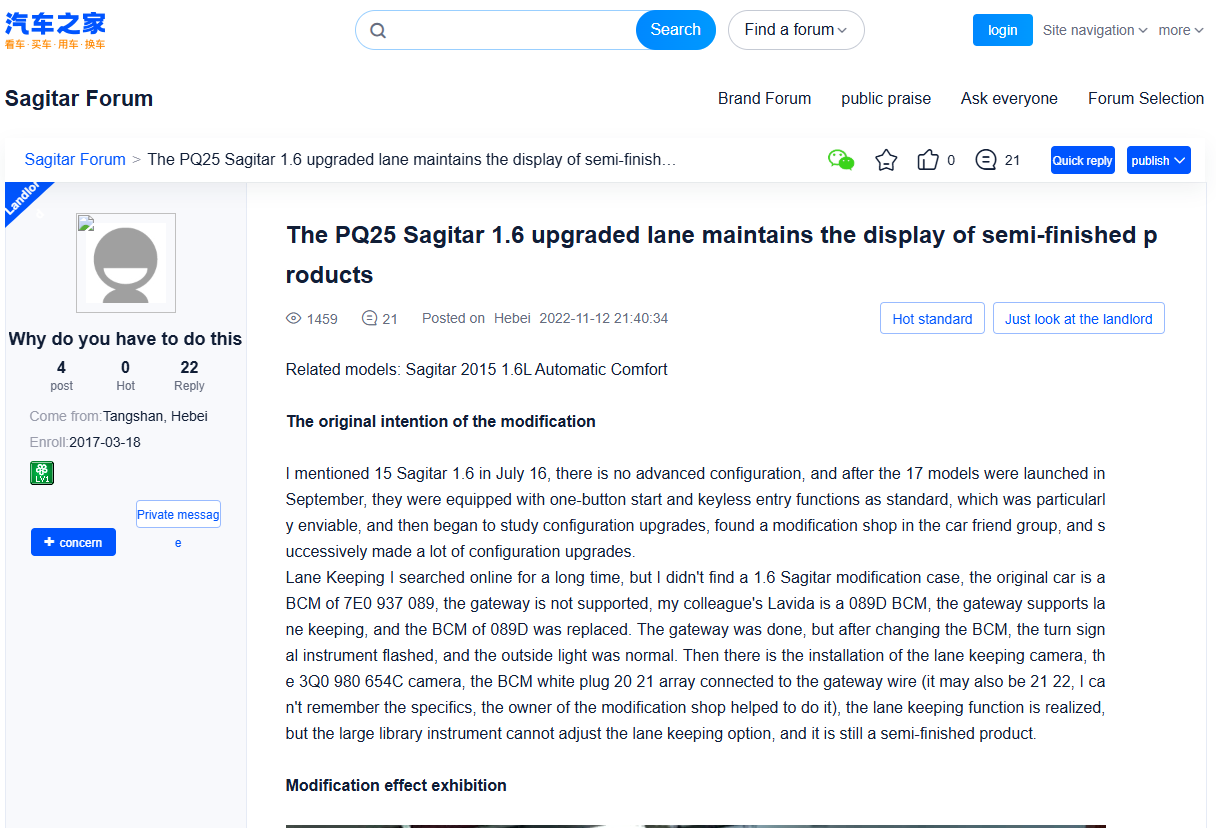

I’ve recently been researching the A5 camera as well.
On a Chinese forum, I found a post about a PQ25 Jetta 1.6 where someone mentioned successfully replacing the A5 camera with a 3Q0 980 654C unit.
I’m currently contacting that person to ask for more details.
https://club.autohome.com.cn/bbs/thread ... 462-1.html

sejuani wrote: Thu Oct 09, 2025 4:49 pm I’ve recently been researching the A5 camera as well.
The Chinese car owner reported that he is unable to provide more detailed information about the A5 camera retrofit, as the Lane Assist. was installed by a modification shop.
He also mentioned that after consulting with others in China who have experience with similar retrofits, so far no one has been able to make the instrument cluster display Lane Assist–related information.

sejuani wrote: Tue Dec 23, 2025 8:19 am
Because they use my experience from D2 =))
