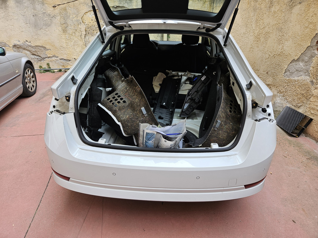

Due to some health problems I was unable to proceed with the installation, even though I had a few days off due to the holidays.
I finally managed to do the first step of installing the radars yesterday.
Just a little teaser

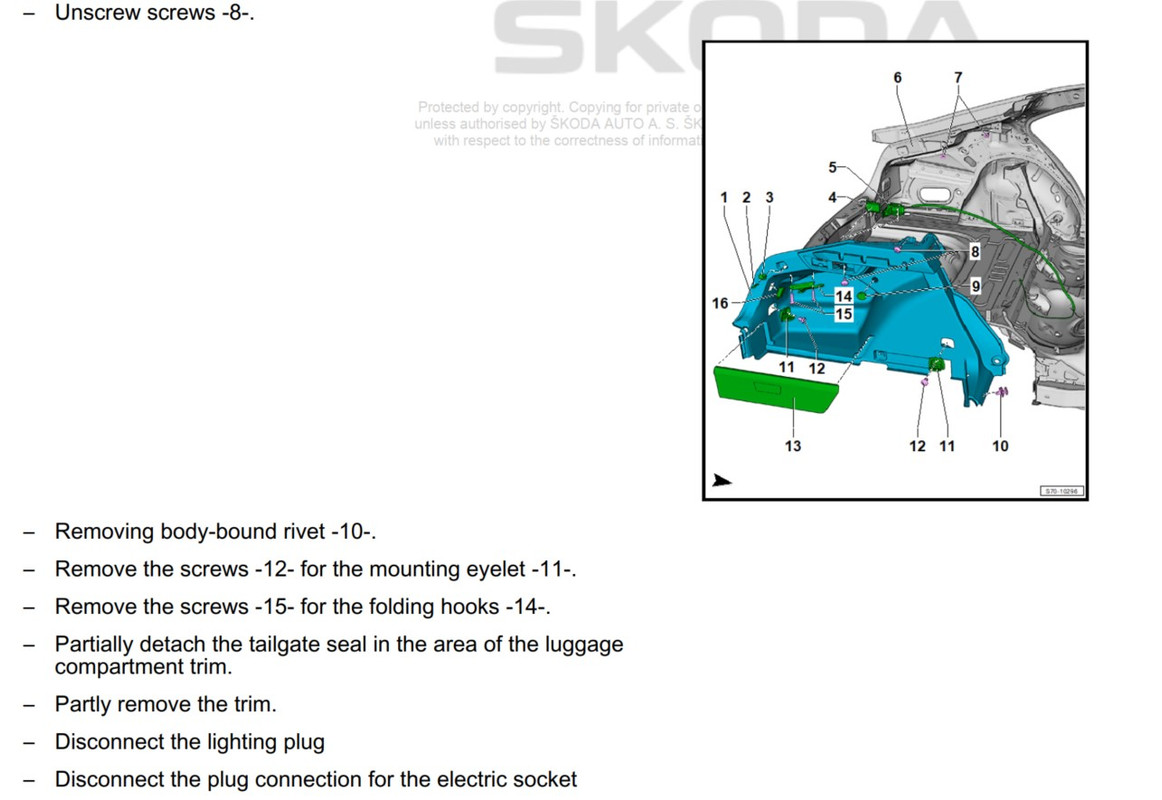

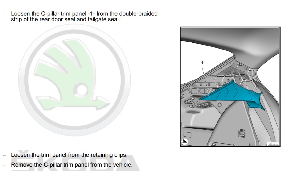

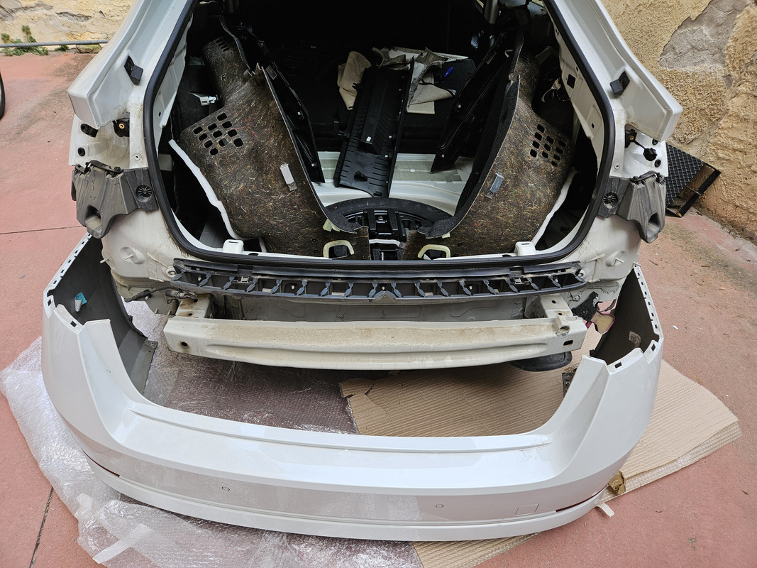

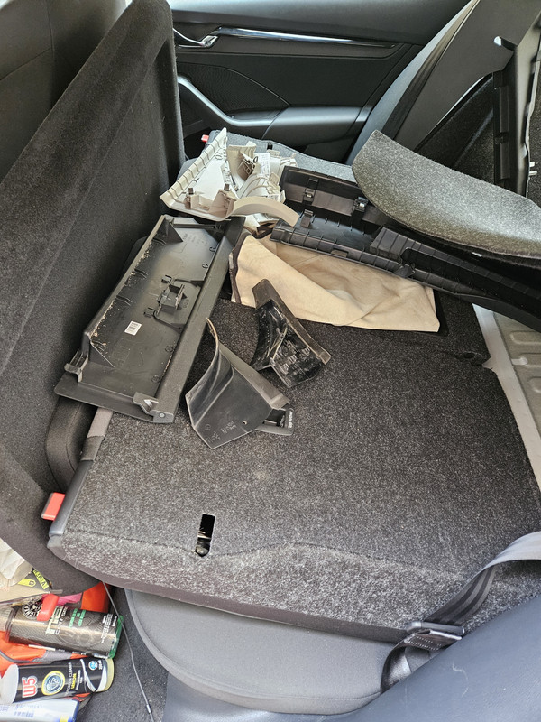

# BSD installation
Well, i have finished the physical installation of the radars at my car.
These are the original parts (right and left) that the BSD radars are mounted on in my car.
So the first thing to do is to remove the rear bumper. In order to accomplice this, i had to remove the rear lights, and some interior trims from the luggage compartment.
And of course a lot of screws
With some effort and a lot of patience i managed to remove the rear bumper
Next step was to mount the brackets and of course the radars installation.
Now it's time for the fun part, the wiring.

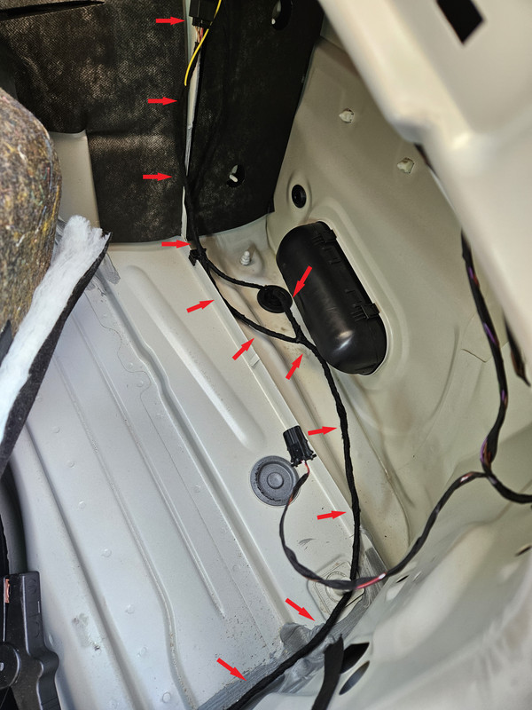

#BSD installation, wiring
the schematic
I read that someone use the rear camera wiring to connect the BSD radars with power and Canbus net.
this is the schematic of the rear camera wiring.
The place of the rear camera wiring is very convenient, is at the right side of the trunk, and has an easy access. it is behind the luggage compartment side trim.
I decided to use the same idea.

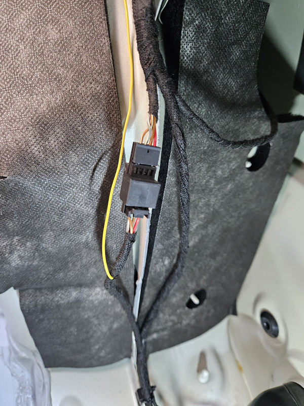

I also decided to use a 4pin connector for my convenience. This is the result.
I root the wires thought the rubber gromets at both sides of the car.
And inside the trunk.
Connected my 4pin connector.
Done!!!
The only thing left is to root the wires (green and yellow) to the front doors for the notification indicator.
Done!!!

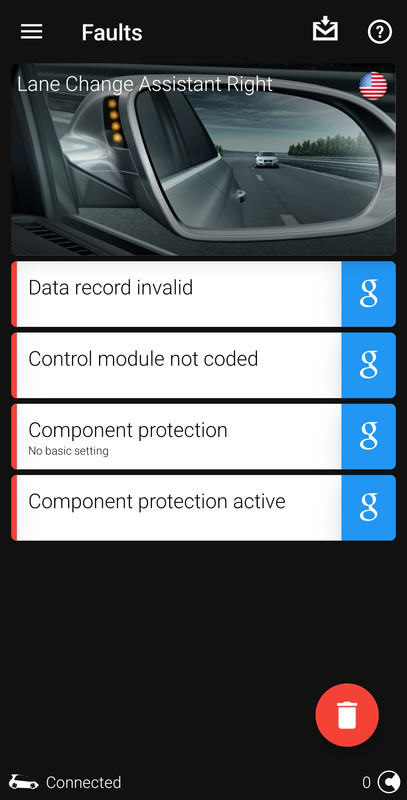

Well,
To tell the truth, I was a little worried if the connection I made was correct.
With ODIS E I can't see the sensors. I think that's logical since I haven't added their module to the gateway list yet.
With ODBeleven I get an indication that the sensors are alive. This it the printscreen.
Probably i am on the right way.
- Posts: 8834
Re: Skoda Octavia MK4 2023, 2.0TDi DSG Ambition
It's not probably, you're definitely on the right way.
As I already mentioned, your VAS5054A - ODIS E does not have the PostSetup for these '2024' radars.
You can now go to your friend's updated official VAS for CP, parameterization (data set), and everything you can do there.
