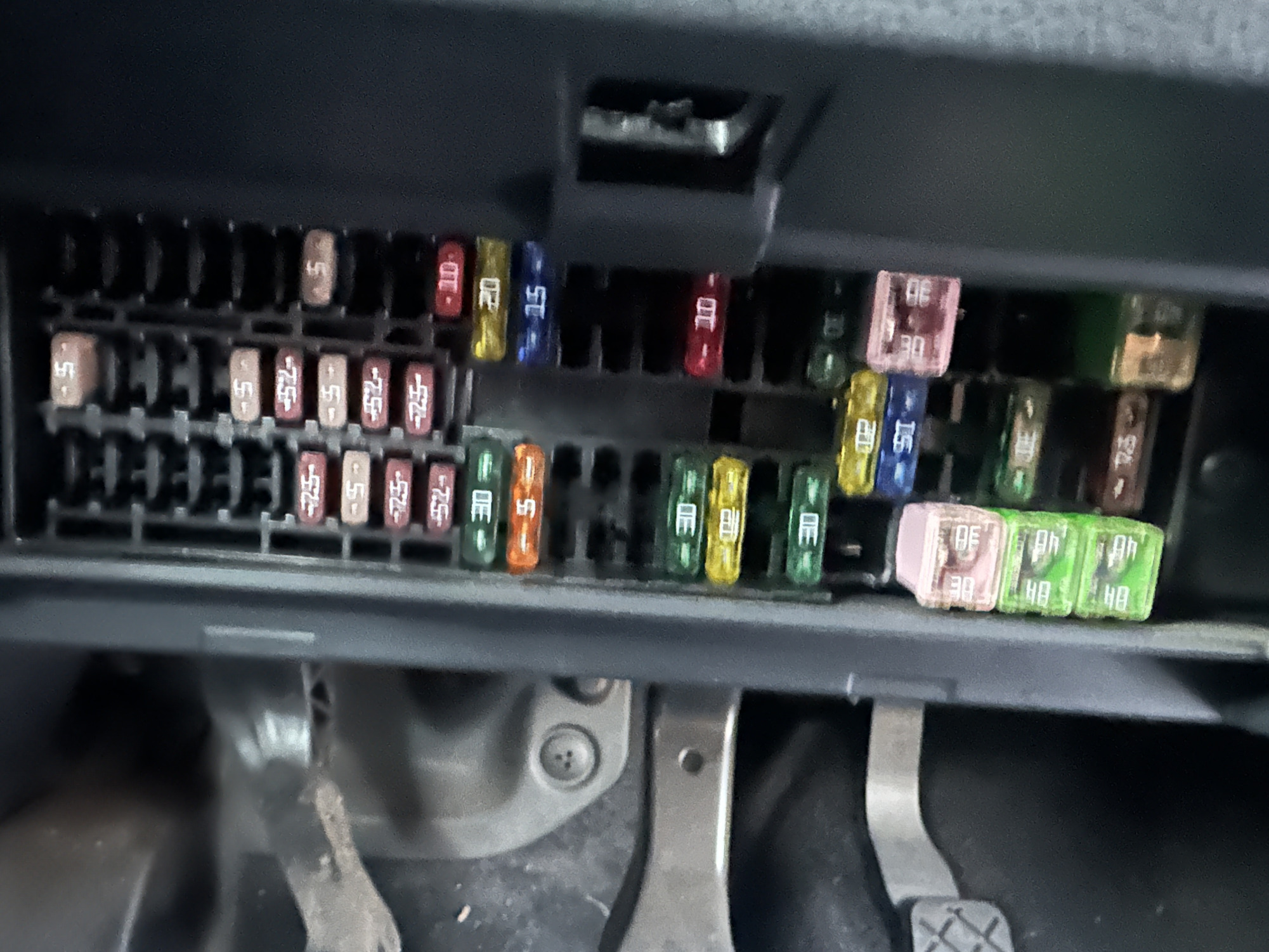

If you don't have a diagnostic tool to post a scan, upload a photo of the fuse box under the steering wheel so we know if it is a 6R or a 6C and indicate the appropriate fuse or comment on what could be happening.
I'm afraid it's a 6C but we'll wait for that image.

As for the washer pump, I still haven't had the chance to check the fuses. I've attached a photo I had taken of the fusebox when I originally posted. Sorry it's out of focus, I'll take a better one later if needed.

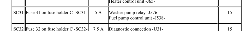

If so, would this be the correct fuse?
I'm confused if that's the case because apparently the fuel pump control unit is on the same fuse. So presumably the engine wouldn't run if that fuse had blown?
So if it's not the fuse, is it the pump itself that's gone?

I'm sure, from memory of reading about people having this "no washer fluid pump" in 6C Polo, that there is another pump associated with the washer fluid pump - as well as that one that you have found.
VW's description will probably be vague or worse!
Edit:- SC23 Brown 7.5Amp located in the "middle row left side of fuse box" - I can see a 7.5Amp fuse there, from memory(again) maybe Skoda, suggested changing that to a 10Amp fuse.
Another edit, I've re-read my notes I made years ago, what you are looking for is the complete middle row of the fuse box, they are numbered Right to Left, and the one at the most right hand end is a brown 7.5 ATO style of fuse, and that is the SC23 which you should check.

RUM4MO wrote: Mon Jan 13, 2025 8:38 pm I'm sure, from memory of reading about people having this "no washer fluid pump" in 6C Polo, that there is another pump associated with the washer fluid pump - as well as that one that you have found.
OK, I think I see the one that you mean. I'll check the fuse tomorrow and if it's visibly blown, will order a set of assorted fuses from Amazon. If it's not visibly blown, then I presume the pump itself is going to need checking.

The 7.5 amp fuse in the middle row far right hand side above the green relay is definitely the screen washer pump fuse,
i had this same issue this weekend , replaced all working
hopefully yours as simple as mine

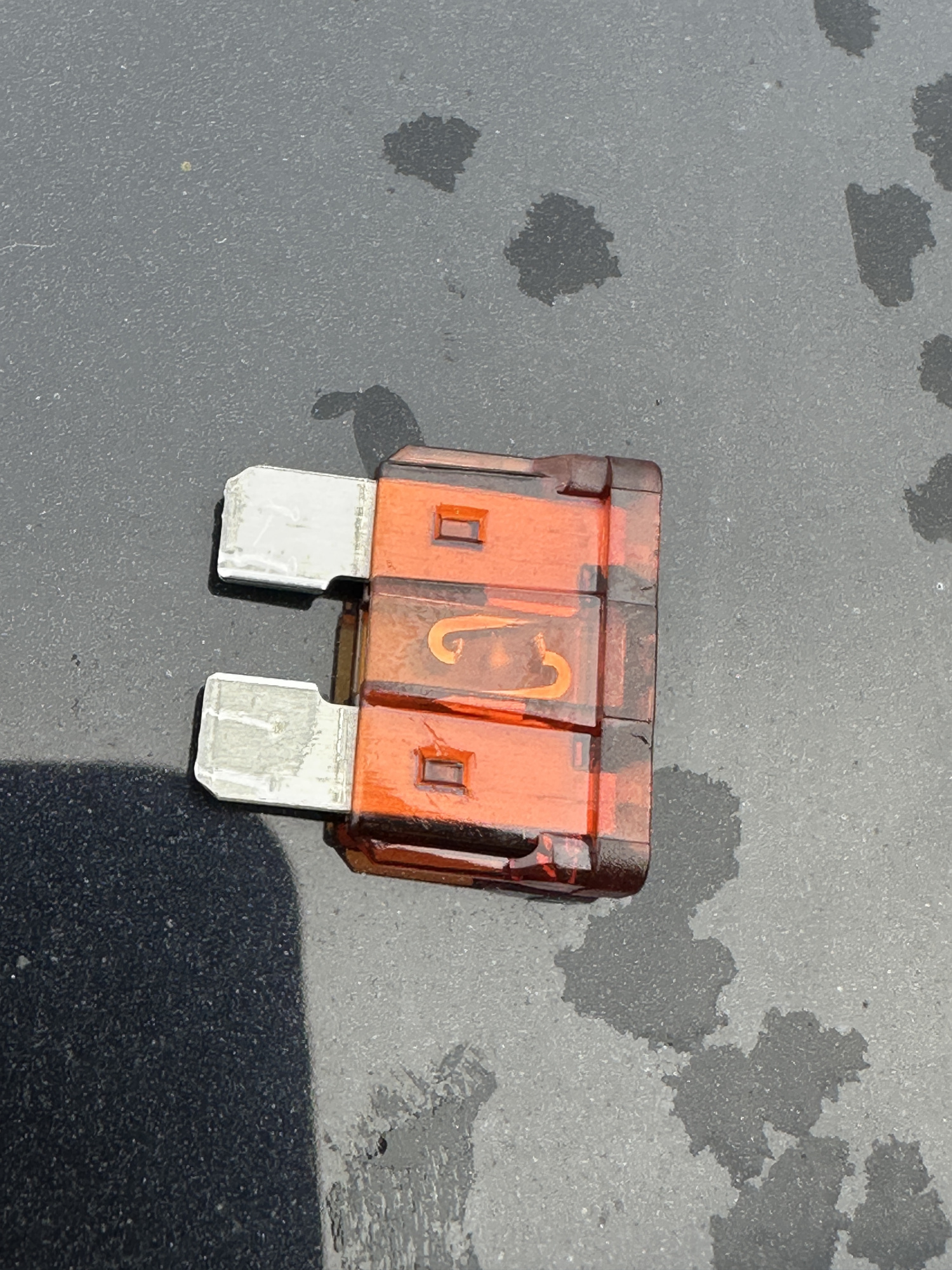

Yes, it's definitely the fuse.
Thank you so much for helping with this, guys. You've saved me the time and expense of taking it to a garage. :)
Now I just need to get a replacement fuse. I'm thinking of buying an assortment kit off Amazon, which will probably still work out cheaper than buying individual fuses at Halfrauds. :lol:

Thanks for reporting, a compelling image to clarify the issue.
