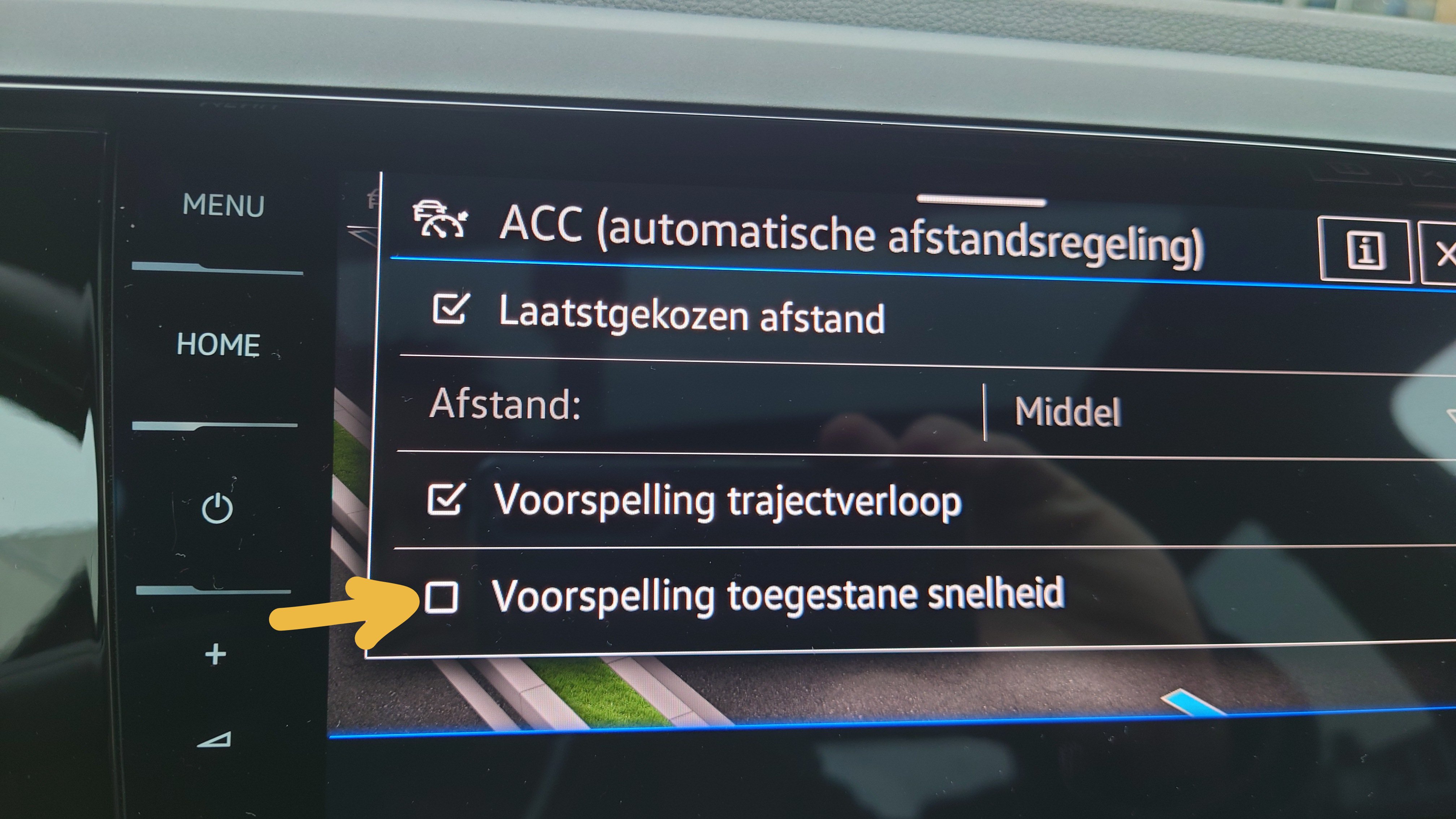

Go to IQDRIVE settings
Select ACC
Decheck this box (predict speedlimit)
ACC (1).JPG (948.01 KiB) Viewed 4751 times

My screen does not seem to be the same as the one above

So what do you see when pressing on ACC?
