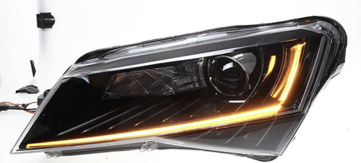

Hello Polos
Has anyone know how to change drl lights from white to yellow?
I met alot of skoda superb in this serup

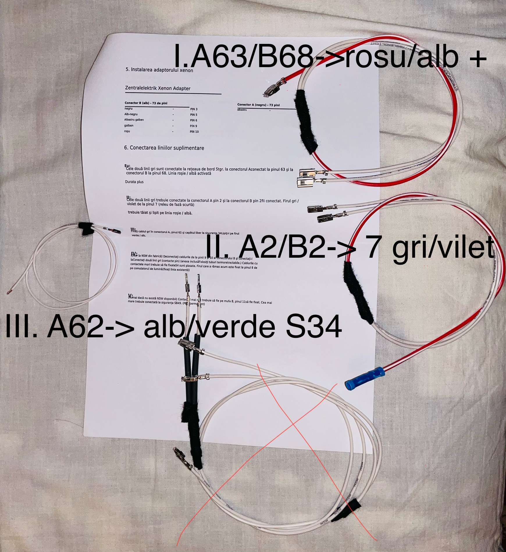

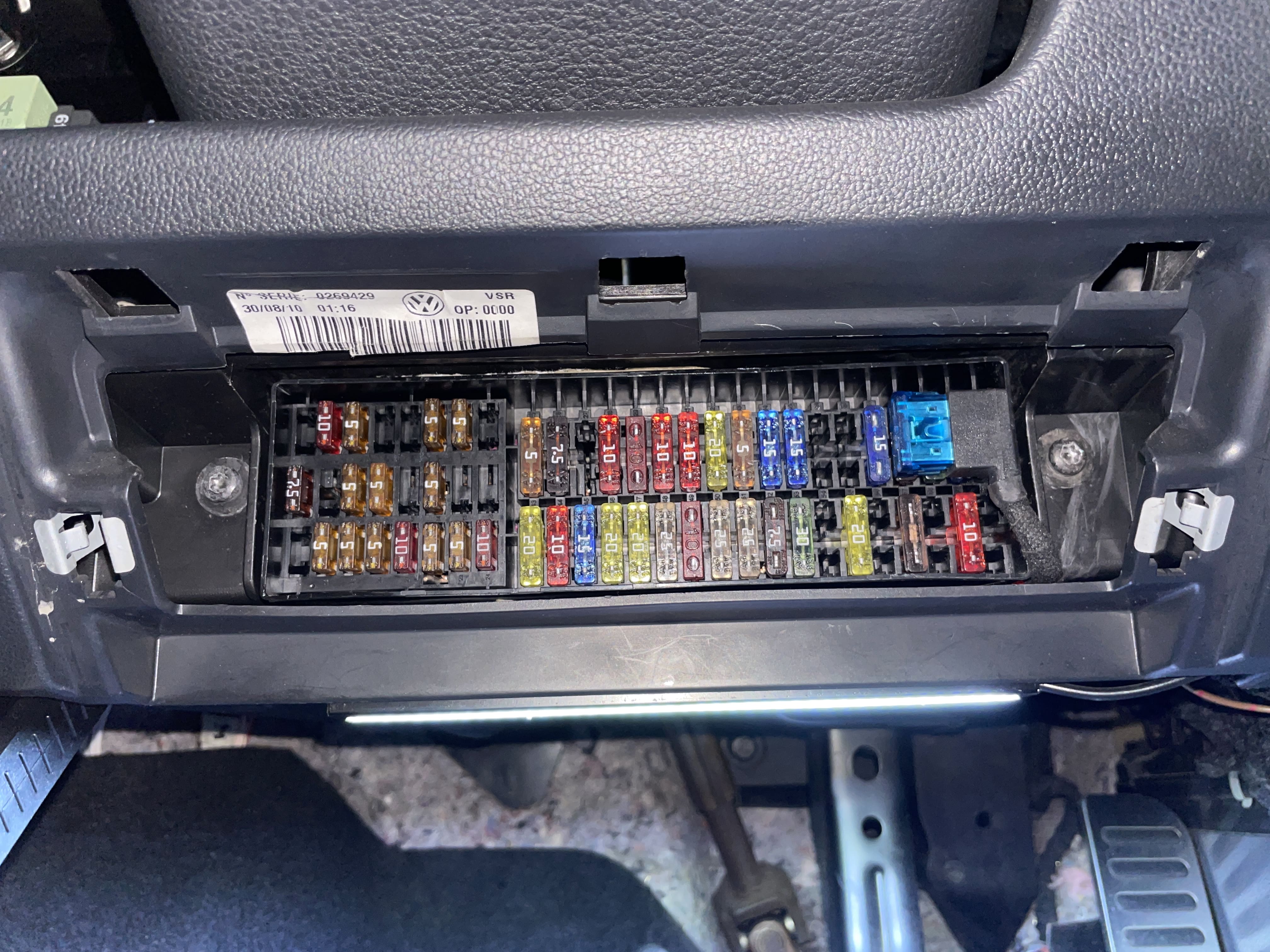

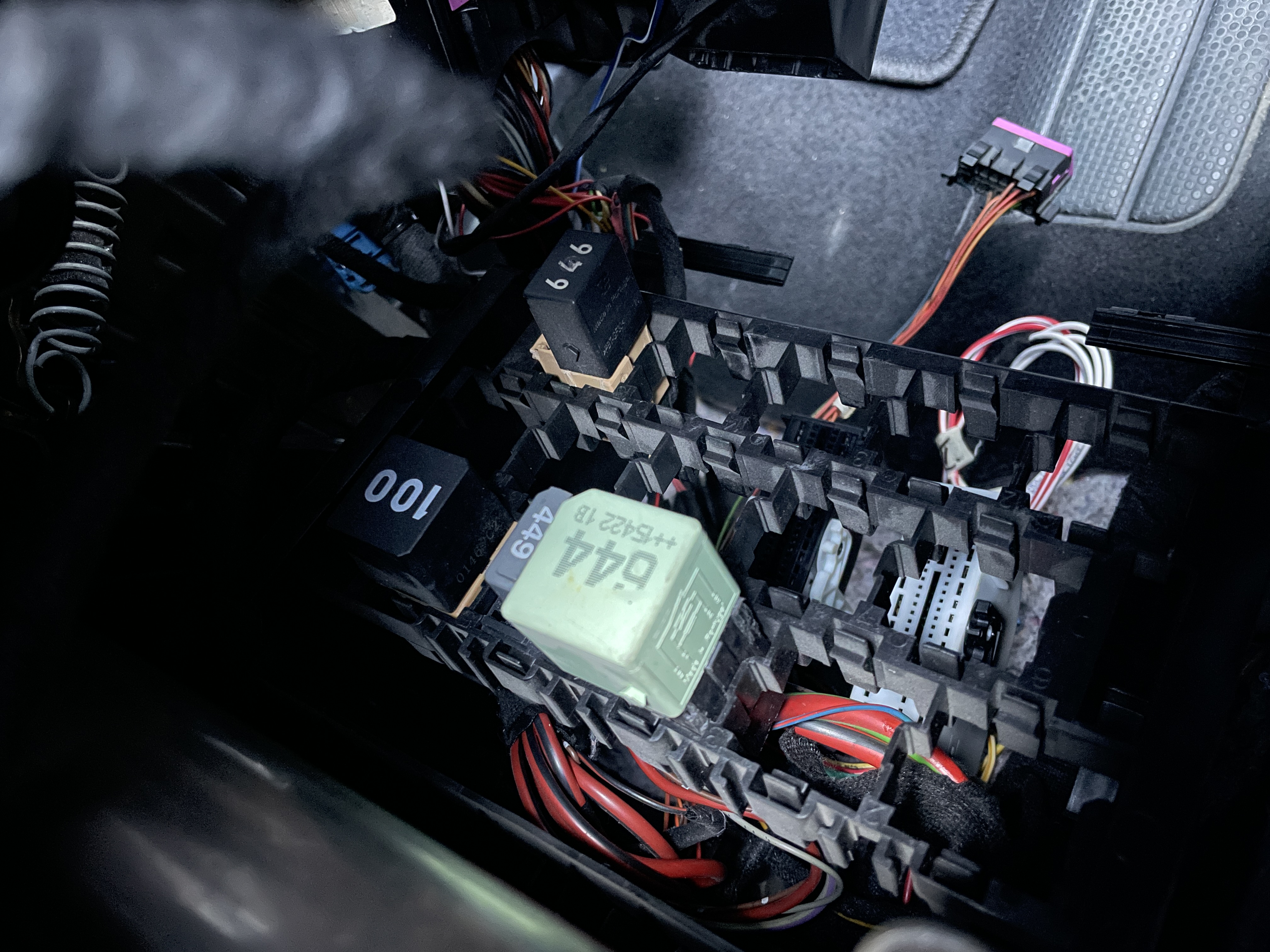

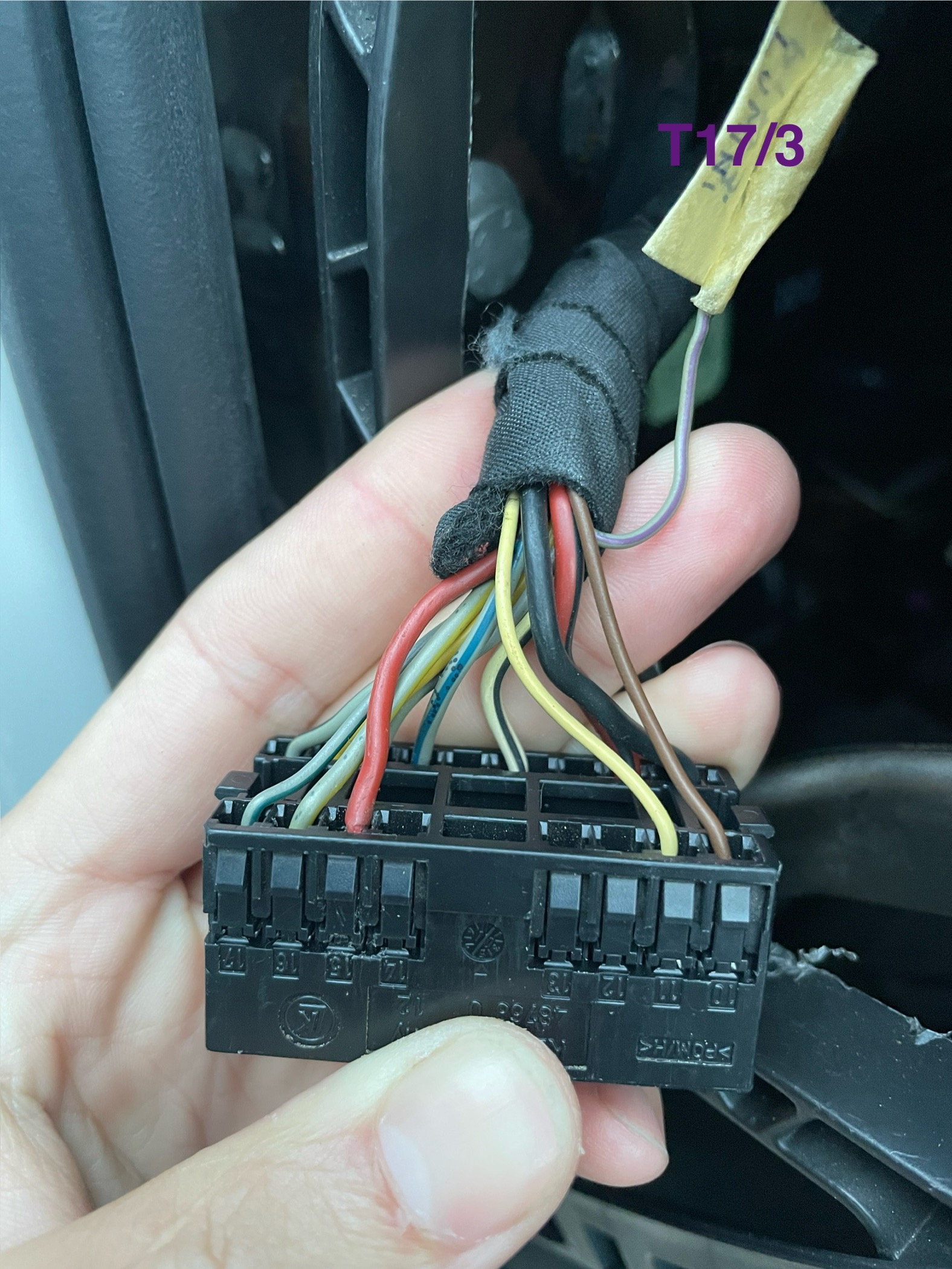

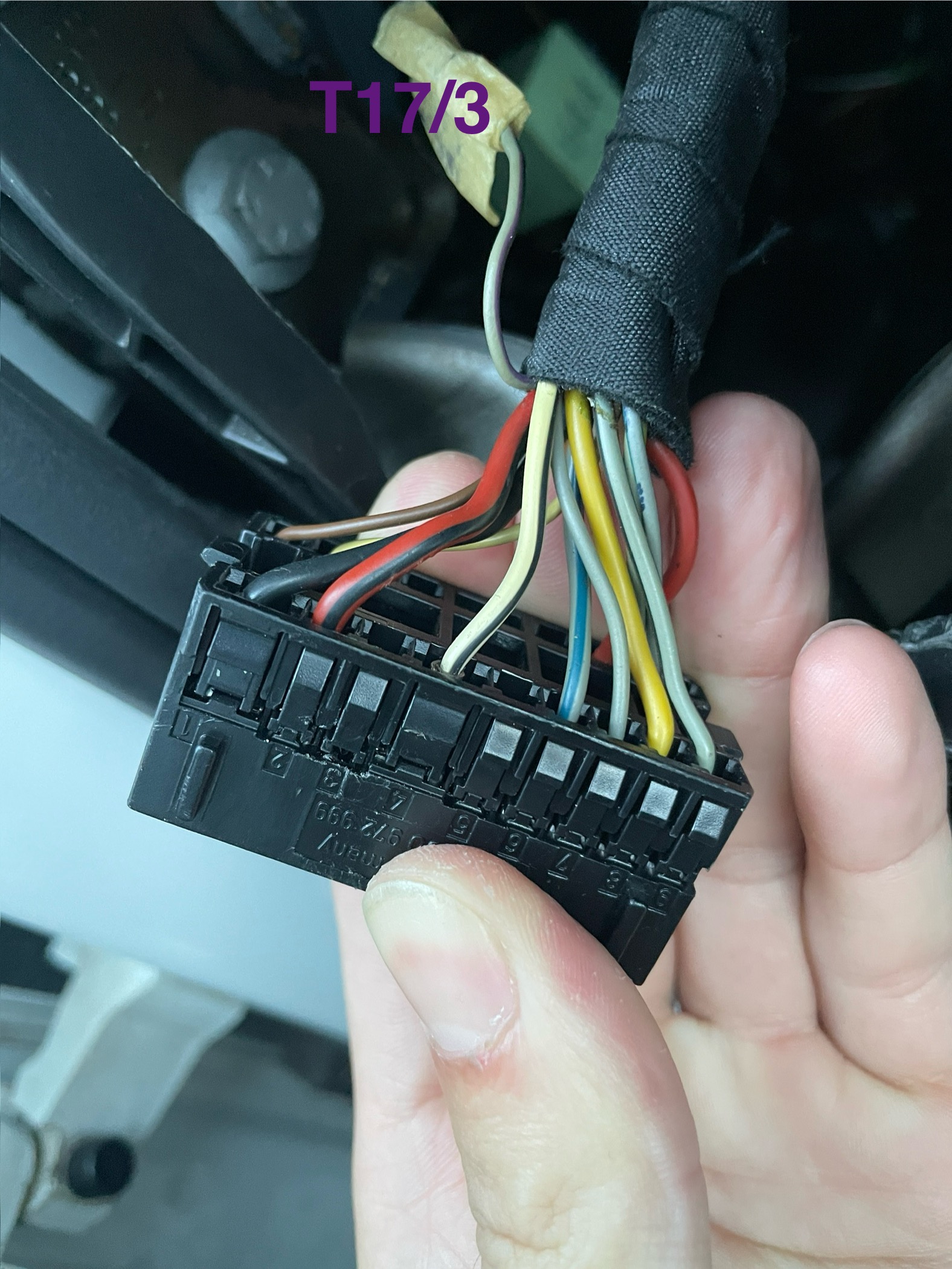

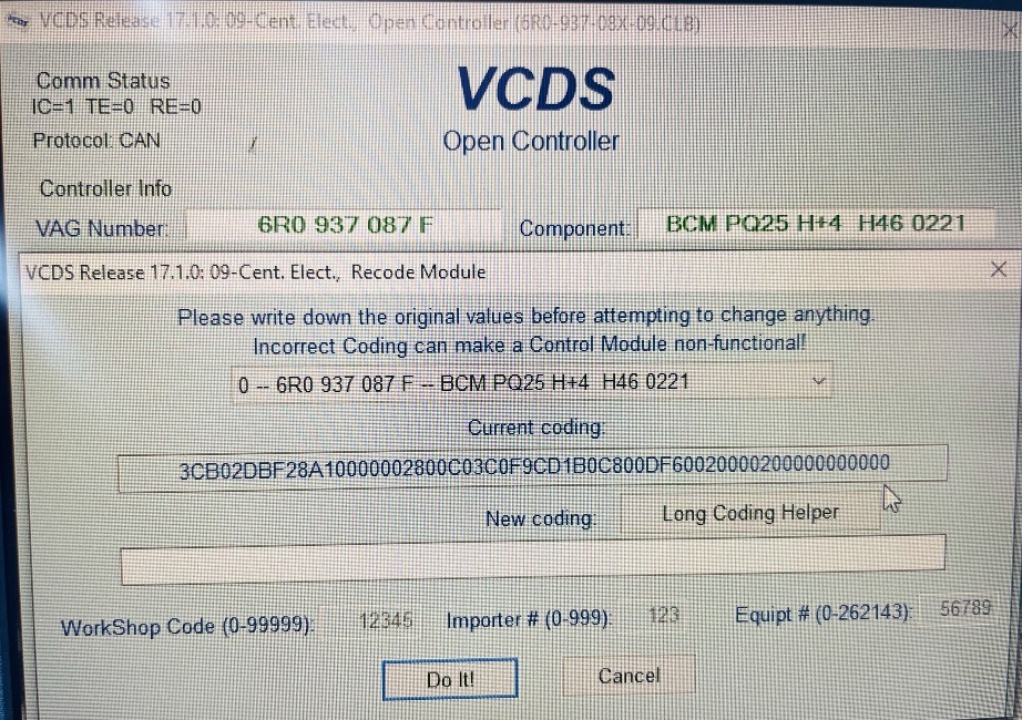

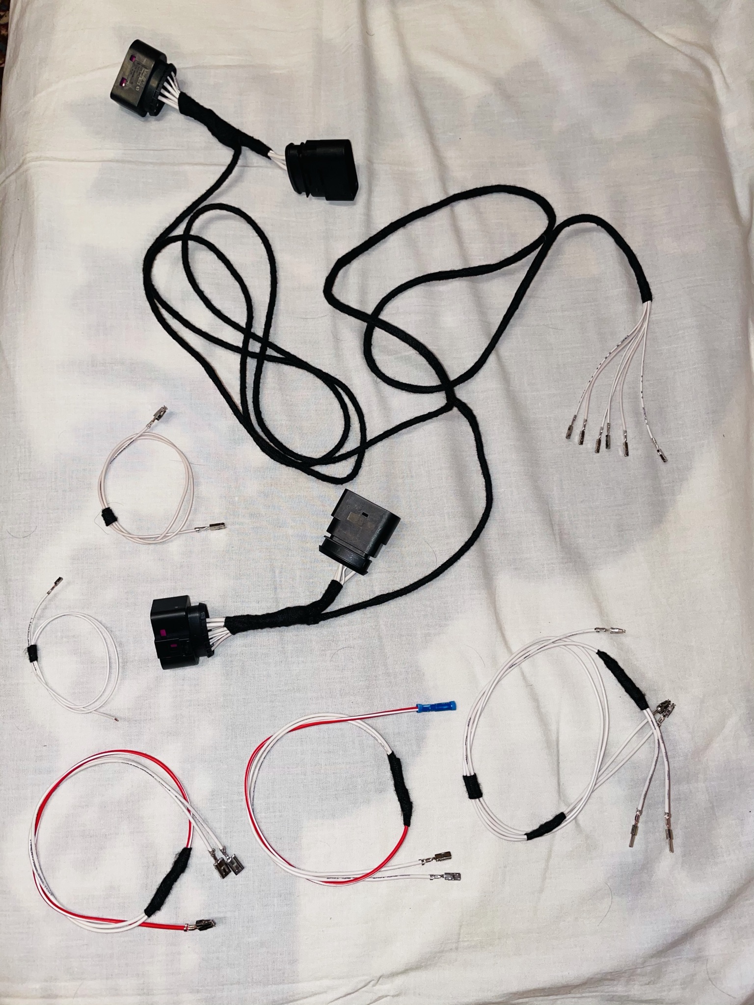

Hello. I'll start by apologizing for my English. I've been searching and following the problems for this retrofit all over the internet and I haven't been able to solve my problem. I found here almost the same situation as mine. Just like my colleague Bakis, I have almost the same problem after the retrofit with KAUFTEC ADAPTOR 10-14. I have two situations and I don't understand anything anymore.iichel wrote: Wed Apr 29, 2020 5:46 pm OK well then I have an idea about what went wrong. You need to do a BCM Max wiring/adaptation:
- Wiring from light switch to BCM
- Wiring from fuse box to BCM
- Wiring from BCM to external lights via fuse box
- Adjust coding/adaptations accordingly
In the first situation (present) with BCM OEM 6R0937087F:
*Additional wire no.0
the KAUFTEC wiring kit, namely the 6 cables (73B<-PIN3,5,6,9,10 and 73A<-PIN5) = I connected them;
*Additional wire no.1
A63+B68 -> permanent plus = I didn't connect them;
*Additional wire no. 2
A2+B2 -> PIN7 relay for lower beam head lamp (cut the wire PIN7) = I did not connect them;
*Additional wire no. 3
A62 -> fuse 34 (braze on-white/green) = I connected it;
*Additional wire no. 4
old B9+B10 -> fuse 54 -> PIN8 on T17 = I did not connect them;
*OEM wire from T17/3 = I disconnected it
The result for the above configuration:
1) Light switch 0 = LED's and high beam not working (just shutters without lights).
2) Light switch "parking lights" = LED's and the high beam not working as well.
3) Light switch "on" = Still LED's off, Xenon light turn on, highbeam work well with lights (Bi-Xenon), and fog cornering work if I signal.
4) Light switch "fog lamps" = Still LED's off, fog light turn on, highbeam work well with lights (Bi-Xenon).
In the second situation with BCM MAX 7E0937090C:
KAUFTEC wiring kit, respectively the 6 cables (73B<-PIN3,5,6,9,10 and 73A<-PIN5) = I connected them;
A63+B68 -> plus permanent = I connected them;
*Additional wire no.2
A2+B2 -> PIN7 relay for lower beam head lamp(cut the wire PIN7) = I connected them;
*Additional wire no.3
A62 -> fuse 34 (braze on-white/green) = I connected them;
*OEM wire from T17/3 = I disconnected it;
*ADD new CAN LINES IC28->73A/54, IC29->73A/57 = I connected them;
For the configuration above it happens like this:
3) Light switch "on" = Still LED's off, Xenon light turn on, high beam work well with lights (Bi-Xenon), and fog cornering NOT work.
4) Light switch "fog lamps" = Still LED's off, fog light turn OFF, high beam work well with lights (Bi-Xenon).
#ciclo Where am I wrong?
- coding09.jpg (346.21 KiB) Viewed 2207 times
- 09d.JPG (1.17 MiB) Viewed 2207 times
- 09c.JPG (2.62 MiB) Viewed 2207 times
- 09b.JPEG (714.33 KiB) Viewed 2207 times
- 09a.JPEG (688.24 KiB) Viewed 2207 times
- 03.JPEG (996.04 KiB) Viewed 2207 times
- 02.JPEG (899.39 KiB) Viewed 2207 times

002 - Lower Limit Exceeded
Fault Status: 01100010
Fault Priority: 2
Fault Frequency: 1
Reset counter: 168
Mileage: 200505 km
Time Indication: 0
Date: 2019.10.19
Time: 08:09:45
Address 09: Cent. Elect. (J519) Labels: 6R0-937-08x-09.clb
Part No SW: 6R0 937 087 F HW: 6R0 937 087
Component: BCM PQ25 H+4 H46 0221
Revision: BF046001 Serial number: 0345 208101807
Coding: 3CB02DBF28A10000002800C07C0F9CD1FFC800F060860040200000000000
Shop #: WSC 12345 123 56789
VCID: 408F2625D35250418F-8014
Subsystem 1 - Part No SW: 6R0 959 801 R HW: 6R0 959 801 R Labels: 6R0-959-801.CLB
Component: J386__TSG_FT 006 0912
Serial number: KU0-KU026.07.1013309
Coding: 08BC30
Subsystem 2 - Part No SW: 6R0 959 802 T HW: 6R0 959 802 T Labels: 6R0-959-802.CLB
Component: J387__TSG_BT 006 0912
Serial number: KU0-KU027.07.1013069
Coding: 08BC30
Subsystem 3 - Part No SW: KU 0-K U02 7. HW: KU0 -KU 027 .0
7.10
Coding: 333036
Address 15: Airbags (J234) Labels: 5K0-959-655.clb
Component: VW10Airbag004 H09 0020
Revision: -------- Serial number: 003GX005PUP8
Coding: 003034
Shop #: WSC 00788 648 00255
ROD: N/A
VCID: 4A9B040DED6E9A1151-801E
Subsystem 1 - Serial number: 357
Subsystem 2 - Serial number: 3582SRB40000C7909A9F
Subsystem 3 - Serial number: 3515RRB405R6T8MIHG2I
Subsystem 4 - Serial number: 3525RRB40616T8MIF0AR
No ASAM data for: "EV_AirbaVW10BPAVW250" (VW36)
Address 17: Instruments (J285) Labels: 5K0-920-xxx-17.clb
Part No SW: 6R0 920 860 F HW: 6R0 920 860 F
Component: KOMBI H04 0304
Coding: 140800
VCID: 377D4DF98E9C17F93E-8062
Address 19: CAN Gateway (J533) Labels: 6N0-909-901-6R.clb
Part No SW: 6N0 909 901 HW: 6R0 937 087
Component: GW-K-CAN TP20 0221
Coding: 002000
VCID: 70EFB6E5A37280C13F-8024
Address 25: Immobilizer (J334) Labels: 5K0-920-xxx-25.clb
Component: IMMO H04 0304
Serial number:
Shop #: WSC 00000 000 00000
VCID: 6ADBA48D8DAE7A1171-803E
Address 37: Navigation (J0506) Labels: 1T0-035-680.clb
Part No SW: 1T0 035 680 L HW: 1T0 035 680 B
Component: RNS-MID H11 5238
Revision: AB001001 Serial number: VWZ6Z7J9045036
Coding: 04000400040000A10020
Shop #: WSC 05314 123 12345
VCID: 377D4DF9869C17F93E-8062
Part No: 6R0 423 156 B
Component: LenkhilfeTRW V277
Coding: 11250
Shop #: WSC 00788
VCID: 2F6D7599EACCDF3966-807A
Address 56: Radio (J0506) Labels: 1T0-035-680.clb
Address 77: Telephone (J412) Labels: 7P6-035-730.clb
Part No SW: 7P6 035 730 L HW: 7P6 035 730 L
Component: TELEFON H15 3200
Revision: 1B001001 Serial number: 00007664892951
Coding: 0010000100010110
ASAM Dataset: EV_UHVNA 002720
ROD: EV_UHVNA_002.rod
VCID: 3B7551C9B2B43399DA-806E
End-------------------------(Elapsed Time: 02:27)--------------------------
