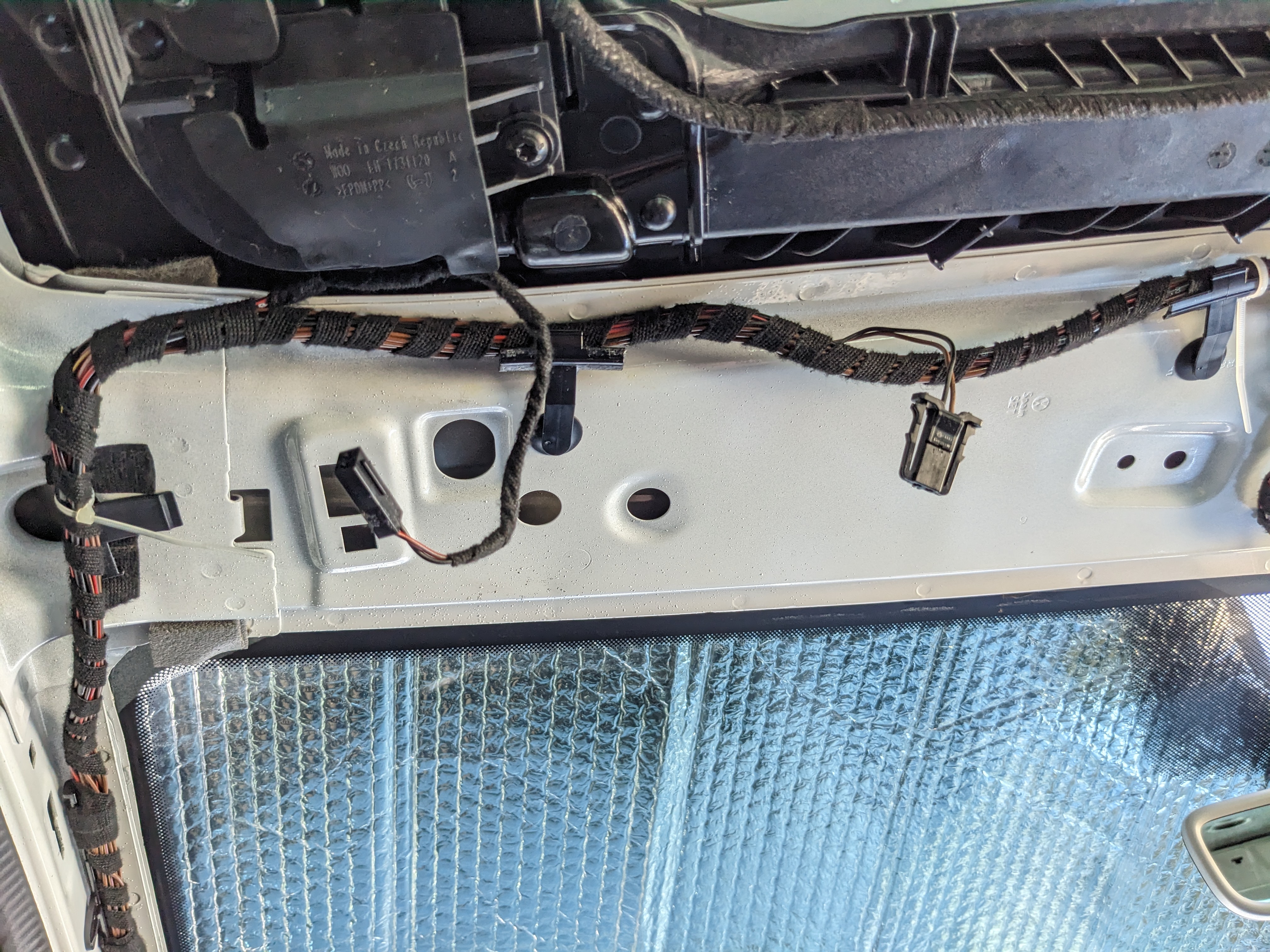

My first repair 2 years ago:

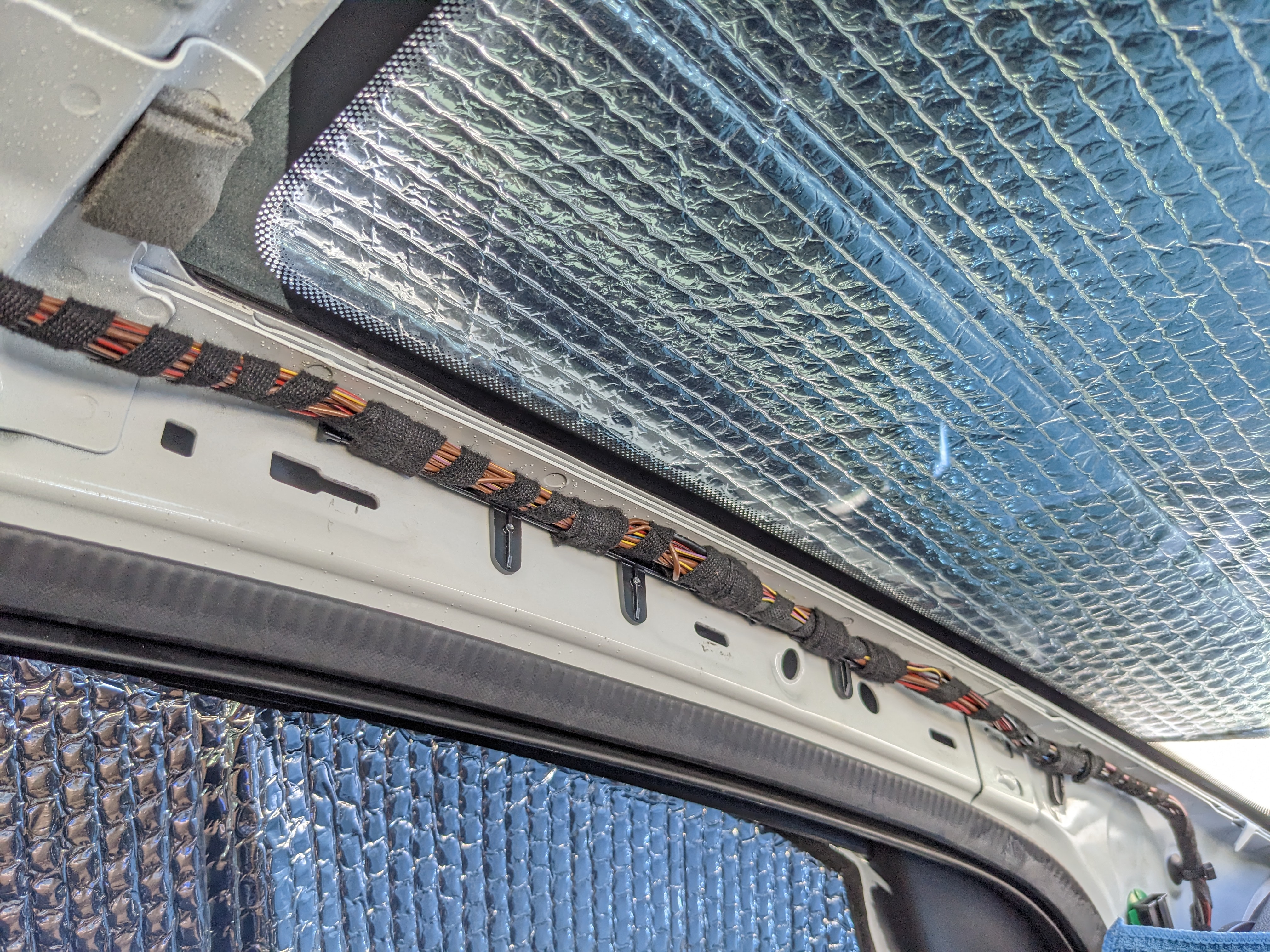

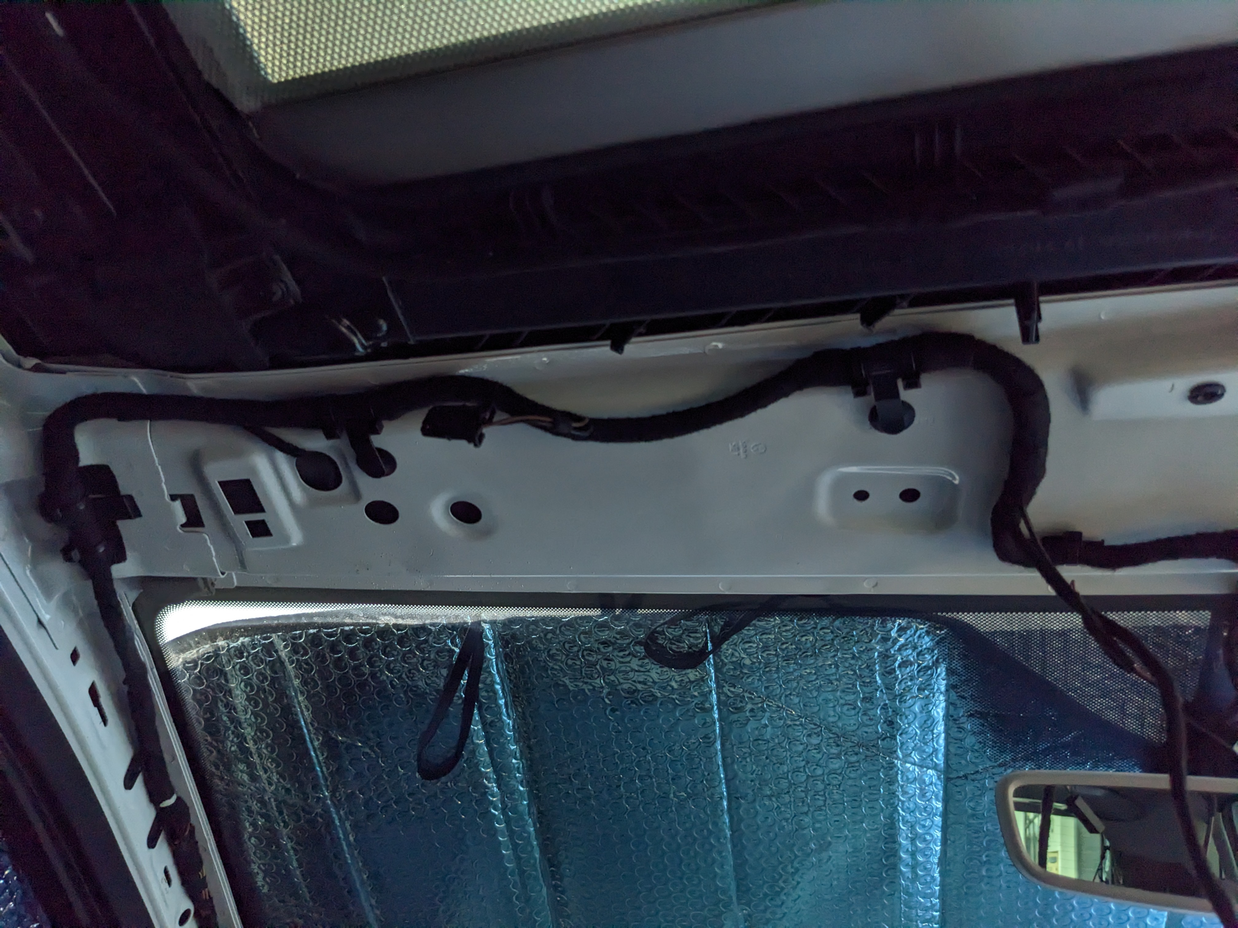

And now:
Looks way more OEM like the lower part of the wiring going down to the dashboard/lower part of "A" pillar

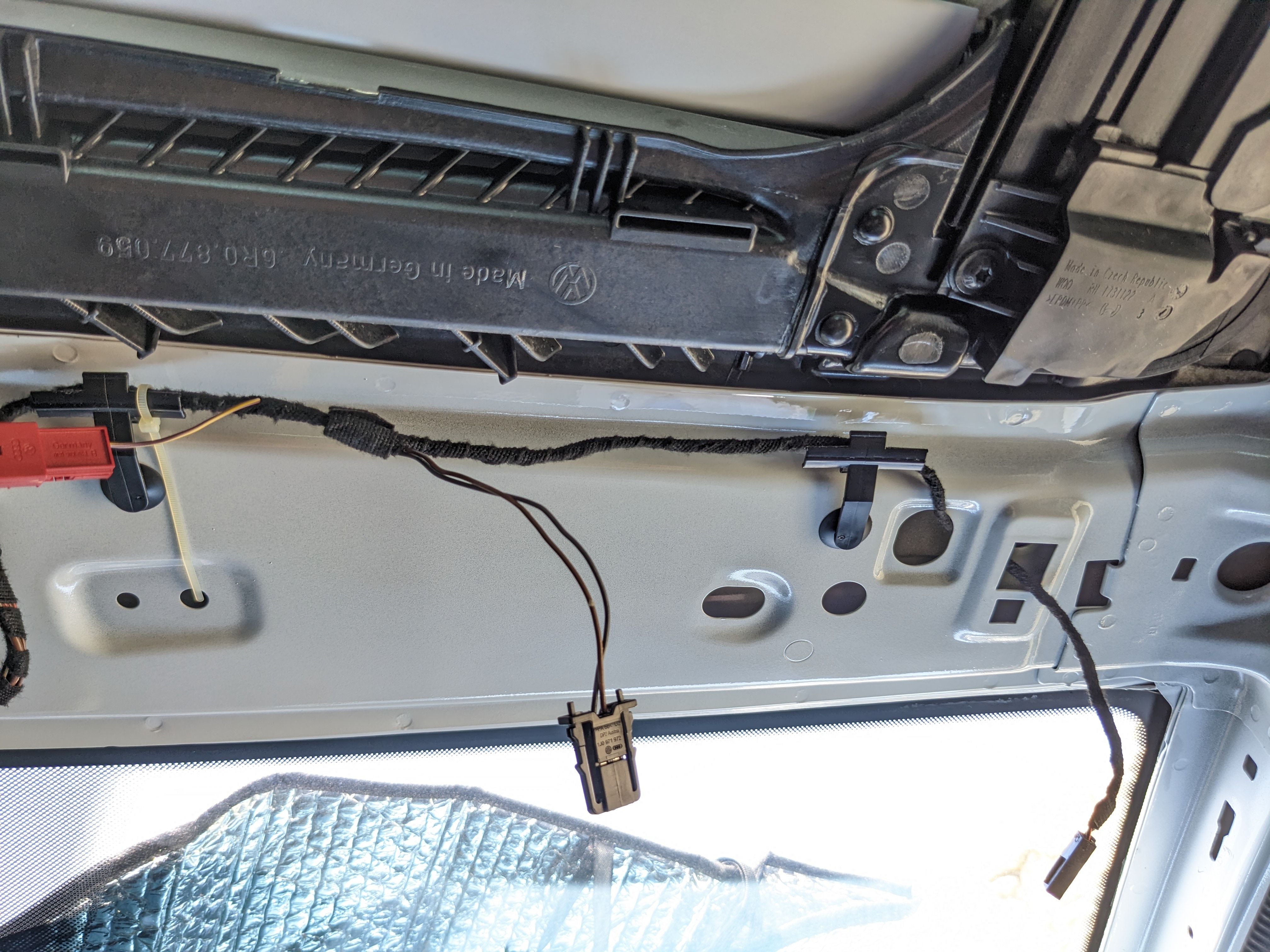

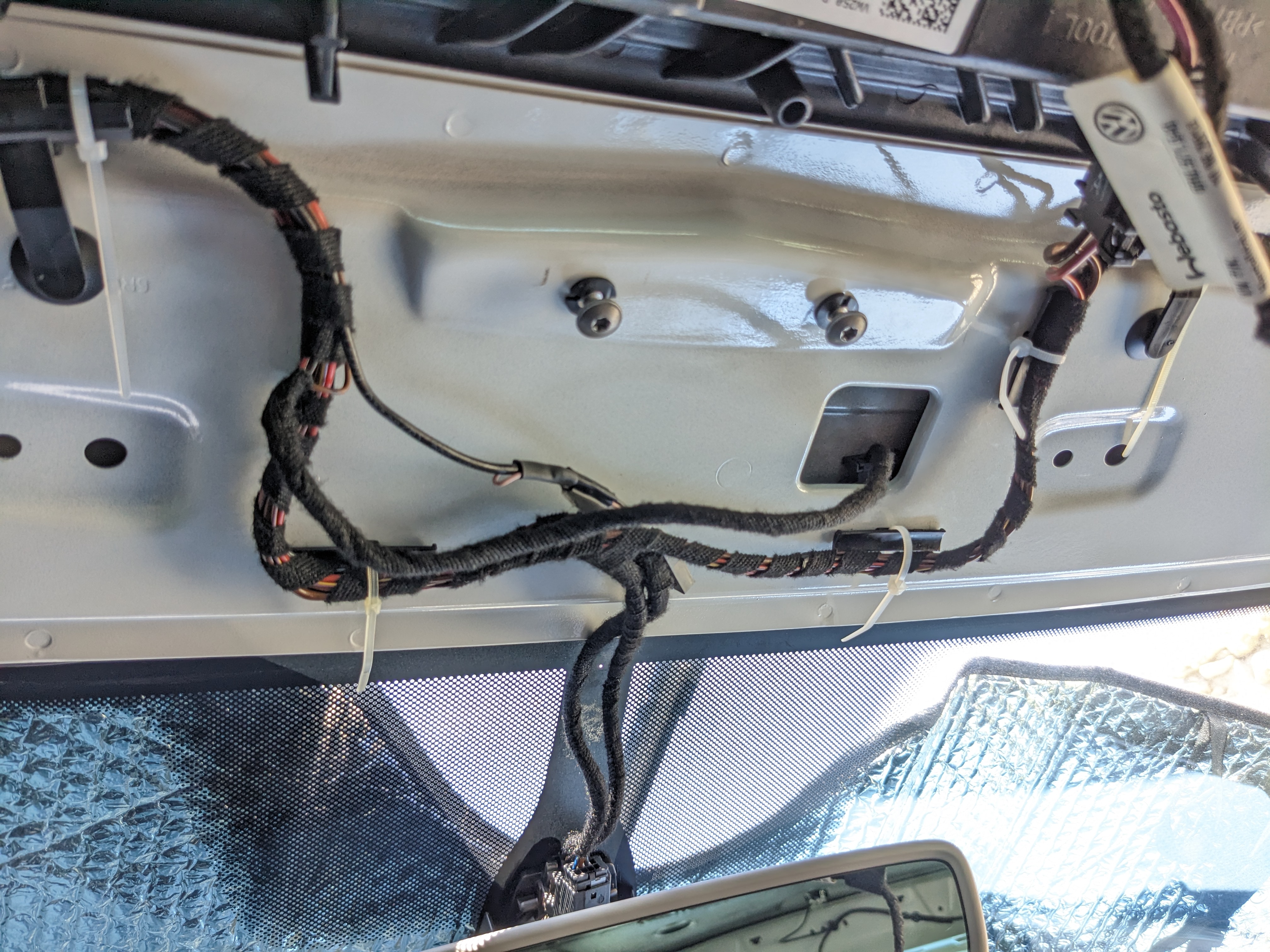

But I have some issue with the upper supports:
As factory, a piece of wiring tape was put over/around the harness, go over/under the support (depending of support's type) and that's all.
Here, even with gloves to avoid glue contamination some wiring tape start to peel off.
So I'm quite frustrated and running against time because in two day, I have to install back the headlliner and I will no longer access to them.
The main solution will be to put on straps but I would prefer OEM look (even I will no longer see this location :P )
