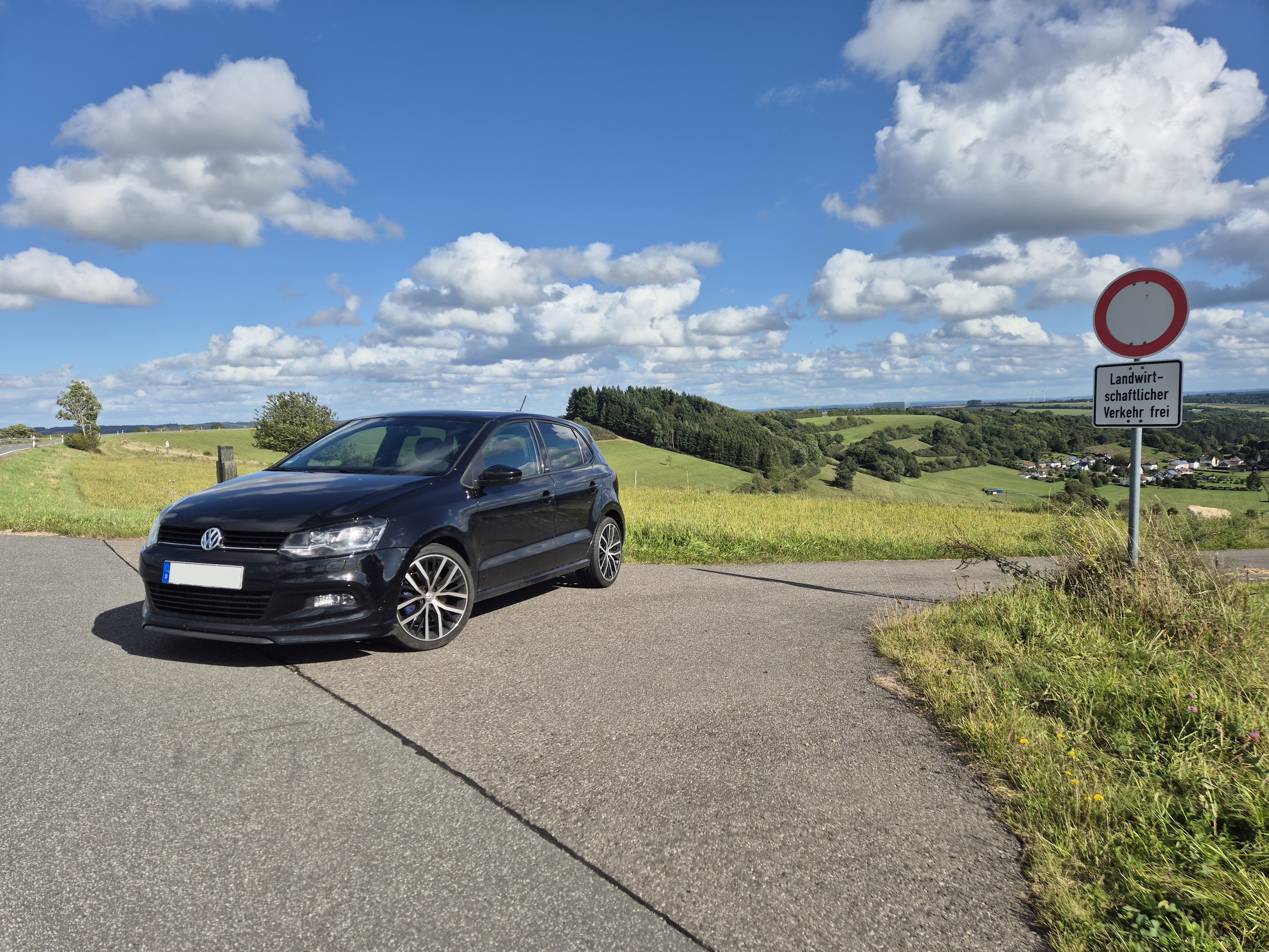

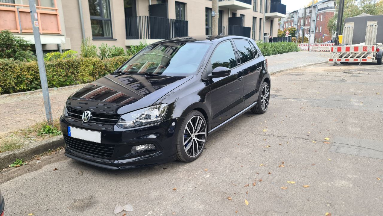

Alrighty, back again.
A little update about the state of my car. First of all: I finally got my bumper covers back from painting. Now I ask myself why the frick I didn't convert to R Line sooner.
And yes, I am very aware that it really needs the highline 6C grill. I have one. Somewhere. Can't find it. I apparently have too much stuff in too many places. XD
Secondly, I now had my new engine for around 5.000 km. And I LOVE it. You can drive it somewhat economical, but you don't want to. The power delivery is awesome! It has some small problems, to which I'll get separately, but overall, it has been a blast so far.
Thirdly, I finally found a reasonably priced ALWR control unit with index C. I haven't really had the time to play around with it, but as far as I can tell other than the need for a fresh set of parameters (which it will get this Thursday) it's fineish.
Also, a little outlook for the future: GT spoiler, widened sill panels and water deflectors are in the making for a completed BlueGT look. In the planning are also side assist (where I might need ciclo's help), TPMS and this exhaustion detection system thingy. Or maybe some light tuning? I don't know, but I sure will find a way to waste my money
So long

Automatic headlight range control now working!
I am happy to announce that my headlight range control is now working flawlessly.
As a recap: some time ago I swapped my H4 headlights for OEM 6C LED headlights. For the automatic range control I used the control module 6R0907357 like in a xenon Polo. Unfortunately the range control wasn't working properly. Whenever the headlights should have adjusted downwards, they turned upwards, blinding the oncoming traffic.
To mitigate this, I purchased a 6R0907357C control module out of a xenon Passat CC. Even after I flashed it with the preset Polo parameters from VCP, my problem remained. So I flashed the TinyQ parameters using VCP. To be precise: I flashed all three of the TinyQ parameters (both Bixenon and the LED one). After coding 0D8A000001000000 and doing the basic settings the system is now working.
Immediate sign for the working system: When I start the engine my headlights are now doing the self-check by turning down and back up to the proper level. Until I flashed the TinyQ parameters this was the other way round.
Thanks to iichel for the inspiration and the instructions as well as ciclo for the recent help!
Just one question: when I activate the travel mode in my instrument cluster, I get a yellow flashing light warning for a few seconds. There are no faults generated by this. I can't really tell if the travel mode is actually doing anything, but I think there is an absolute miniscule movement downwards. Is this normal behaviour?

Hey you all! My little Blue-GT-swapped Polo recently survived a small 2500 km road trip through the southern parts of Germany. A nice opportunity to take some pretty pictures. Please ignore the absolute humongous amount of dirt on it!
Also, it was a good way to test it out some more. And of course, I found two mediocre problems:
ESC being boring
When I turn through sharper turns with a little bit more... gusto
, the ESC thinks I am slipping away, cuts power and breaks me to almost a standstill, if I don't straighten the wheels. I think it is a bit (way) too overprotective, since if I turn it off, I can take the same turns with quite a bit more speed without slipping a bit. My ABS coding seems to be correct (I guess?). I am using stock Blue GT springs with stock 6C GTI dampers and the strongest possible stock stabilizer with 6C GTI Parabolica wheels and the correct size of tires for them. I am running out of ideas. What could be causing this? Let me guess: good opportunity to justify putting in some coil overs?
High beams occasionally not working
Sometimes, completely randomly, my high beams will not turn on. Sometimes it is only one, sometimes it’s both. Sometimes it is only one, sometimes it’s both. When they are on, they stay on. My low beams work absolutely flawlessly. It acts as if sometimes, the signal to turn the high beam on doesn't reach the bulb. What would be your guess? Wiring or the drivers on the headlights itself (broken or some stupid software nonsense)?
ESC being boring
