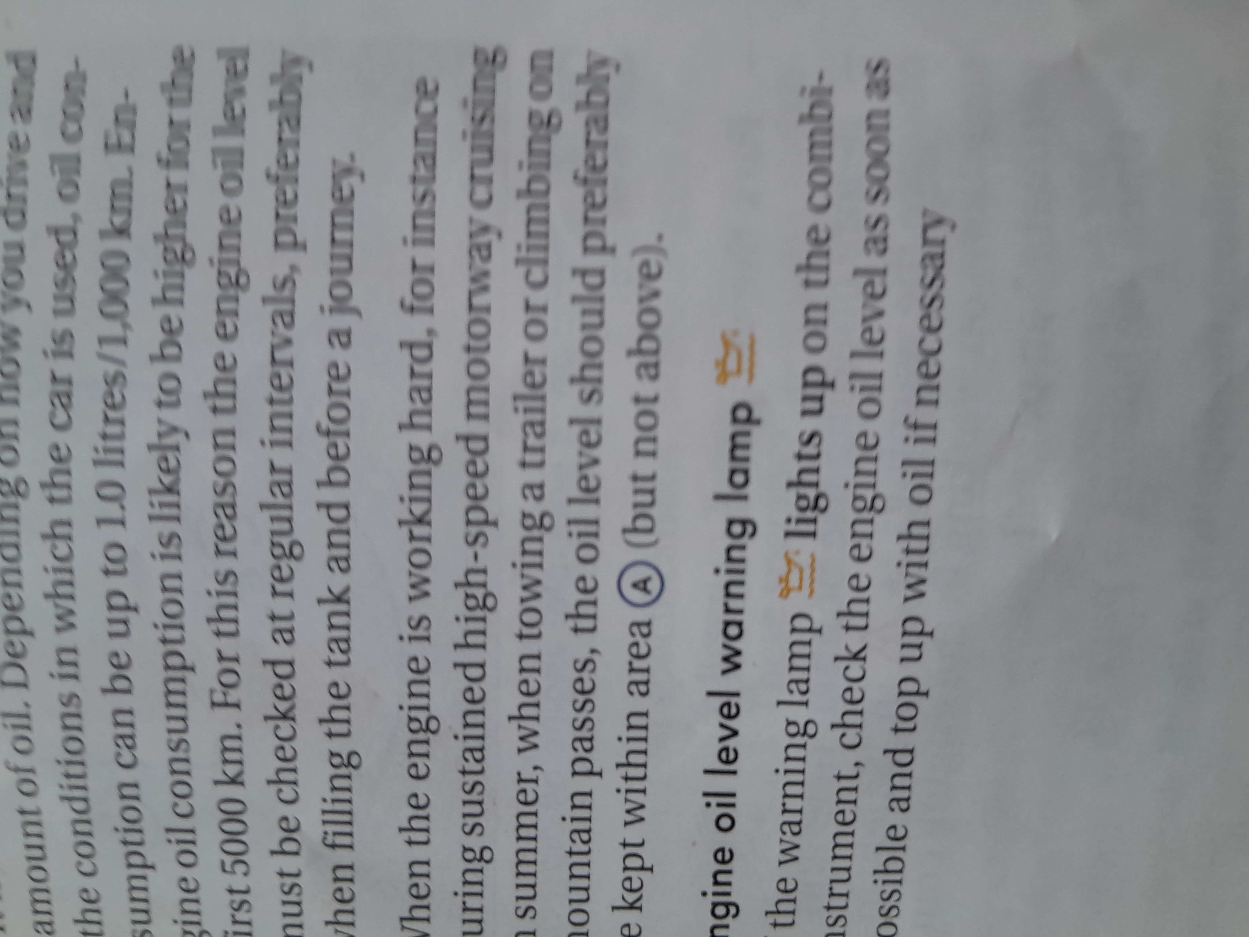

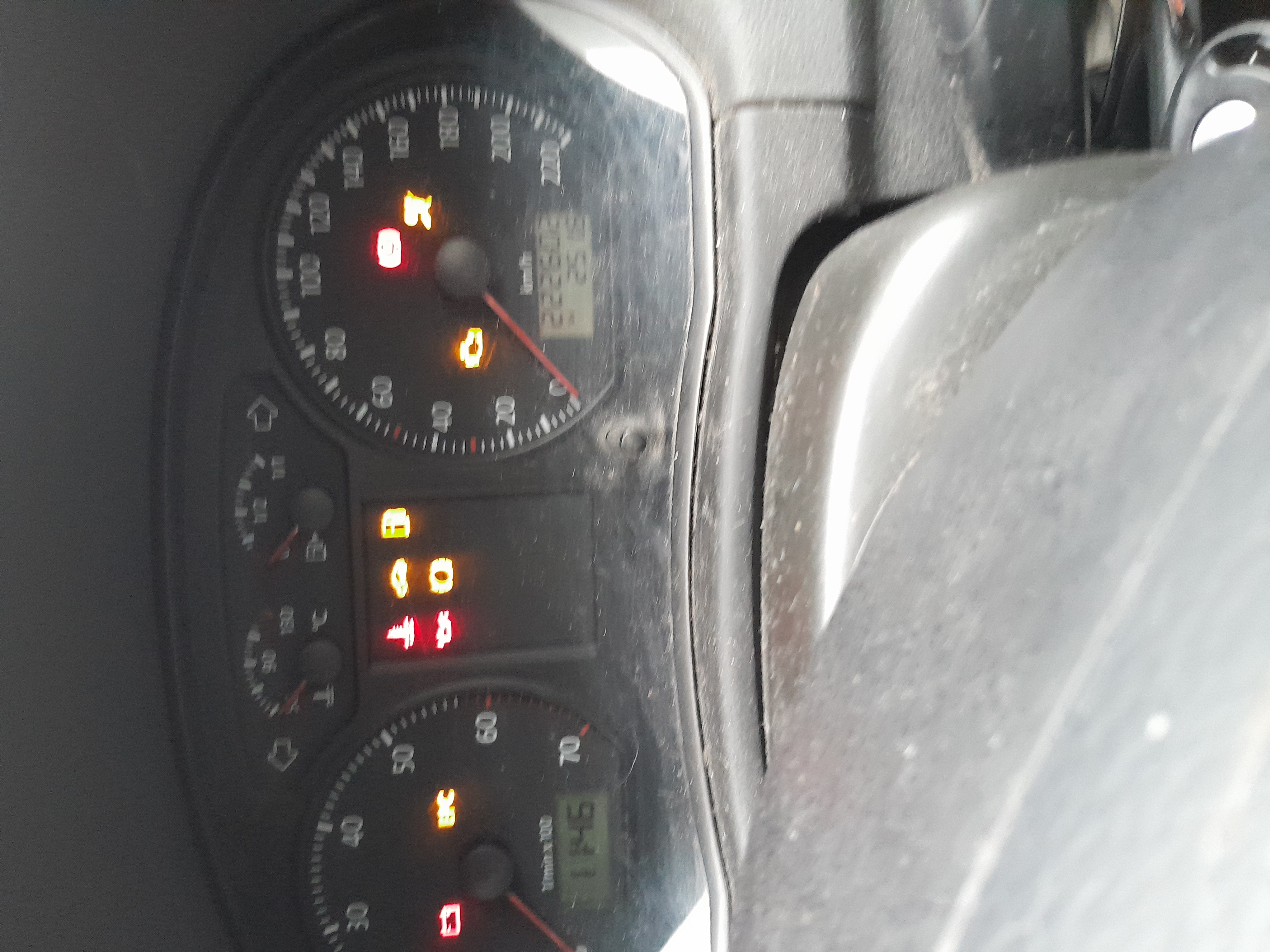

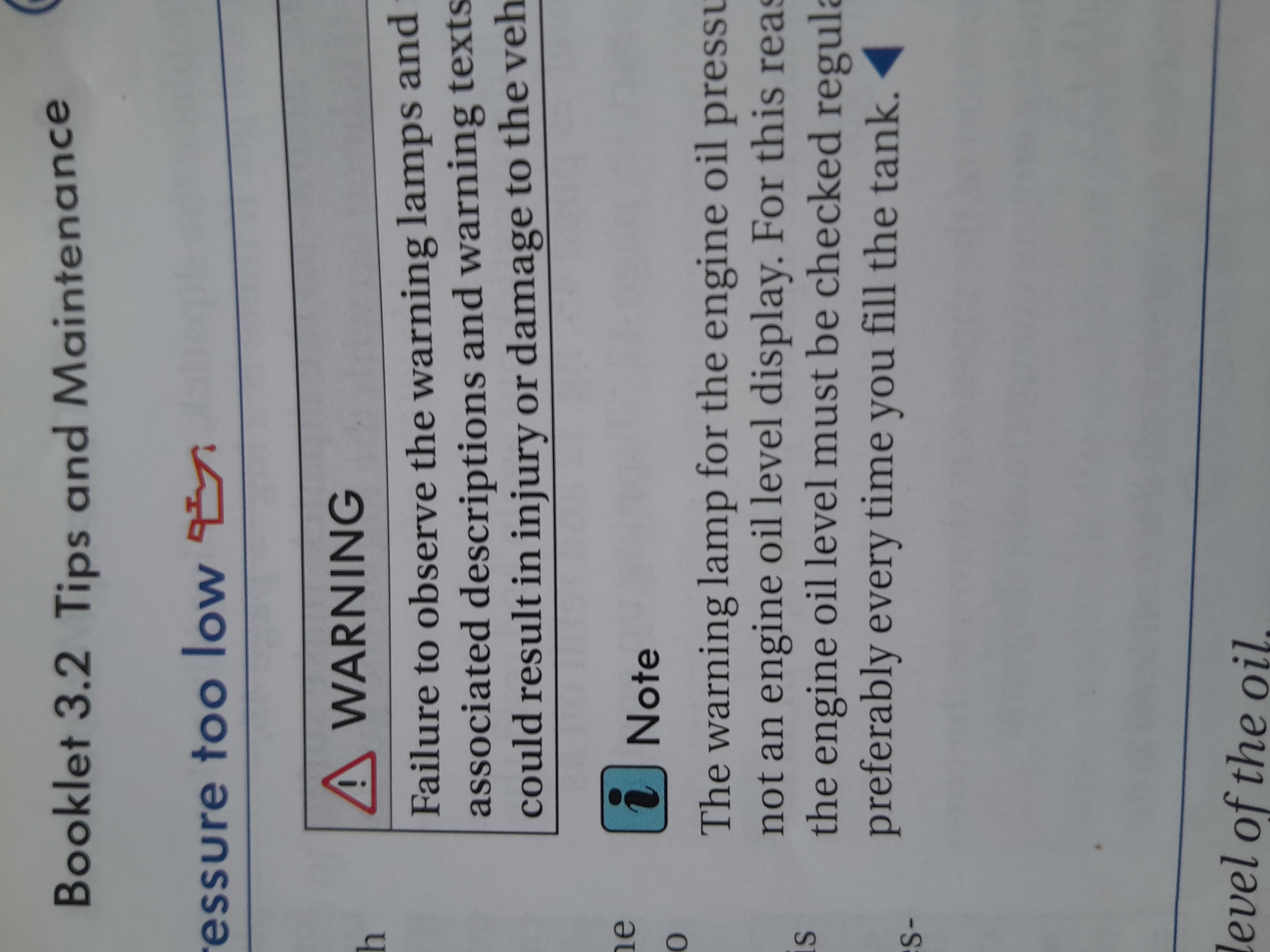

There is a 2005 1.2 Petrol BMD engine in my family from new and it has a oil level monitor because the level did go quite low once and it illuminated yellow, cant remember if it was the same oil can symbol shown in the instrument panel, below but the maual shows a YELLOW underlined oil can symbol, for low level, I would think that if its not RED then you don't have a pressure problem, also, if the oil pressure is really low then its inhibited until the engine revs reach smething like 1600/2000 RPM, a feature of all the VWs that I've owned since 2005.You can probably check it by pulling off the wiring harness from the pressure switch, start the car and increase the revs until the warning light illuminates.

Hey thanks for replying …
Actually yes I totally agree with what you’re saying - I think I’ve gone off on a pressure tangent when as you say orange light is indeed level.
I guess this still leaves me confused ..
My level is spot on but more importantly I don’t have a level sensor at all on this engine - so where would this signal be coming from ?
Is this the natural behaviour for a Bmd engine “without level sensors “ ?

I will check it out when I next see that Polo, the attachments are from its hand book but its possible I'm mixing up the alarm from a year 2000 Bora that has only departed the scene recently.

Couldn't see anything like a level sensor so must have been the Bora but I was fairly sure it was on this Polo, I'll be changing the oil/filter at the end of the year so will check for any warning light when oil is removed.

Polo 9N3 has a level sensor for sure!
