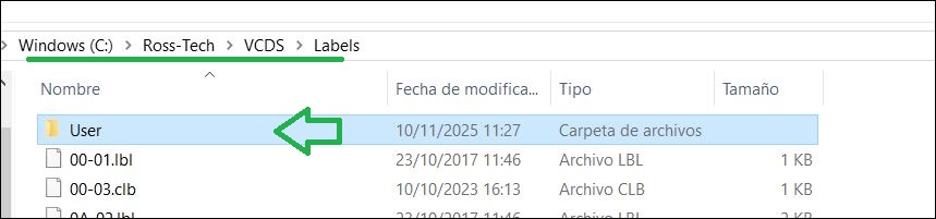

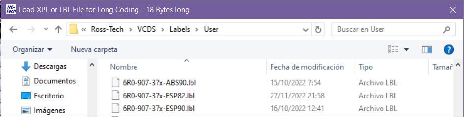

However, if you have VCDS, you might be able to generate your own ABS coding if you read this thread on the Drive2.ru forum, especially where it says, IMPORTANT INFORMATION! = ПОЛЕЗНО ЗНАТЬ! and download the ABS.zip file. Following the instructions, you should then move the labels to the 'user' labels folder in your vcds program.

Extract the zip file, place the labels inside this folder...

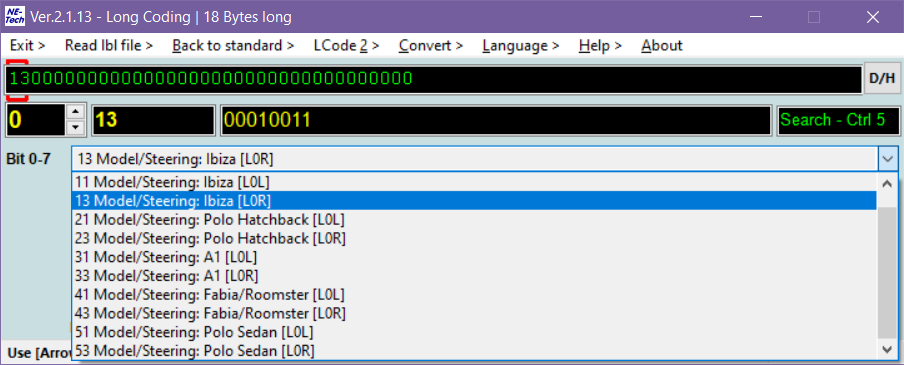

Copy the 0s coding, open Ne-tech (ross-tech app - inside ross-tech program), paste the 0s coding (pasted by default*), click Read lbl file (2), select your ABS system (1) and begin coding your ABS system (2) according to your vehicle's specifications.
1
2
Copy the result of your evil wizard spells and test it.
You can also code it directly, but it's better to create the spell first and then paste it when encoding via the OBD2 port, this way you will prevent the power (battery) of your magic wand from running out.
