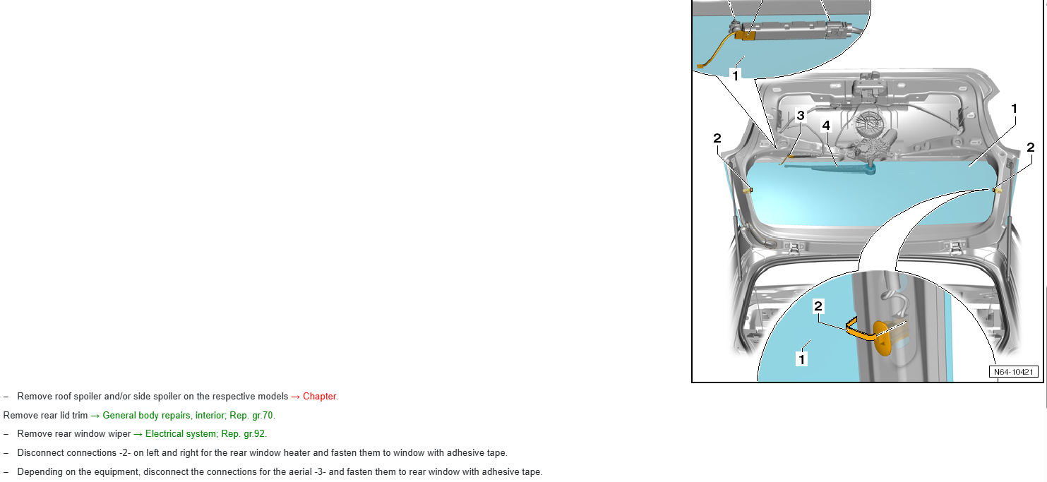

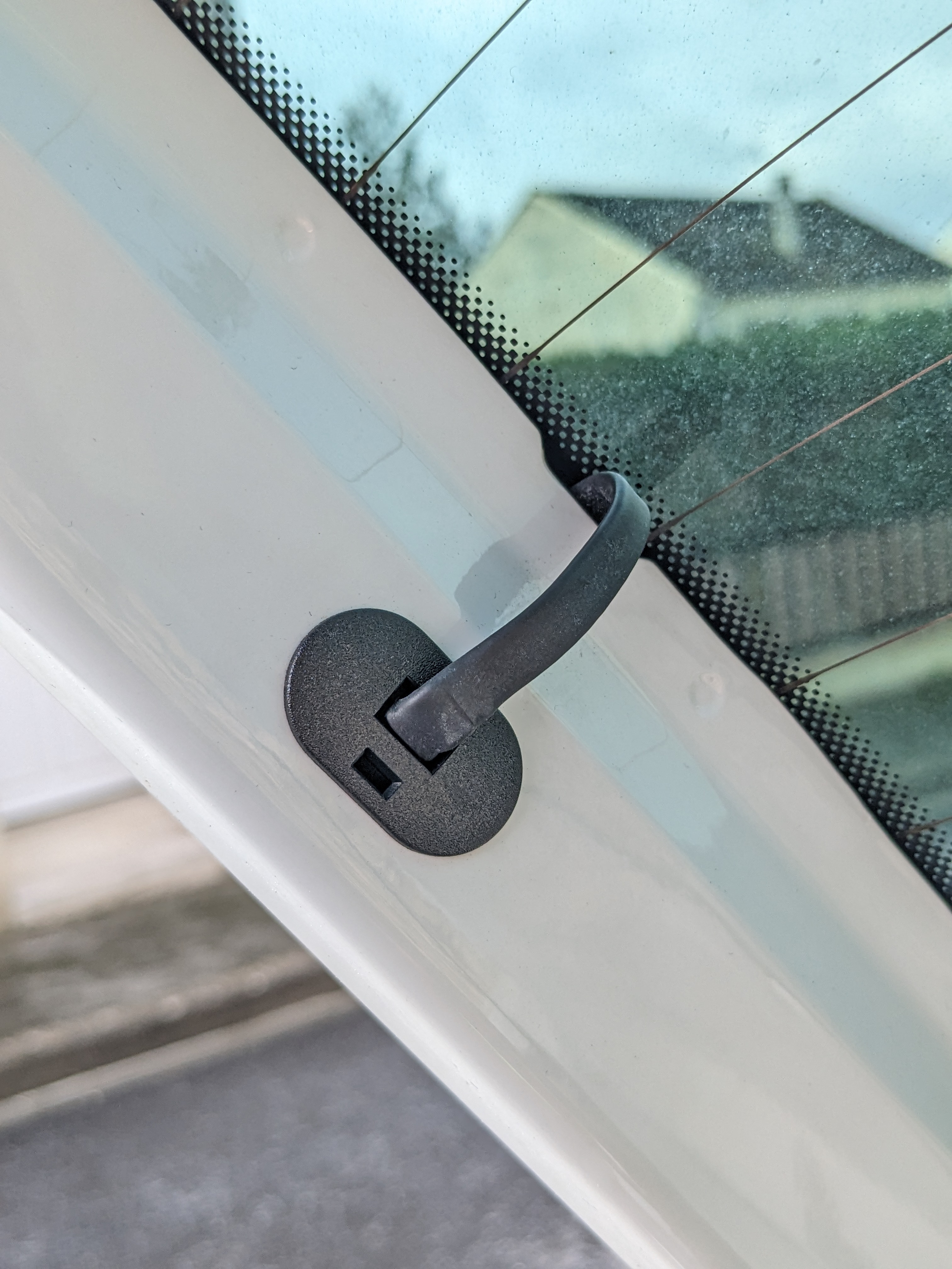

Thank you for all the details :D

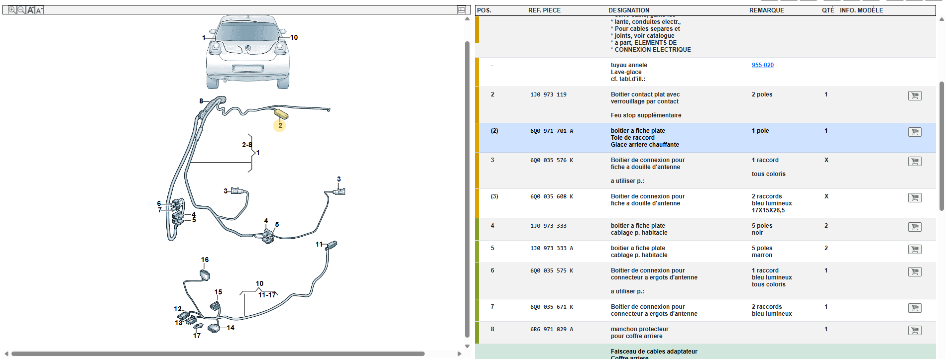

For the window defroster, I have to investigate more as I don't know how they manage the cabe harness for the tabs.
Capture d’écran 2026-02-19 231542.png (211.96 KiB) Viewed 9056 times
According to ELSA, they just said "disconnect".
EDIT:
Okey now I understand:
I will pain in the ass to handle the connector (yellow part on the schematic) to stay in place.
Le_Combattant

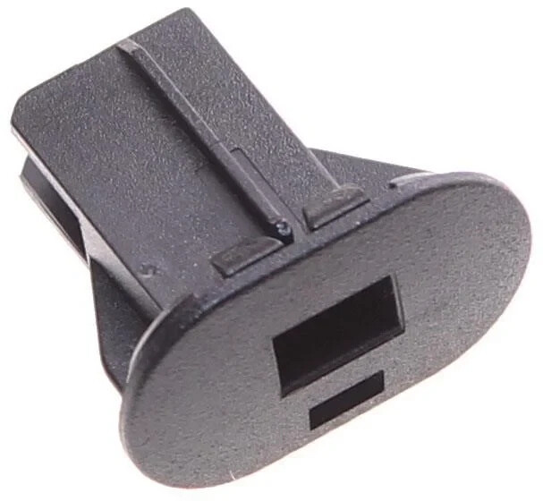

So here is a focus of my power supply line for the rear defrost window:
So according to the manual, I just have to pull.
But how to remove the connector from the black support behind ?
Here is the black part (6Q0971701A):
*Item 2*
Capture d’écran 2026-02-20 204601.png (174.83 KiB) Viewed 8982 times
So it's seems, this cable is engaged (holded ?) by the black part ?
6C6971145A-VW-POLO-V-5-LIFT-WIAZKA-INSTALACJA-KLAPY-BAGAZNIKA-Numer-katalogowy-czesci-6C6971145A.jpg
6C6971145A-VW-POLO-V-5-LIFT-WIAZKA-INSTALACJA-KLAPY-BAGAZNIKA-Numer-katalogowy-czesci-6C6971145A.jpg (97.26 KiB) Viewed 8982 times
So the back part also need to came out ? For me yes, otherwise it will be hell to remove/install the new cable.
Sorry for all the question, but I'm in the fog now :mrgreen:

Re: Polo 6C: wire harness damaged (boot)
Its easy to remove the black plastic part from the trunk.
Use a flat head and insert in the slot.
Then you need to unconnect the harness from the black plastic part and from the defroster line tab
But the connector can grip the strip pretty hard on the flat defroster wire. use a screwdriver to assist it
Its easy to remove the harness part from the black connector.
When you pull the harness,
that cable that branches for the defroster will easily align near the hole.
