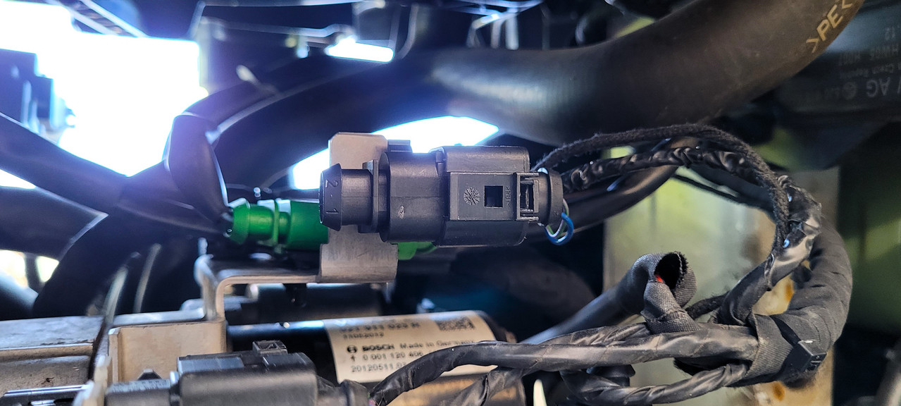

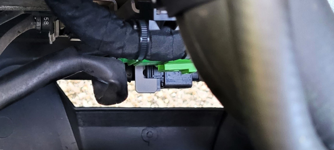

Refurbished 140A LIN Alternator Installed. Green T4 connector repinned.
-Alternator installation according to erWin.
Highlights.
There is no need to remove the coolant fan at all (another urban legend or something from inexperienced people/workshops).🤷‍♂️
Read previous post.
:arrow: viewtopic.php?p=610278#p610278

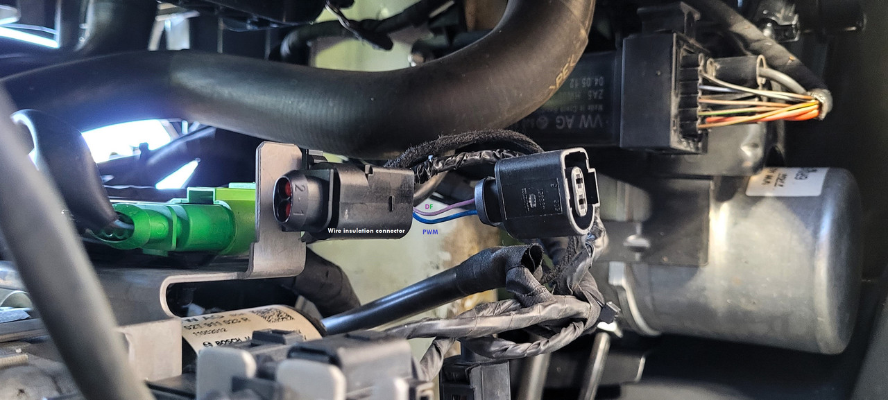

-Repinned Green T4 connector. LIN.
The insulation of the old PWM and DF signals/wires/terminals is temporary during testing; it will be improved later (insulation T2 connector).

Fortunately, everything worked smoothly on the first engine start.
Due to the lack of a fuse for the BM (SC6 5A) and the general coding, the 'new' 140A LIN Alternator is in 'protection mode', supplying only 13.3V according to the cabin voltmeter.🤸‍♂️

Battery monitor 6C0915181D with HW10 SW9070.
Update to the previous post.
After returning the one I bought from the AliExpress store and receiving a quick refund after providing the required evidence (scan), I bought a 6C0915181D battery monitor from a local auto salvage yard.
I cleaned it, but I also had to polish it to remove the typical corrosion (dark stains) and sulfation from the donor car battery (SK Fabia, I don't know which one 😄).
I did it with a mini polisher, sponge, and a little fine cutting compound. Naturally, the protective electroplating (galvanizing) wore off in some small spots, so it's highly likely I'll repaint it with spray paint (primer, color, lacquer).
However, I'm not too bothered about protecting it, it is easily solvable, and besides, I like the mirror finish... 😅
It works just as well as the previously tested Battery Monitors (7E0K and 6C0B). 💎
Due to their good performance, I do not have sufficient capabilities to make a comparison between them.🤷‍♂️

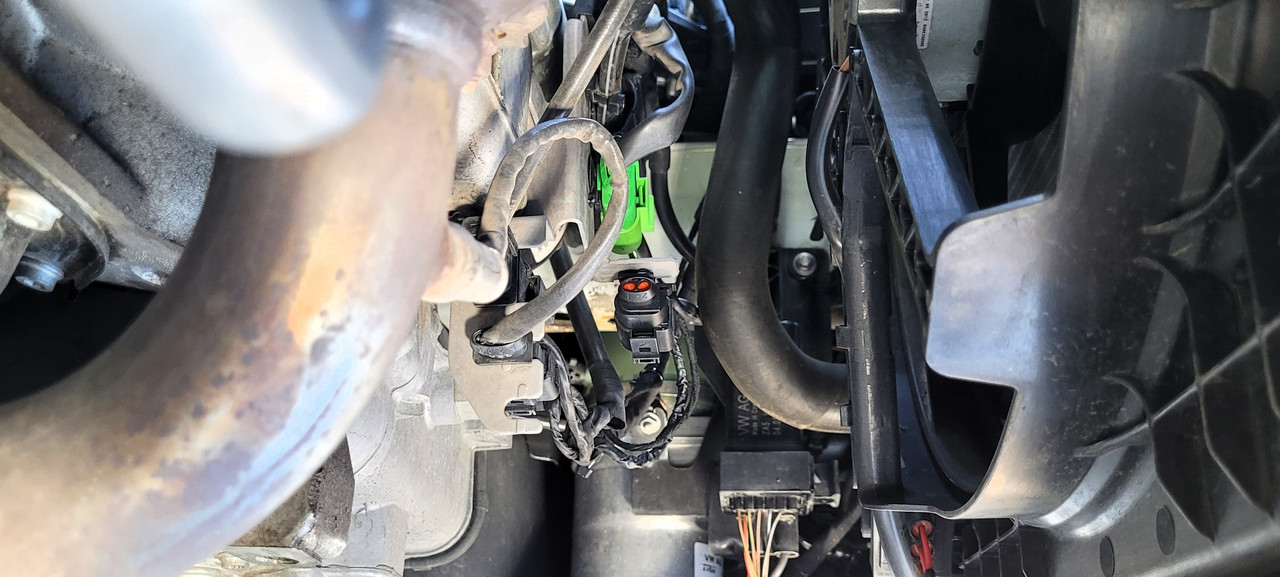

Re: ciclo's Polo. R-line 1.2 TSI 90hp 119gr.🤝
T2 connector for insulating the wires of the old alternator. PWM, DF.
Since installing the fuel filter didn't take long, I took the opportunity to do something else...
Wire insulation connector:
Related: :arrow: viewtopic.php?p=610292#p610292
For quick leak inspection during the next 100,000km.😊
