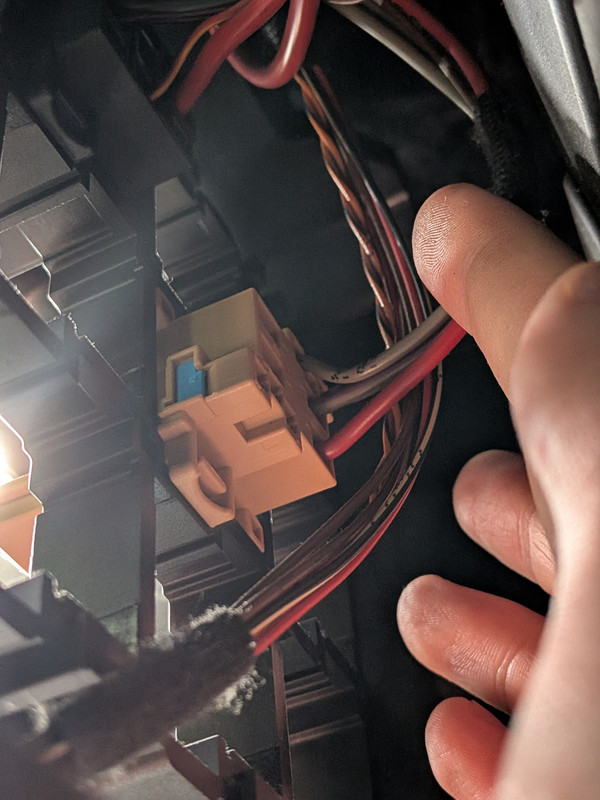

I received the tool (Laser Terminal Tool 3932). I've unlocked the blue clip from the relay connector (see image below) and I tried during 1 hour to pull this f*****g wire but it doesn't want to come. Can I cut it and use a Wago 221 to connect it to the cable going to pin 7 of the light switch connector ?
EDIT : I may have found the issue. The Laser Terminal Tool 3932 should have a 2.8 mm inner diameter and a 4 mm outer diameter. I measured mine with a caliper and it has a 3.6 mm inner diameter and a 5 mm outer diameter. They put the wrong tool in the packaging. I don't want to order a new tool, so my previous question still stands.

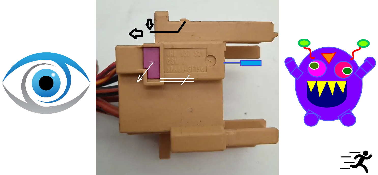

Posts: 8941
Re: 6c headlights onto 6r ?
There is another locking mechanism—pink/violet in color—located on the side where the wires and relay are found. You simply need to remove the brown relay connector from the relay carrier, pull the locking mechanism out by about 1.5 mm, and extract the gray wire terminal, and the rest of the process is relatively easy. Good luck!
