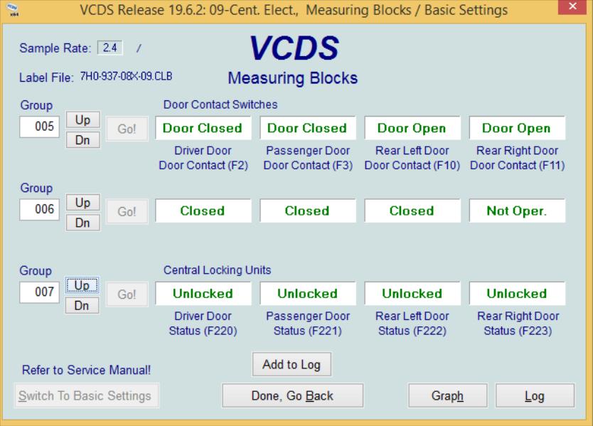

1. Radio - cannot be reached because i have android from aliexpress, it has some VAG module but VCDS show error, i remove it from CAN gateway installarion list
2. ABS error - i think it's because acu is low (11.8V), it's charging right now
3. 00329 - Control Circuit for Unlocking Rear Lid - this error is permanent
4. Sliding doors, there is no error, when doors are open vsds says closed, when i close them vcds says open (like on the picture)

thx ciclo error 00329 vanish, new coding was accepted
something also changed with interior lights and sliding doors:
- all door close and unlock, instruments doesn't show that they are open also radio confirm that they are closed, but when i start engine interior lights are still enable :?
- when i open sliding doors radio confirm this fact
- when i stop engine, get off the car and lock by pilot interior lights turn off
- and 2 errors arrived, they are Intermittent but return

What exactly I made today:
Unplug acu -> wait a 2-3 minutes -> plug it back -> auto scan -> remove errors -> auto scan -> open and close sliding doors -> read errors -> run engine -> check errors -> enable lights -> disable lights > check errors
Production date: 2010-01-12
I have interior lights on front like this https://bt-cars.pl/223404-large_default ... 105-c-.jpg but i assume this isn’t what you asking for?
This is basic, naked transporter 😕 i changed switch lever, add 3 wires to instruments and active mfd. changed light switch (from AliExpress with internal light sensor) but drl wasn’t started so I left it. Right now I changed bcm to install ccs but I stuck with mentioned earlier problems. No more changes in wiring

Well, it is highly likely (but not 100%) that the problem is in the BCM coding regarding the "model" of lock installed for the central locking of the tailgate.
I think the lock is not sending the correct signal to the central locking and that is why the interior light stays on in the conditions where it should go off.
The Bytes involved are Byte2 (Bit3 and Bit5) and Byte7 (Bit4 and Bit5).
;LC,02,3,Zentralverriegelung/Heckklappe: ZV-Regler in eine Richtung verbaut
;LC,02,5,Zentralverriegelung/Heckklappe: Schloss mit vorheriger Verriegelung verbaut
;;LC,07,4,Heckklappenschloss mit Safe
;;LC,07,5,Motor fur Zentralverriegelung Heckklappe NICHT verbaut
It is impossible for me to know what type of central locking lock your T5 has installed for the tailgate, so you will have to try all possible combinations of said Bytes until the interior light does not stay on under normal conditions.
Start by testing this new BCM coding:
A8A0393A0E212013002008103C2B8C500000430F60060000300000000000
to know what new faults appear...
The fault diagnosed in the Gateway will disappear once the BCM coding is correct.

Is there any chance to get somehow original coding of bcm 086?
A8A020380E212023002000103C2B0C500000430F60060000300000000000
this was latest coding from you, earlier i paste you auto scan without errors... after night errors from sliding doors return.
I spent some time testing the encodings today, i tried to disable almost all function... currently waiting for the battery to recharge,
