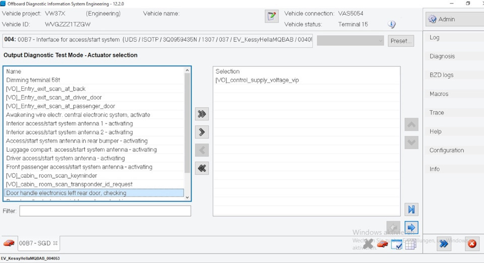

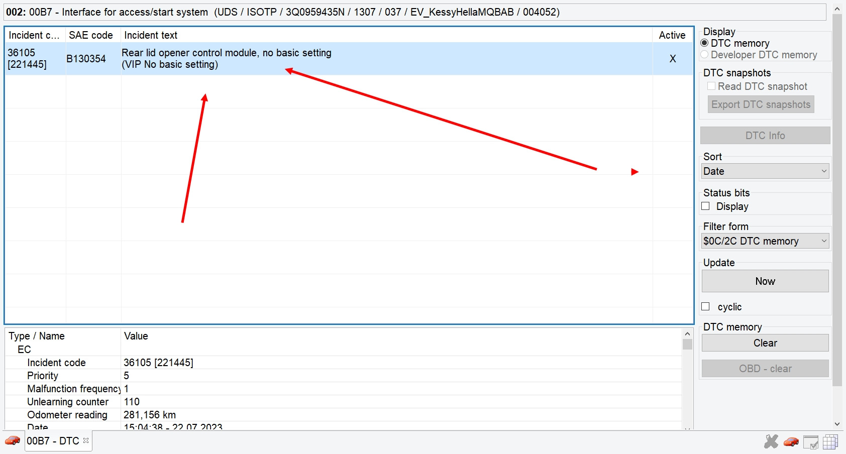

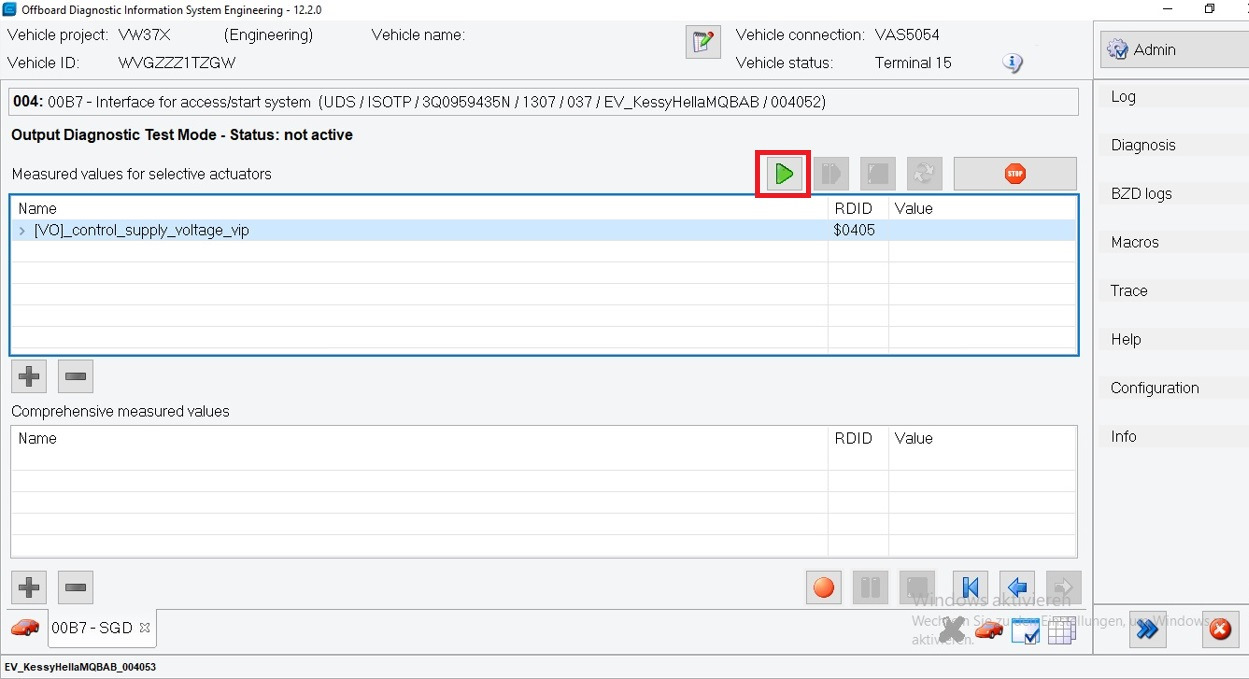

Re: iichels VW Passat 2.0 TSI DSG 4-Motion 2017
If you set you will have a VIP error.

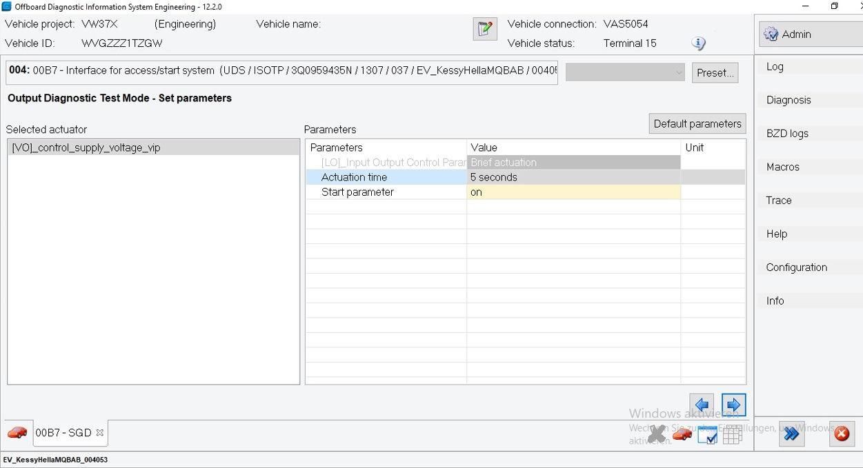

TEST VIP

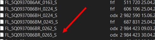

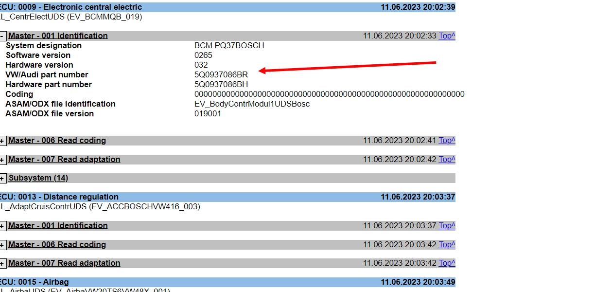

I am reviewing your scan, at my place is BCM BR, I did the upgrade from BH to BR. Did you do the AID update to 3G0920791D or did you buy the car with the meter updated? Does the view button on the steering wheel work for you? Because at my place it doesn't work, and I have AID 3G0920791C

I have BCM 5Q0 937 084 EC and 5Q0 937 084B ready for upgrade. The most recent flash file I can find for 5q0937086x is BM so I didn't update that one.
