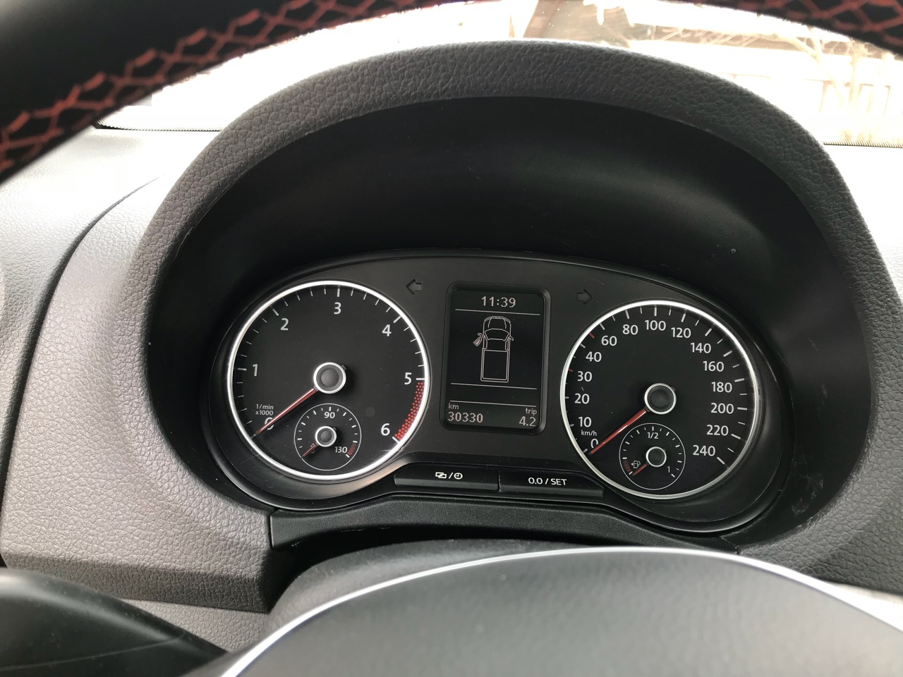

Looks brilliant with the new cluster

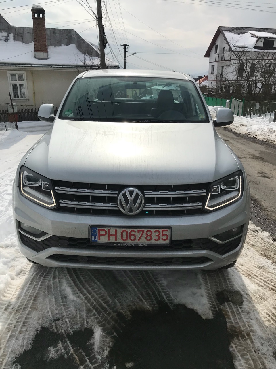

Re: Amarok Oem Bixenon retrofit
The CCS is working. No problem with it.

- Posts: 6689
I believe this was the solution.georgenis wrote: Wed Feb 28, 2018 7:09 am He told me that he put the Bcm on other Amarok with xenon headlights from factory and made with ODIS a lights parameteres configuration, and then put the Bcm back in my car.
This also can be made with Vag commander.
When I arrive home I will post also the coding, but he told me is the same.
