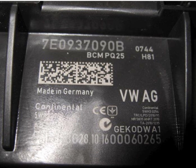

One more question, I hope You don't mind: any 7H0937090D BCM will work (from whatever car is,T5, T6, Amarok,...)?
Re: Amarok Oem Bixenon retrofit
No will not work
Posts: 8982
There are some 7H0937090D BCMs that will work for your bixenon headlights. The donor car has to be an Amarok or T5 with factory bixenon headlights.

So I will buy 7H0937090D Z4R with Pr codes 8K0,8K1,7L3,8IH and 9PR,9AD. This BCM should work with my light system and Bixenon with led, and also Climatic? It is not so expensive new.
Posts: 8982
It is no longer available, it has been replaced by a 7E0 BCM.
But for a similar price, why not buy the best one?
