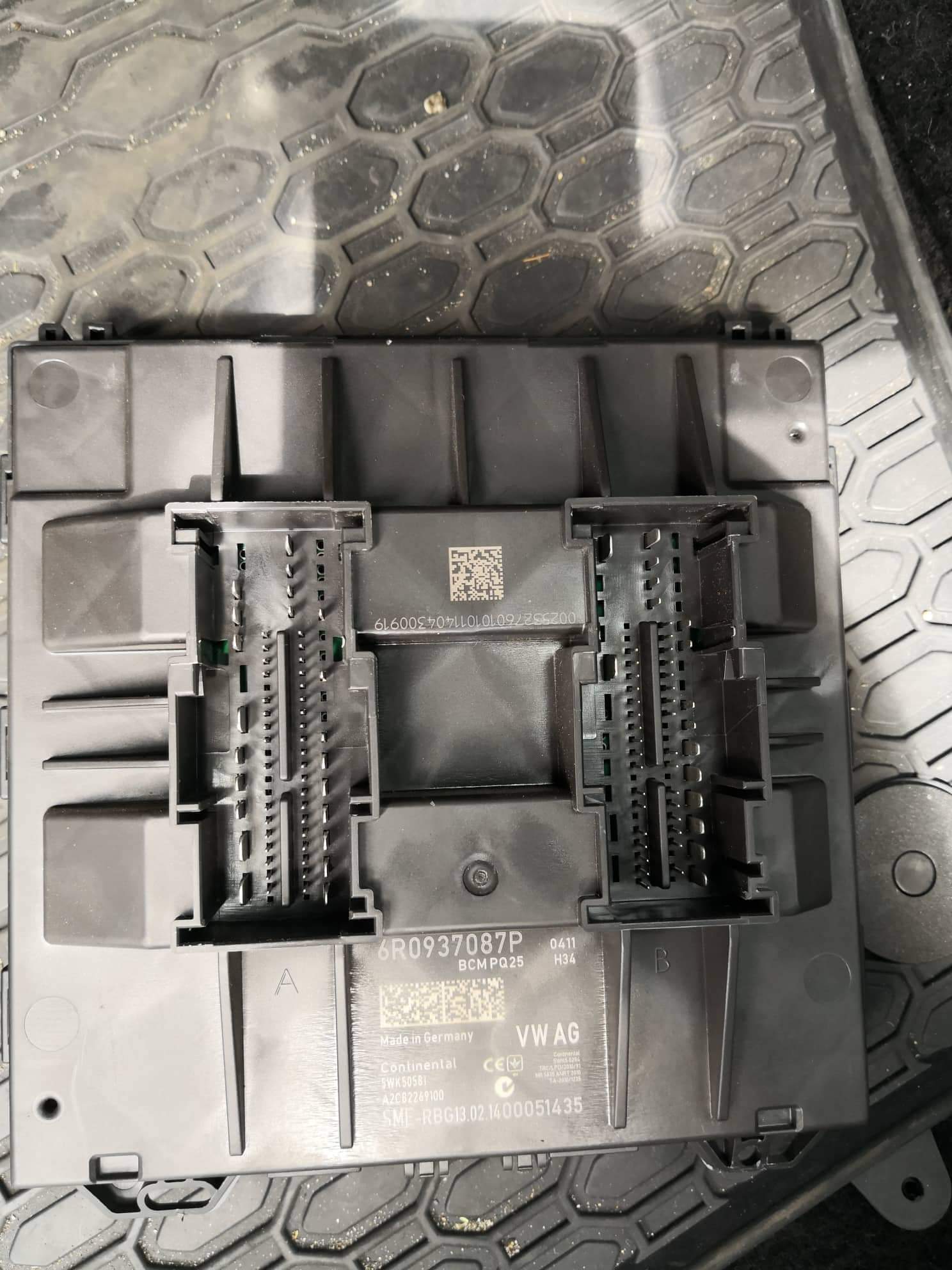

Hi guys, I have this BCM 6r0937087P which kind of MFSW is better adattable?
Re: mfsw on polo 6r
you can fit any mfsw you like
but on the MQB wheels (5Q0... 6C0...) the button illumination will not work.

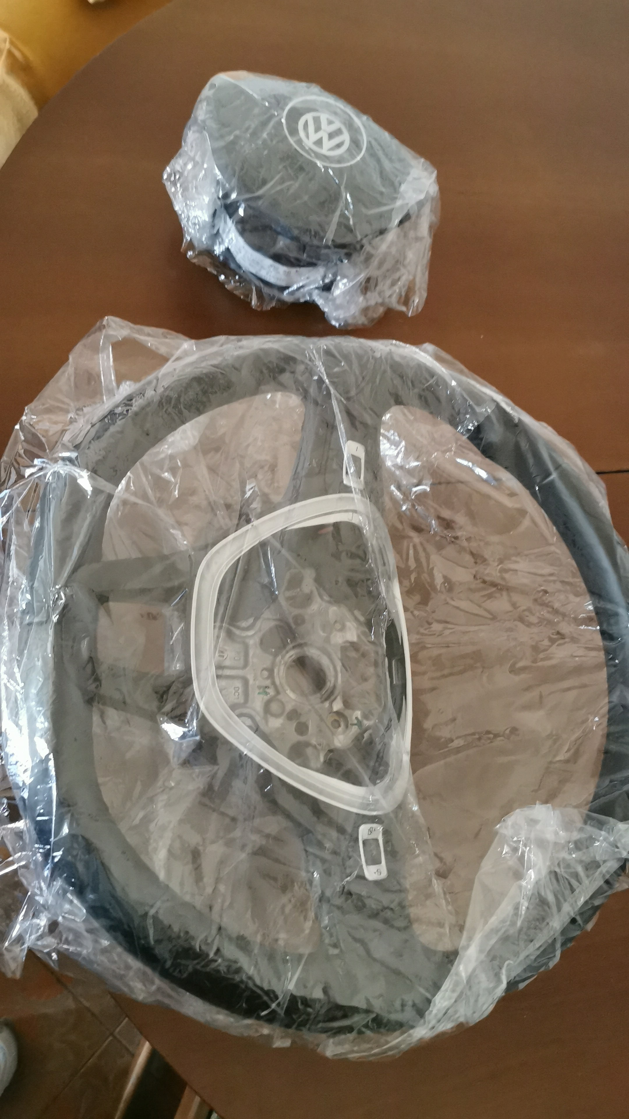

Hi guys, finally I found the MFSW for mi polo 6r. It is the normal steering wheel of the polo 6c. Could you please help me to fit it? An other answer: this MFSW was from a vw Passat, can it be fixed on polo? Thanks

Hi guys. Finally I found the MFSW for my polo 6r, I have some answer to ask. The MFSW was installed on a vw Passat. Is It the same of the polo 6c? How can I install it without any problem? I have also the cruise control and I would like to put it on the botton of the WHEEL. I will send also the pictures of it and of my bcm. Thanks to everyone, hopefully that you answer me.
Re: mfsw on polo 6r
No it's not the same wheel, I think it might have white lights and not red lights like on Polo 6C.
