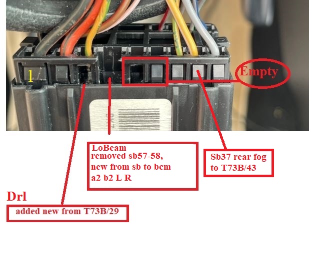

from there, part of the wire go to bcm and rest to new T10 connector of new autoswitch and T40?

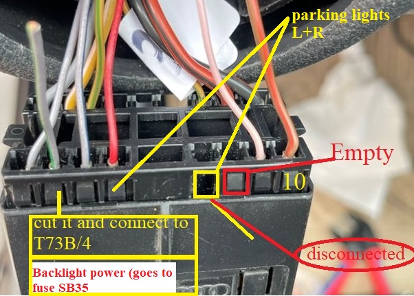

Yes, exactly, You can re-use some wires as they are the same regardless of what BCM is installed.
Other wires need to be re-routed to the BCM and from BCM to external lights/fuse box.

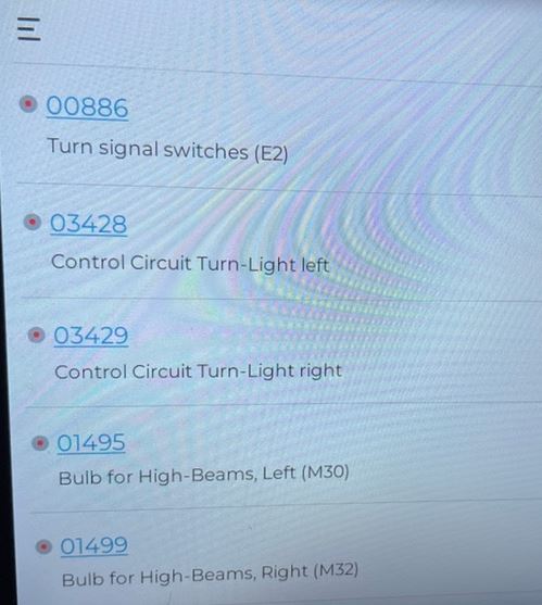

3 Bugs found:
00886 - Turn signal switch (E2)
008 - Invalid signal
Saved freeze frame:
Fault status: 01101000
01495 - Left High Beam Lamp (M30)
010 - Open circuit or short to positive
Saved freeze frame:
Fault status: 01101010
01499 - Right high beam lamp (M32)
Saved freeze frame:

after some manipulation today i forgot make vcds scan but i have from carista. there no difference in fault light code anyway

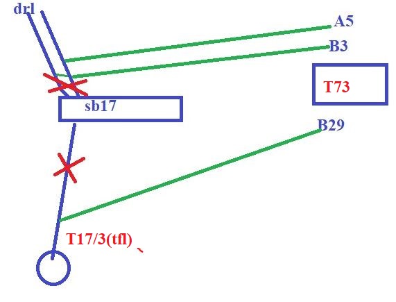

just for test The pin from T73B/29 that come to T17/3 i remove it from socket , and drl stil working

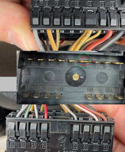

-According to the pictures of the T17 light switch connector, wires 13 and 14 should not be there.

i post 2 pic t17 after evolution
I am not sure if i need cut T17/14 or reconnect other side to T73A/45 or it already connected?

- Once I've reviewed the diagrams from your link, wires T17/13 and 14 should stay where they are from factory, ... the Rapid's xenon headlights are somewhat simpler than those of the 6R.

Ok i add T17/13 back.

Apart from the signal from the light switch to the BCM T73b/29 for DRL, have you installed two 'NEW' wires from the BCM to the xenon headlights?
Re: Polo 6r GTI - Bi-Xenon installation Issues
BCM T73b/29 for DRL i connect it direct to T17/3.i try connect it to wire from SB17 but no difference.part from the signal from the light switch to the BCM T73b/29 for DRL
Yes 2 from Hibeam pin to L-A1,R-B1have you installed two 'NEW' wires from the BCM to the xenon headlights?
New BCM coding: (second test)
6C980F2000210400000808303F480CC00F404007600308C0060000024000
Drl same story,+no lo no hi beam at all. When I switch to lobeam it blink a bit and stop working
- Posts: 9037
Well, in that case (low and high wired from BCM to headlights), you should modify and install more wires in E4 for Low and High beam.
E4
Check your diagrams for clarification.
Regarding the DRL, the diagrams do not seem to be clear. There is no representation of an LED module that controls the DRLs and side/parking lights on the same LED strip. I haven't tweaked anything in the BCM coding for the DRLs yet, the BCM coding tests are to find out what's going on with your installation (low/high).
