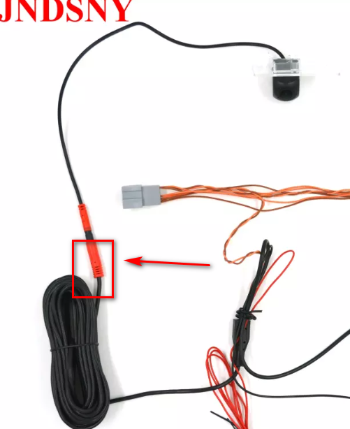

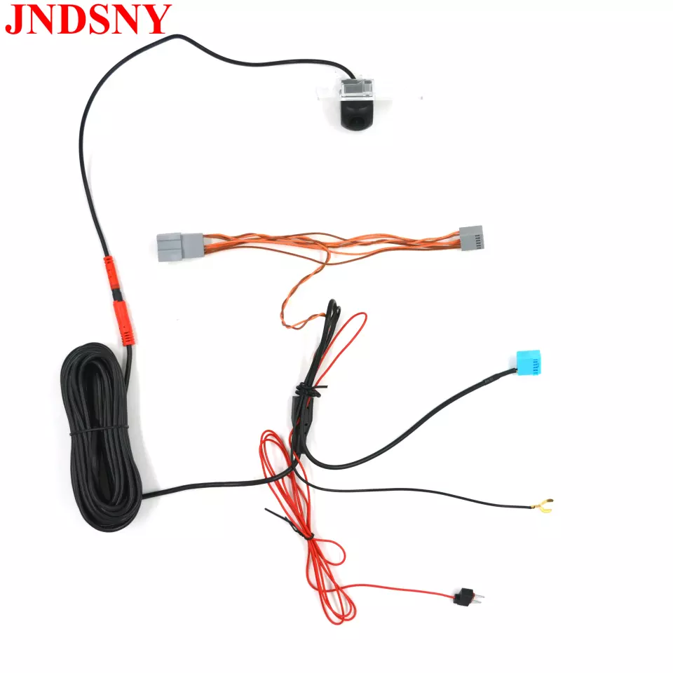

patil wrote: Mon Jan 04, 2021 3:24 pm Hello Damon/ Macro..
Can you post the pictures and wiring kit of the reverse camera you people are trying to install. I can't see the camera picture posted earlier.
Thanks.

@ iichel
I coded that I have Rear view camera, when i turn off byte 19 bit 4 then I will see the OPS.
This is the fault code.
1 Fault Found:
6720 - Rear View Camera
B1102 31 [009] - No Signal
Fault Status: 00000001
Fault Priority: 3
Fault Frequency: 1
Reset counter: 100
Mileage: 64470 km
Date: 2021.01.03
Time: 12:11:45
Voltage terminal 30: 11.1 V

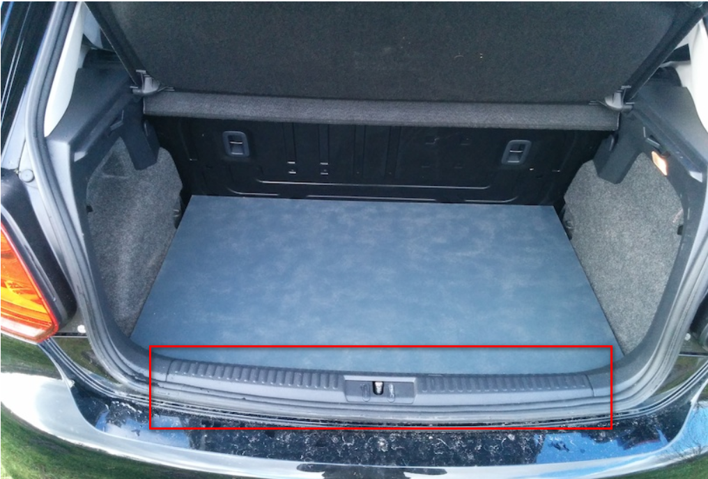

Damon wrote: Sun Dec 27, 2020 5:42 pm Okay got it working at front of car.
However I’ve put the bracket with the camera in the registration light but how do feed the cable off the camera into the boot from the bracket?
I push the cable through but can’t seee where it’s coming out?
Remove this
You will see a round rubber thing with wiring remove the rubber
Put a cable in the license plate light holder
You will see the cable is coming to the rubber whole, its little bit difficult but the cable is coming to the rubber whole
patil
Posts: 577
Re: Help fitting Reverse Camera with RCD330 - Canbus
Post by patil »
Thanks for the picture👍
Please do as I suggest and tell me the results.
1. Please feed the camera power with +30
2. Ground connect wherever you want, but I suggest you to connect ground in front eg.. steering column ground point.
3. Connect can high and can low to your quadlock can wires as iichel suggested.
4. Coding is not required for such type of cameras.
5. In address 10, select automatic in ops display.
This should set everything right.
Good luck👍

iichel wrote: Mon Jan 04, 2021 4:51 pm i guess you'll have to figure out why the radio isn't receiving a signal from the rvc
Yes iknow, I measured the cable up to the plug of the camera. There is coming power.
it is possible that i am not getting video through canbus cable?
Video is not transmitted through the canbus. It needs the canbus for the dynamic lines. The video is transmitted to the blue block of the quadlock.
