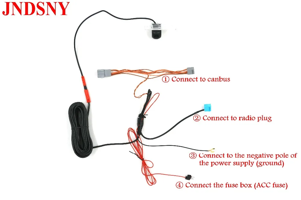

Have a reverse camera that I bought alongside my RCD330, which has dynamic lines.
Fitted RCD330 weeks ago fine.
Was trying to fit the camera today to my Polo 6R, but got stuck.
Diagram of parts from seller

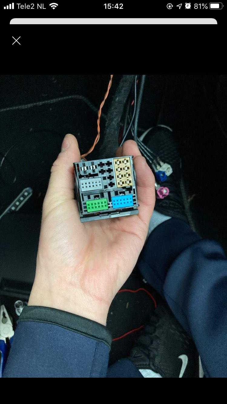

The bit im struggling on so far is the Canbus bit, where is the canbus located to connect those parts to?
Unless Im blind I cant see anything in the Quadlock to attach them too.

You'll have a orange/brown (can low) and orange/green (can high) wire in your quadlock. I think this is what you are looking for.

But what would I need to do remove those wires from the quad lock ?
Unsure how the two Can Low & High connectors shown in the diagram will fit into the quadlock , as there’s seemingly no space.
Unless I’m missing something obvious excuse my lack of knowledge
Posts: 6693
Re: Help fitting Reverse Camera with RCD330 - Canbus
You'll have to connect them to the existing wiring (i.e. soldering, clamps, crimping).

Also what Fuse would you recommend connecting the camera too?
I believe it needs 12V

Looked at the fuse diagrams available on forum, still a bit confused.
I believe I should be looking for a ACC fuse that is only live once the ignition is on.
Any suggestions as to which fuse to use? Or would I need to tape into an existing?
According to the diagram fuse 8 - is used to control injector cylinders on cars up to March 2010. My car is September 2010 so not in use on my car, I assume this is controlled by ignition and can be used?

Question for anyone viewing:
Looking at diagram in original post.
If I use a fuse Tap can I just connect the reverse camera fuse directly into it instead of having to crimp? As it already has a fuse and blade connected to the wire.
Where as I see a lot of reverse camera sets usually only have the cable to crimp to tap.
Or would I need to cut the fuse off?
Also which fuse would I even connect it to unsure which is ACC

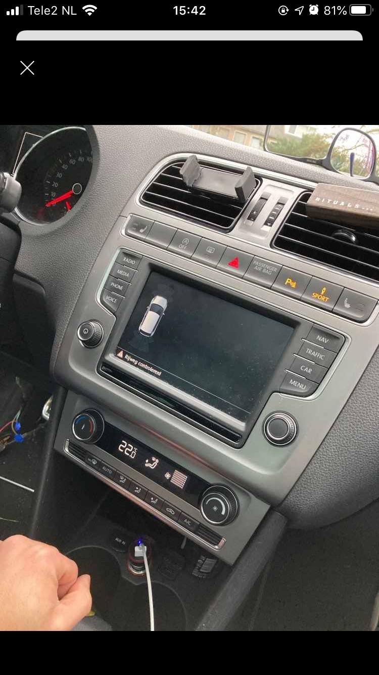

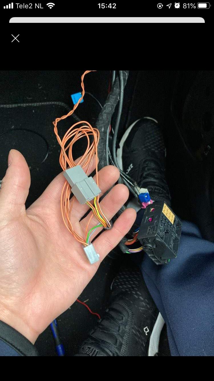

I have a problem with this camera, first i have a standard camera without dynamic line and I want to replace it with this camera.
Everything worked included the steering lines, but after a few KM the lines was gone en now I have a black screen and the it said Parkpilot is not available.
I install it on Disvocer media mib 2
Can anybody help?
Posts: 6693
is the camera compatible with the canbus of your Polo 6C? the first post was about the Polo 6R. if you disconnect the camera, does the OPS return? can you read any error codes from your car?
Mocro
Posts: 42
Joined: Sun Apr 26, 2020 10:08 am
Drives: Polo 6C 1.4TDI 105HP
Location: Netherlands
Post by Mocro »
Yes it is compatible, because first time I install this camera it worked. After a few KM of driving the lines was gone and now i have no screen.
Read it with VCDS i have the error No Communication'
Yes, if have I disconnect the camera the OPS will shown

Hello Damon/ Macro..
Can you post the pictures and wiring kit of the reverse camera you people are trying to install. I can't see the camera picture posted earlier.
Thanks.
Posts: 6693
Perhaps you need to code the OPS module to tell it that there is a camera pesent?
