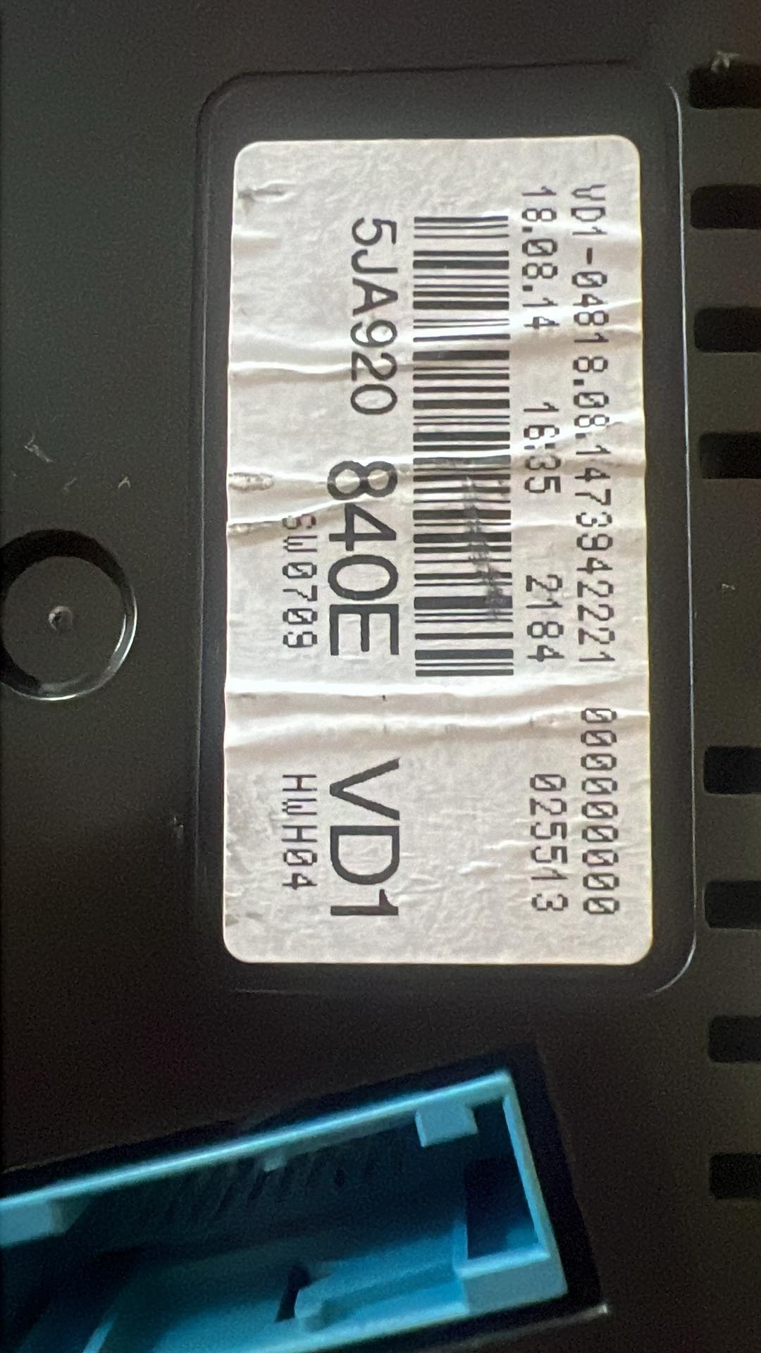

I have one from Rapid with these numbers: 5JA920840E

Probably from this car and such a counter sticker.
