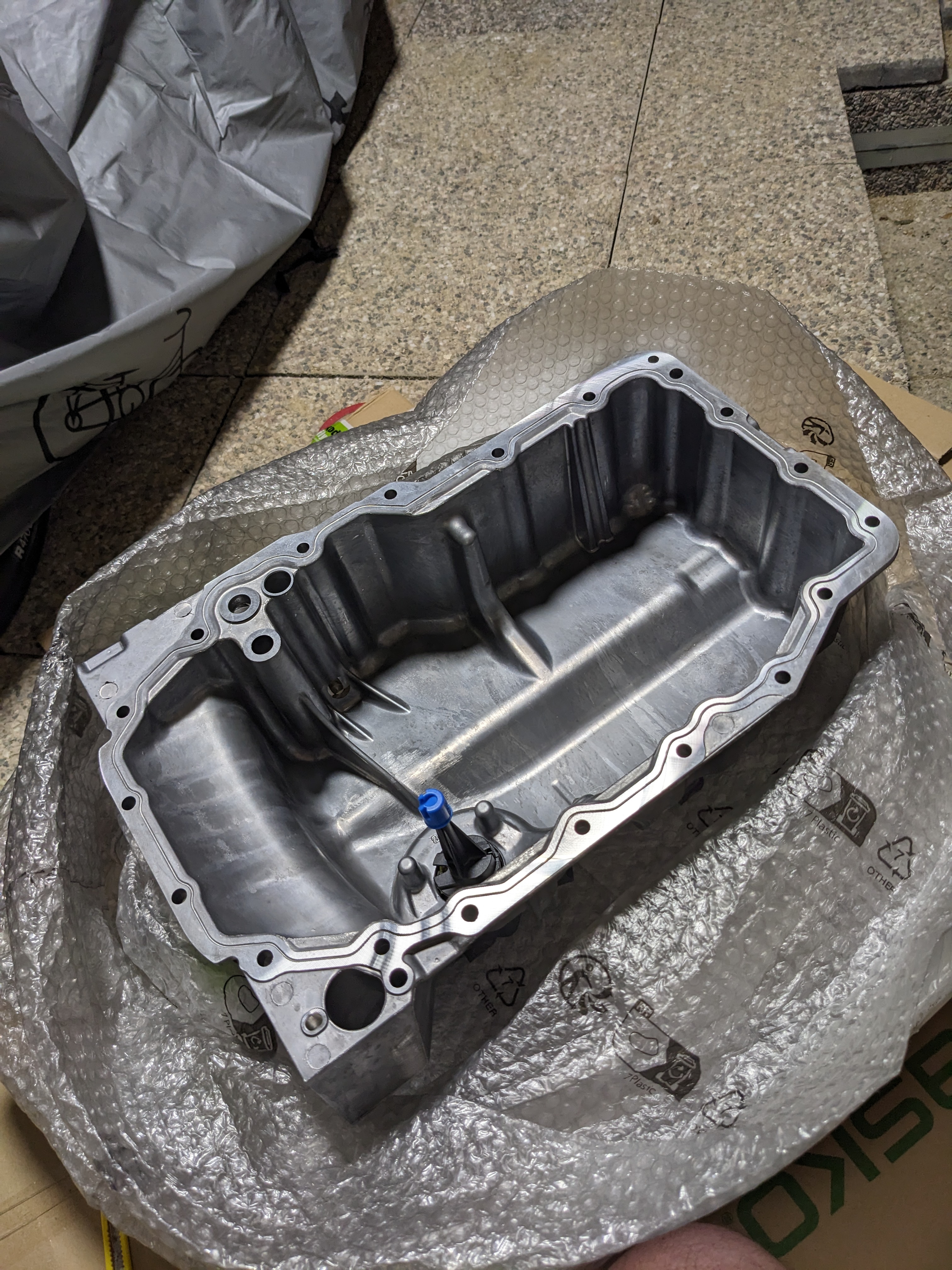

Hello all !

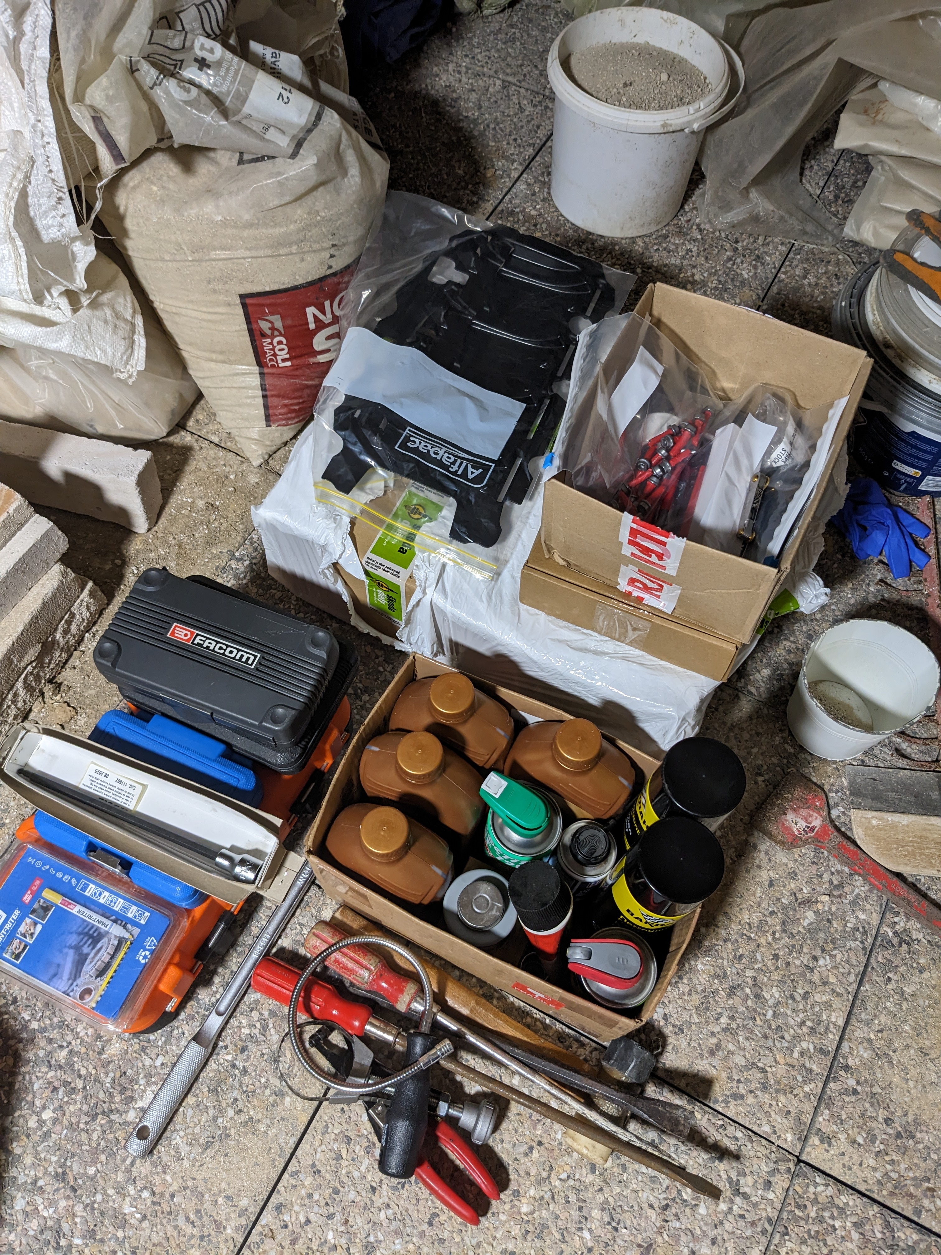

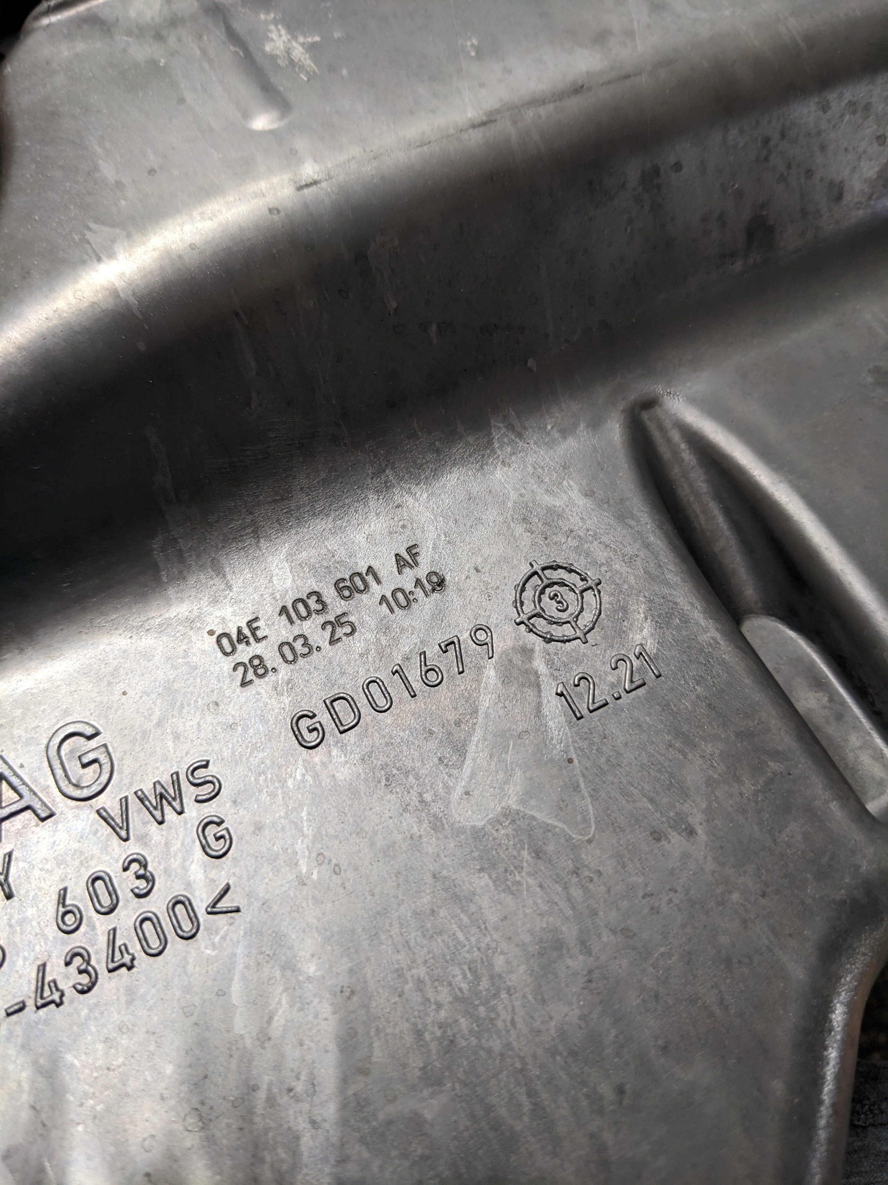

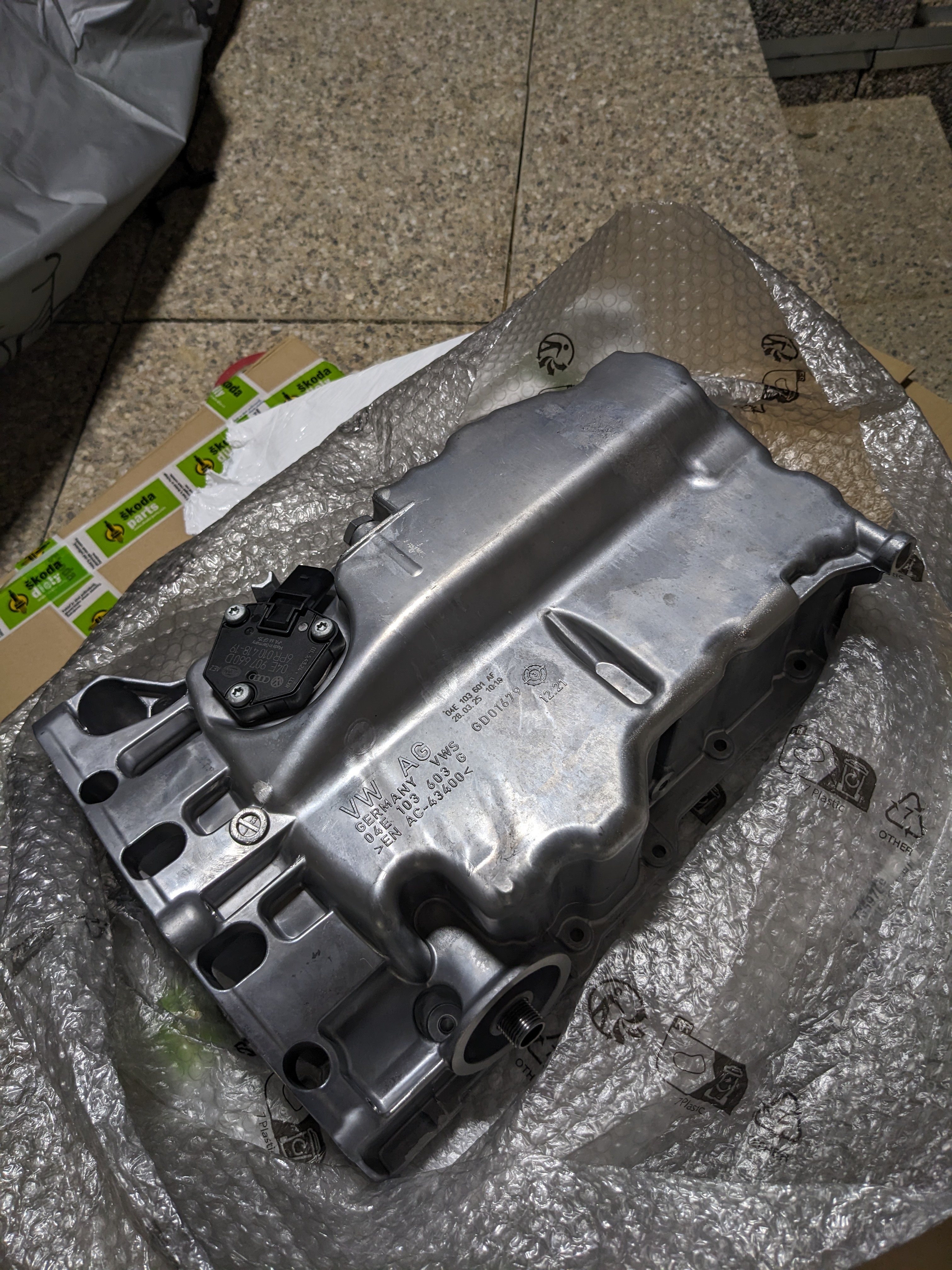

So good news, I just received my brand new oil pan !
I also ordered from my local dealer some parts/bolts:
Oil pan bolts: N90500605 x19 (+2: two will be converted into studs for guidance during installation).
Gearbox bolts: N10706901 x3
Air conditioning compressor bolt: N191204501 x3
Sealant: D176501A1

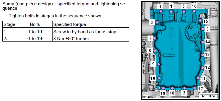

Adn documentation for the torquing sequence:

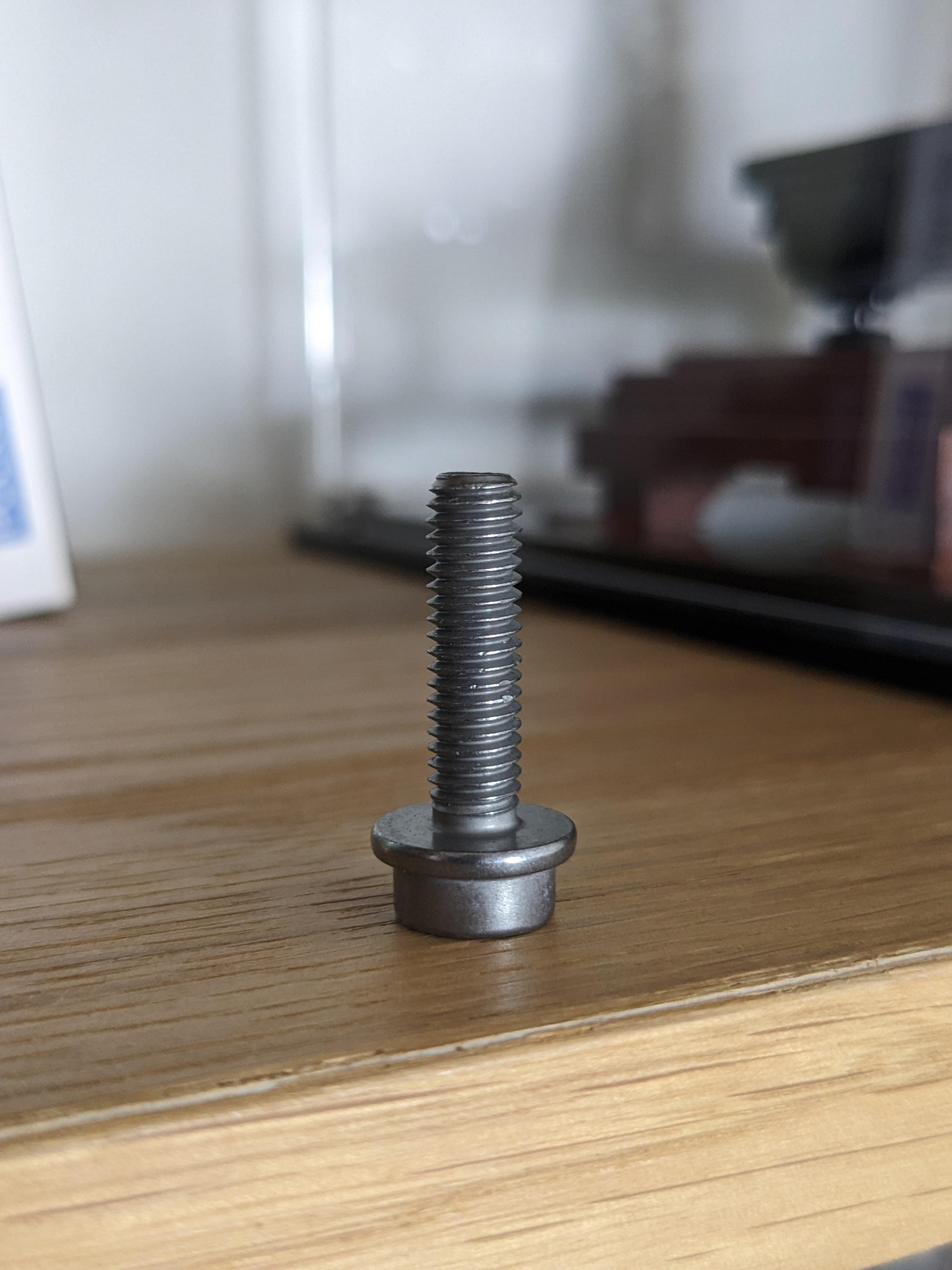

The things is about oil pans bolts (N90500605) I noticed some imperfection on the threads (even brand new) and because my engine block is made out of aluminium, I don't want to mess with it.
For, on some of them I used a tape and die set. I had some hard point on them (hand use only with WD40).
Then I received the lang tool 2584 kit, perfect for my situation. I used it on the last remaining bolts.
The thing is, those bolt will be torqued to 8NM + 90°. And tape and die set are much more aggressive than a thread chaser as it's primary function is to cut new threads.
Is there a possibility I messed up some threads by removing some materials ?
The only thing I fear is threads stripping.
Thank you for your help, and have a great day.

It is very annoying that new bolts from at least VW Group always seem to have slight damage on their threads when you receive them, even worse as you have said when it is a softer material that they are getting screwed into.
I have just replaced the front suspension on my old 2011 Audi S4, and when carrying out that job I needed to remove the drive shaft bolt, when I fitted the new bolt into the driveshaft it jammed, so I removed it and discovered there was slight damage on the thread - not good! So, I ordered in a split die to correct that, I wanted a split die so that I could open it up as much as my die holder would allow and that would stop me cutting any material from the "okay/good" sections of that bolt's thread - and that worked - I could run that die down the thread easily, I just used oil to lubricate it and not cutting fluid as I could not reach it at the time, a very small amount of thread was removed at 3 points on that bolt, after that I was able to screw it fully into the driveshaft by hand.
You are absolutely correct that thread chaser and thread files will take off less material.
What really really really annoyed me was, because I had needed to order in new uprights and the pinch bolts had seized in the original ones, my Audi parts person said "we will not honour any warranty claims against these new (very expensive) uprights if you do not buy new genuine fixings" - that driveshaft bolt was in fact bought from that Audi dealership parts department!! I just could not be bothered with the time and expense of going back in there to get that bolt swopped possibly for another one that was also damaged, so I sucked up that by buying in a split die.
Also, I was more than slightly concerned when I changed the oil on my wife's 2015 Polo 1.2TSI this year, I did not detect any roughness/stiffness when refitting the old drain plug after fitting a new washer, I set a torque wrench to 30Nm, but felt that maybe that fixing was "beyond" 30Nm and the torque wrench had not "clicked", so I played safe and grabbed another torque wrench set it to 30Nm and finished torquing up that drain plug - though I was still very worried!
Edit:- just a comment aimed at anyone that does not know this, there are at least 3 grades of fixings threads sizes and tolerance, aircraft and car threads are always the top grade but when buying taps and dies for general use, DIYers etc usually only get access to the next grade down which will always mean cutting off more metal than you should, now just how much of an effect that this will/can have on the ultimate strength of a "joining" I can't say in terms of "is this joining now too weak" - but it is something to consider when using "general purpose" grade taps and dies when working on your cars.
Re: Polo 6C 1.2 TSI Oil sump drain plug strip
thread a nut, if it goes on it will be fine. if not, id give them a clean
Posts: 6093
amer6R wrote: Tue Sep 30, 2025 7:59 am thread a nut, if it goes on it will be fine. if not, id give them a clean
That only works if you use a nut of the same grade, using a "domestic" grade of nut on a "automobile" grade bolt that is already got slightly damaged threads will prove nothing as being over size it will still fit over the damaged area unless it is extreme.
Cleaning up using a split die that is used "opened" will work though, maybe even better if you allow it to close down only over the areas of damaged thread.

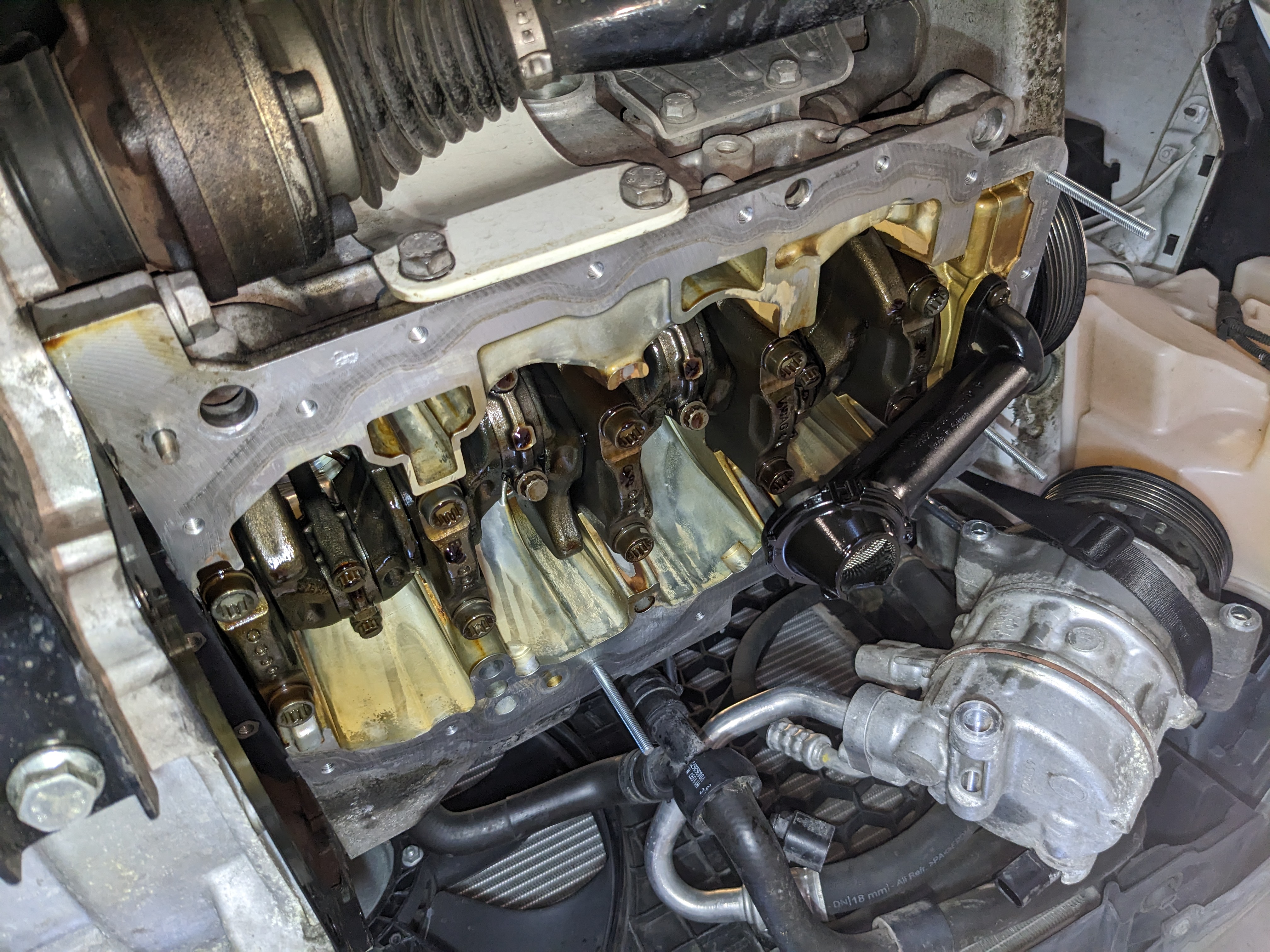

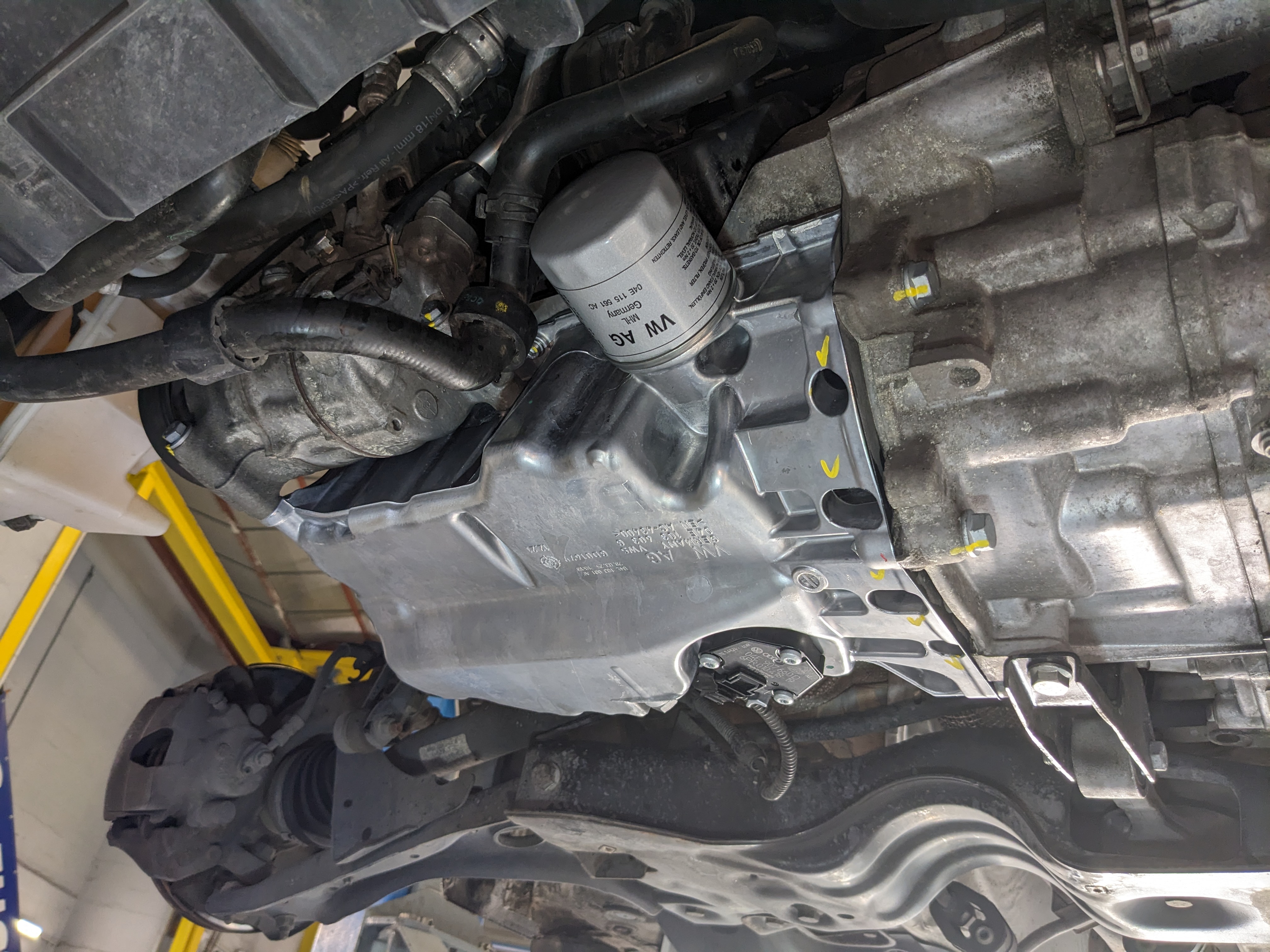

First step: removal
All the screws came out without any problems, except for one (of course...) which immediately stripped :oops:
Luckily, I had bought the special VW tool (hex key with rounded tip).
With that, it came out without any problems.
The screws on the gearbox and air conditioning compressor also came out without any problems.
No matter if there were in good condition, I alway buy new screw.
Two kicks with a crowbar and the oil pan is removed.
Despite applying tape, the aluminium still left marks where it came into contact. It's incredible how soft this material is.
Overall, it's very clean, with no debris or pieces left behind.

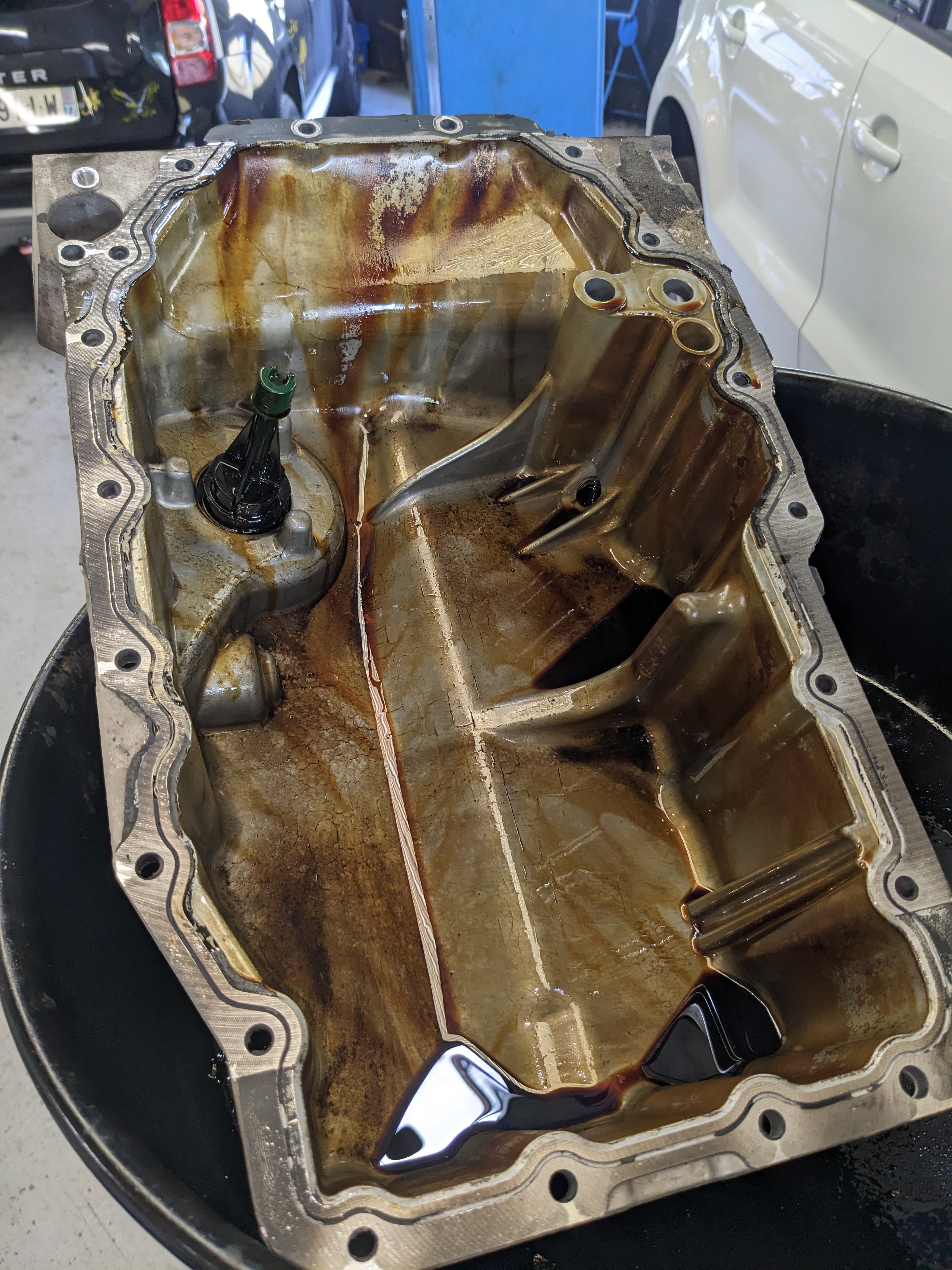

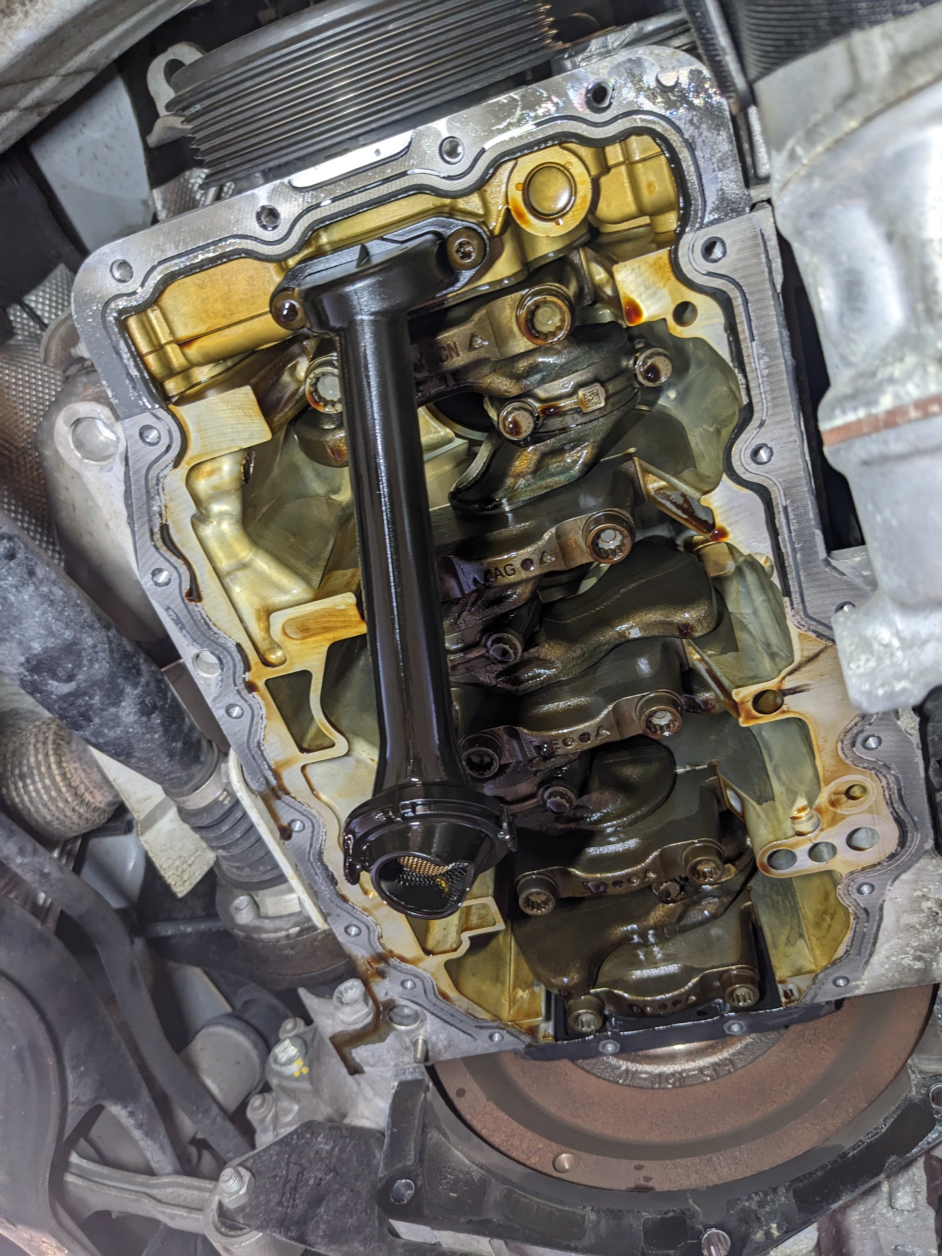

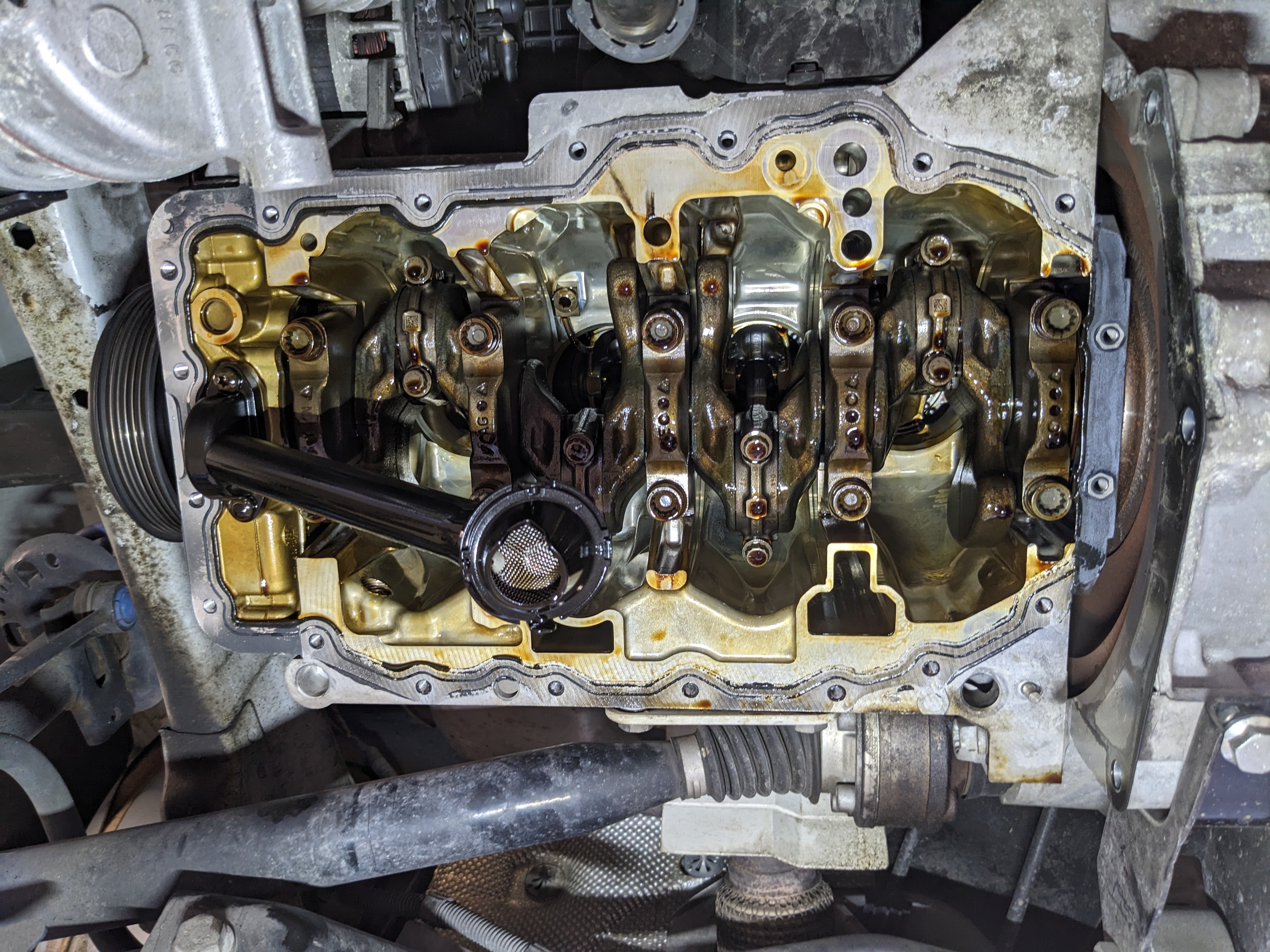

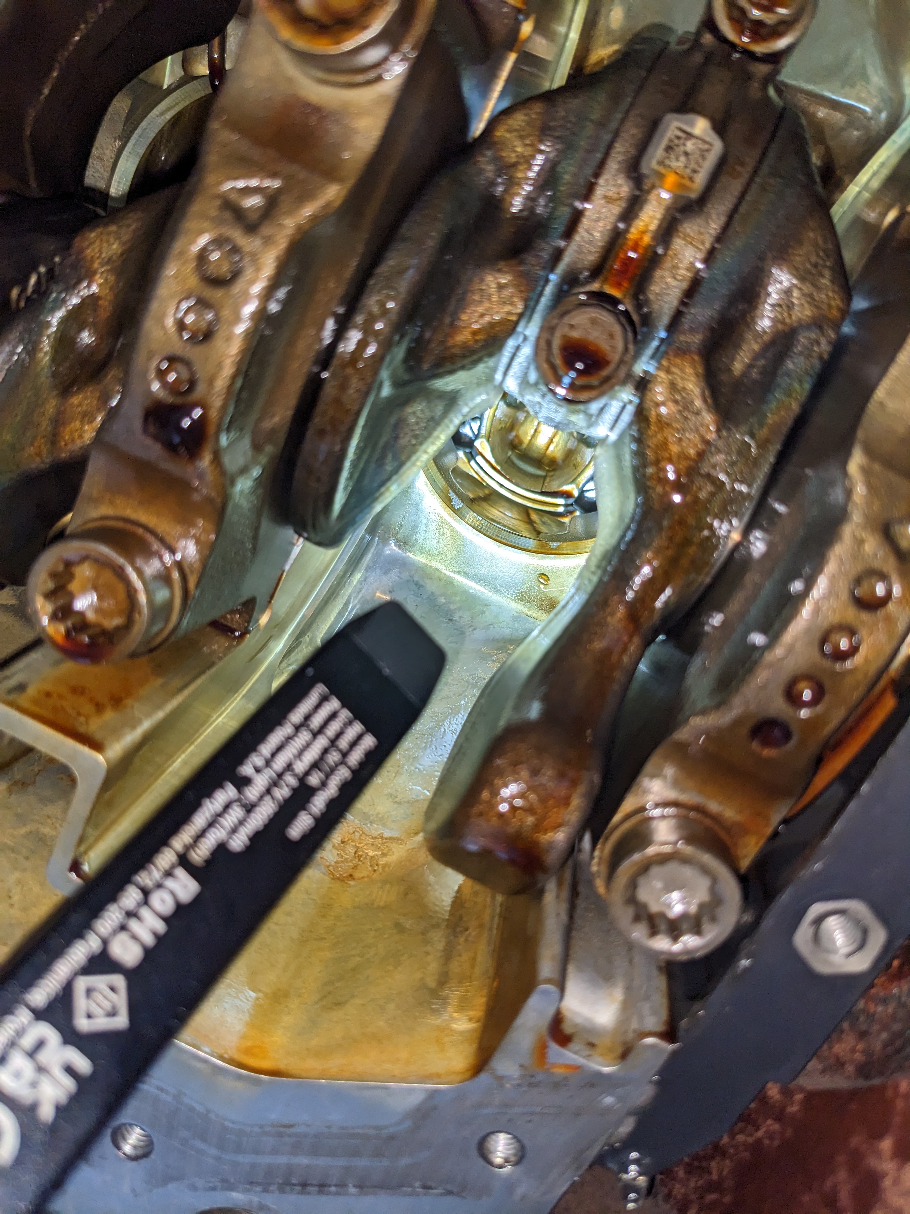

Now for the internals:
Well, same thing: very clean.
I was pleasantly surprised to see that there wasn't too much carbonised deposits (brown colour). There were a few, certainly where the oil tends to stagnate a little.
Overall, the aluminium has taken on a beautiful golden colour.

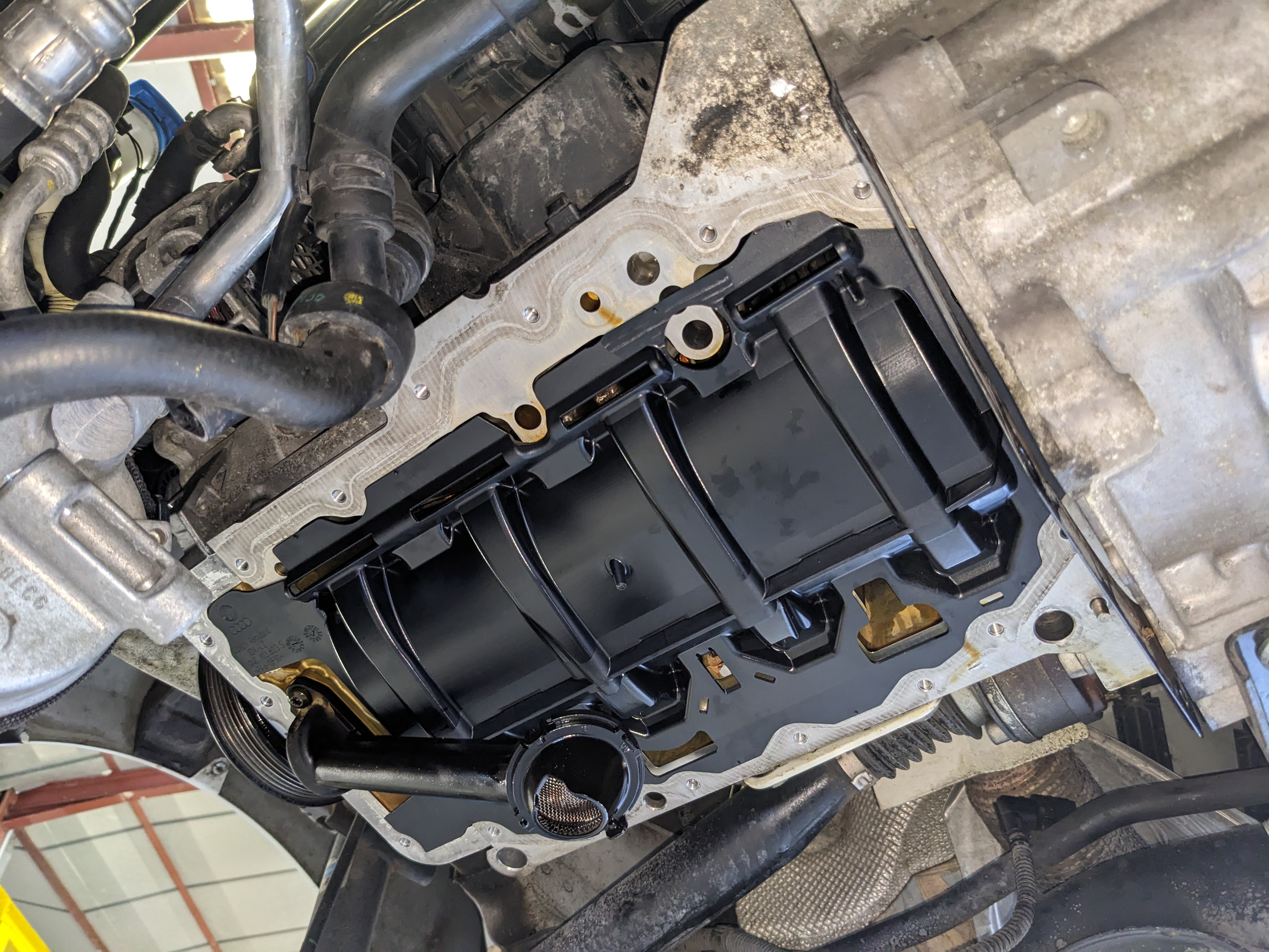

Installation of the new firewall:
This part is a bit of a ‘misfit’ in the sense that it is sandwiched between the block and the casing. A slight misalignment is enough for the casing to fit poorly (as seen in the video) and be mounted crookedly.
I did a test with the old oil pan to confirm the position, but even today I still have doubts despite the absence of leaks.

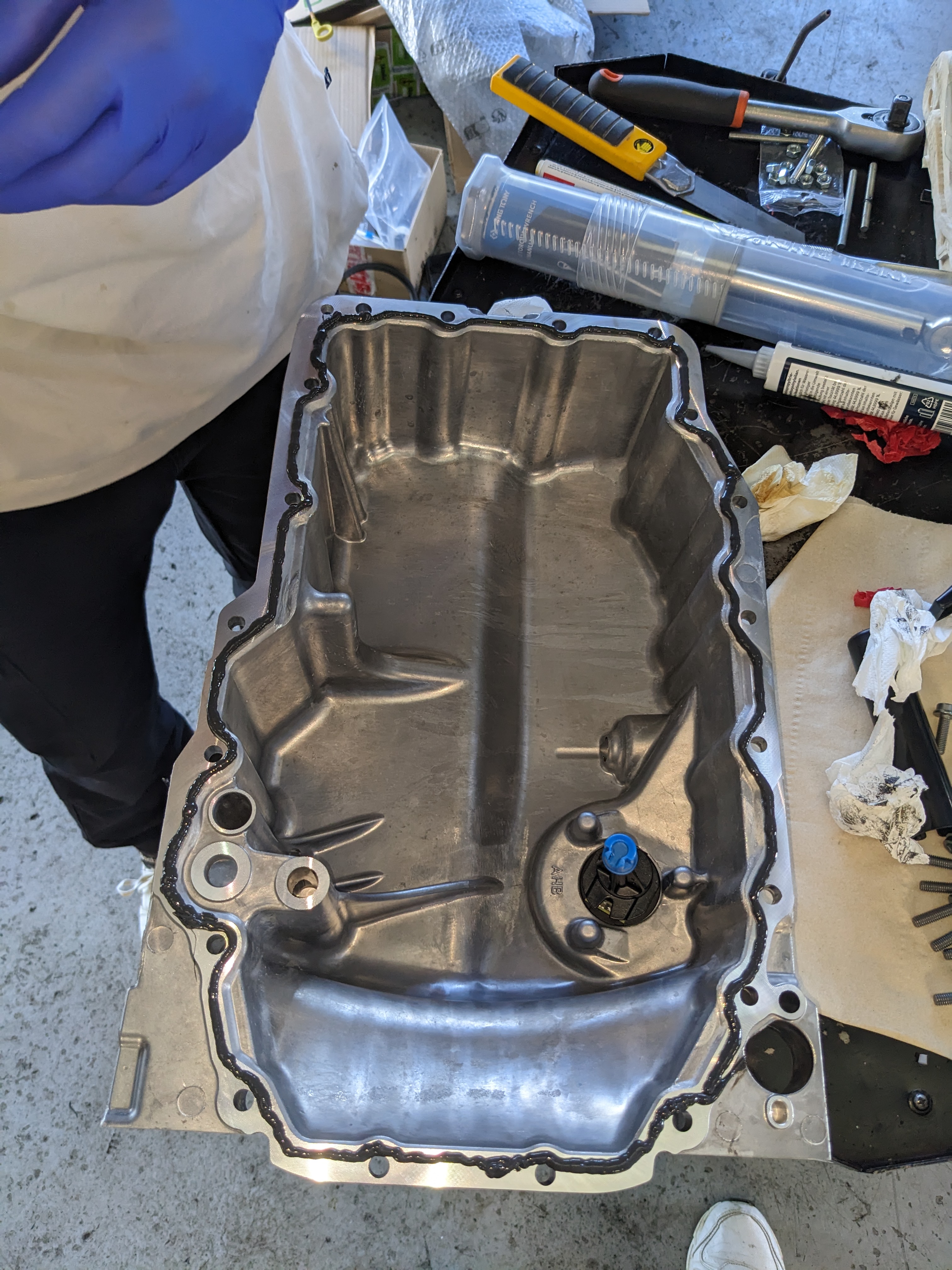

Penultimate step: preparing the new casing
I sprayed brake cleaner as if it were free, paid for by my boss :lol:
No, it's not my boss, it's my bank account :scared:
Brake cleaner all over the area and a blast with an air gun to remove all the dirt.
So, it's clearly not the most beautiful bead. I've done much better and much worse.
Let's say ‘could do better’.
The difficulty (and my fear) is not to put too much on to prevent pieces from falling off and clogging the strainer.
VW recommends a thickness of 2-3 mm, but I think I've put on more than that.
And there are certain areas where the sealant (in my opinion) is too close to the edge... I'll check during the next oil change with a borescope.
The strainer is clean, apart from a piece of metal (machining residue?), nothing to report.

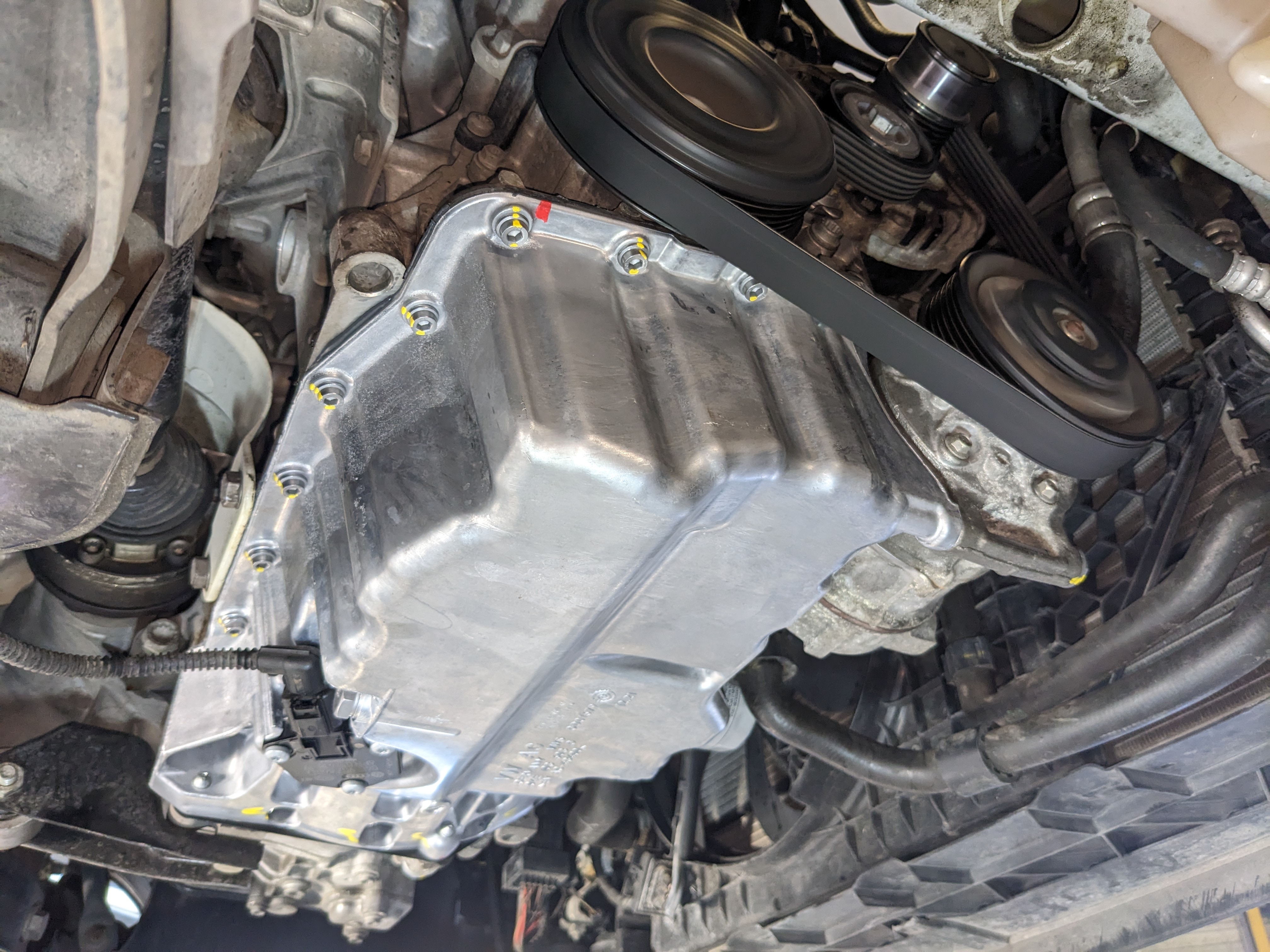

Final step: reassembly
  • Tightening the casing screws: 8Nm + 90°
  • Tightening the gearbox screws: 40Nm
  • Tightening the air conditioning compressor screws: 25Nm-+2Nm

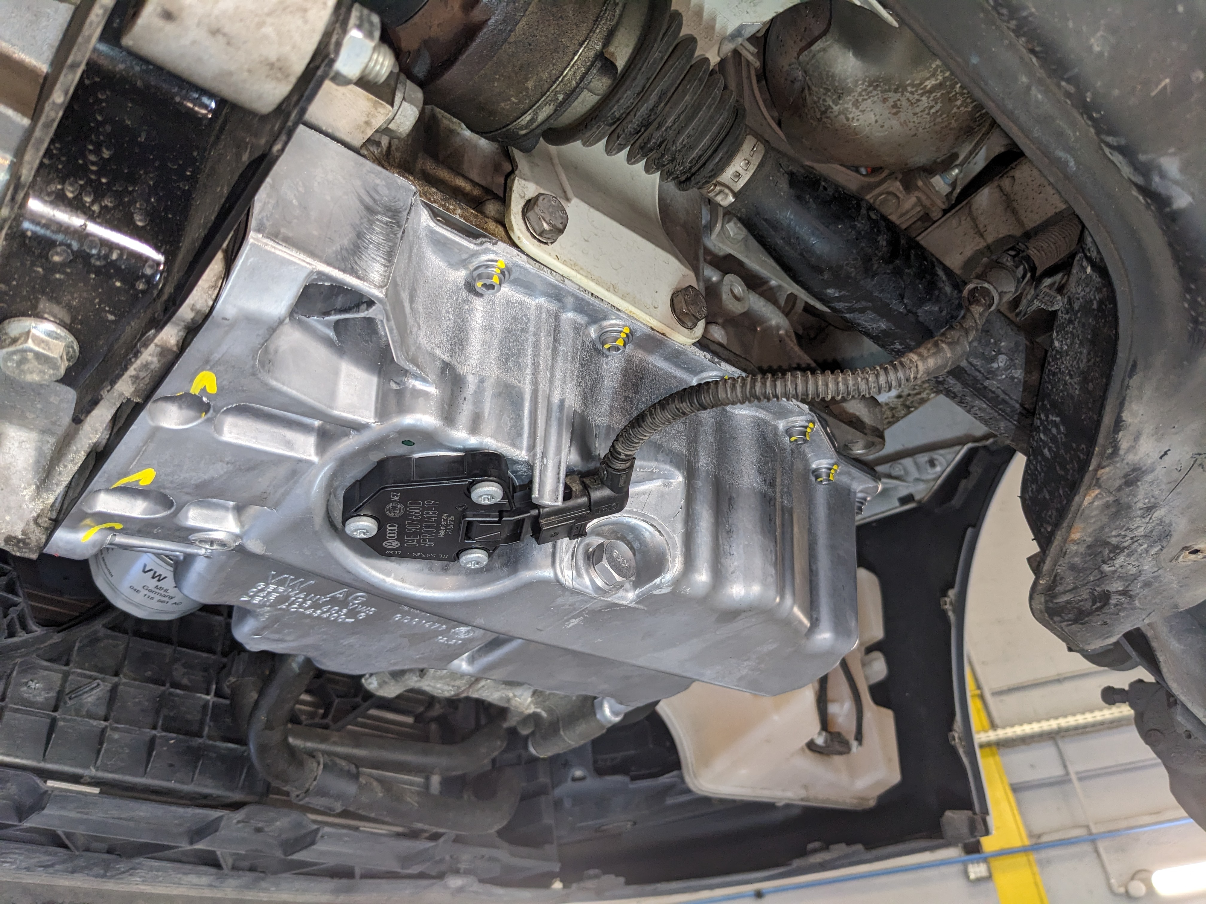

They didn't cause any problems. Angle thightening was good and apart from one (oil pan screw: when tightening at an angle, it feels a little bit off), the feeling was good. No impression of stripping all the threads with each tightening.
Once again, I had doubts about the ability of the specific tool I had purchased to handle the tightening torque and angular tightening for two screws. But that wasn't the case at all; it was perfect.
In fact, two screws are quite off-centre in relation to the hole in the casing, and VW, to remedy this (without removing the box), offers the tool I posted a little earlier.
VW recommends a drying time of 30 minutes before refilling with oil (this may vary depending on temperature and humidity conditions).
To be on the safe side, we waited an hour...which is how long it took us to finish tightening the casing, reassembling the compressor and gearbox screws, plus a few other few things (inspections etc...).
Fill with oil and start up. The car will have been running for 15 minutes: all clear.
No leaks.
Back home, I check under the car: all clear.

I see that you used a couple of lengths of threaded rod to use as positioning dowels instead of cutting the heads of a couple of bolts.
Yellow paint touch up pencils, yes, ideal for marking torqued bolts and the "target" position after applying the angle tightening - I've had to buy my second yellow paint touch up pencil due to the first one now being too old and being tricky to open!

RUM4MO wrote: Tue Sep 30, 2025 1:55 pm Good result!

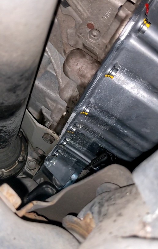

I tried with rods but it's way better without. With you hand and the guide pins on the engine block (one on the side) it's way better as you have to make a slight rotation to pass the oil pan in the gearbox hulll.
As soon I torqued the bolt, I put a yellow paint at 12'' to mark the position and, so I will know if one didn't received the +90°. Except the two in the gearbox, the pen was too big haha.
Final touch of yellow between the bolt and the assy to confirm the final installation.
Posts: 6093
Ah, so long studs etc can't be used here due to needing to move the sump around slightly - very annoying.

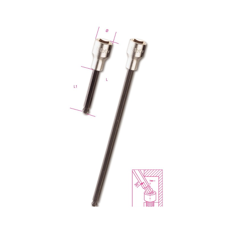

I'm usually a bit concerned about using "ball ended" Allen keys or Allen key bit, as they are a compromise, but sometimes you just have to take a chance.
I had the same feeling about the ball ended Allen key but I took a nice brand to handle the job: Beta tools.
Metal is tough and handle well the torque but still, it's not a very pleasant feeling.
