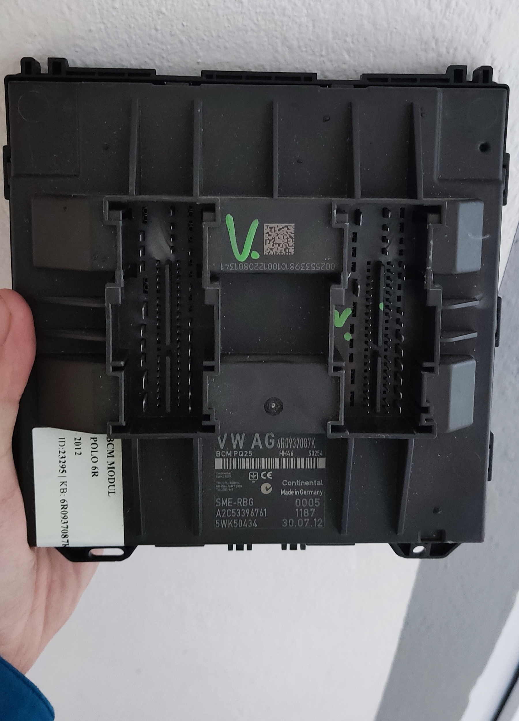

I think i will get this bcm 6R0937087K, its 40E and its from 2012. A bit newer than mine... should outlive mine by two years ahahah
( I will just get pissed if it doesnt fix the lid issue). After all of this troubleshooting).

I've searched for those double letter bcms, nothing came back on local market place.
I went and grabbed this one
Im not sure about these gray marks, but the seller gave 15 day warranty. ( doesnt smell burnt, smells normal)
Most of these part cars come from eu or uk. None from india or russia.
I will have to remove the instrument cluster, to check the can high/low lines where i spliced into. The bcm ones i heat shrunk yesterday.
And i will test with this BCM so we will see...
Today is definitely a rest day even if its a 5 min job to swap the bcm.
If this goes as planned ( fixes lid issue) im hunting down stalks with g85.🀞

Ciclooo my man! I have positive news the lid unlocking now Works with new BCM!!! πŸŽ‰πŸŽ‰πŸŽ‰πŸŽ‰πŸŽ‰ YES!!!

09- Long coding- It didn't accept my long coding - out of reach so i did a few things manually ( idk i again left sun roof enabled it came that way)
So It looks like this
2CB02BBF08210000003008006C2B0C100000412F60840000200000000000
So i have this malfunction
03075 - Parallel Parking Assistance Control Module (J791)
            004 - No Signal/Communication
                    Fault Status: 01100100
                    Fault Priority: 2
                    Fault Frequency: 1
                    Reset counter: 152
                    Mileage: 139333 km
                    Time Indication: 0
                    Date: 2019.09.30
                    Time: 00:01:10
Maybe i forgot to clear all DTC-s from being happy the lid works :mrgreen:

Posts: 9037
Location: Earth β™₯, Spain.
Re: Stuck trunk
Once I've reviewed your BCM installation procedure, this should be your final BCM coding:
2CB02FBF08210000003000007C2B0C100000410F60860000200000000000
It's rare that it's not fully accepted (out of range). If so, review and modify the Byte HEX values ​​one by one. (only two or three)
The new BCM bugs should be fixed, including the SAFE LOCK message.
The old permanent failures on unreachable units will logically continue.
Clear All DTCs should be performed as often as necessary when doing anything with the VCDS. Often, it's also necessary to perform an ignition cycle to verify the clearing of stored DTCs.
In extreme cases, or on older vehicles, it may even be necessary to disconnect the negative battery terminal, or even perform the trick of disconnecting both terminals and 'joining' them together (momentarily) to eliminate any trace of electricity.
Parasites or Symbionts: :lol:
I don't know what type of radio (Android) you have installed, but some of these NON-OEM parasites (not all) were causing significant errors in the CAN communication lines. This may be your problem with the 03, 44 communication.πŸ€·β€β™‚οΈ
Definitely opt for the CCS, provides remarkable driving comfort. You'll like it!
Re: Stuck trunk
Thank you ciclo for coding and going back and forth with me!

(the hazard light issue is also been solved with bcm swap)
