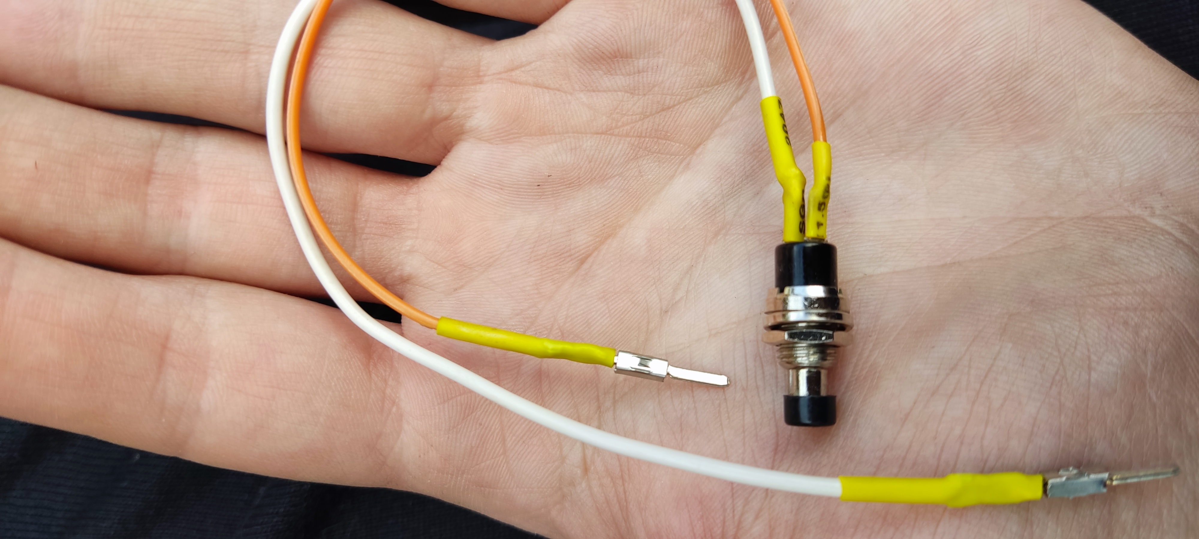

Can I run a simple push button ( since its a 2pin connector on the latch) to have a backup?

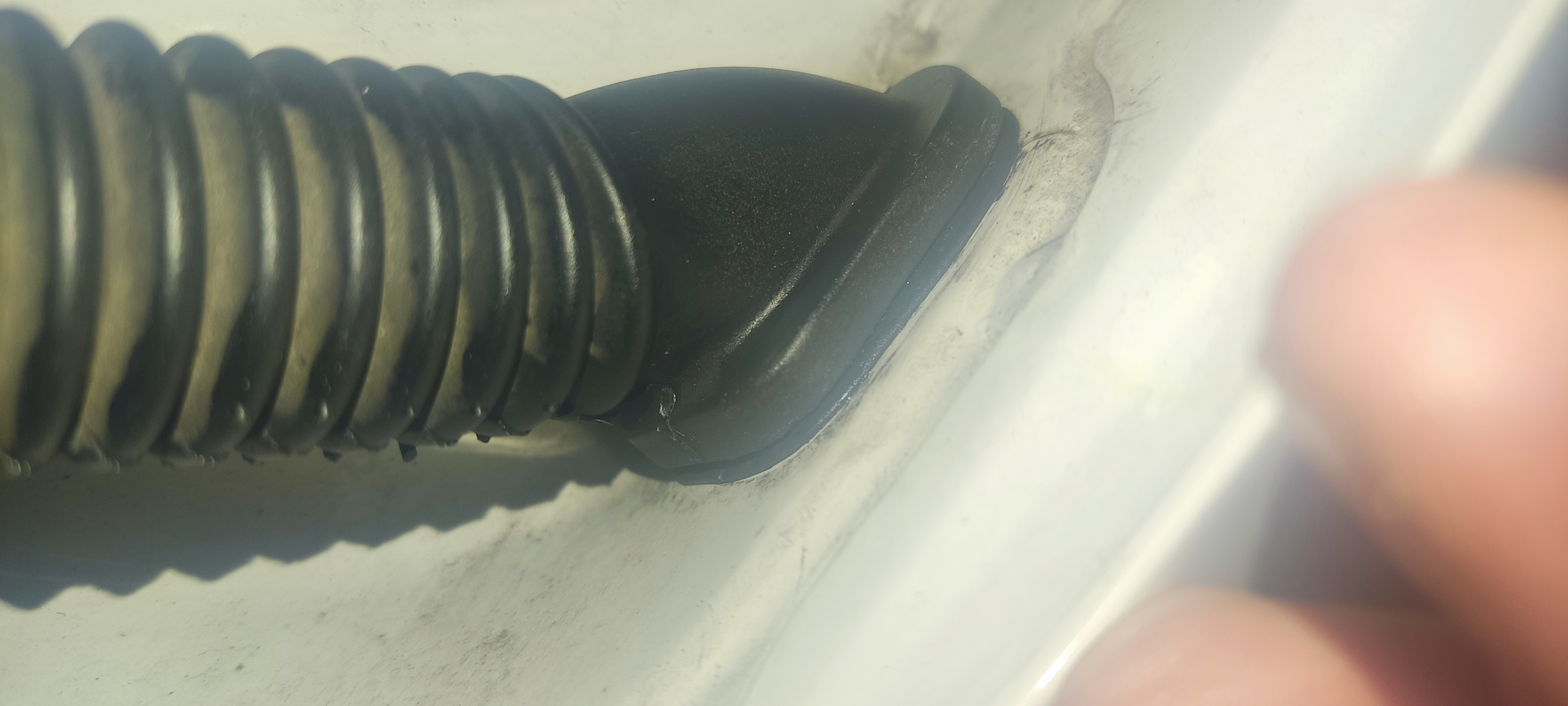

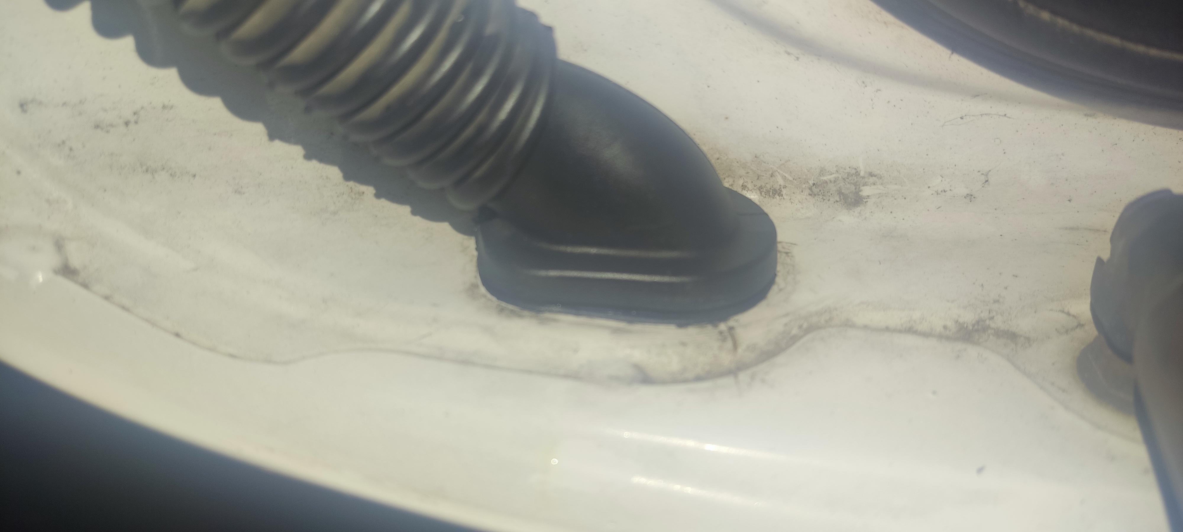

Can someone check on their car if this seal lip tucks under the body Sorry for bad lighting its dark here ( parking lot..)

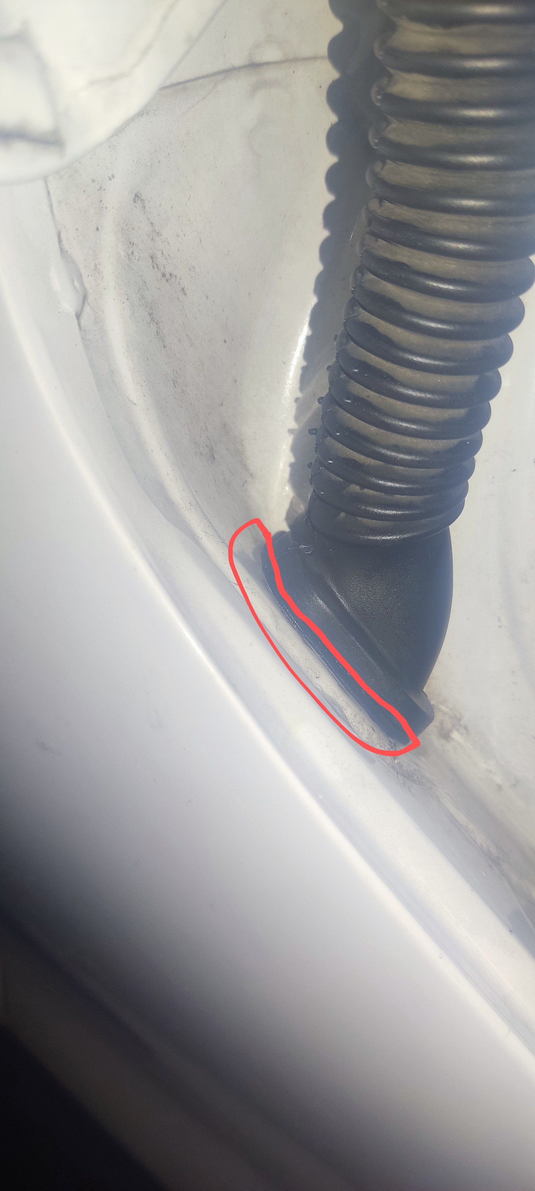

This lip,
I placed the plastic thingy inside the boot then I clipped it into the body of the car.

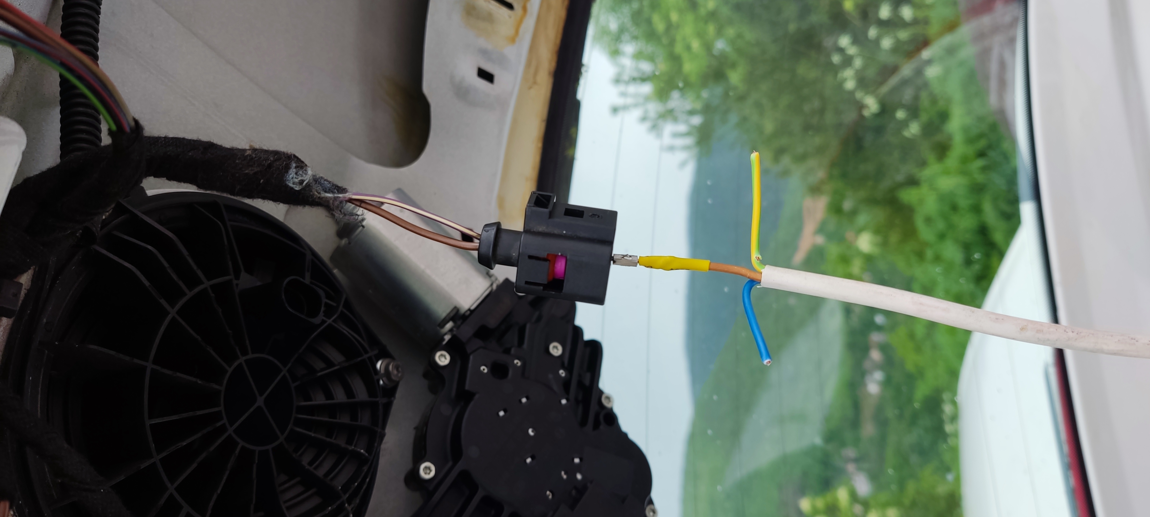

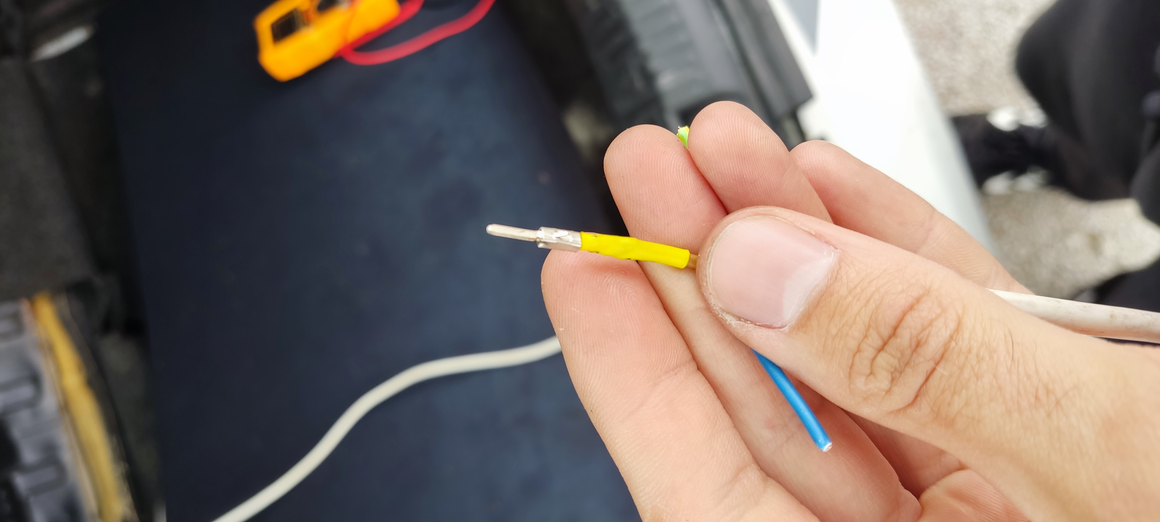

Today I have installed a new lock. (6010-01-053449P Blic)
The trunk light instantly turned on since the lock was unlock ( beautiful).
Bad news the trunk unlocking by rear lid doesnt work.
Again used a paper clip, the lock isn't unlocking.
-It unlocks when i hold the remote controll for rear tailgate unlocking.
Tried to paper clip the brown connector GND and corresponding pin - nothing.
Now I assume somehow the loom is broken somewhere bellow the flex point?
What do you guys think?

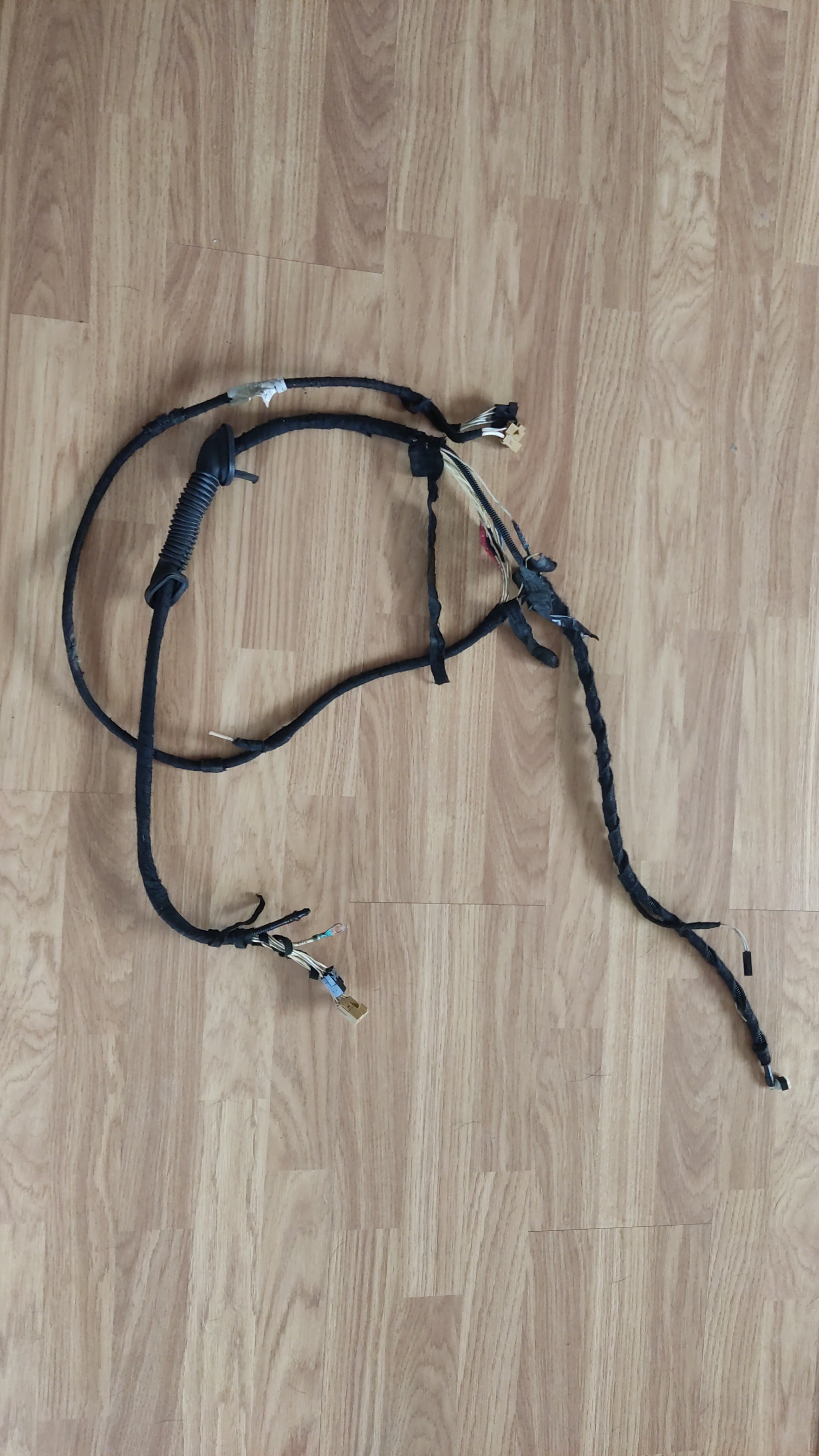

Ok guys i have swapped the loom ( guess what the old one got stuck when pulling it out so 1hr battle to remove it.. what a s*it show).

- The lip of the corrugated tube is on the outside of the body, just fit the inner tab of the corrugated tube to the body and that's it.

Ok guys a bit of multimeter diagnostic (yoga ouch that bcm location is so cramped) work.
(brown stuff is a thin layer of cavity wax) This was my boot lid push button/emulator just in case.
https://youtu.be/K3ssyigL7VQ?si=gfDcfuXKb8yhOyYl
conclusion:
1). Tested the part of loom from main loom of lid (right side of the loom - short one) to the boot lid switch
- Checked the ground on connector for lid
2.) Removed the BCM -pin 23 on A connector ( black one) and inserted extension cord to the lid button as seen on image.
- Ran continuity test with multimeter, beep
So my conclusion is that the BCM is damaged, since there is no break in the loom. and our lid button continuity came back as
For the hazard lights, the loom on bcm looked perfectly ok.
BCM it self is dry as a bone, a bit dusty but nothing mayor.
Just to mention i have checked the new(used) loom where it flexes the wires are perfect, a soft. Not brittle as mine. (iichel pointed this out when it broke the first time sings of water) i have traced it then to third brake light seal. Thats also fixed way back then.
Just to add the other day before all of this i washed my headlights from inside, on one headlight I couldn't remove the loom ( ofc it got a bit wet). But it was a sunny day and they were left to dry. There was no condensation. ( That night i drove the car)
And this issue with boot lid and hazards was night after that.
So coincidence or not im not sure, i had no warning lights.
Yes i tried all of testing with headlights plugged in and not plugged in made no difference.
