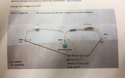

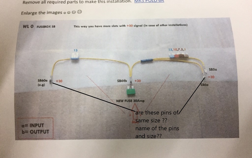

download/file.php?mode=view&id=2050
are these pins of same size?? name of the pins and size??
Posts: 8981
Re: Bixenon headlights with AFS For polo gt Tsi 2015
NO
SB60 = SPT Standard Power Timer
SB5/6 = JPT Junior Power Timer
They're usually the most common.
