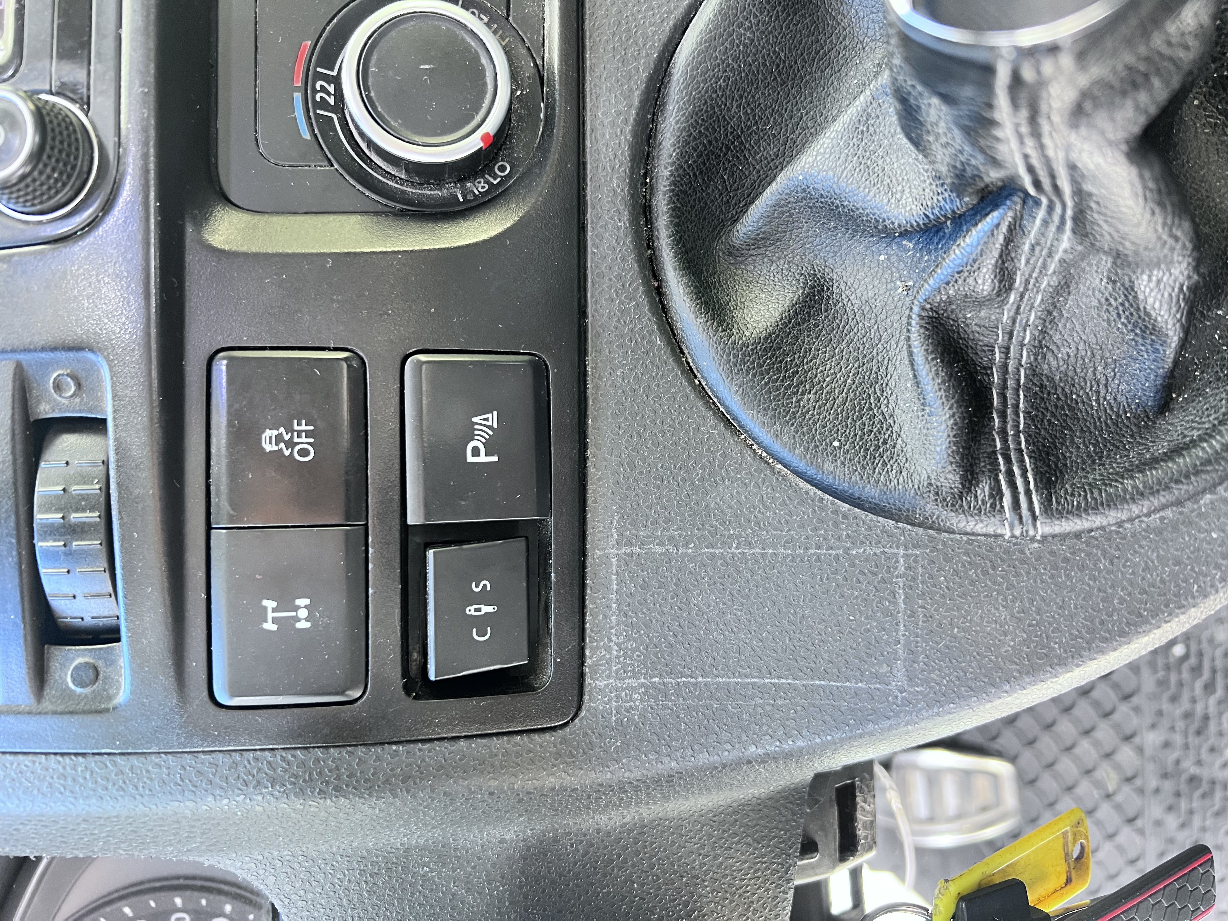

So I have finally completed my EPB retrofit
I had this kit from e-bay that have nearly everything I want
Attached the new button:-
Replaced the calipers:-
Everything works as expected

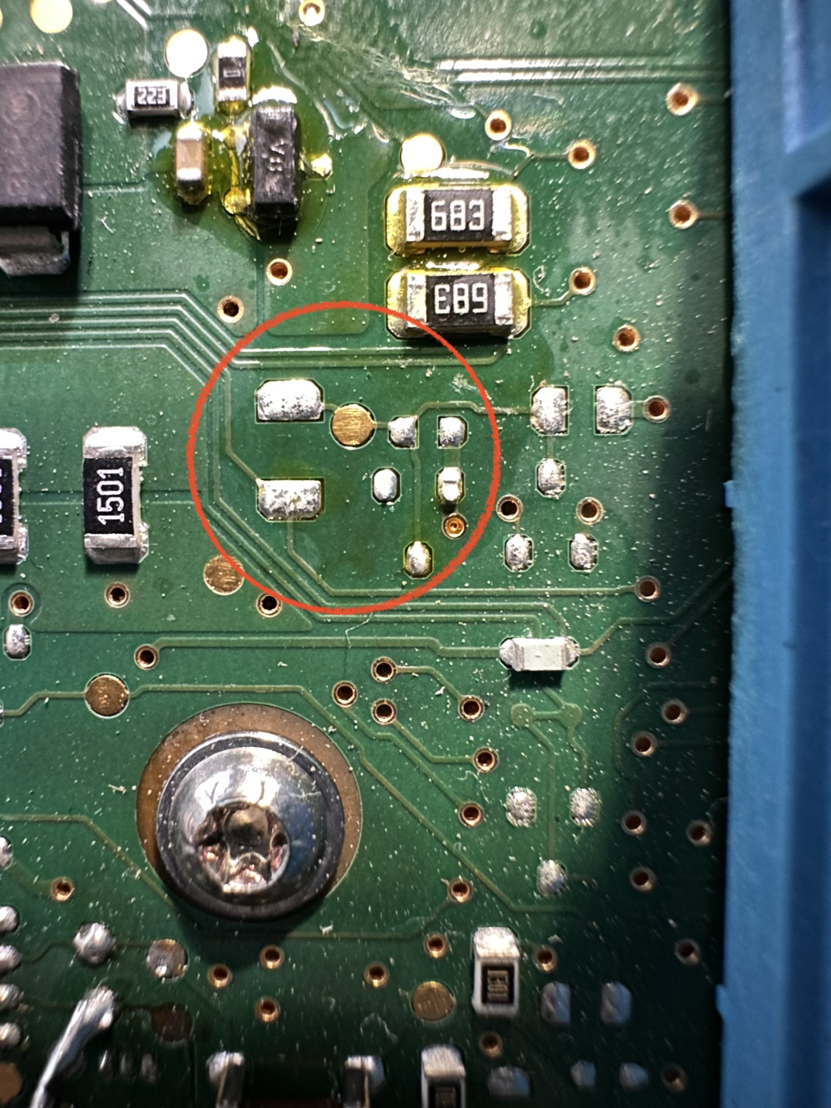

Part Two was dealing with parking signal to cluster
First I have modified my secondary cluster
After that I have edited epprom with VDO editor
But after testing the signal is reversed
So I have P light on when parking break is not engaged
When I have a free time I will try to sort it out
