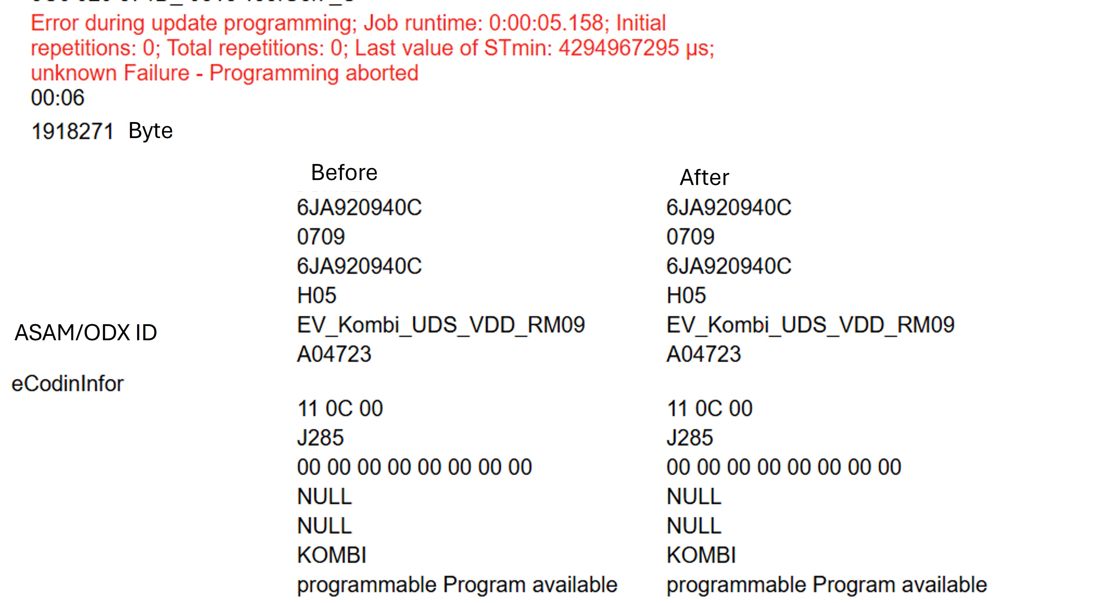

Second, I tried to update my IC to 5C6 818, but it failed (I tried vehicle projects VW25X and VW36X).
I also have 2H6 1120, but I know finding the correct wheel circumference is really annoying. :cry:

In VCP you have to do an extra step to trick the security algorithm using an older firmware for the firmware to update,

My original IC is A04(EV_Kombi_UDS_VDD_RM09 A04723), and the "layer-refs" of the 0818 5C6 IC is also A04.
(LAYER-REF DOCREF="EV_KombiUDSVDDRM09_A04" DOCTYPE="LAYER" ID-REF="EV_KombiUDSVDDRM09_A04"/)
It's fine to upload the new FRF to the original IC, but it shows the following error:
Error during update programming; Job runtime: 0:00:05.158; Initial repetitions: 0; Total repetitions: 0; Last value of STmin: 4294967295 µs; unknown Failure - Programming aborted

Than it's really SA2 key fault. Try copy it from the other sw.
sejuani
Posts: 51
Joined: Fri May 17, 2024 8:38 am
Drives: POLO 6R
Location: Taiwan
Re: Dashboard swap! Seat Toledo Instrument Cluster on Cross Polo 6R
Post by sejuani »
MrCollayder wrote: Sun Oct 13, 2024 10:40 am
I really appreciate it.
I changed the SA2 key, and everything is good—no errors occurred.
Now I have 5C6 818 and RTA menu.
However, I have a warning for the brake fluid level on the IC.
I'll check 0x2CB later to see what's going on. Thank you again!
