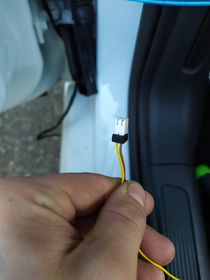

Do you know the name of the plug that goes into the LED blind spot mirror? What are the connectors?
Thank You :)
Posts: 8976
Re: ciclo. Wife's Golf MK7.5 Ready2Go 1.0 TSI 6MT 200Nm/l 115HP
I don't know, in the ETKA there is no reference for these connectors.
It seems to me that it is a German company that manufactures this type of connector, ... it is the type of connector that the taillights have on the interior electronic board.
In other words, they are connectors for electronic boards.
We'll have to find out, I guess. :)

Posts: 8976
dcgumis wrote: Sun Sep 27, 2020 1:56 pm Nice :D
Thank You :)
smr https://www.smr-automotive.com/
I have tried with no success to find the mini connector for the BSD LED light on the mirror.
smr is the supplier of these original mirrors for VW, it has a worldwide presence.
smr has several partners that supply electrical components and on none of their websites have I been able to find the mini connector. :(
Searching in google 'mini 2-pin pcb connector' you can find very similar connectors, although the problem would be to find the rubber seal for waterproofing.
Thank You :)
Thank You fernando :)I read on the Polish Forum that the molex5102 plug also fits.

dcgumis wrote: Thu Oct 01, 2020 8:37 am
ciclo wrote: Wed Sep 30, 2020 8:13 am https://i.imgur.com/WRGeyDb.jpg
Bsa works great :))
Thank you very much for the info Piotrek, it seems that the Molex 5102 is currently discontinued. There is a mini JST connector that is also very similar.
