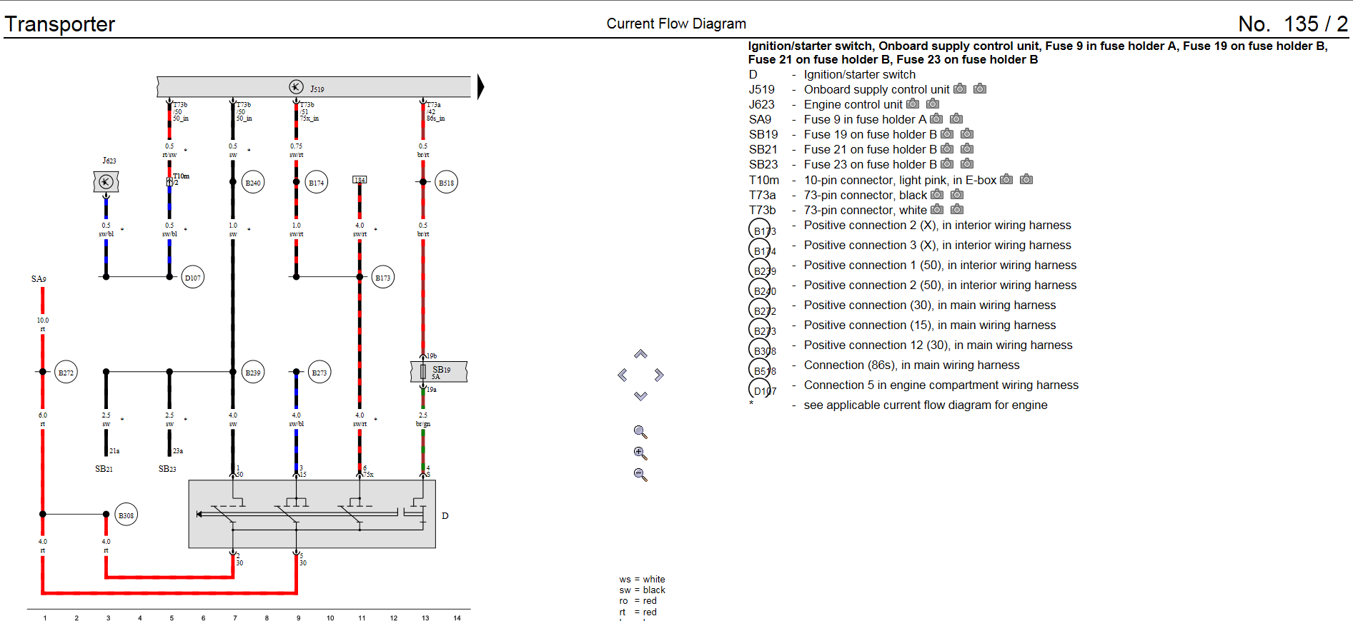

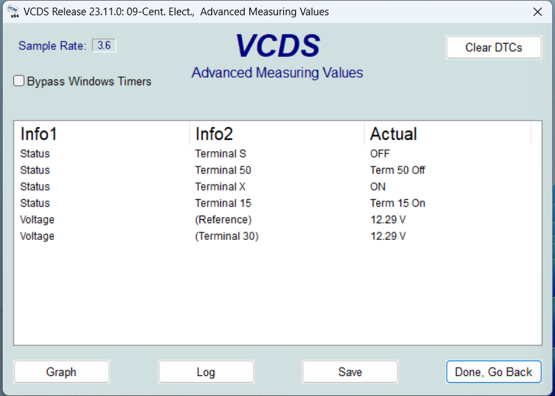

Update regrading kessy..
I have got my ELV working
Kessy Entry is also working
the final step was to repin old ignition switch
Screenshot 2023-11-03 182637.png (140.26 KiB) Viewed 7233 times
D1 => T7/5 (starter relay)
D2 => T7/3 (starter relay)
D3 => t9g/5 (Terminal 15 relay)
D4 => T16v/7 (ELV)
D5 => t9g/3 (Terminal 15 relay)
D6 => t9m/1 (Terminal 75 relay)
after repining I got 2 faults, 1 in BCM and the other in ELV

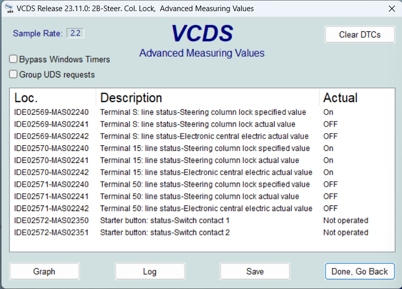

First click on the button will turn 15kl on, as seen In measuring
when trying to long press with clutch, it will turn off 15kl
I have double checked Terminal S wire from T16v/7 (ELV) to D/4 and is seems OK

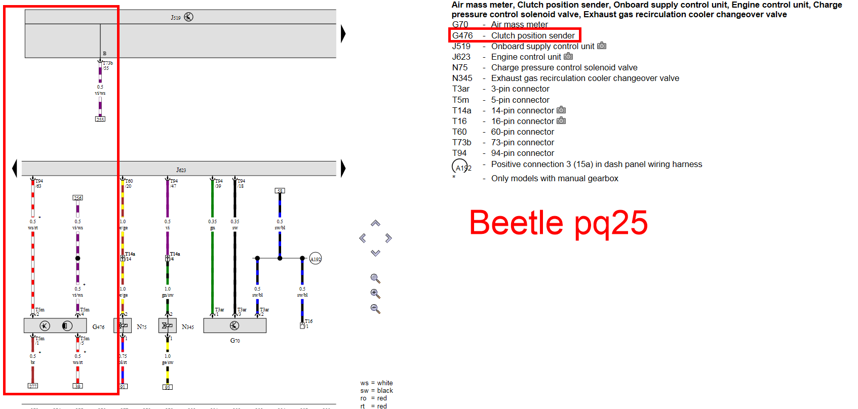

kessy update...

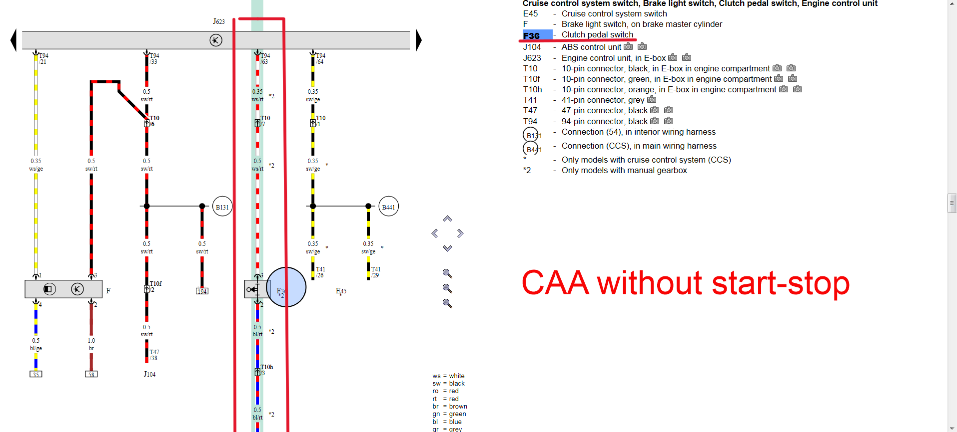

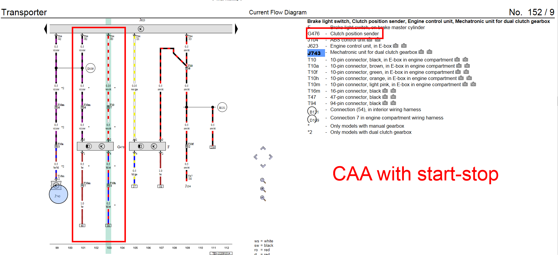

after a long research why my elv didnt send 50kl signal to start the car..
the biggest possibility was that ELV is not knowing that my clutch is pressd
so after a quick look at elsa :-

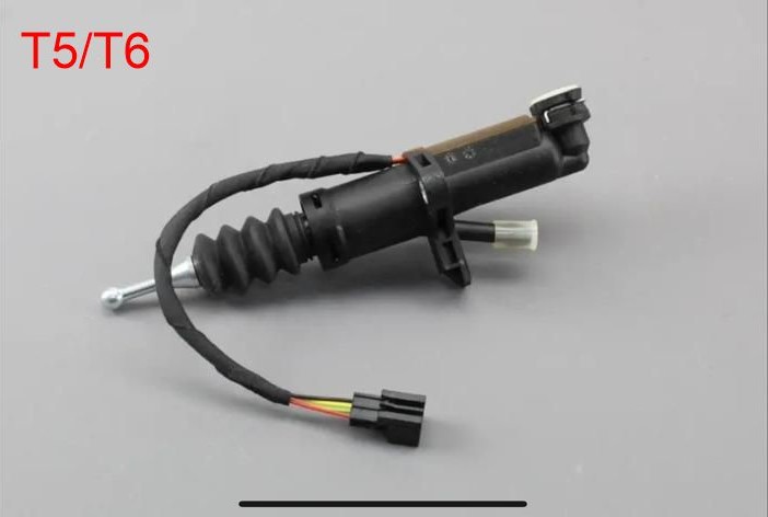

So my van has a basic clutch padle switch
But in CAA with start-stop elsa shows a different case :-
I have immediately ordered this part and installed it ..
2 wires are repined + new GND wire + one new wire to the ecu
and after testing still no progress :cry: :cry:
I was thinking maybe I should also flash ECU to support (start-stop) to get this new line working
after a quick look into etka I have found : 03L906019GQ
PR :-
G0K 6-speed manual transmission
7MJ Emission standard EU5 plus
7L6 Start/stop system with regenerative braking
7MQ Emissions standard EU5 mod
after flashing and coding, still nothing changed
two days later I asked my self so how a manual beelte and jetta with kessy knows when clutch is pressed
after checking elsa I found this :-
after checking the beetle clutch position sensor I found that its nothing like the T5
WhatsApp Image 2023-11-26 at 23.12.25_55796abd.jpg (21.33 KiB) Viewed 7051 times
WhatsApp Image 2023-11-26 at 23.12.25_4731a748.jpg (28.2 KiB) Viewed 7051 times

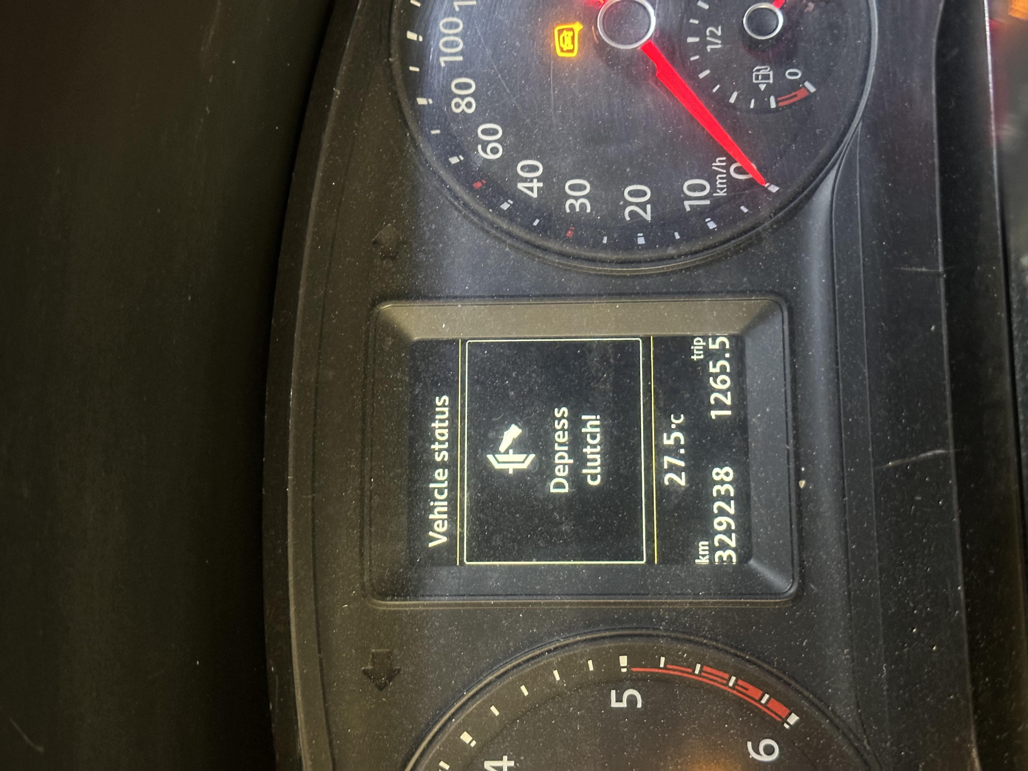

But If we look closely at the wiring diagram, all the wires seem to be similar, so I decided to give it a try and rotate the new wire to T73b/55
and when made a test I was surprised, kessy start is starting to work
with full clutch and a long press only, it will start the car
a press with out clutch paddle with turn on 15kl, but I wont be able to start the car with a second press with clutch, instead the second press turn of 15kl
