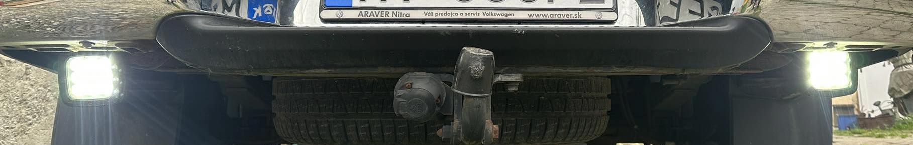

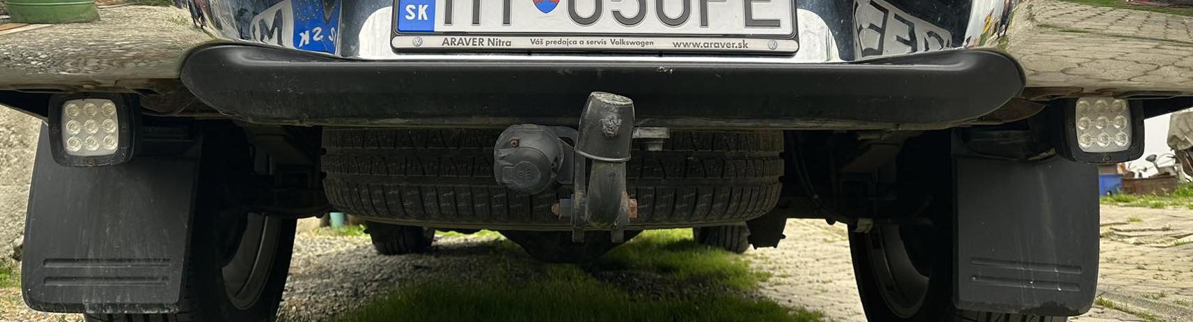

Parking/side lights:
'Assuming' the two new wires for the 'front parking lights' are installed correctly, and due to your comments, you will need to reprogram your used BCM Max with the correct settings/parameters/values for Bixenon (front POS parking lights):
viewtopic.php?p=598453#p598453
Value = 28.
License plate light:
New wire 0.5 from T73b/7 to the lamp conector.
Remove and perfectly 'insulate' the original wire from the lamp connector.
Reversing lights (Back-up lamps):
New wire 0.5 from T73b/12 to the reversing light conector. ... (edited, I wrote T73b/48 and it is not correct, it must be T73b/12)
Remove and perfectly 'insulate' the original wire from the connector.
New and last BCM coding: (definitive)
3C0002380C01000000300C316C4B84D40F80654E60843040300000020000
The rest of the problems are due to the same circumstance, that is, they are due to the fact that you have not studied the diagrams enough to carry out this retrofitting. I remind you that I told you not to do these installations if you did not know how to interpret the diagrams.
Again, I'll have to do the work for you ...
Value = 28.

When were you planning to tell us that you have "additional" reversing lights installed?... What should we assume?... You have two reversing lights and no rear fog light (possible from the factory)? or did you install those additional reversing lights later?
... you could show us a photo of those additional reversing lights in case other users think this is a brilliant idea for them.

. I disconnected the reverse lights when installing the xenon headlights so that it wouldn't be a problem. I will send a photo
