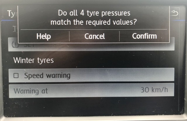

massimo23
Posts: 128
Joined: Sun Nov 18, 2018 1:57 pm
Drives: Polo Beats 2017
Location: Ireland
Re: Polo 6R ABS CODING
Post by massimo23 »
I have indirect tpms but no reset button. The reset function is present in the settings of the composition media unit.
massimo23
Posts: 128
Location: Ireland
Post by massimo23 »
You would need to change a byte in the abs long coding and also enable the tpms menu in 5F multimedia unit and enable tpms option in dashboard long coding.
Here is the menu:
exantas
