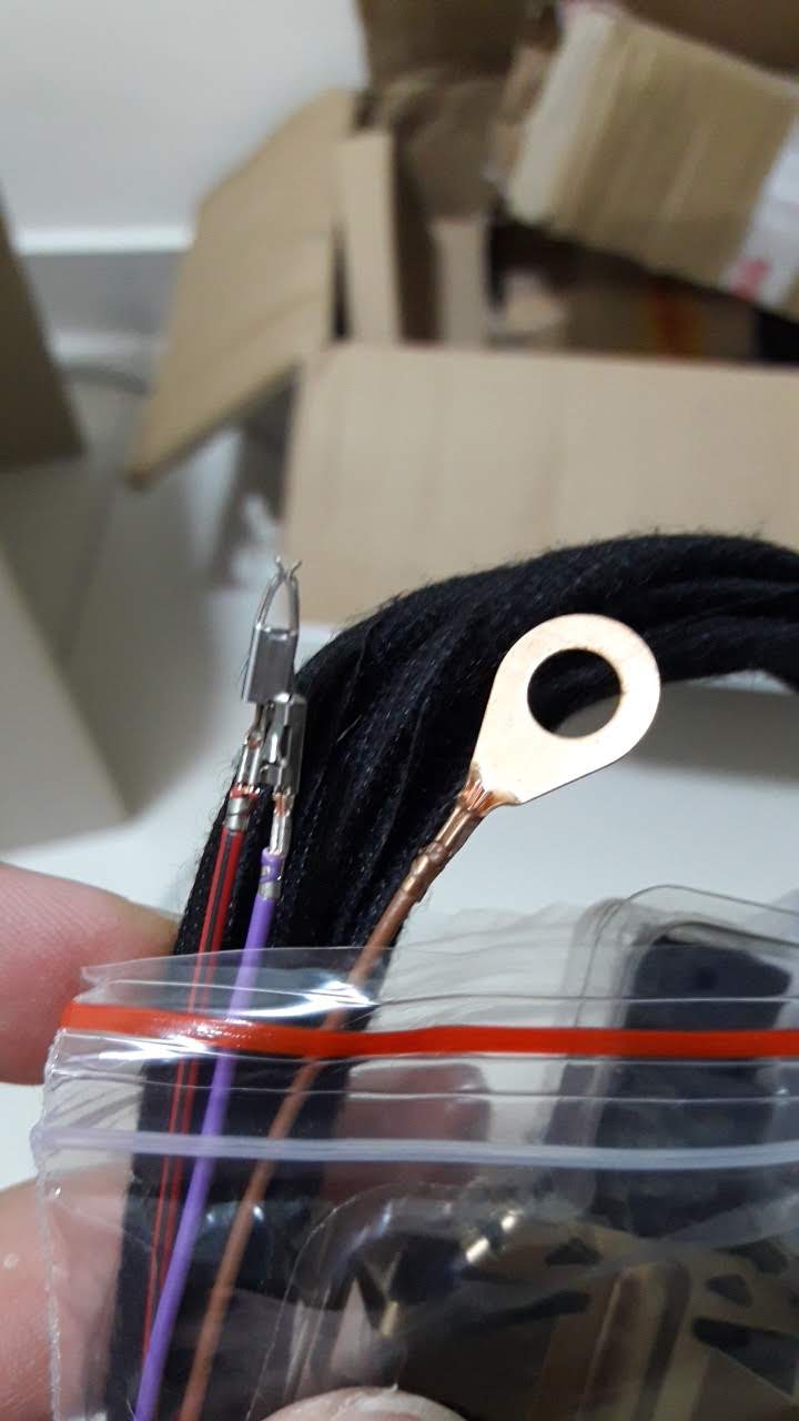

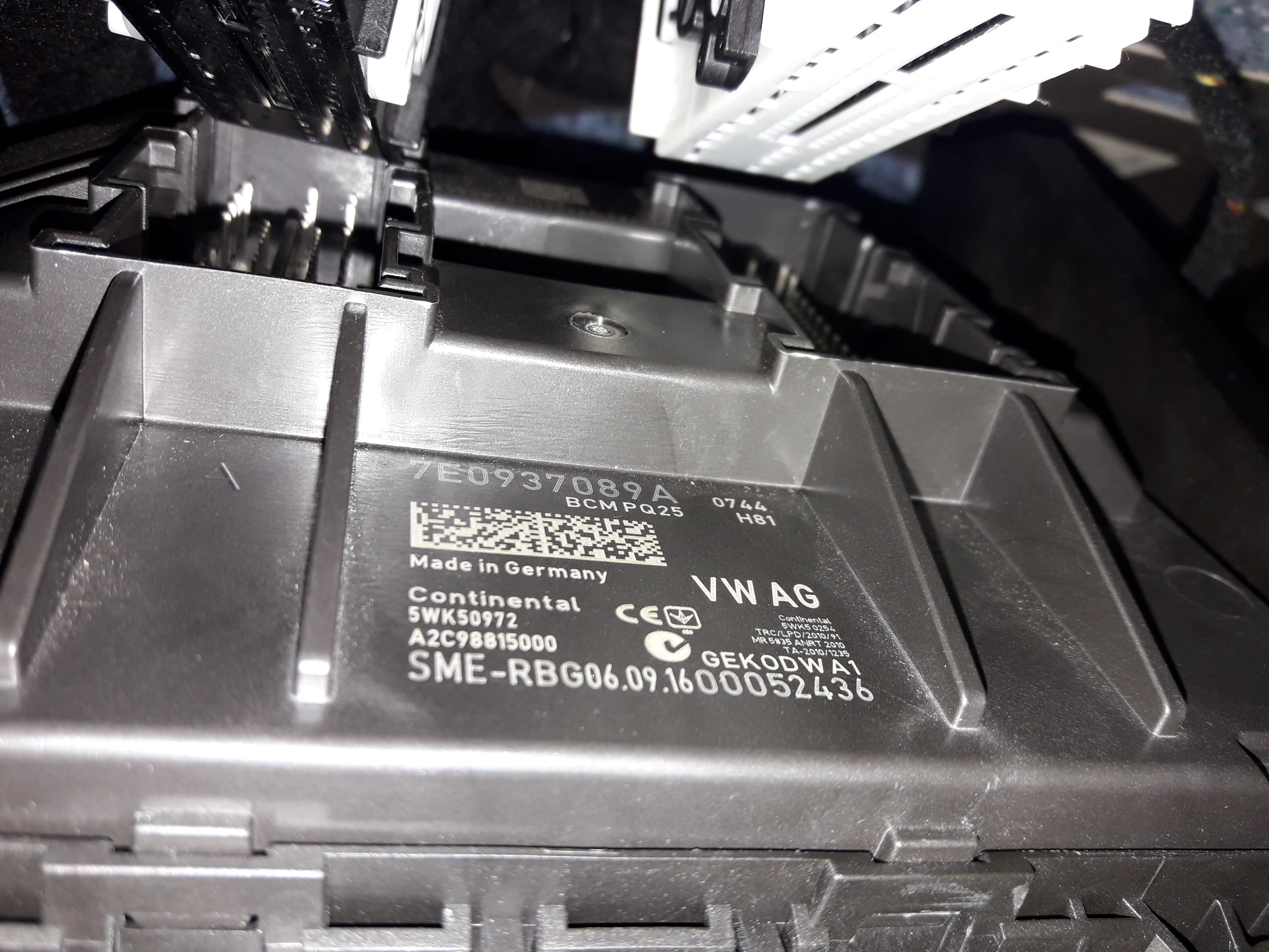

Hi guys, I'm from Malaysia.
I've recently purchased a set of rain light sensor,
Sensor - 5K7 955 547
Auto-headlight switch - 5ND 941 431B
Hardness as attached below.
BCM - 7E0 937 089A
Currently i have followed seller's instruction to tap the purple cable to BCM White bracket connector, pin 24.
However, it was occupied, seller's instructed to cut an opening at cable pin24, and tap the purple color hardness to it.
I have followed, but unfortunately the original hardness was broken during the process, so i uses the purchased hardness pin to plug into the pin 24, and tap the original purple and white cable to it. Then I try to starts the car, but was unable to start, engine lights came out.
Latest situation is i unplugged the pin 24, and some functions like plate number lights, headlight switch, anti-theft functions are off.
Any advice please?

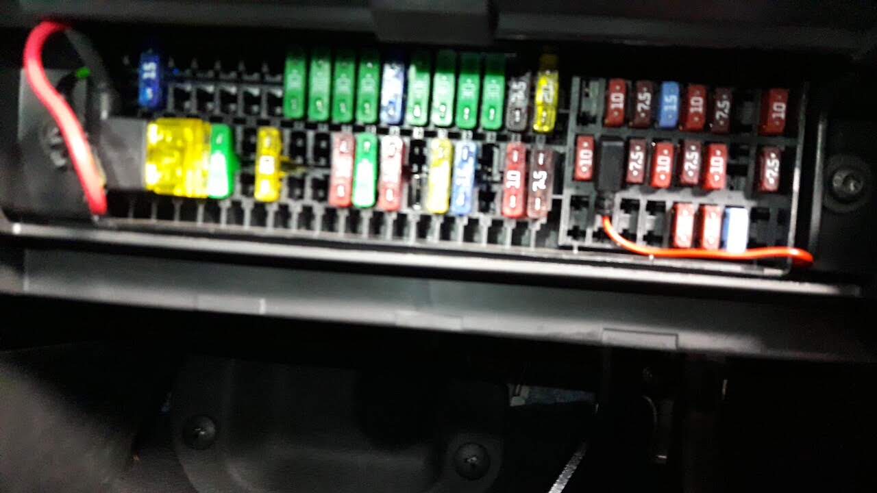

And also I have no idea how and which port in fuse box to tap into. (Red color hardness)
Please advice guys. :cry:

So I just plug the red cable into this pin hole ya?
Also, do you have any advice on the previous issue I've encountered?
Posts: 8981
Re: RLS ,CH/LH , Auto lights , Rain sensing wiper & Auto dimming Rear view mirror on Vento
Jerryncg93 wrote: Mon Jun 17, 2019 7:29 am So I just plug the red cable into this pin hole ya?
Hmm... red/black wire?... yes.
It would be perfect if you add a fuse. (e.g., 5A)
Jerryncg93 wrote: Mon Jun 17, 2019 7:29 am Also, do you have any advice on the previous issue I've encountered?
Make a good splice of the wires for the LIN. (purple wire with original violet/white wire)
All the problems mentioned are directly related to this LIN/wire, T73b/24 . (RLHS, alarm sensors)

Can I use 7.5A?
Posts: 8981
yes
