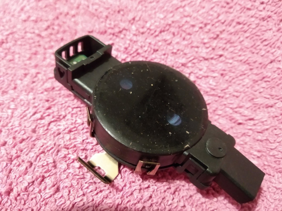

Re: Franciswat's Polo 6R 1.6 Bifuel
RLS as arrived from Aliexpress (brand new). Look how much dirt on it!
I'm looking for some way to clean it considering sensors surface is very delicate.
Elsawin suggestion (google translated):
"If the surface of the coupling gasket of the rain and light detection sensor -G397- is dirty, it must be cleaned by "gluing" and then "removing" one or more strips of adhesive tape."
Tomorrow I'll try.
Tomorrow I'll try.
