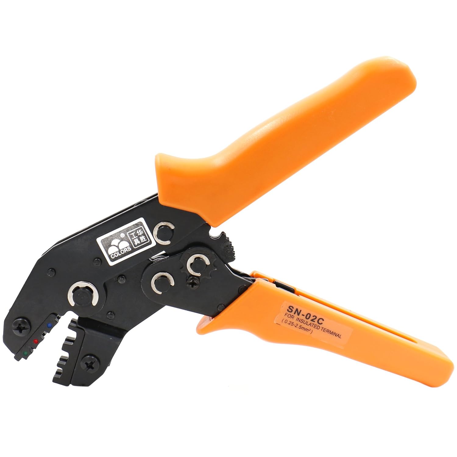

Hi guys, I finally started working on wirings!
I got this crimper but for some reasons I am not able to use on terminals. :cry:
Posts: 8994
Re: My polo 6r bifuel
That tool is FOR INSULATED TERMINALS, it is clearly written on the label attached to it.

Omg you are damn right!!! :oops:
I'll check for right crimper. Thank you mate! :wink:
