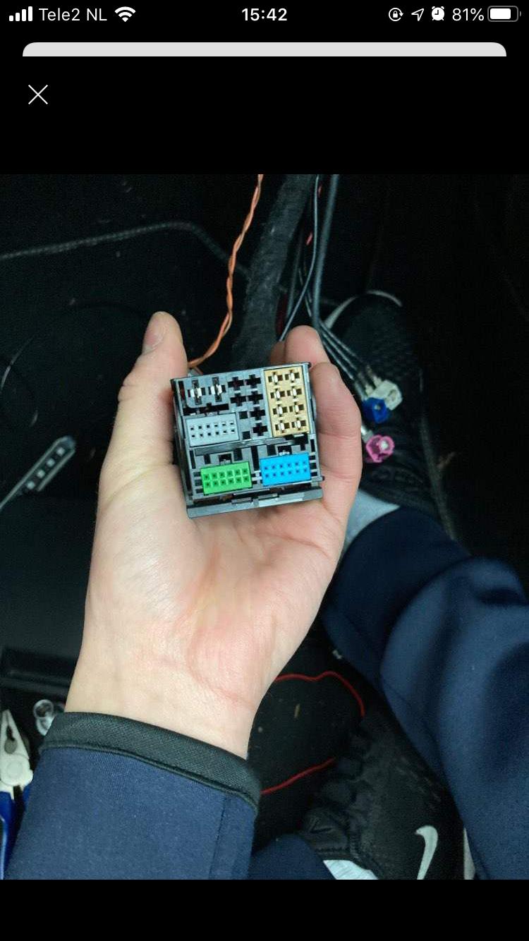

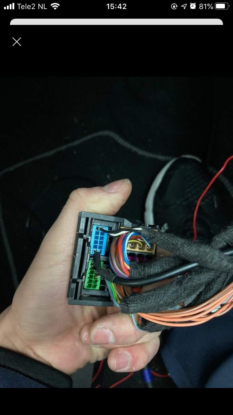

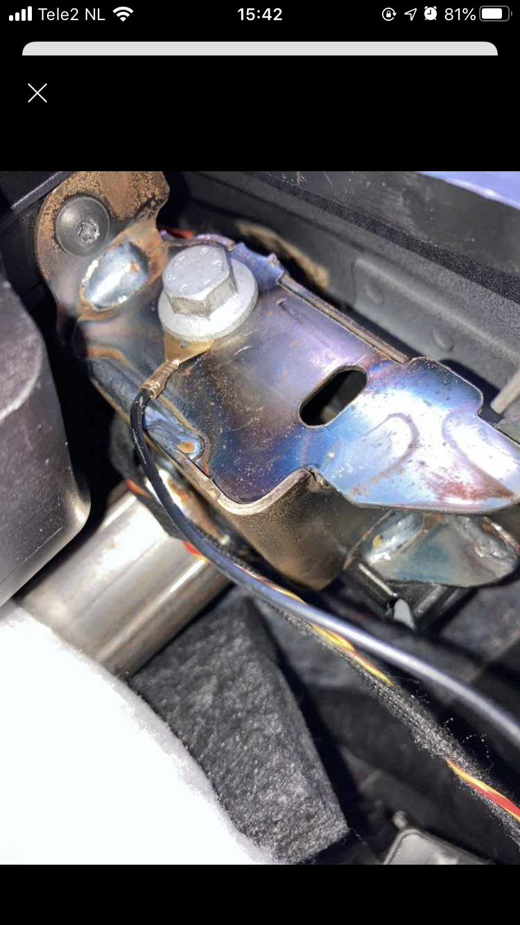

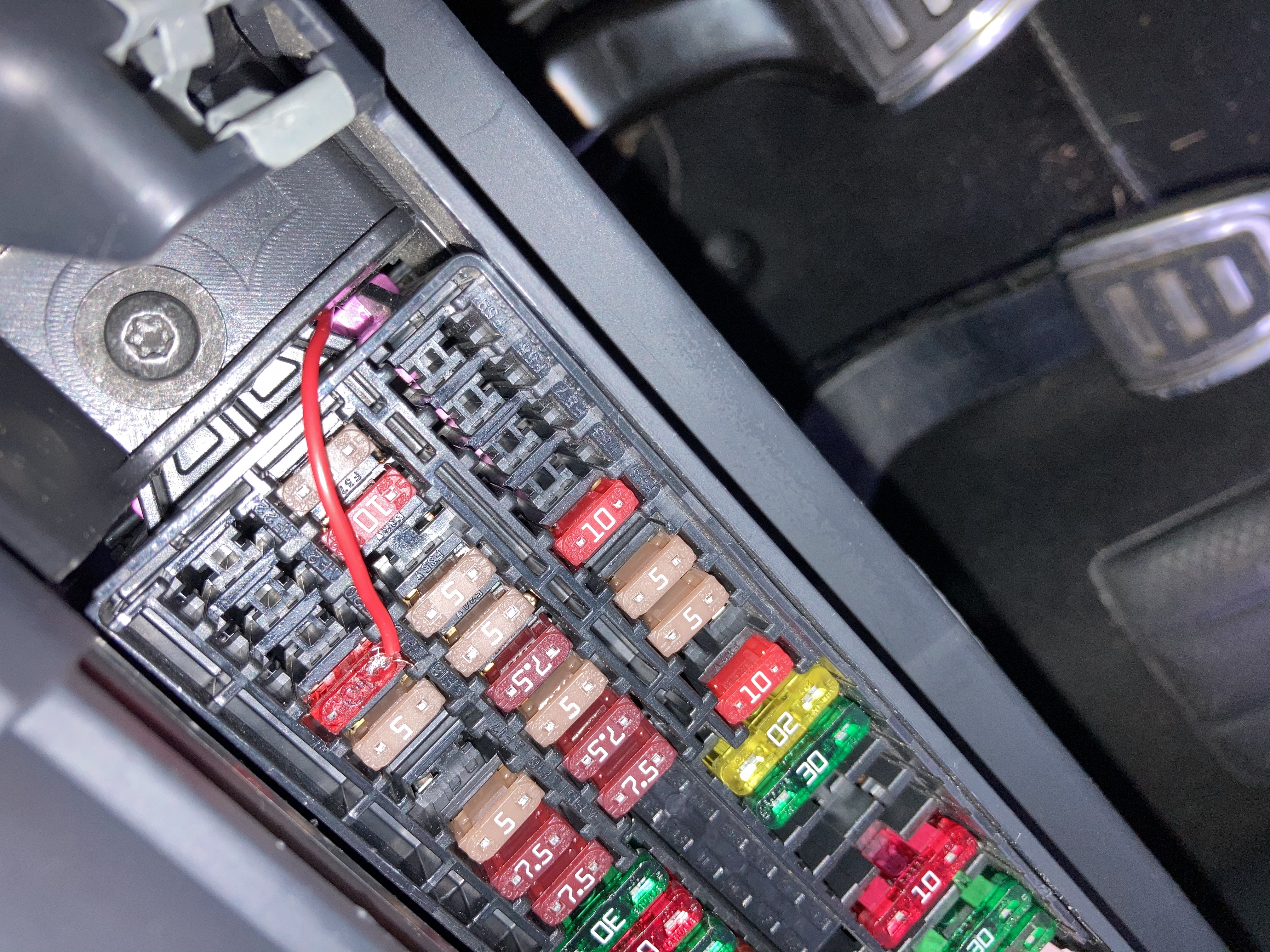

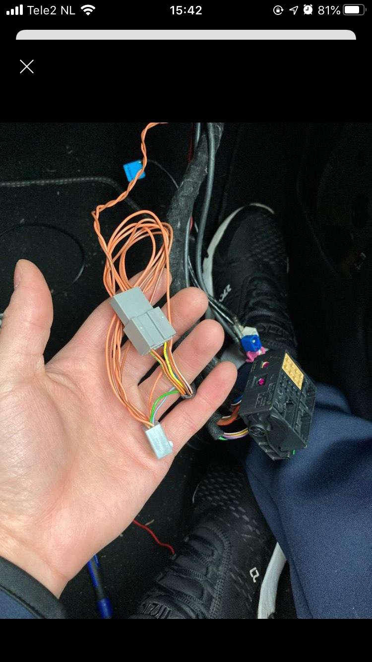

Yes patil I follow your instructions and you can see the pictures above:

Thanks for the pictures.
I suspected something is wrong with wiring, and your pictures are the proof!!
Thats a awful way to tap power supply for your reverse camera. Very bad and risky too..atleast use a fuse tap. :roll:
Looks like the black wire is loose in blue connector, the terminal is not locked properly inside, please check.

I had a fuse tap but also with fuse tap it doenst work, i did this totday because with fuse tap the fuse wont get fully in the fusebox.
The reason why it sais it have 11.1 V is because the car wasn’t started. When i start the car it wil go to 12v.
Iknow that the way i do is risky but it was for the test.

I highly suspect your blue T12 connector of quadlock. The T12/12 black wire is partially out of its place, inspect it. And also provide clean +30 power to RVC for your tests.

That is my microphone I replace other t12 connector of the quadlock now everything is on its place. I inspect everything, the fuse is +30.
The black and yellow cable is for RVC, T12/7 Black and T12/1White is for Microphone. You see that T12/7 is little bit out of his space. But T12/12 and T12/6 is good.

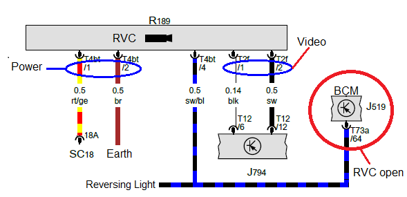

Everybody thanks for the input, but I am going to remove the camera and going to OEM golf 7 flip camera. I checked the camera @ vw specalist and they told me the camera is dead.
For the OEM camera i need to have + wire in the fusebox for 6c it is SC46. But from where can i pull the wire from +30 to the fusebox my SC46 is empty.
Diagram is from golf 7

To find the +30 signal in fuse box, visually inspect the fuse box for presence of terminal inside any of empty fuse slots. If you find any then use multimeter or 12v tester to find out the type of signal present.
Thanks.
Re: Help fitting Reverse Camera with RCD330 - Canbus
Can I just say that I'm a bit shocked by the way you're running this red wire to a fuse. Come on man, you're better than this
