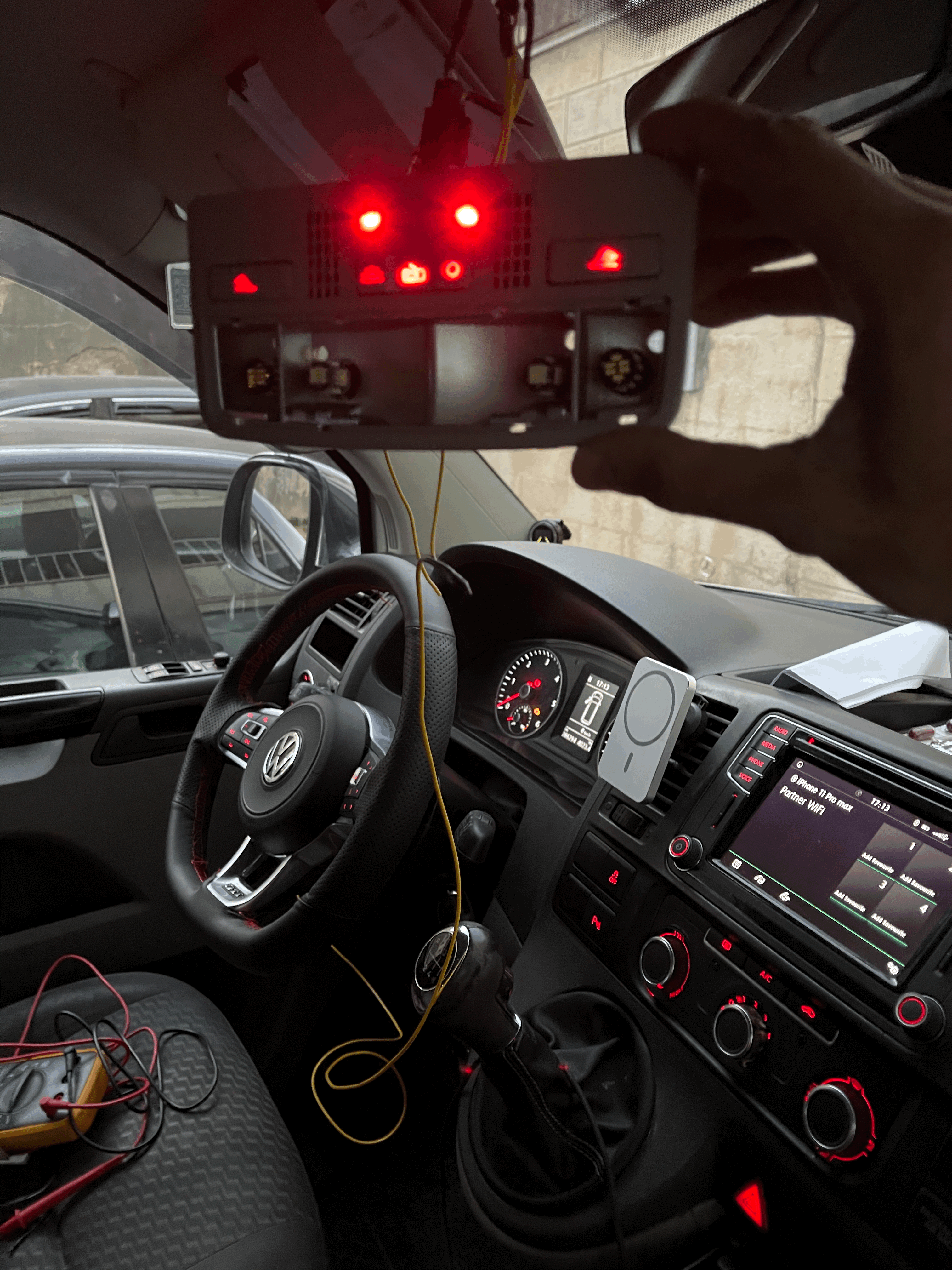

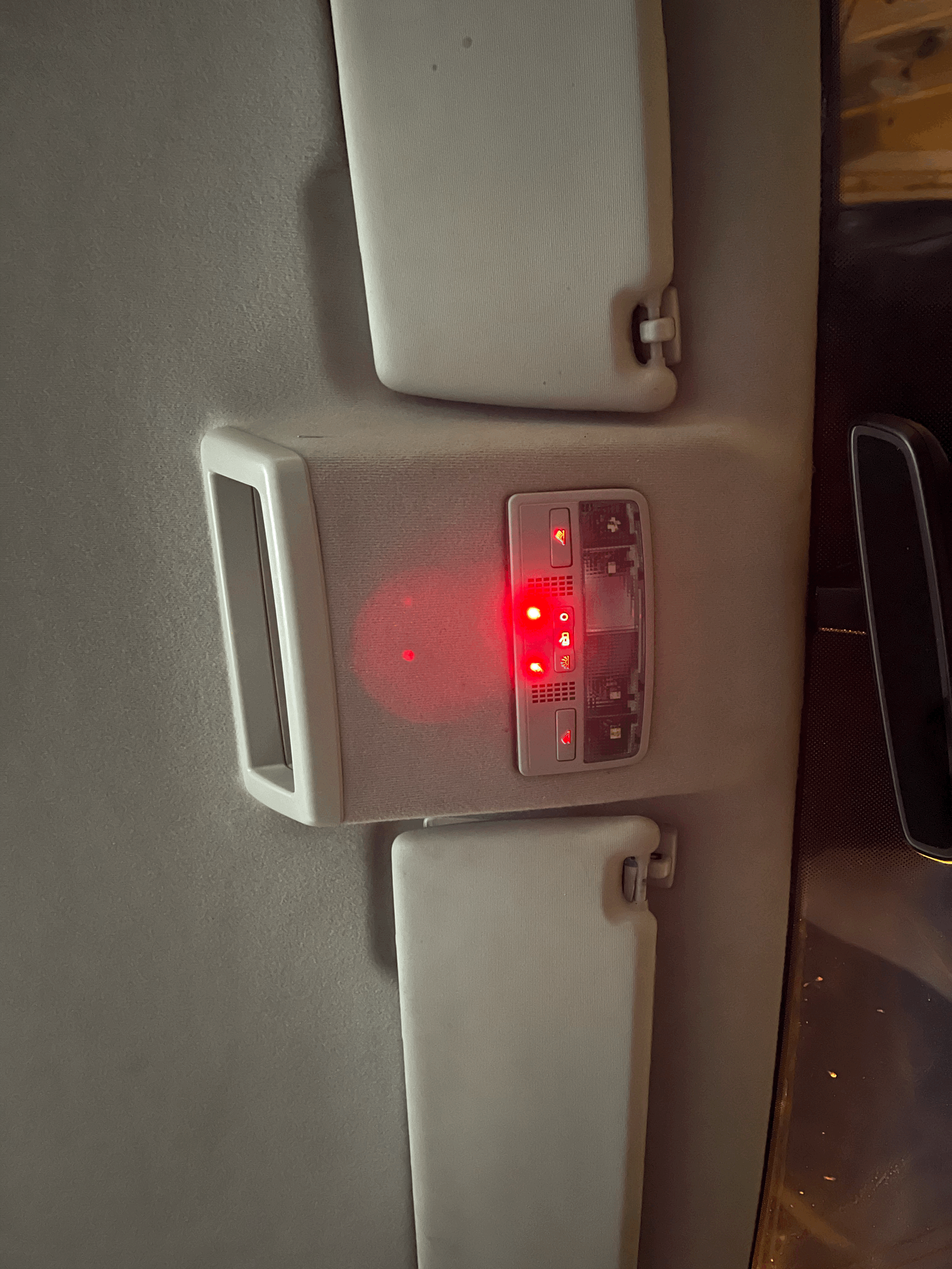

Finally I found some time to deal with the doom lights ...
It looks great, the only issue I couldn't solve was that the lights don't turn on when I open a door
I swapped back to the old doom light and the issue was gone
Posts: 8992
Re: BCM Max Transporter 2013
8)
So the puzzle is clear (and it is very easy to solve having a multimeter handy).
Either the pinning of the adapter wiring is not correct, or the electrical/electronic circuit of the dome lights is damaged.
Run the dome lights with a battery on the table and find out what the problem is. (with a 9V battery and two cables is enough... :lol:)
To check on the table you must place the main switch in its central position.

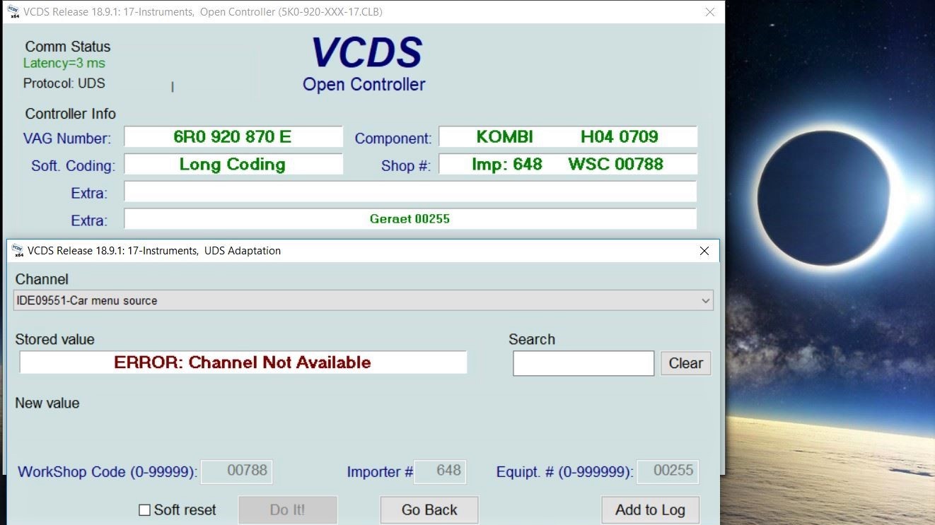

ciclo wrote: Sun Jan 24, 2021 5:12 am looking for a new menu ...
Convenience and/or Lights and Vision (CH/LH)
Another example :arrow: https://uk-mkivs.net/topic/20240-highli ... ntry761427
According to the information I have available, by activating the adaptation channel "Car menu source" and configuring it to "Version 1", the mentioned menus are activated in MFD.
This happens in the instrument clusters for PQ25 that are sold in South America, ... Gol, Fox, Suran, etc ...
The source from which this information comes is from the BCM or a unit that I think is called VW i-system for PQ25. (depends on the date of manufacture)
I have dumped the eeprom data, by blocks / sectors, from a 5Z0 920 865 A H07 0010 instrument cluster (which has the mentioned menus activated and whose data structure is similar) in the eeprom of my BlueGT IC (except IMMO data, logically).
In each block/sector I have been checking with VCDS if this adaptation channel changed to available, ...without success.
Not available.🙈

BTW, did you solve the W8 dome lights issue?

Unfortunately not, I am so lazy in the winter, today I had a free time, But I preferred to retrofit the Fog lights loom, I will post a scan later

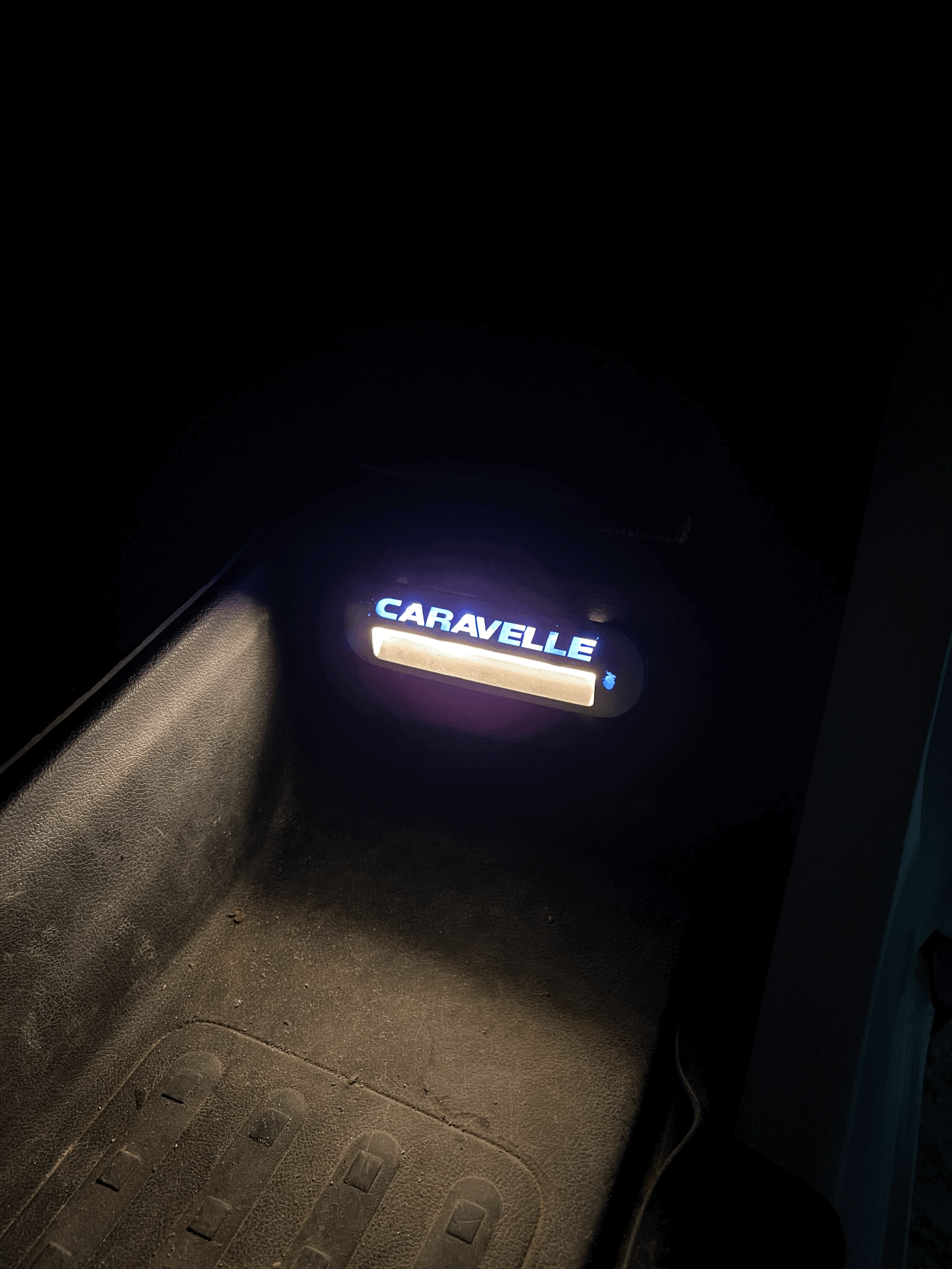

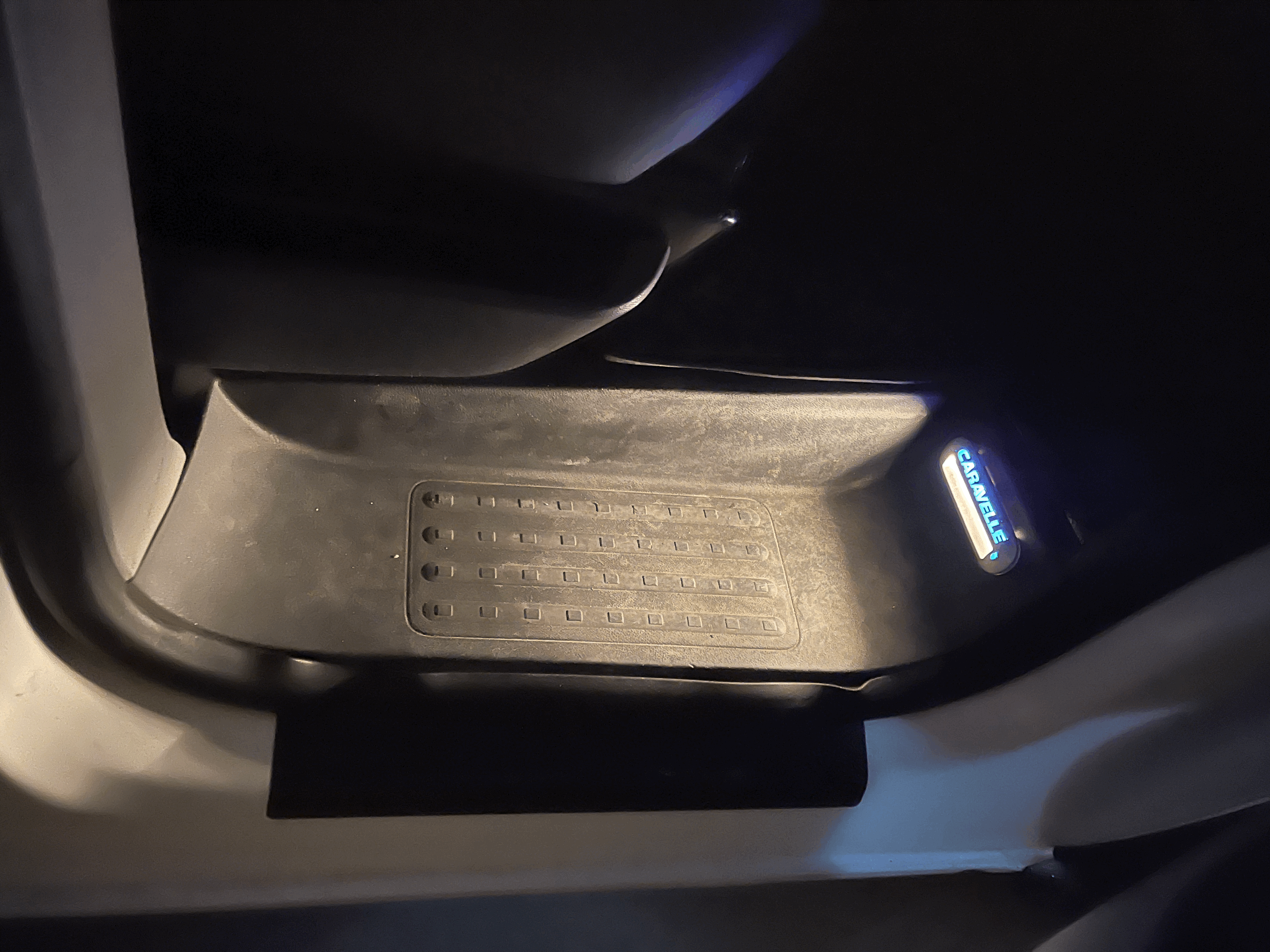

Bonus Job :-
Footwell lights:
+ve T73a/65
-ve T73a/4
as you mentioned
Is was a nice sunny weekend :D
Posts: 8992
Great, well done!
Nice access lights/footwell lights on your T5. 8)
