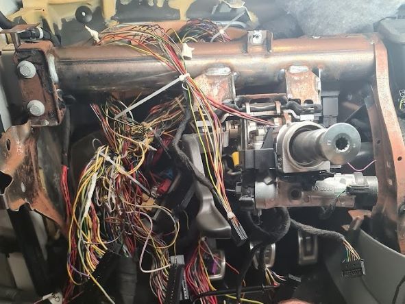

Finally I was able to allocate some time to work on the bcm conversion and fix some other things
OMG ! it was a very time consuming process and definitely not for the faint hearted.
Because I am a tall guy the option to remove everything instead of crawling underneath the dash was more viable.
I rerouted most of wires and added some new as needed. it took me 4 evenings after work.
Added some extra things in the process like Front assist radar and High beam assist mirror.
I need to flash the mirror to pq25 and code the radar (maybe remove component protection) - Pending !
I made same coding alterations to bcm but as I am not so familiar with that level of of configuration , I will share it here to get usable info.

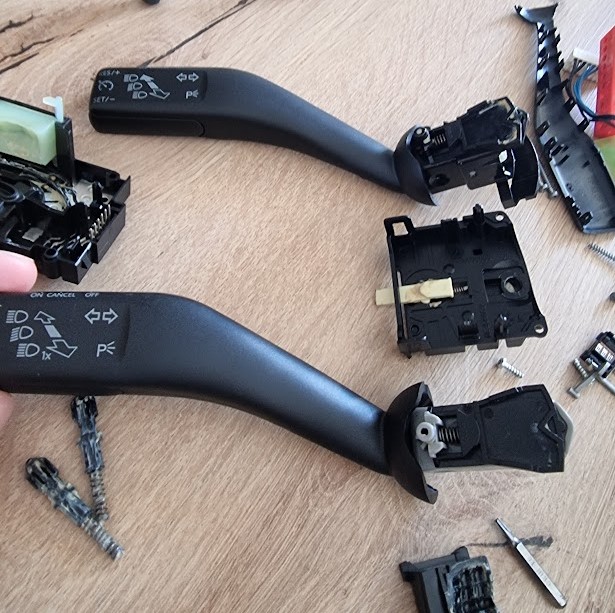

I am using a 5GG light switch temporarily because I am unable to find the one that I need , it may raise some issues.

Also I bought a used golf 5K0 hba stalk hoping to convert my 6RA to non-latching with the correct icons but this was not a match.
Stalks themselves (if you disassemble everything) can be interchanged but you cannot interchange the non-latching part because it is physically different.
