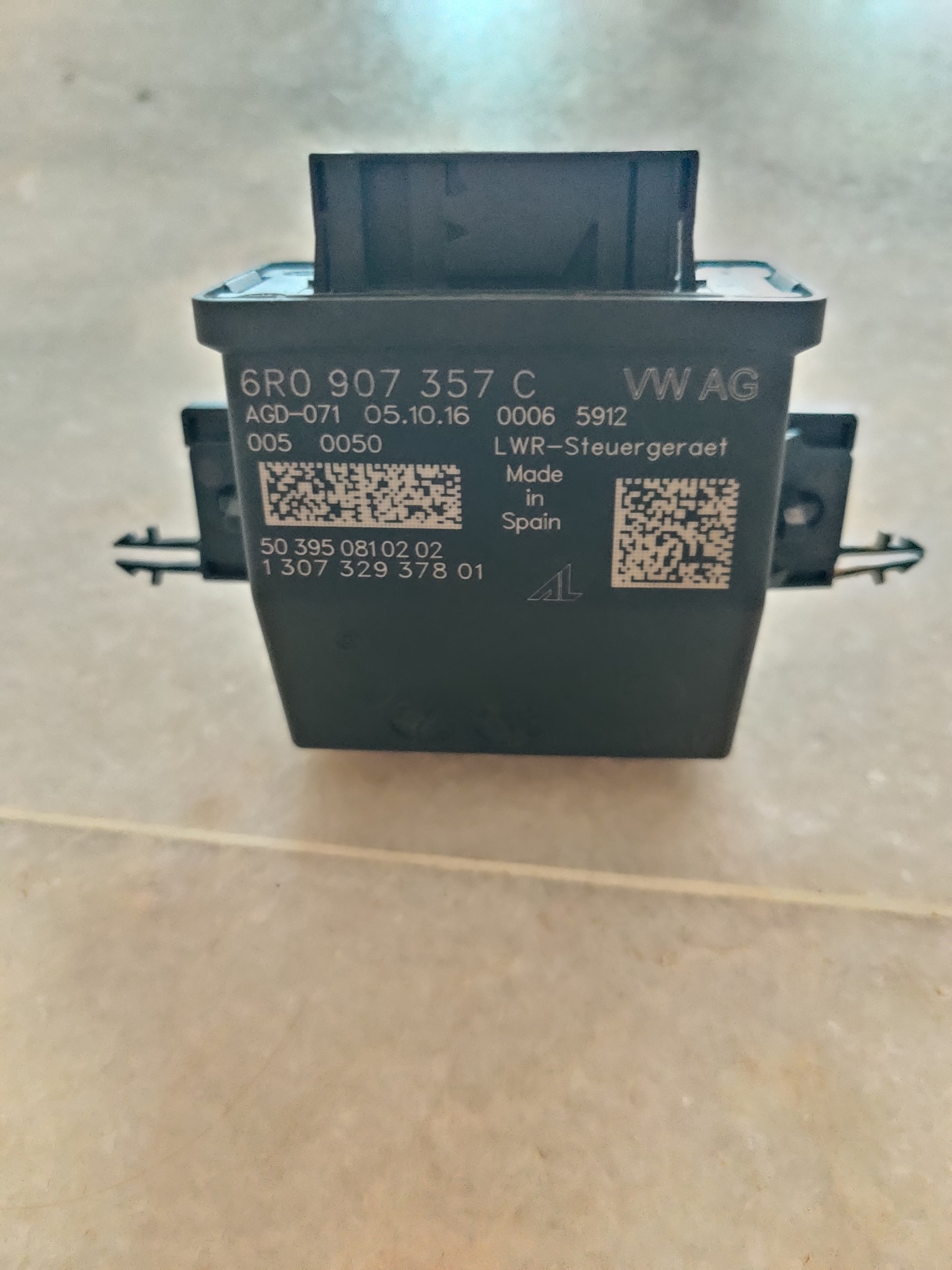

I finally got the C version of AFS Yesterday.
After installation, I updated the AFS code to the one used & shared by iichel and height adjustment worked right away :D. Thank you iichel 🙏
And a big thanks to Ciclo for guiding me in the right direction 🙏❤️

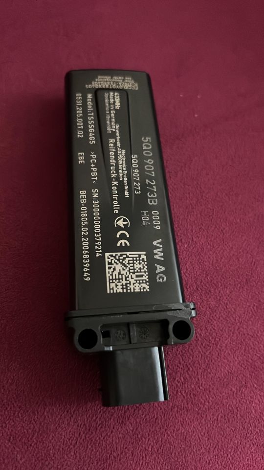

Hi Guys,
I am catching up after a long time. A lot has happened since my last update on this thread.
1) Auto folding ovrm
2) Golf 8 Steering / CCE
3) Upgrade to the front brakes to 288MM on the 17" Skoda Vega alloys & the judder.
4) GTI Interiors
5) TPMS
6) Front seats re-upholstered
And a whole host parts lying around for planned upgrades

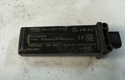

In October ’24, I purchased a new 5Q0 TPMS antenna from a Chinese seller on AliExpress with the intent to flash it with the 3AA firmware, as the genuine 3AA antenna with the “F” suffix was prohibitively expensive. At the same time, I bought a set of 3AA TPMS sensors. I installed everything, but the antenna refused to flash using ODIS or VCP. After researching, I discovered I wasn’t alone—others reported the same issue on drive2.ru with no known fix. The antenna could not detect the 3AA sensors, and even if it did, my cluster, running firmware 0729, likely wouldn’t display it.
This particular TPMS antenna was advertised as compatible with the MQB platform, but we also tested it on a 2019 Skoda Superb, where it failed as well. So, when buying TPMS antennas from Chinese sellers, be sure to do thorough research.
A few days later, I found and purchased a genuine 3AA907273B antenna. By then, the tire pressure sensors were already installed during routine tire rotation. I managed to flash the new TPMS module from firmware B to D using ODIS, but I still can’t get it to update to firmware F, no matter what I try. This is a Beru unit with specific hardware.
3AA Antenna.png (209.39 KiB) Viewed 5503 times

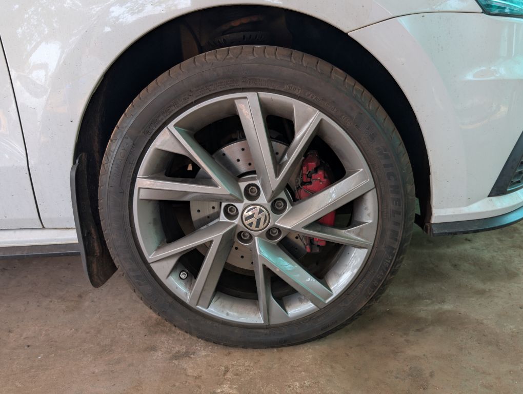

Between December ’24 and February ’25, I installed a new set of Brembo drilled front rotors. However, during installation, we found that the 288mm calipers were rubbing against the Vega alloys due to offset differences—the stock Portago alloys have an offset of 45, whereas the new 17" Vegas have an offset of 39.
To fix this, we installed 7mm spacers on both the front and rear. After returning the car to me, I noticed a pronounced vibration in the steering wheel at speeds close to 60 km/h, which made me hesitant to drive faster. Eventually, we discovered the alloys were not properly seated on the hub, so we reduced the spacers to 4mm. This resolved the vibration issue.
