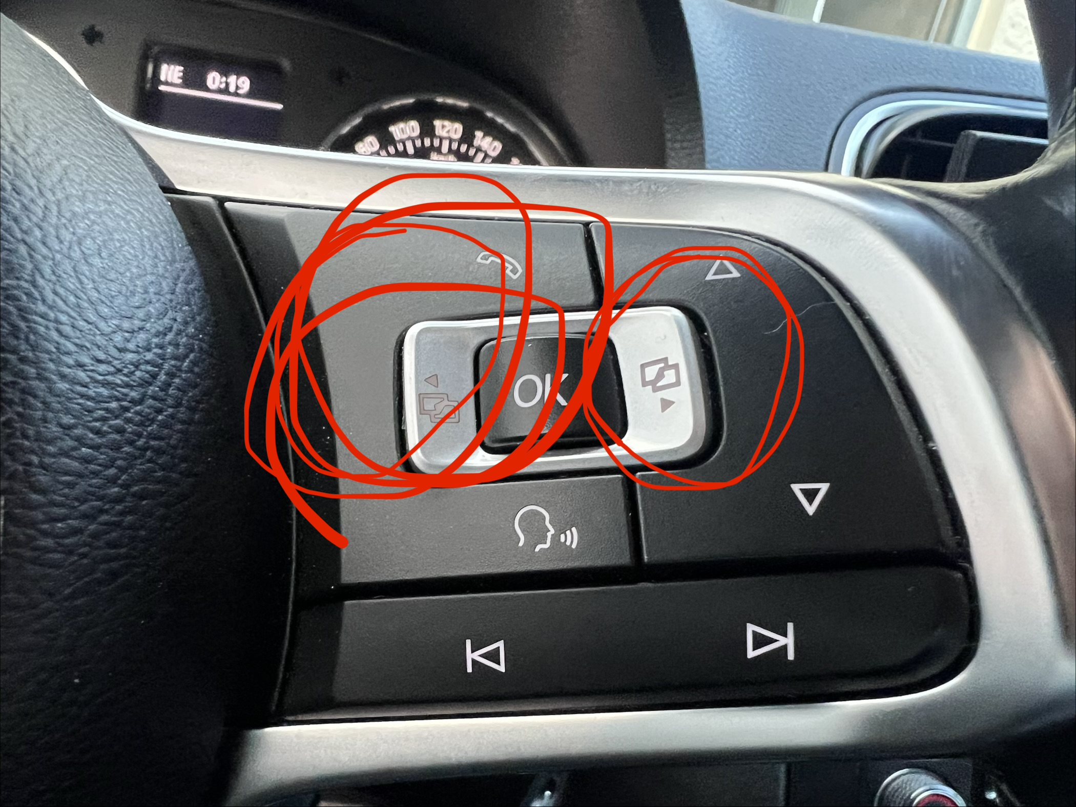

Hi, I connected the new BCM 090 C, but the MFSW and the instrument cluster don't work.

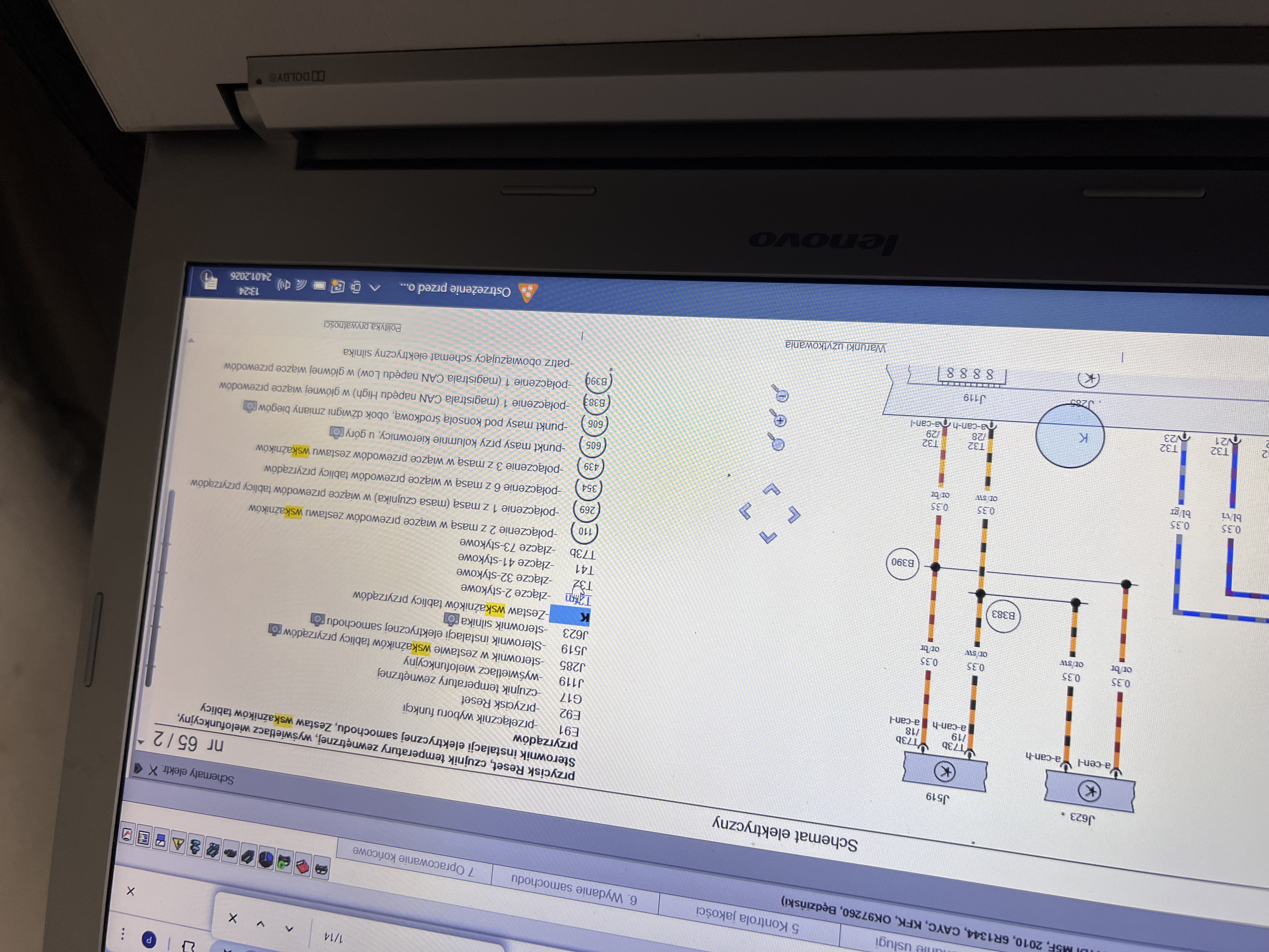

I got it wrong, sorry about that 😅 Luckily, I’m in luck — my rocket already has wires 28 and 29 plugged into the instrument cluster connector, so all I need to do now is repin the BCM connector and everything should work.
I’ll also send you how everything is currently wired in my Polo according to the VW wiring diagram. I’ll finish the rest of the work when it gets warmer, because doing this stuff at −1°C isn’t much fun 😄

Hello, I installed BCM 7e0937090C and the two buttons on the steering wheel that I wrote about earlier still don't work.

Post by GreatBoss »
Ciclo master, do you have any idea about this?
