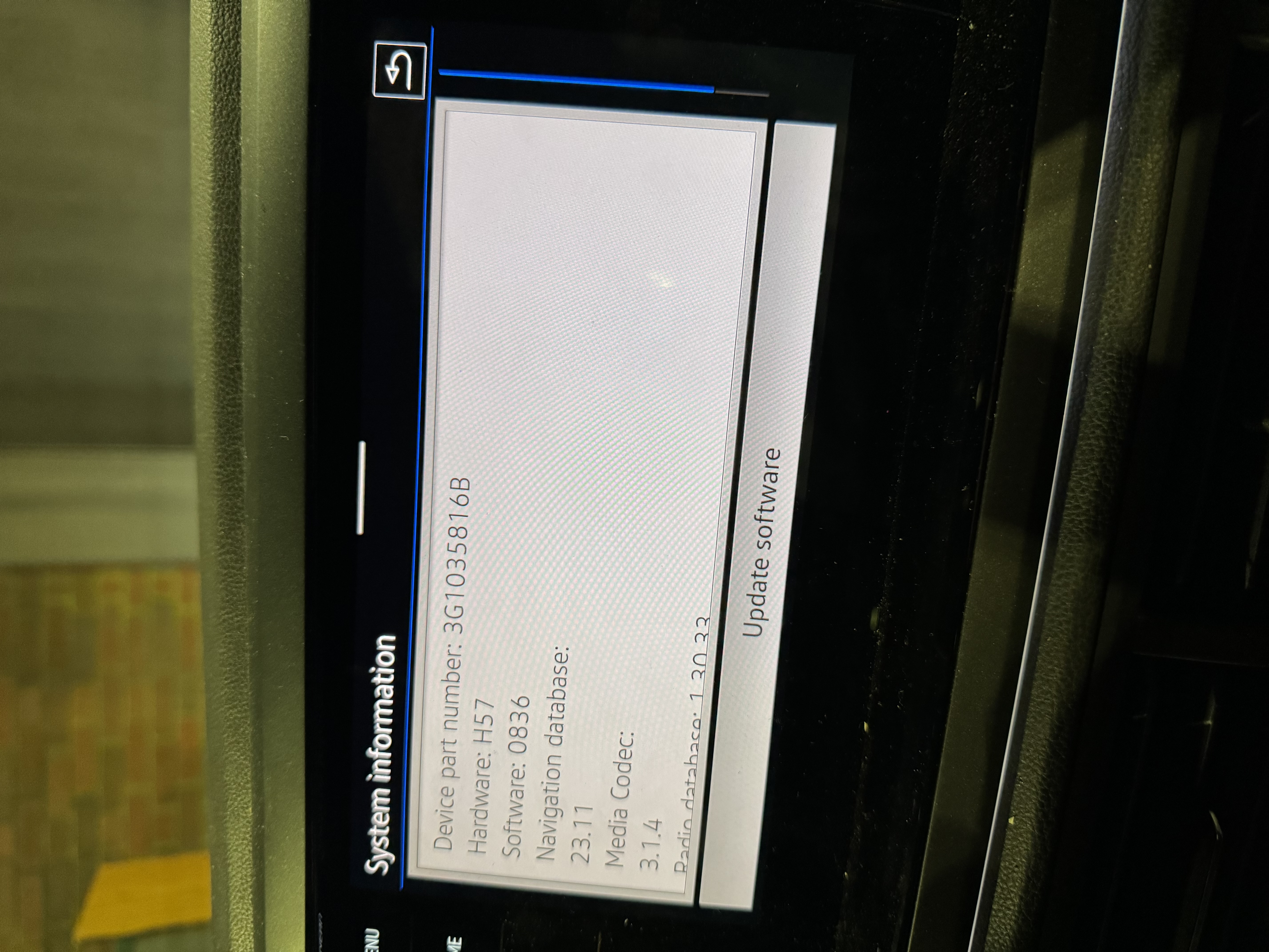

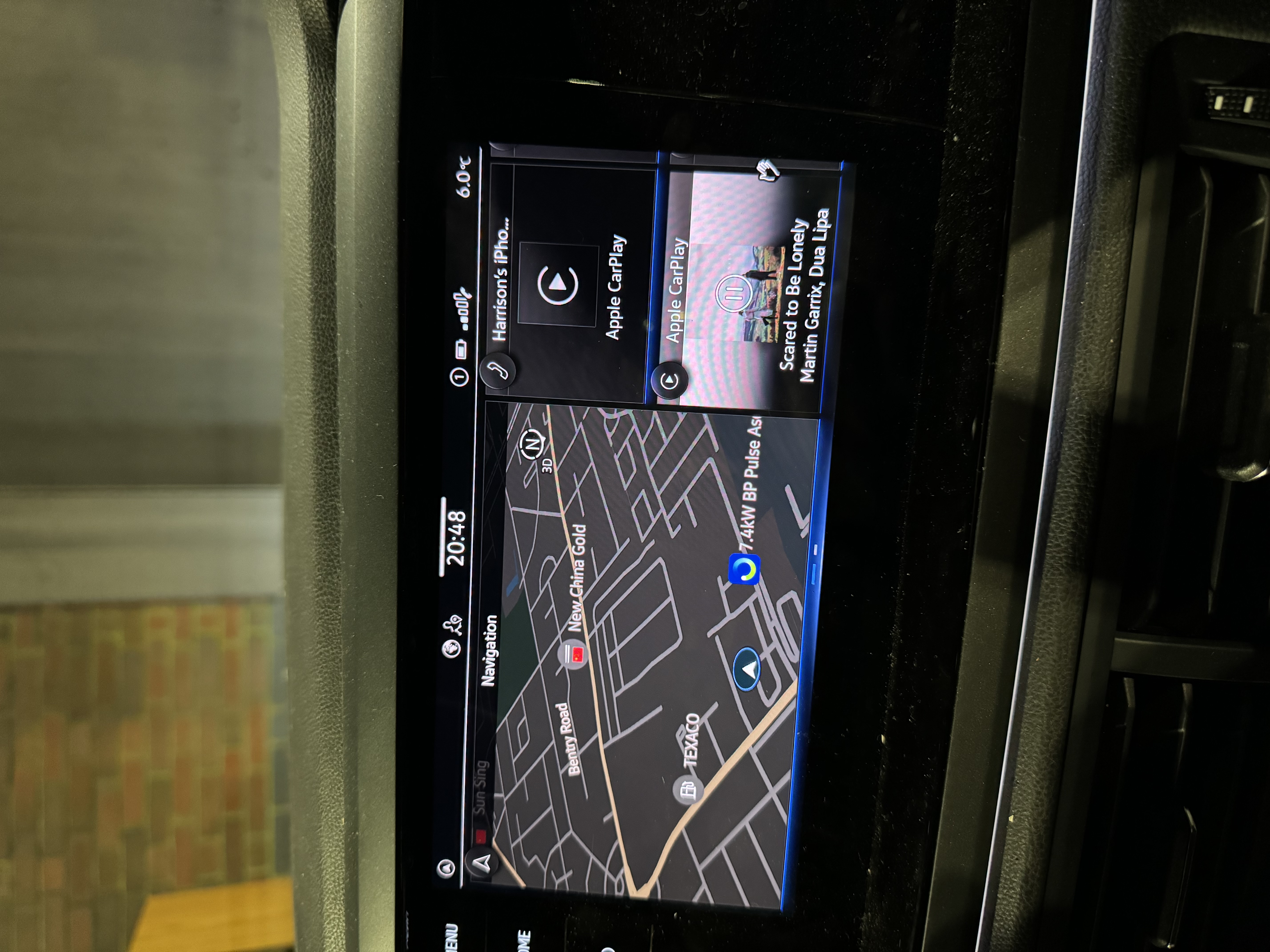

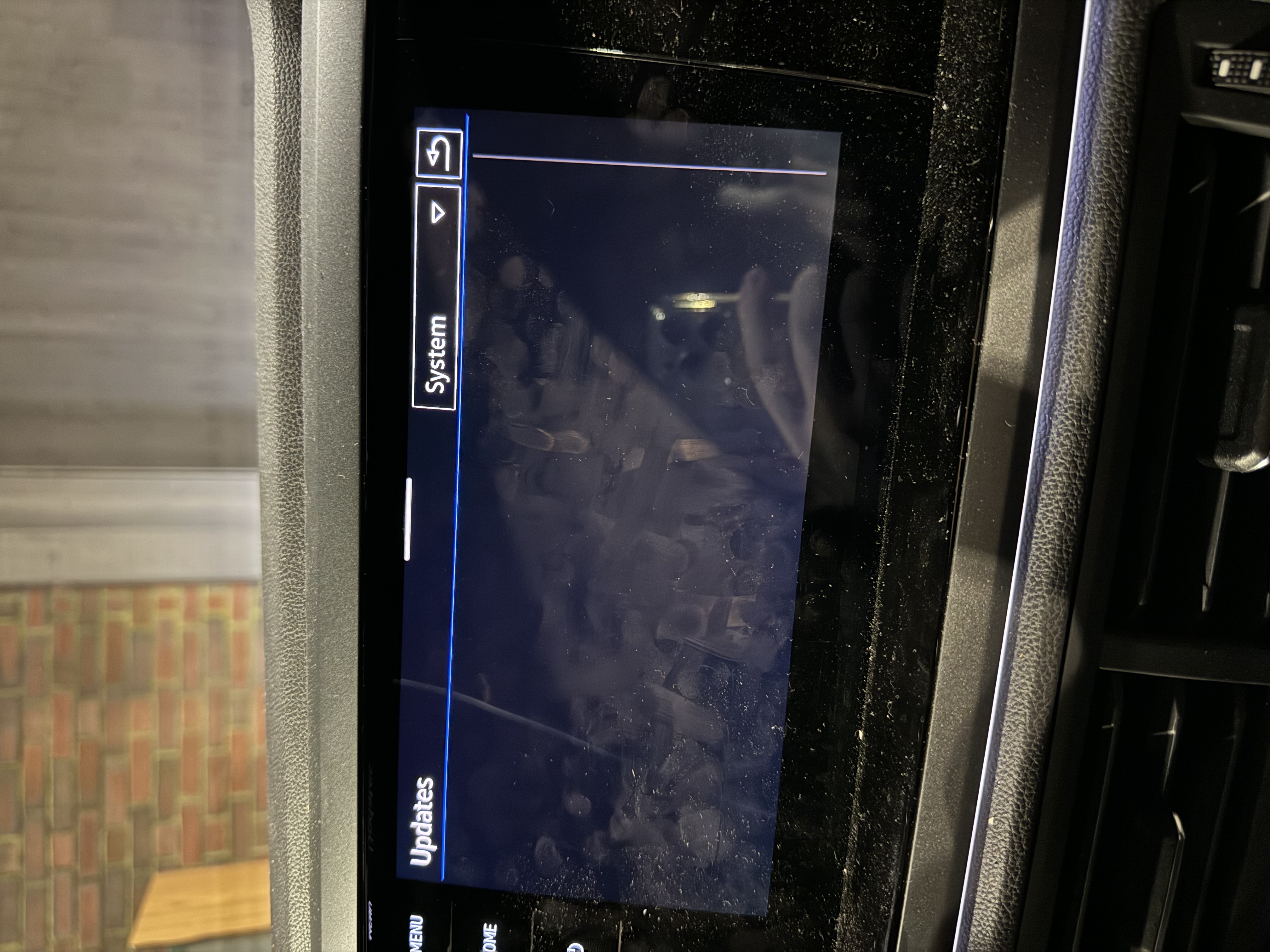

I’ve tried to update mine many times. Sometimes the notification randomly pops up saying update and if I press yes it will say that it can’t do it as I’m driving. Once that message disappears it’s very hard to predict when it will next show, and I’m going to make sure that I’m at a stand still when I accept it. My software screen looks like this when I manually try to install it, (no update is showing) see photos attached.

MikeDO
- Posts: 246
- Joined: Sun Mar 13, 2022 5:57 pm
- Drives: GTI 2022 (white)
- Location: SW Scotland
Re: Oug8 update showing in car,could not download
Looking at your last photo, you have "1" update waiting to be applied.
Try (as suggested a few posts back) swiping down from the top of the infotainment screen and then swiping left (or right, depending on your viewpoint) and it should be there waiting for you.
Good luck.
PS. I've NEVER seen an updating waiting for me going view "updates" screen shown on your photos. But doing as I suggested above, there's one sat there waiting for me to apply it. Not like it will actually do anything!

Harrihealey02
- Posts: 261
- Joined: Sun Dec 23, 2018 12:33 pm
- Drives: 2018 SEL
- Location: Essex
I managed to do it! I did what you said, swiped down from the top and then swiped to the left to see the notifications and is now updated! Thanks

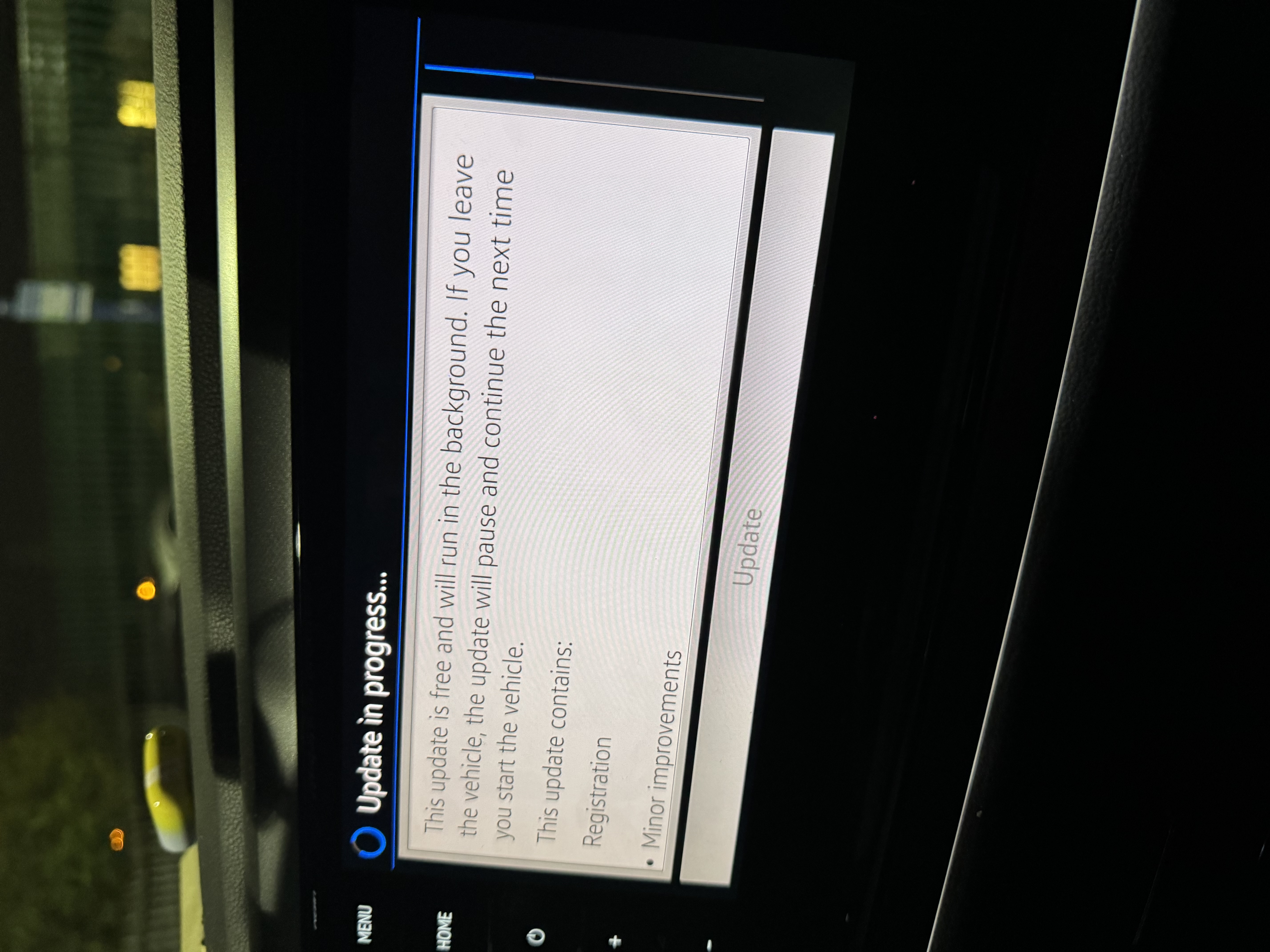

Does anyone know why the update notification (IE. the circle top left of the screen that looks to show the progress) when applying an update, is sometimes blue (as above) and sometime red (as in the case of my apparent "stuck" update)???

Once again "I don't believe it"!
After a month of trying to get this update to install. I noticed today that there were two other updates queued to download/install. No indication what they were. But both downloaded/installed quickly and soon after that, the original "stuck" update returned (see above picture). This then proceeded to quickly install itself.
So my guess here, is that the first two small updates sorted something. Allowing the original one to then install correctly. But who knows really I suppose.
