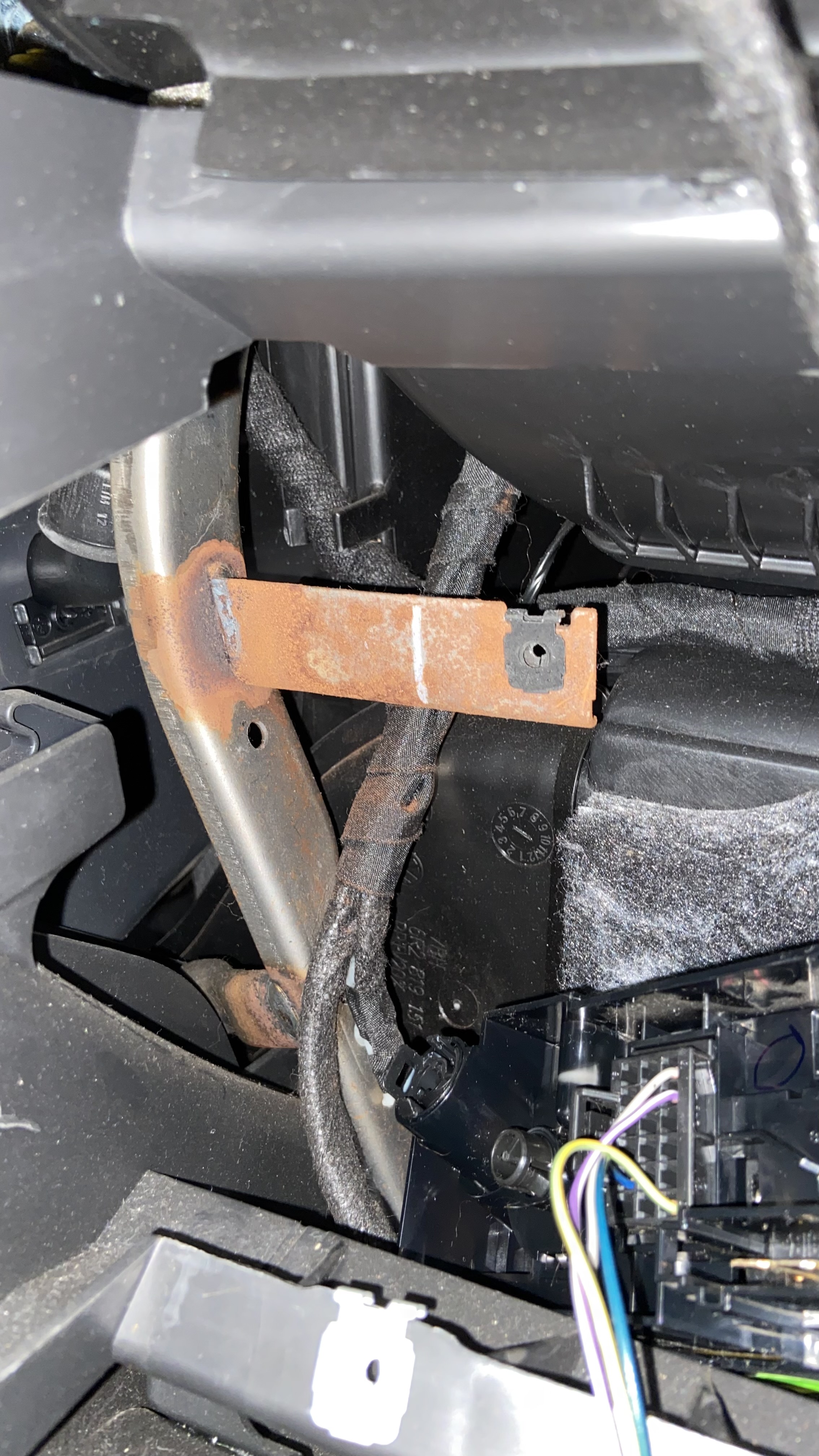

I had really good success with taking out the interior + seats to clean today: It’s all back together now: I wonder why VW uses metal that develops this rust over time: It’s really annoying to see when they should have coated it or used a different metal that is more rust resistant. Is there anything I should do to treat this surface rust?

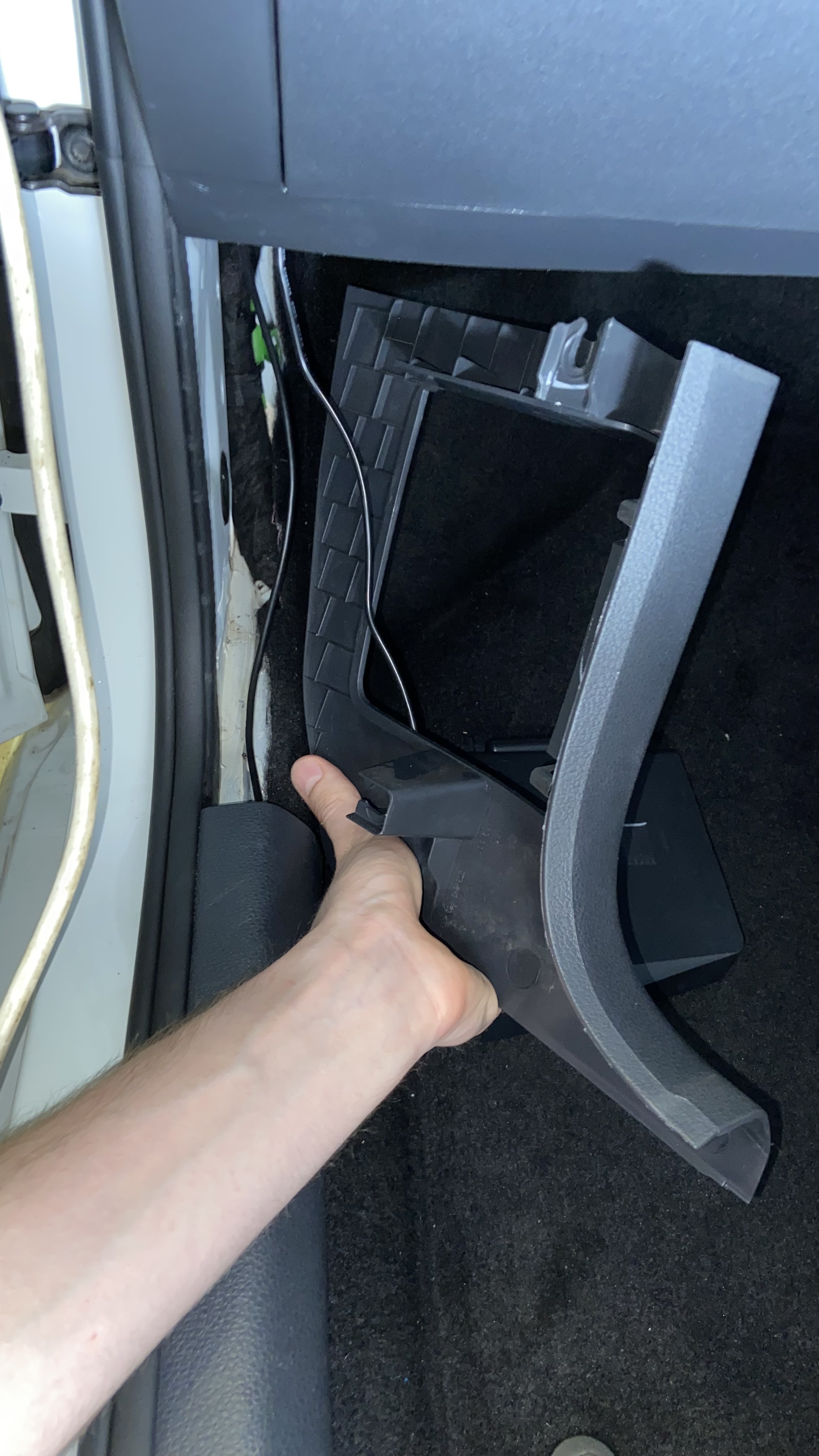

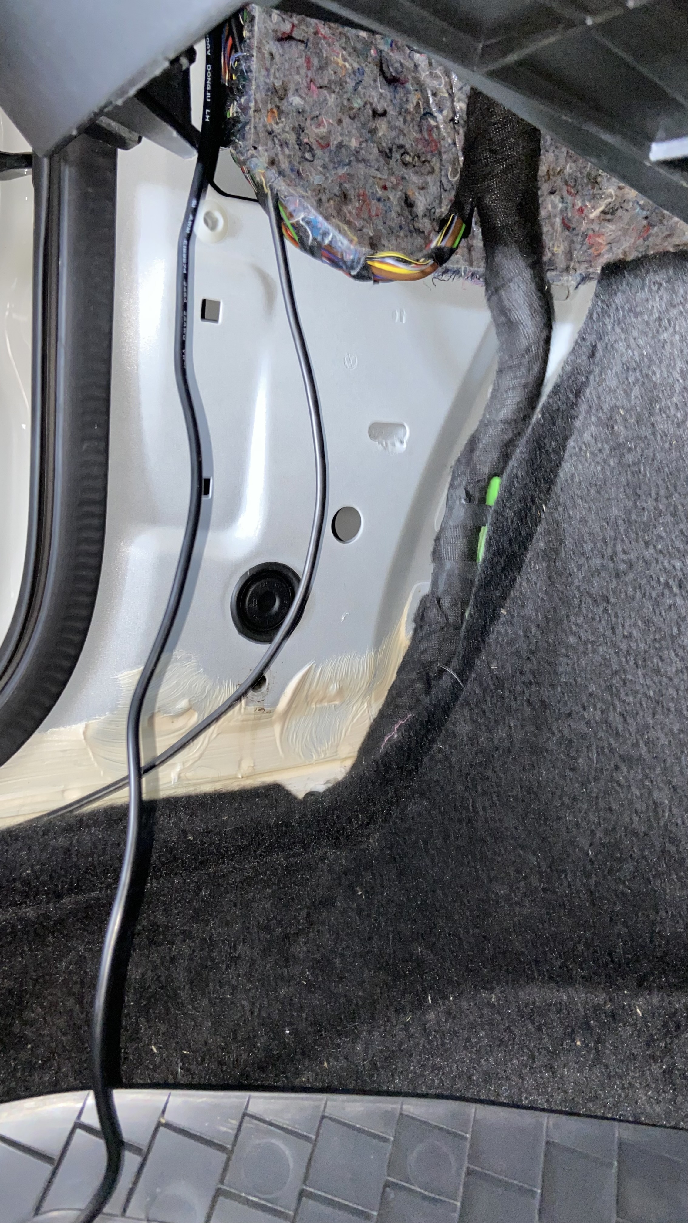

I noticed this panel for the passenger footwell storage compartment was not clipped onto anything: Does it look like it’s missing a clip on the body? Unrelated, but I had a brief interaction with my neighbour and I was talking to him about changing spark plugs and he said to never torque spark plugs with a torque wrench and insisted on doing it by hand. This sounds wrong to me, right?

Good job R!
A very rewarding job for at least a couple of days.
That rust is known to us.
I think like you, I believe that it begins to originate at the moment in which the visible welding is made, although logically it is not visible at that moment.
Whatever method you use to remove/clean it, remember that it is an interior part and that harmful/unpleasant odors will subsequently be produced from any product you use when the vehicle is closed. So don't put too much effort into the process of removing that rust, put more effort into cleaning it.
That lower A-pillar panel/trim is held in place by two clips. Each clip consists of two parts. They have a tendency to get lost.
3C0867333
3C0867333

I agree that seeing these parts, which tend only to be dashboard stiffeners, with surface rusting is annoying, why the welding sites could not have been cleaned up and these parts have their top coating/treatment carried out AFTER the welding>cleaning is an unanswered question, though as said already, this rusting will never ever end up being any more than cosmetic and annoying when discovered for the first time.

I think I’m probably going to leave the rusted bits. Attempting to clean them is probably more trouble than it’s worth.
The part number for the clips looks to be right. I’ll get some ordered because like you said they appear to have vanished.

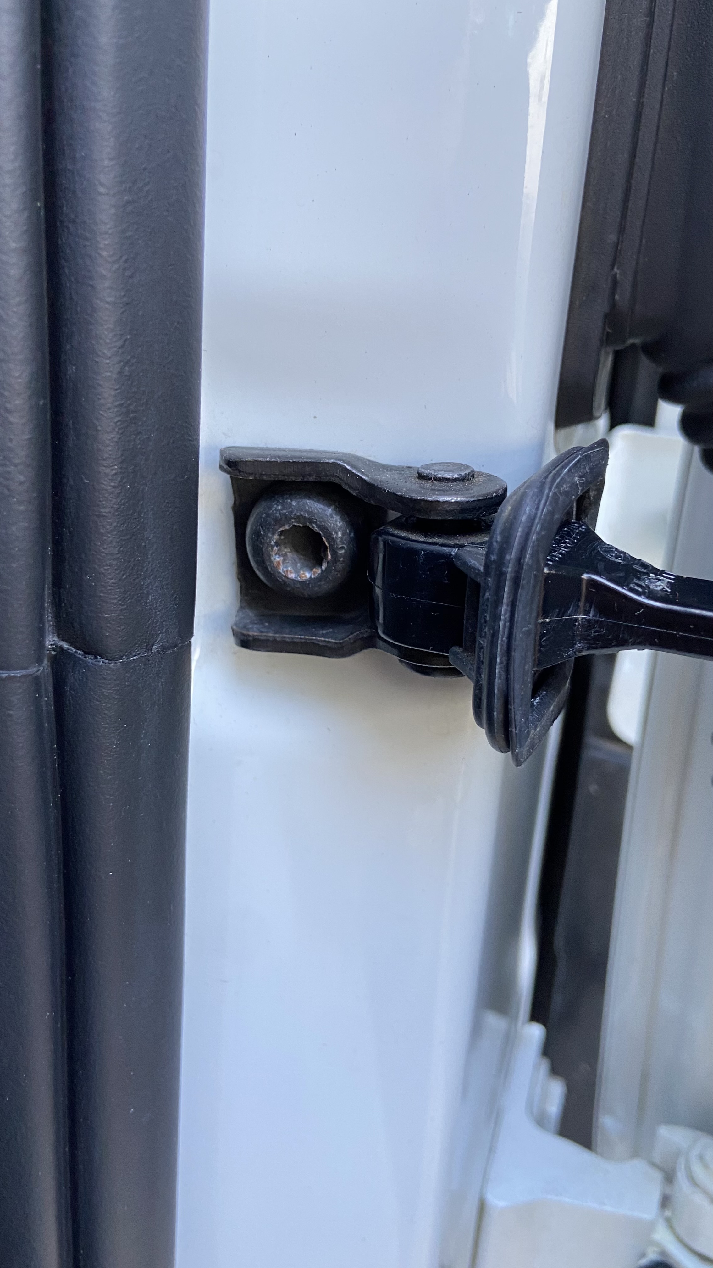

On another note, what is the image number for the bolt that holds the black part of the door assembly? I searched through the whole of group 8 (body) on ETKA so I must be overlooking it.
