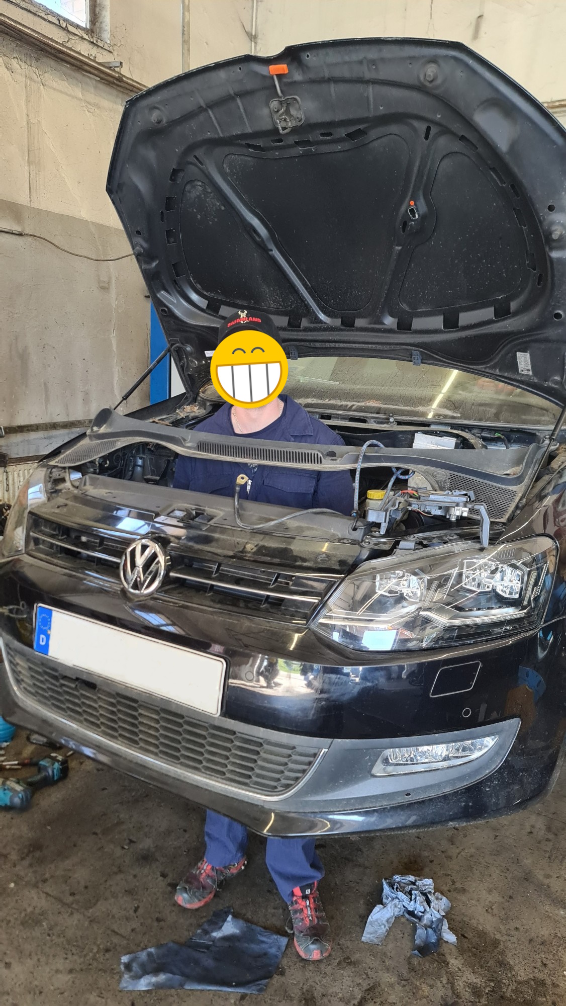

Now here the promised pictures:
My extremely helpful colleague, happily standing in my completely stripped out engine bay:
Jemand im Motorraum.jpg (773.85 KiB) Viewed 4343 times
And my kind of finished looking engine bay about three hours later (ignore the crooked wiper :lol: ):
Eingebauter Motor bearbeitet.jpg (1.04 MiB) Viewed 4343 times
Things left to do: driveshafts (yes I know I should have done it right after putting the engine in), AC compressor, alternator, belt, exhaust system, starter. In other words: Just a few hours of work left and I might hear my car come back to live after more than half a year :D

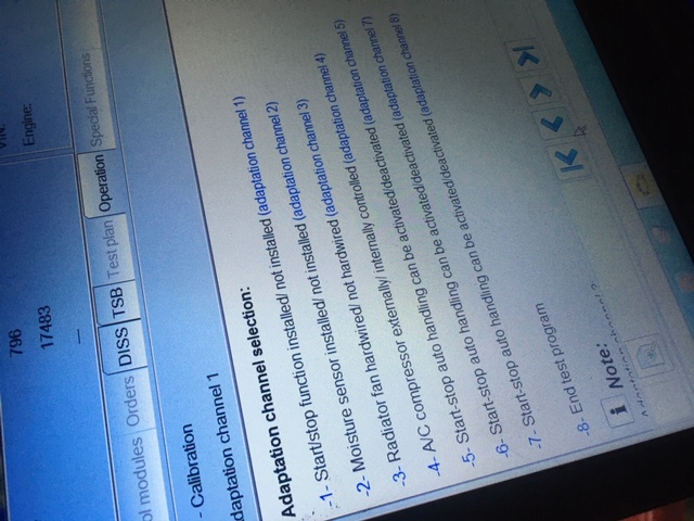

Re: Pauls Polo 6R Trendline conversion road to OEM++
change some adaptation channels in 08 hvac to fix the fan issues
Paulpelz
Posts: 50
Joined: Thu Jul 07, 2022 11:42 pm
Drives: Polo 6R 2012 Style 1.2 -> 1.4 TSI OEM++
Location: Berlin
Post by Paulpelz »
Thanks! That has got to be it!
Sadly, there are no labels in VCDS for the adaption channels, so I just guessed and changed the following:
Ch 1: 0 -> 1
Ch 2: 0 -> 1 (I installed one of these coombined rain and moisture sensors ages ago together with my high beam assist conversion)
Ch 3: 1 -> 0
Ch 4: I don't know the value, but I haven't changed it
Ch 5-7: 0 -> 1
Now it stopped moaning about the missing wires, but instead started infoming me about being coded wrong. So there is still some experimenting left to do. But thanks Michel, without your picture i would never have been able to fix that issue. :D

A few days later, and nothing changed. Well, that's not completely true. I fixed a knocking in the steering assembly (it turned out we forgot to tighten the nuts of the tie rod ends... whoops :lol: ), also I installed the underbody covers and fiddled a bit with the exhaust, so that it doesn't touch the heatshields anymore. Though I am still not completely satisfied with the result as the tips don't sit absolutely perfectly in the middle of the bumper cutout... that's a later problem.
Concerning the start-stop-button I still haven't found the solution. Start-Stop itself is working on the other hand, so I might just procrastinate on that problem a little bit. For the technical inspection it just has to work at all.
Now my question for the day: Is there a possibility to test the 2-Cylinder-Mode on the car? I mean: other than to actually drive and accidentially stumble across the narrow area where it will switch the two cylinders off? Maybe a VCDS readout or something? Because I don't know if my instrument cluster will display the message, since it is out of a Toledo... :shock:

Paulpelz wrote: Wed May 29, 2024 2:35 pm Concerning the start-stop-button I still haven't found the solution. Start-Stop itself is working on the other hand, so I might just procrastinate on that problem a little bit. For the technical inspection it just has to work at all.
Wrong. I couldn't leave it alone. And it turns out I'm an idiot.
I wired negative cables to two pins that should have +12 volts. I have absolutely no idea how I f*cked this up. I'll fix it tomorrow and report again!
