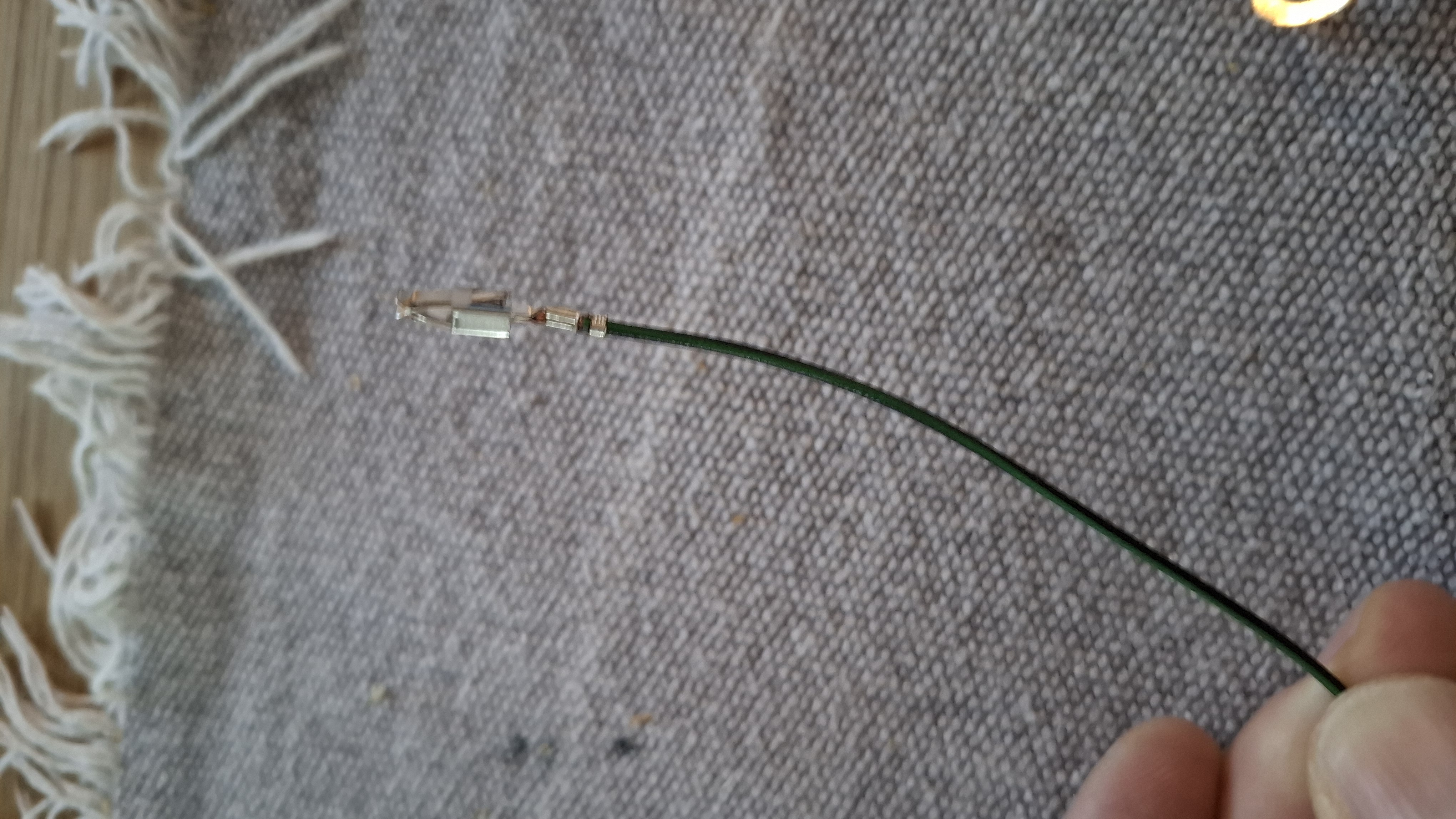

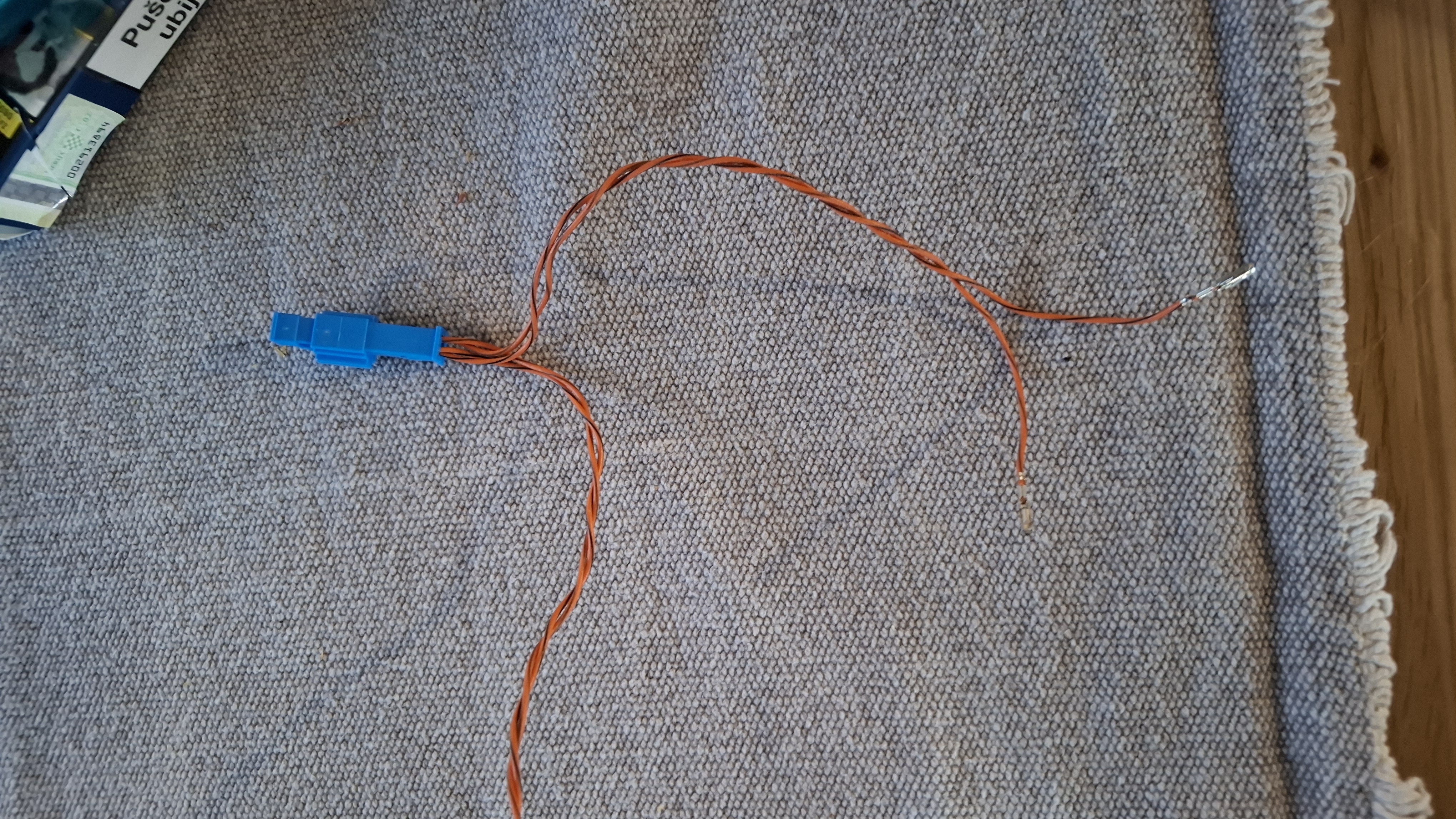

Hm. This is my setup of wiring for 4k ops. I do not know for what is the grren long wire that goes to the front? Wiring is from aliexp..there is no manual for connecting. Here are the pictures.Buci wrote: Fri Oct 24, 2025 6:52 amGrrat. The wiring has the solution for that, I reviewed it. But since I need your modul for 8k connection I decided to while I wait for your modul to connect 4k ops option. Can you tell me can I lay all the wiring for 8k but connect only the wires for 4k option? If so, as I see it I need only to connect two set of wires. Wiring from the modul to instrument cluster for can wires, and wirimg from the senzors to the modul. And the buzzer of course. Codimg vcds and that is it? On whiich side.of the trunck is modul for the left driiving cars?ciclo wrote: Thu Oct 23, 2025 4:40 pm The CAN bus lines dedicated to the PDC in the PQ25 are called "powertrain", this is also commonly used for the other PQ platforms.

You can connect everything; the module is the one that determines how it will work based on coding and SW capabilities.
With that crimped JPT terminal, the "green" wire is very likely the +15 (12V) power supply, but I can't say for sure since it's an aftermarket wiring harness... You can be sure by looking at the position it occupies in the T16 connector.

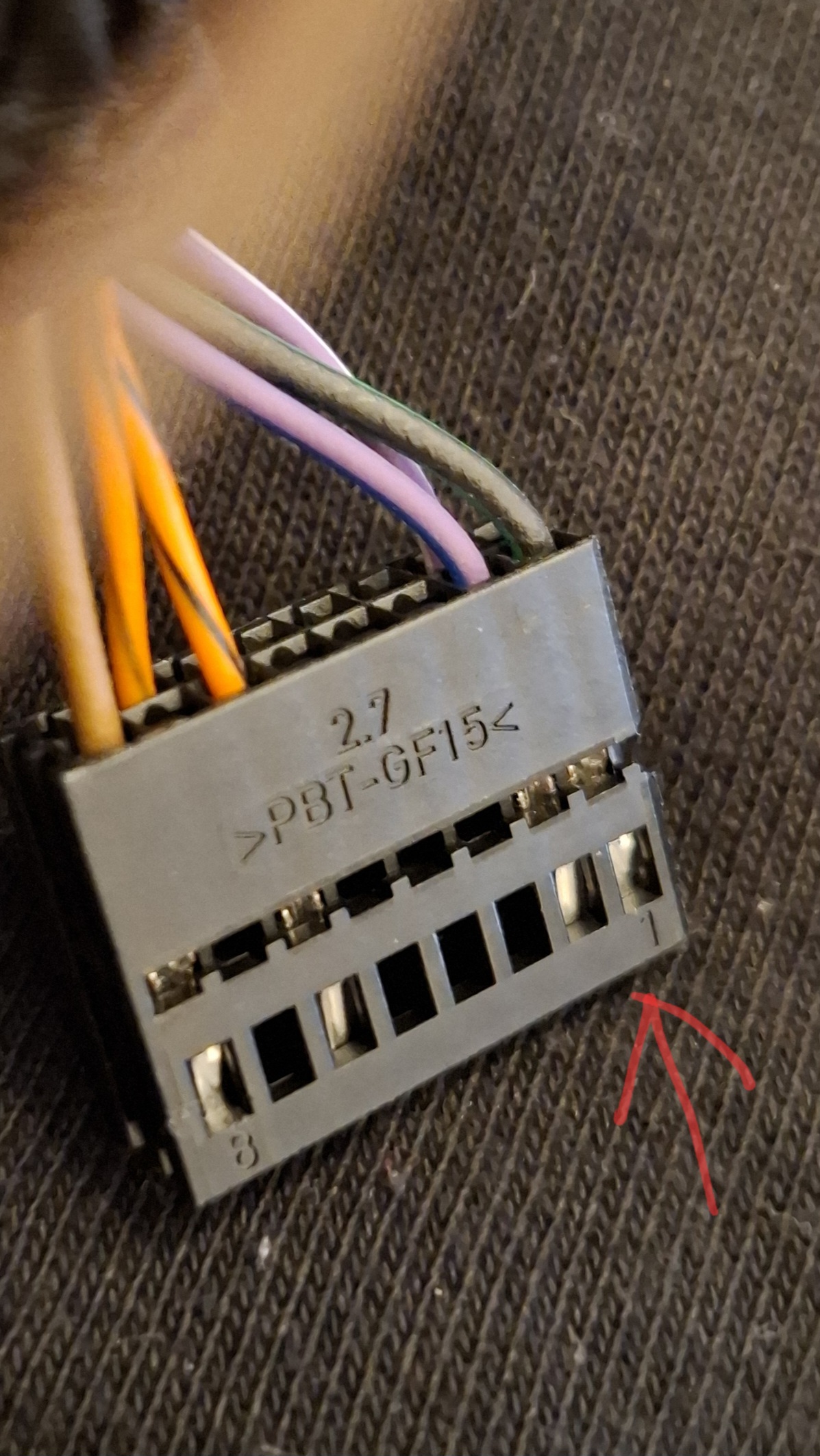

[/quoti I saw a lot videos online and pdf but nobody is talking about the jpt connection. I opened the connector and this green/black wire is on pin 1. So this is the 12V.
Thanks for the schematics. I am not so good in reading them but I eeady to learn. Can you tell where this wire should go? Fusebox? But how? I saw this jpt terminals on BCM when i did the wiring for the cruise control.

Buci wrote: Fri Oct 24, 2025 5:12 pmI saw a lot videos online and pdf but nobody is talking about the jpt connection. I opened the connector and this green/black wire is on pin 1. So this is the 12V.ciclo wrote: Fri Oct 24, 2025 8:00 am You can connect everything; the module is the one that determines how it will work based on coding and SW capabilities.

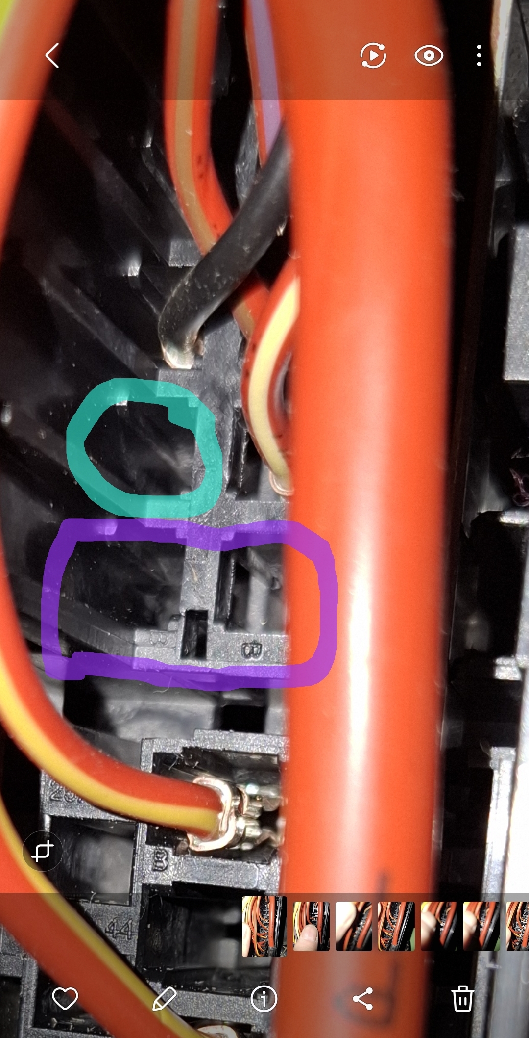

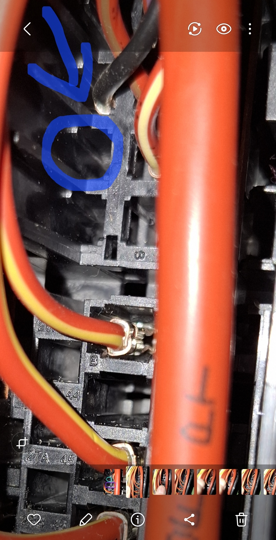

Can high and low 18,19 connected to bcm (my back is done!!)
Regarding fuse box I wanted to connect the +15 wire (12v) to the fuse place number 16 but i think that on the other side there is no wire? Can I use number 15 place because the wire is there?

I have a picture. Green is empty space for fuse number 15, next to him there is a wire (red/white).Buci wrote: Sat Nov 01, 2025 6:53 pmToday I started with the retrofit.ciclo wrote: Sat Oct 25, 2025 2:49 am The J446 PDC unit is installed in the same location for 6R RHD.
Download these PDFs (ask me for permission to download)
In them, you'll find the truth—I mean, everything you need to know... about what you're asking about.
It's hard to understand why people buy things they don't have the knowledge to do so. There are many tutorials and images online on how to do this job.
The money you don't pay to purchase these items without technical assistance is supposedly what you save because you already know how to install them.
...and yet, 'happily', you make others suffer the losses...
All the information in this thread is at least worth/costs three times what you're going to pay for this mod.
I already gave you a ridiculous price for 'my' 1K8 unit, which I offered you because of the timing of the situation, not because I was selling it like a predator, and the only thing that could happen here is for me to lower that price.
I assure you, I have no intention of selling many of the magical things I own; most people don't deserve them.
On place 16 both holes are empty, without wires.
What is the right place?

For ease of understanding, a fuse has an input 'A' and an output 'B'.
In the 6R SB fusebox, from fuse 9 to fuse 16 input A is the same for all fuses and is called the SUPPLY BAR. In this case it is a supply bar with a +15 signal (ignition switch ON).
Output B is where the systems/components are connected.
Therefore, you can choose any output B of this row of fuses to insert the appropriate terminal/wire and then install the fuse to protect and feed the system you are connecting.

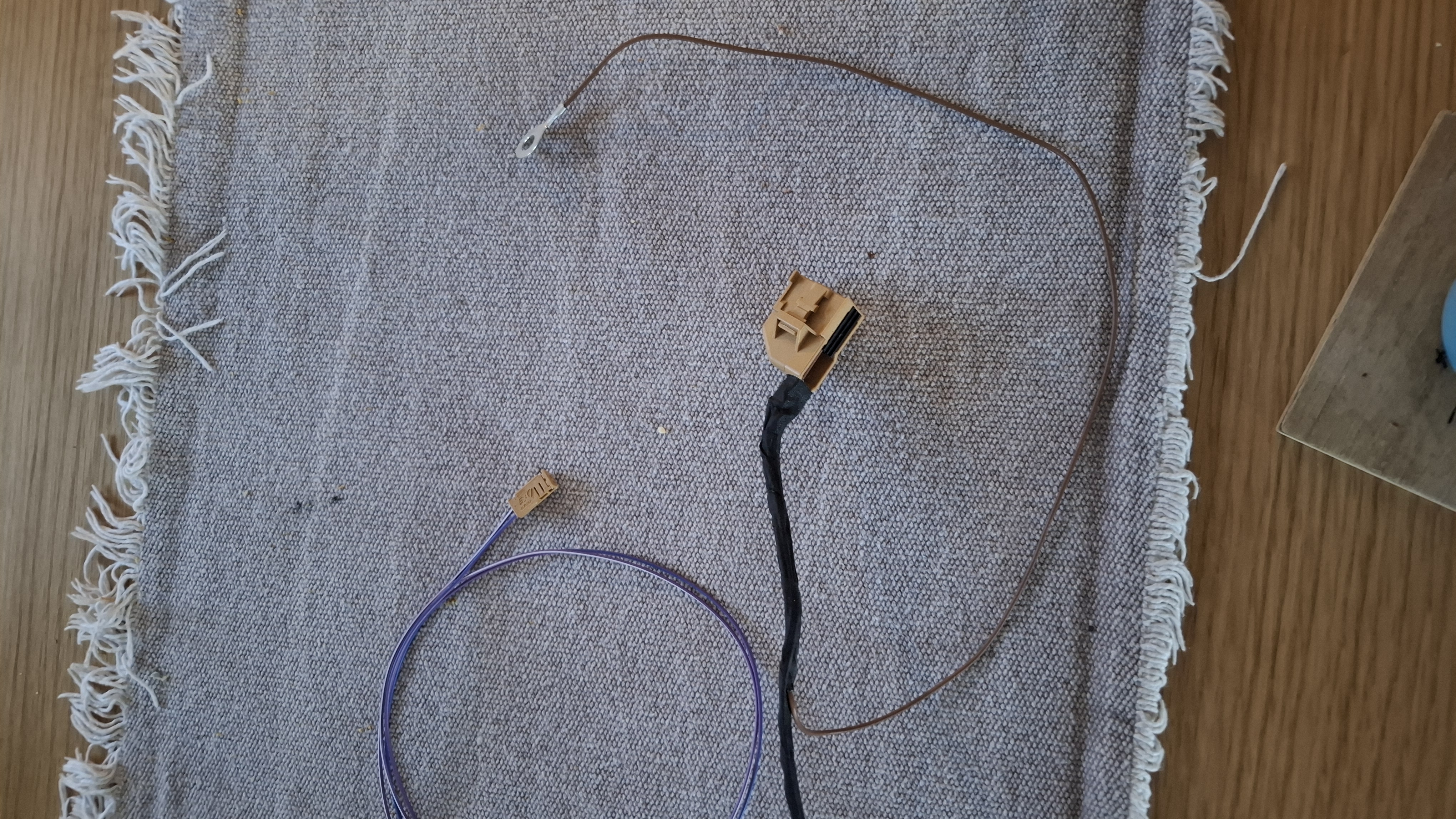

Thanks, but did I did it riight? Every fuse has two wires.ciclo wrote: Sat Nov 01, 2025 8:56 pm For ease of understanding, a fuse has an input 'A' and an output 'B'.
So I selected the fuse 15, that already had one wire input A and I connected the pdc modul next to it. Is that Ok? Picture can help.

Re: Parking Sensors
