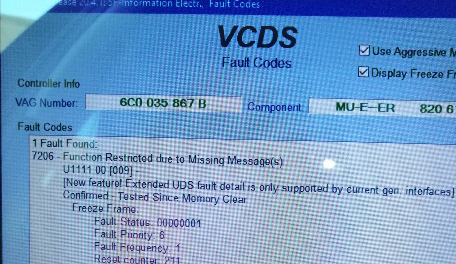

Heyy lichel In this way, error happens. Do you know what does it mean? Multimedya 5F
- IMG_20200921_170910.jpg (1.12 MiB) Viewed 3181 times

Without an extended view, it's very difficult to say what exactly is happening.
Does this error dissappear after you put back your ABS coding? Perhaps you can share a full scan of the vehicle?
Re: Polo 6R ABS CODING
When I encode it for multimedia esc menu, I get this error. Maybe something has opened defixient, can you please help me?
don't think it's a mistake to do with Abs coding.
5F I found these ref to the brake:

Perhaps check this one in your ABS unit:
MAS00120-Anti-slip regulation (ASR) activated 1
This is from a polo 6c with ESP off via 5F:
ENG122227-ENG117671-Car_Function_Adaptations_Gen2-menu_display_Brake_Function activated 60
ENG122227-ENG117675-Car_Function_Adaptations_Gen2-menu_display_Brake_Function_after_disclaimer not activated 60
ENG122227-ENG117672-Car_Function_Adaptations_Gen2-menu_display_Brake_Function_clamp_15_off not activated 60
ENG122227-ENG117673-Car_Function_Adaptations_Gen2-menu_display_Brake_Function_over_threshold_high activated 60
ENG122227-ENG117674-Car_Function_Adaptations_Gen2-menu_display_Brake_Function_standstill not activated 60

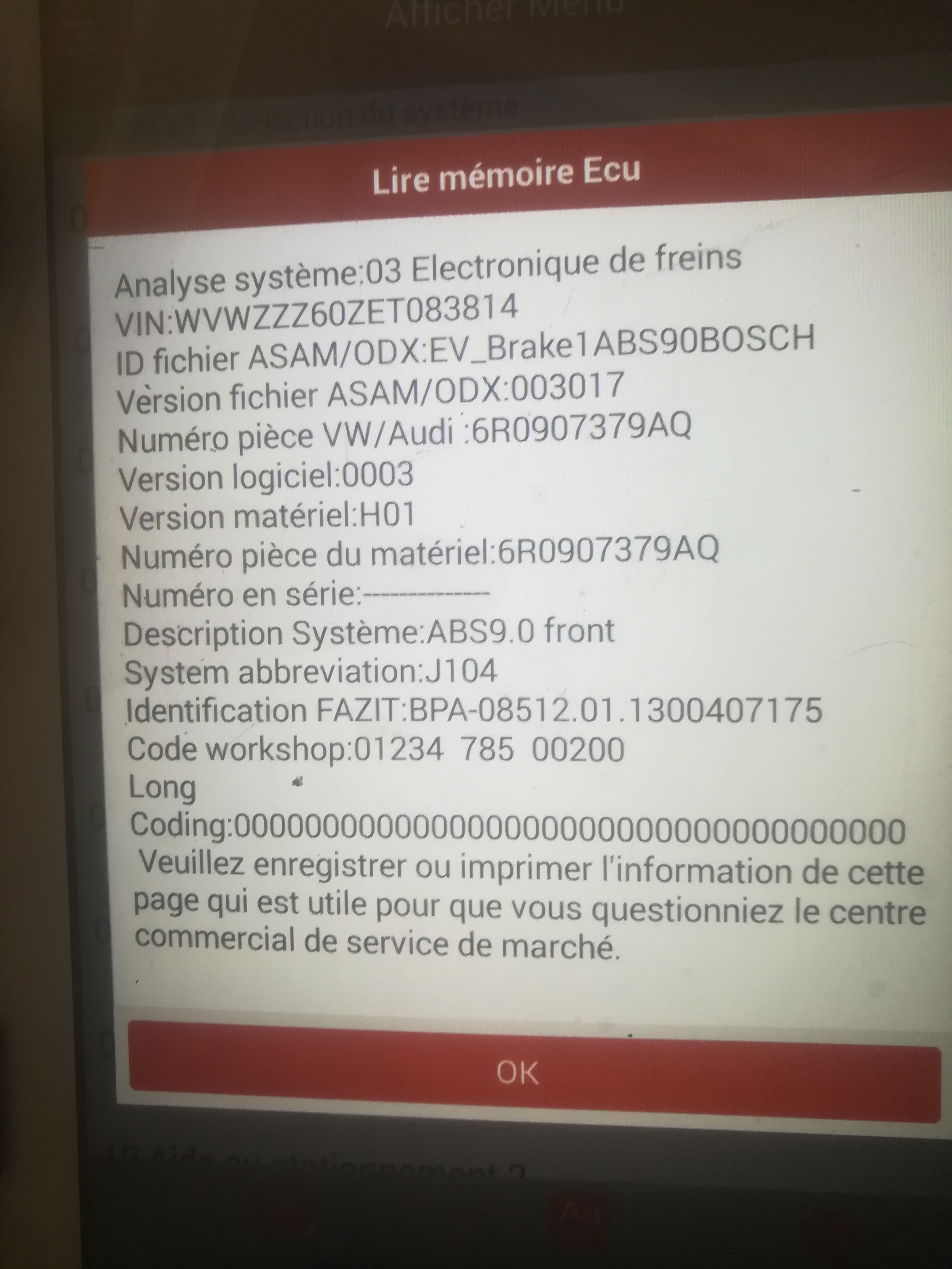

Salut, je besoin codage abs pour polo sedan indian d'un moteur 1.4 essence année 2013
Vin:WVWZZZET083814
6R0907379AQ
ABS 9.0 front
Merci d'avance
Vin:WVWZZZET083814
6R0907379AQ
ABS 9.0 front
Merci d'avance
- Posts: 6694
I'm going to need you to communicate in English please and I'm going to need more information:
LHD/RHD
Engine
Gearbox
ESP
TPMS
VIN
Why is the coding lost?
LHD/RHD
Engine
Gearbox
ESP
TPMS
VIN

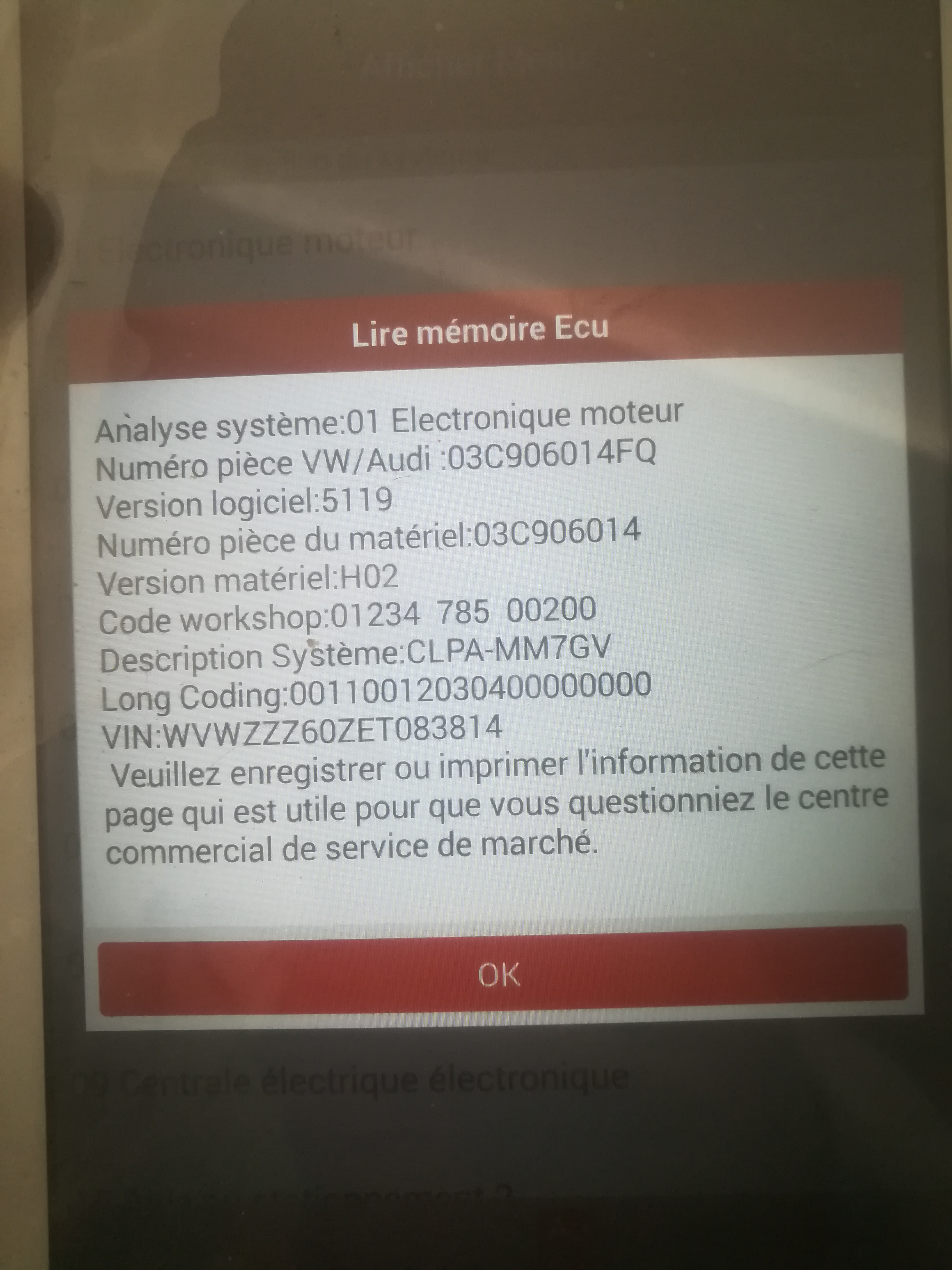

Polo berline
made in india
Gearbox manuelle
made in india
Gearbox manuelle
- IMG_20201022_130144.jpg (2.59 MiB) Viewed 2993 times
- IMG_20201022_130222.jpg (2.02 MiB) Viewed 2993 times
- Posts: 6694
Why was the coding lost?
Change ecu + instrument
- Posts: 6694
LHD/RHD --> ???
Engine --> CLPA
Gearbox --> Manual
ESP --> No
TPMS --> ???
VIN --> WVWZZZ60ZET083814
Why is the coding lost? --> new instrument and cluster
I need to know LHD/RHD and TPMS
LHD/RHD --> ???
Engine --> CLPA
Gearbox --> Manual
ESP --> No
TPMS --> ???
