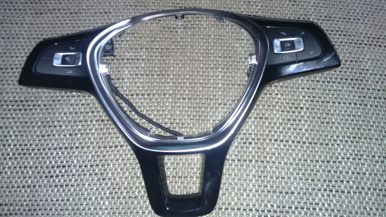

if i get a flat bottom steering with paddles for my polo sedan tsi with white backlighting . can i replace just my red backlit buttons from my old steering to the new one since its the same looking steering? i want red backlighting because all my other buttons in the car are red.
Posts: 8866
Re: ciclo's Polo. R-line 1.2 TSI 90hp 119gr.
Yes, if both steering wheels are exactly the same. The buttons can be replaced.
No, if the new steering wheel is a Sport model. The shape of the buttons is different.

ciclo wrote:Yes, if both steering wheels are exactly the same. The buttons can be replaced.
Pics?
The steering which he has got with white backlight is with paddles and his existing steering is without paddles has red backlight can he swap lights of old steering to new ?
Sent from my Pixel 2 using Tapatalk
Posts: 8866
The buttons can be exchanged.
For example, look at the images of these buttons: http://www.cars-equipment.com/www/en/sh ... [68237]/1/
All you have to do is remove the trim with one or several plastic tools, then change the buttons, three screws on each side.
Or change the whole set. https://i.ebayimg.com/images/g/aJ0AAOSw ... -l1600.jpg

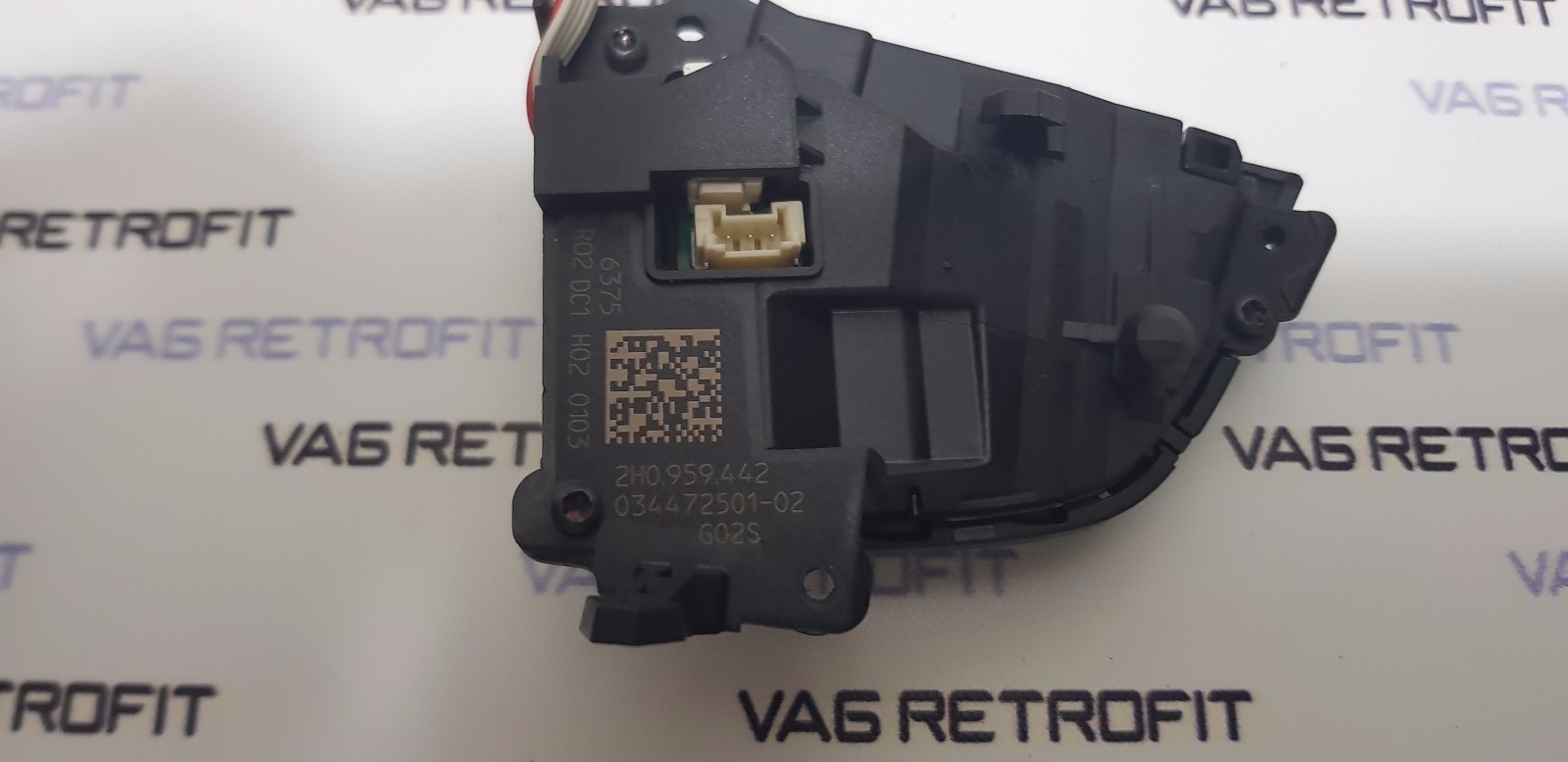

Maybe:
2H0959442
Read description :arrow: https://www.ebay.de/itm/Original-Multif ... 2513204488
paddle connector

ciclo wrote:The buttons can be exchanged.
Maybe:
2H0959442
paddle connector
The button without paddle don't have plugs of paddle connection
Posts: 8866
I know, that's why I show you the buttons that meet all the conditions requested by sharan1988.
Which would fit perfectly in your steering wheel.

Does the paddles connect to the multifunction buttons ?
Posts: 6687
Yes they do
sharan1988
Posts: 13
Joined: Thu Dec 21, 2017 1:01 pm
Drives: Polo sedan
Location: Chennai , India
Post by sharan1988 »
iichel wrote: Fri Dec 22, 2017 7:11 pmYes they do
Then I can't interchange buttons with red from old steering with no paddles then
Posts: 8866
sharan1988 wrote: Sat Dec 23, 2017 1:18 am
You can, but maybe they don't have tiptronic function.
Recommendation: Buy a steering wheel from 6C, Amarok 2018 or T6 2015-2018 for lighting in red, tiptronic and leather.
Learn to use ETKA online: viewtopic.php?f=10&t=42713#p466570
Please, if you have more questions open a new topic in the forum and make there the right questions... of what you want or need, thanks.
