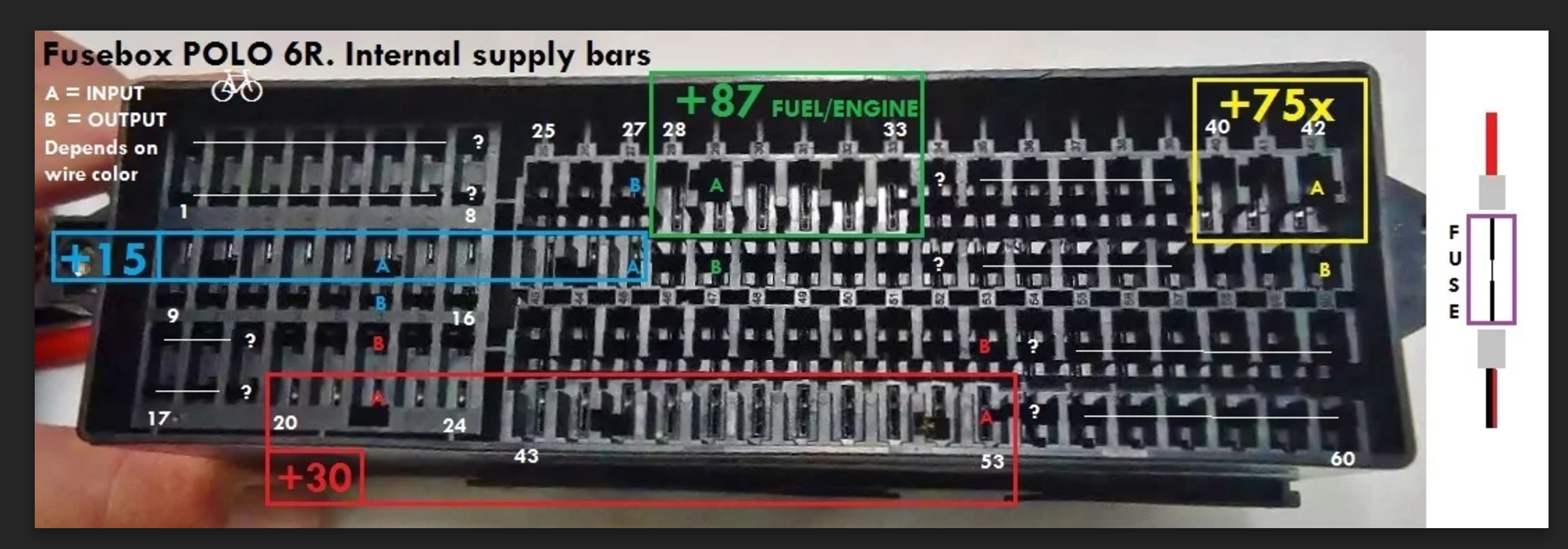

hi corner lighting one fuse goes to sb 57 and the other to sb54? on sb 54 which cable should i connect to?
T41/5 SB 57
T41/6 SB should I connect to 54
two are the same white and orange
Re: Polo 6R 09 1.4 85KM
Ignore SB54. It is obsolete if you make new cornering lights.
SB54 installation:
+75 contact --> light switch T17/2 (in) T17/8 (out) --> SB54a/b --> fog lights.
So SB54 can be removed and the wires can be left (or better, removed and isolated).
You see, no BCM interference.
Your new installation will be different.
Remove the wire that is now in T17/8 and isolate.
Make a new wire from T17/8 to BCM T73a/7 (1.5mm2), if possible, yellow
There goes a wire from SB57 to T73b/11 (this wire is already in place/needed for your LED headlights)
One wire goes from T73b/9 to the left fog light/static cornering light
One wire goes from T73b/10 to the right fog light/static cornering light
Now you can cheat a little bit. SB54b goes to both fog lights (SB54b is close to the middle).
You can use this to wire T73b/10 to the right fog light and save 5 meters of wire.
So connect T73b/10 to SB54b (cut off connector from the yellow/white wire). You can check if it's the good one with your multimeter. It should NOT be connected to the light switch T17/8.
It is important to remove and isolate the wire to the left fog light at the connector of the fog light. Here you'll place the new wire (T73b/9 to T2/1).
thank you, I meant the Ciclo installation
T41 ---> 6,5,4,3,2
but I don't know which fuse to connect to t41 / 6
