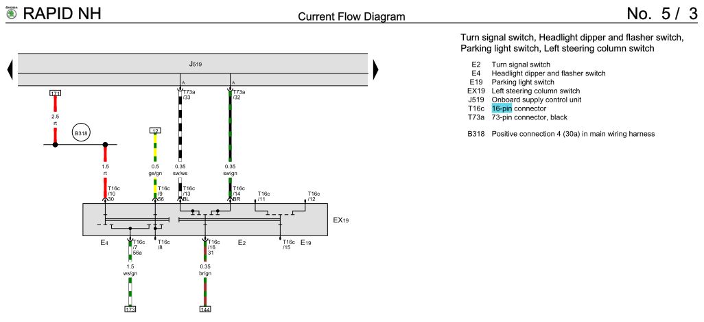

- Check with a multimeter the +30 wire that reaches T16/10 (there should be +/-12V), it is the one that should make the high beam flash work when the light switch is in position 0. Check that the contact terminal is well inserted into the connector.
- You must change the combination switch of the steering column (STALKS) from 6RA to 2Q0, without cruise control (left stalk) and with buttons for MFI (right stalk) 2Q0953513G, that is to say as currently but 2Q0 (search in Skoda Rapid 2019 onwards). This will make your high beam hand switch work correctly and not strangely.🤭
where he's going from t16/10, to SB fusebox?

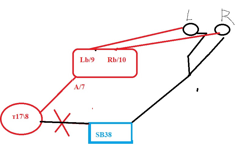

Now i se i didn't need 2 cable from sb17 to B3 A5 drl?rear fog to bcm,all rear light to bcm and salone light?
I did a lot of extra wires impractical :shock: and didn’t harness rear fog😂
I just couldn't find where it splits before SB38 to L and R, but this is a new project, fog with drl section

-T16/10 is powered from the SA4 (40A) fuse, usually located near the Battery. I see you still haven't learned how to use the diagrams.

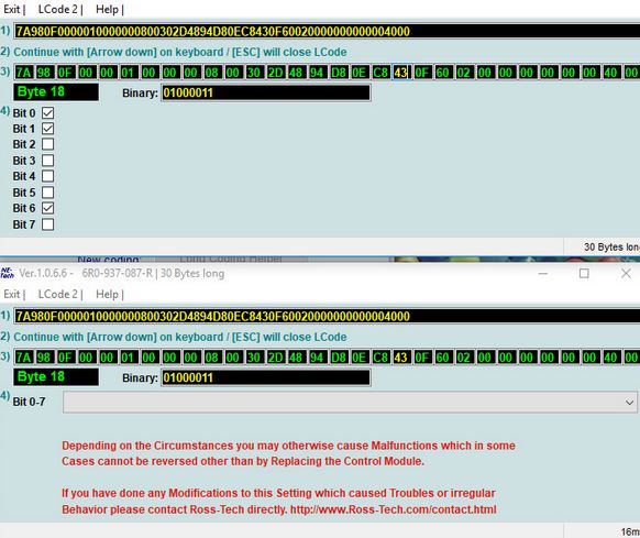

I change bit 18 from 73 to 66 and now i can flash with hi on switch zero 🙏
On parking switch👍 Lo work stable👍 the story with stalk still here.

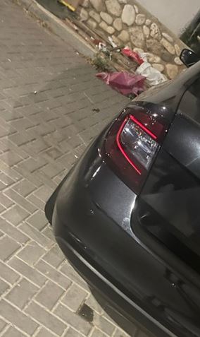

and it seems there is a problem now with left tail after lock :mrgreen: ,LED continues work 🙃

I think that the real problem with your installation lies in those connections that you made that you say were unnecessary
Speaking of the wires that I stretched in vain, I had in mind
1)SB37 Rear fog T17/9 to T73A\6.
2)Illuminated buttons in the cabin.
from the connector of the T17/16 switch Grey-green thin wire to T73B\4.
3)Revers light and license plate lamps, T73B\7.
I just changed my mind in the process. Because the light sensor 5JA907451B that I planned to instal as I understand not installed on PQ25.
Maybe yes maybe no i didnt find solution)so I decided to stay without auto light and with the old T17 switch.
So if someone only wants to adapt the bixenon only, on pq25 with maxBCM, then he will have enough of those connections and coding that are in this thread

To operate the SCLs (static cornering lights) the wiring for the front fog lights must be under BCM control:
The SCLs function and all its variants on higher platforms is great!🧙‍♂️
On the PQ25, depending on the factory equipment, the front fog lights may be installed without BCM control, which makes SCLs impossible through these lamps:
In your current circumstance, which is very favorable, going from a T17 (large) connector to a T10 (small) connector is the same child's game we have been playing up to now.
If I remember correctly, T73b/7 is for the output of the license plate lights, and T73b/12 for the output of the reversing light or lights. T73a/37 is for the input signal from the light switch for auto lights (AUTO position).
However, with a BCM Max the Coming Home function can be activated without the need to have a Rain/Light Sensor (RLS) installed. For Automatic Lights and the Leaving Home function an RLS is required.
In pq25 the CH function can only be a semi-automatic function. With the ignition switch OFF, pull once from the high beam lever, when you open the door the corresponding lights will turn on to guide/illuminate your path.

So only my sb connection wrong
Posts: 9037
Re: Polo 6r GTI - Bi-Xenon installation Issues
I will always support any kind of creativity and innovation, I am starting to like your 'pictograms' ...
