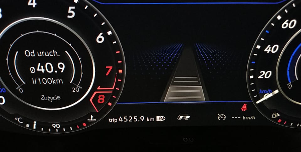

OKay, done
- 263953688_2877969555841562_5821266137454346922_n.jpg (51.3 KiB) Viewed 21181 times
- 263743143_591526041930299_6945259191847314699_n.jpg (45.82 KiB) Viewed 21181 times

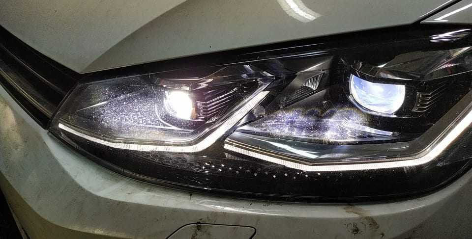

- Posts: 8968
Re: GOLF 7.5 FL R-LINE
Excellent!
Now you will know how cool it is to drive at night with Matrix LED headlights.
It is very important that the level of headlight height adjustment is done correctly to fully enjoy them. The high beams will be ON most of the time without dazzling oncoming traffic.

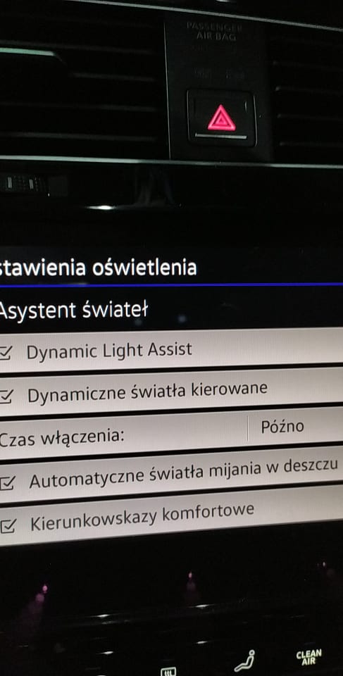

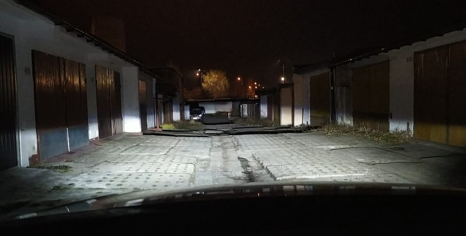

Yes, When I put on the lamps they were too high
The next day, I drove my car to diagnostic stations to set the lights I haven't had a chance to see how led DLA works yet
1 day difference between photos
- 263937079_1357665698001075_3853944989839257778_n.jpg (79.36 KiB) Viewed 21123 times
- 263746407_1487268614978304_8885189569042642028_n.jpg (44.41 KiB) Viewed 21132 times
- IMG_20211210_104614.jpg (441.89 KiB) Viewed 21132 times

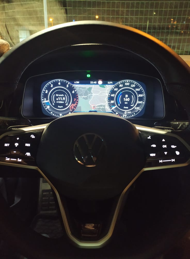

- 267847161_675158926815042_5699466341824037767_n.jpg (66.95 KiB) Viewed 21023 times
- 266371371_256662523064168_4928873171362296186_n.jpg (105.84 KiB) Viewed 21023 times

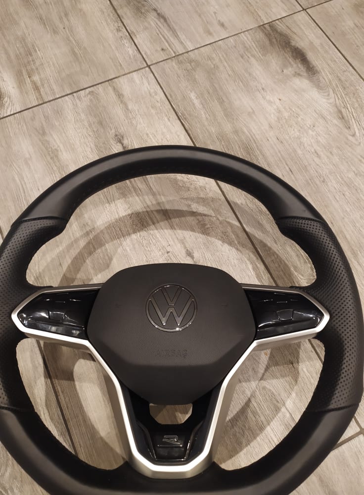

- Posts: 8968
Why?
Do you plan to install a DSG Emulator?
Did you install the proper steering ring for the heated steering wheel?
What happens when you press the Travel Assist button? I really ask. Please tell me.

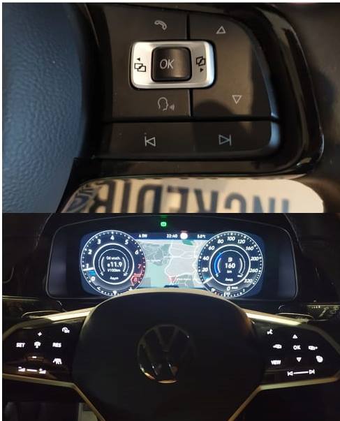

I bought a complete steering wheel for 380 euro
In Poland, it's hard to get steering wheels without DSG.Over time, I will replace it with the normal one, I care about heating the steering wheel.The travel assist button is inactive

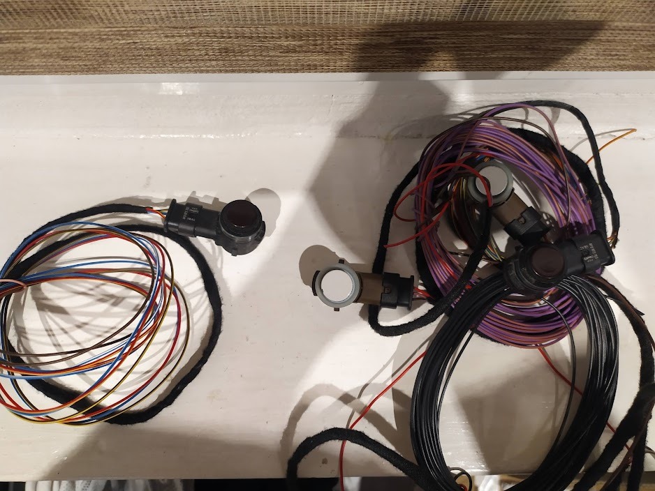

Today the courier delivered 5Q0 953 549 D I'm still waiting for
5q0972726
My coding - AF0300
But the view button doesn't work for me And the previous steering wheels did not have it
5q0972726
My coding - AF0300
- 267728650_655510492124982_4225071096086731736_n.jpg (35.35 KiB) Viewed 20957 times
- Posts: 8968
OK, ... some things to fix there ... (GW)
With that amount of money you could have bought a full last generation MFSW "in NEW condition" and suitable for your Golf with manual transmission.
Happiness is a subjective state of well-being

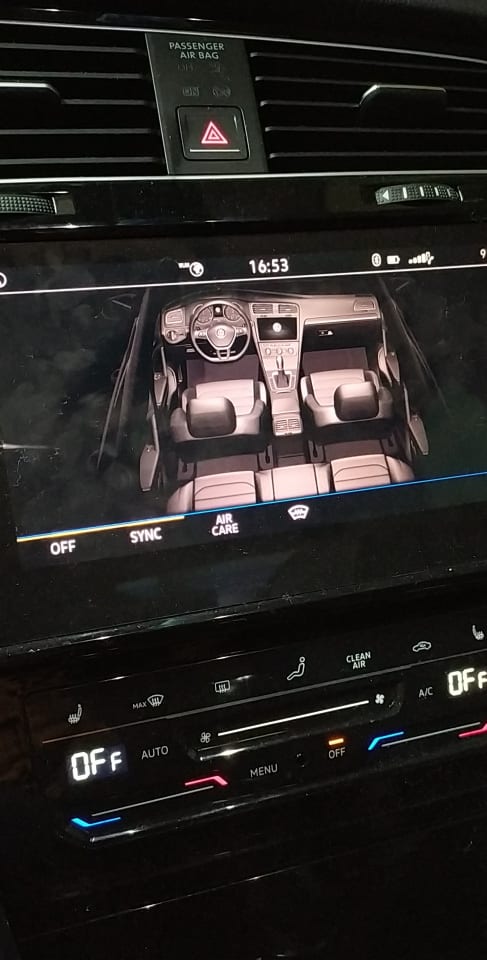

dcgumis
- Posts: 94
- Joined: Tue Sep 03, 2019 6:04 pm
- Drives: polo 1.4 85KM CGGB/GOLF 7.5
- Location: Polska

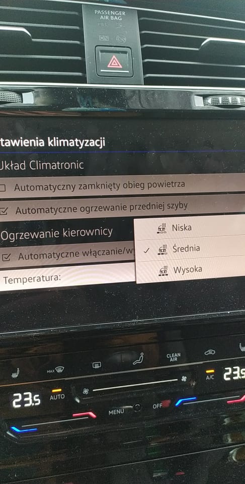

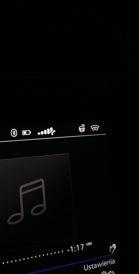

I just finished the heated steering wheels heats up very cool
I coded the block 08:
byte 11 bit 2-3
But the steering wheel icon does not appear in the air conditioning menu when the steering wheel heater is on, only the icon is shown in the top right corner.
byte 11 bit 2-3
I tried many encodings,2C0300 the view works but the heating does not workOK, ... some things to fix there ... (GW)
- 267926838_4947977478567690_287399748773449161_n.jpg (54.22 KiB) Viewed 20845 times
- 266905083_497373861812291_5343215293480406673_n.jpg (74.84 KiB) Viewed 20845 times

This is how I saw this post from 10 PLN earlier, I meant the "View" button ,The view button works on a different coding, but again the heated steering wheel button does not work
I'll try to work on it later

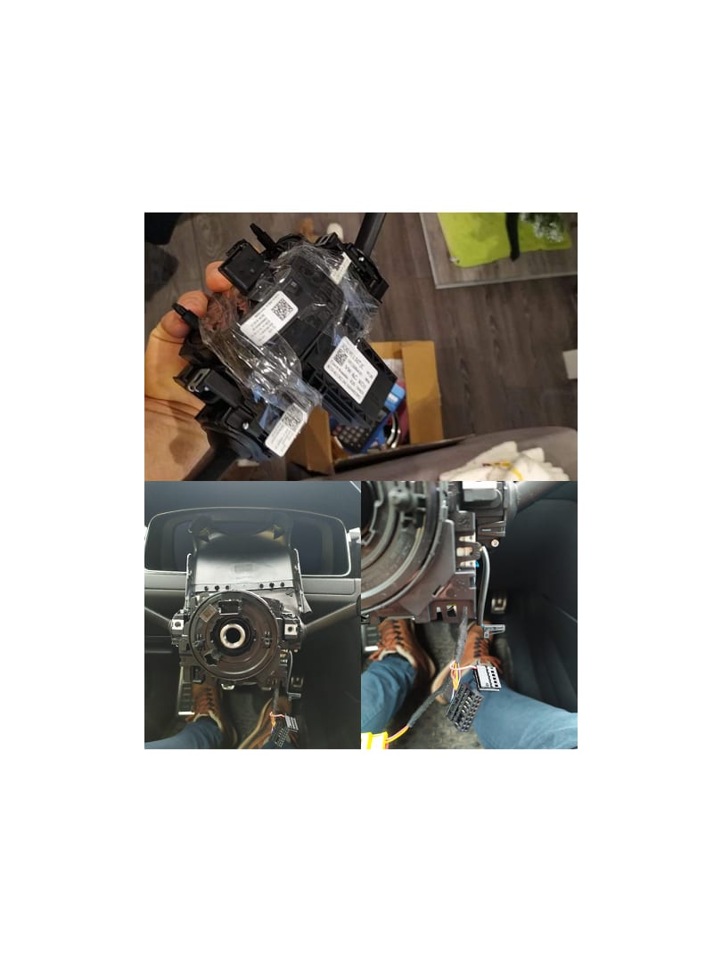

Maybe you will find the solution for the heated steering wheel button by reading the following link, or at least some clues as to why the heated button on your steering wheel is not working.
https://www.drive2.ru/l/566248764256288809/
In the evolution of the Golf 7-7.5 , MQB platform, the steering ring went from being an individual control unit with CAN lines - comfort/convenience - Address 16, to being a BCM subsystem with 2 LIN - BCM, Gateway-.
Previous generation heated steering wheels didn't have a physical button on the steering wheel, it was either on the center console buttons (two wires from BCM) or on the HVAC unit.
Note: Slavik have the steering column ring hardware "just like you", address 16, and on his steering wheels, the button to heat the steering wheel does work.
It may be a hardware or software compatibility issue, but since you don't post a full autoscan after your modification, we can't draw any conclusions.
