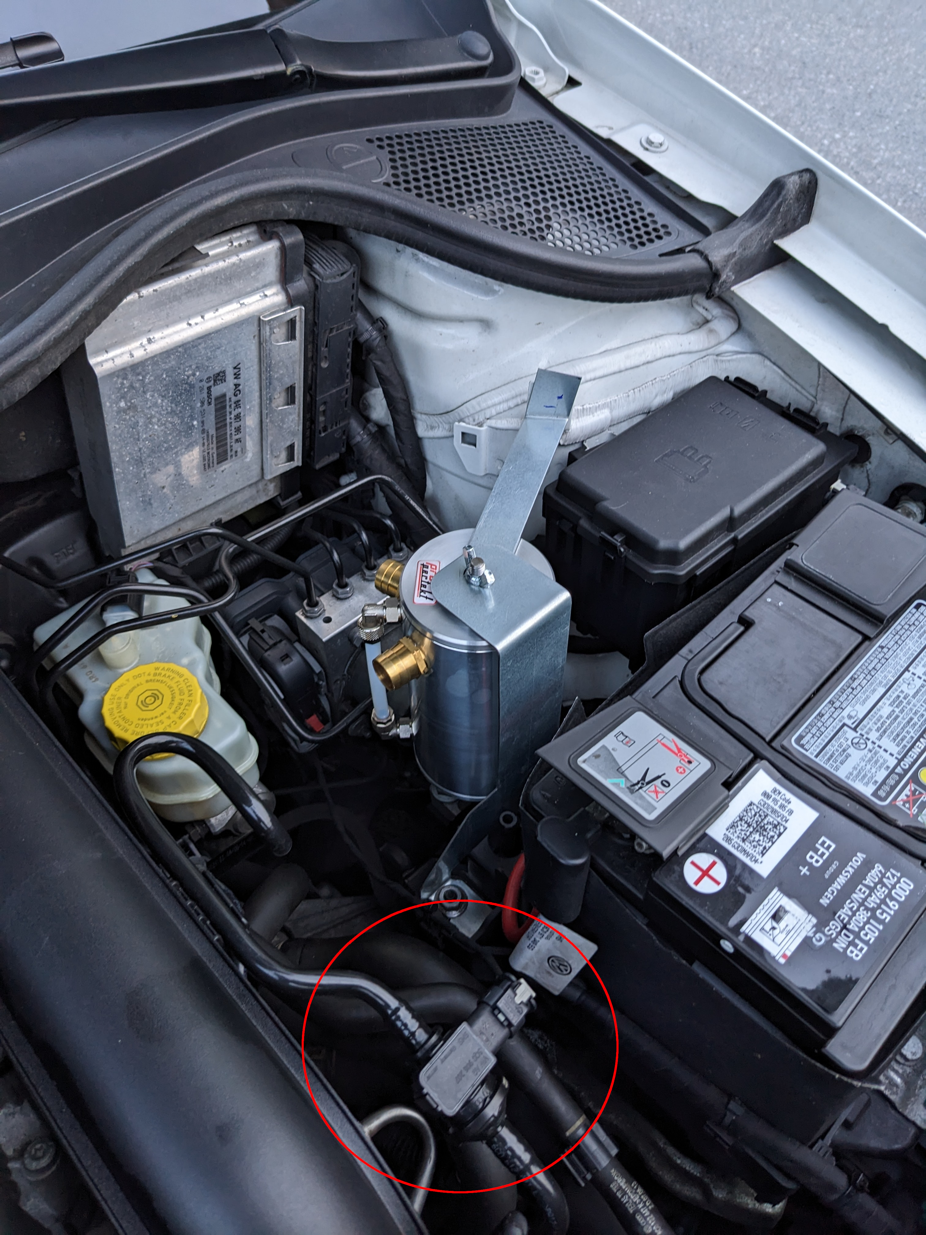

Off-topic...
Just looking over pics again.
What is the purpose of this sensor:
It is brake vacuum or booster pressure sensor. Just curious as to what it connects to and what it is used to control.
Re: EA211 Oil Catch can
Posted: Mon Mar 25, 2024 8:40 pm
by Le_Combattant
You are right, It is brake vacuum line ;)
Posted: Tue Mar 26, 2024 7:52 pm
by 2226
lol well yes, it's a vacuum line. But what's the pressure sensor for?
Can't quite tell from the option codes applicable to CJZD equipped vehicles.
Posted: Tue Mar 26, 2024 8:41 pm
by Le_Combattant
Brake Vacuum Pipe Tube sensor.
Why ?
I don't know :?:
