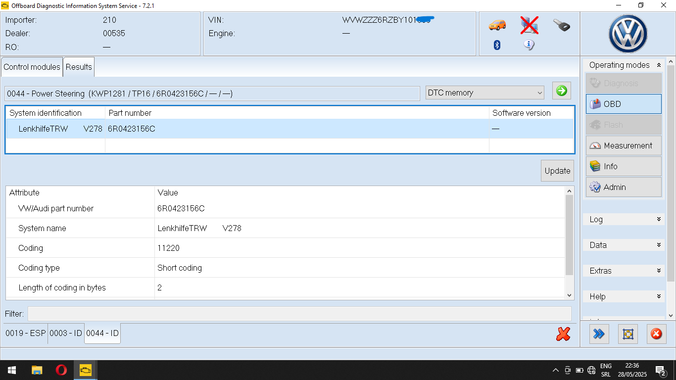

Ok guys,
I have disconnected this android radio, and ran autoscan.
Unfortunately our communication Issue Isn't solved. But we now have access to our G85 slip ring! with one not so pretty fault.
   Serial number: 25111304652410
   Coding: 01
   Shop #: WSC 00000 000 00000
   ROD: EV_LWSKLOVW25X.rod
   VCID: 7EA5FEE540748B2BFDF-802A
1 Fault Found
136193 - Supply voltage
          U1012 00 [008] - Voltage too High
                    Fault Status: 00000001
                    Fault Priority: 2
                    Fault Frequency: 1
                    Reset counter: 235
                    Mileage: 242692 km
                    Date: 2024.09.29
                    Time: 00:01:46
                    Voltage terminal 15: 0.00 V
                    Voltage terminal 30: 16.50 V
                    Terminal 15 status: OFF
                    Entprellzeit: 90000 ms
Edit:
242 000 km - Meaning this was while it was on a donor car. So we are good. (date also matches)
Next step:
I will have to look at the schematics and see what do power steering pump modul and abs brake module share and go from there.
There are three possibilities.
1.) Faulty abs modul ( but the abs works fine- it is pulsating the brake pedal when slipping on braking)
-I did re-seat the connector on abs pump, it looked dry and normal
2.) Faulty power steering module - I doubt it since i replaced it while ago and put new connectors. So no moisture problems.

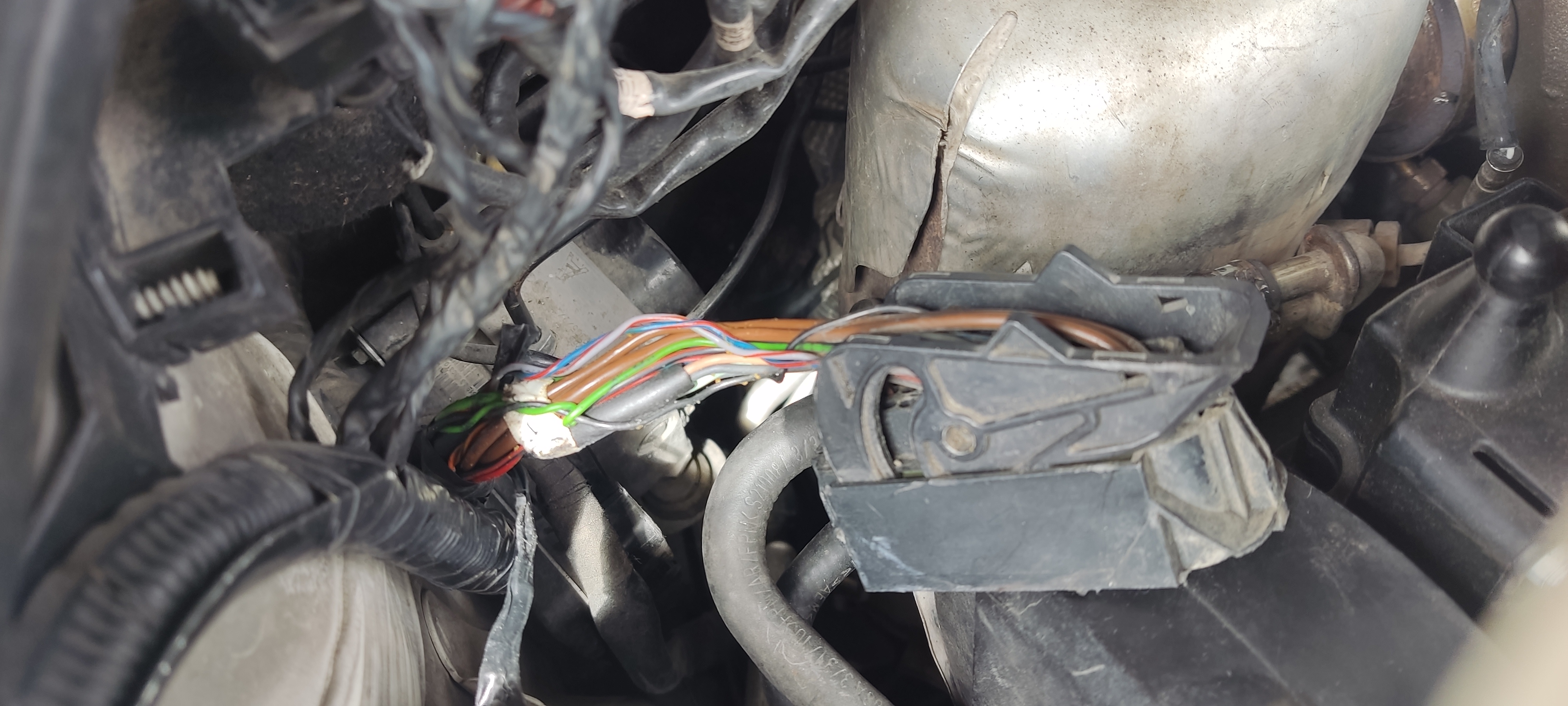

3.) Some wire-ing issue between these two. ( I have noticed that there was a repair done on the loom in the engine bay i think between gearbox and the fan... it might have been a purple wire- not sure)
------------------- I will have to get a probe light---------- Open the abs connector and probe red green wires to see if we have power on ABS module. If thats ok then the canbus should be ok - I have no scope to test this out. Maybe measure the voltage and see. i think it should be '+6v or +5v on can lines.

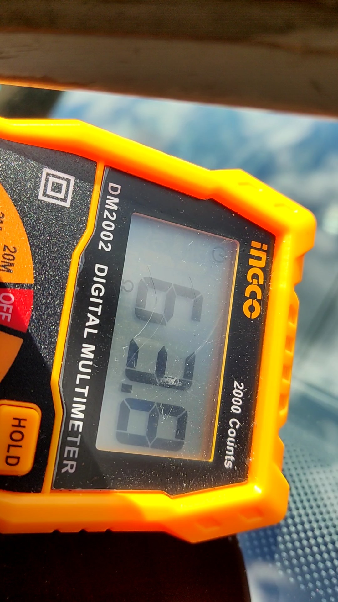

Check if the resistance on CAN hi- Low on abs pump connector Specification is 60-70 ohm. If ok then can-hi low wires are good towards abs pump.
Check power check gnd, its its all ok- Faulty abs pump.

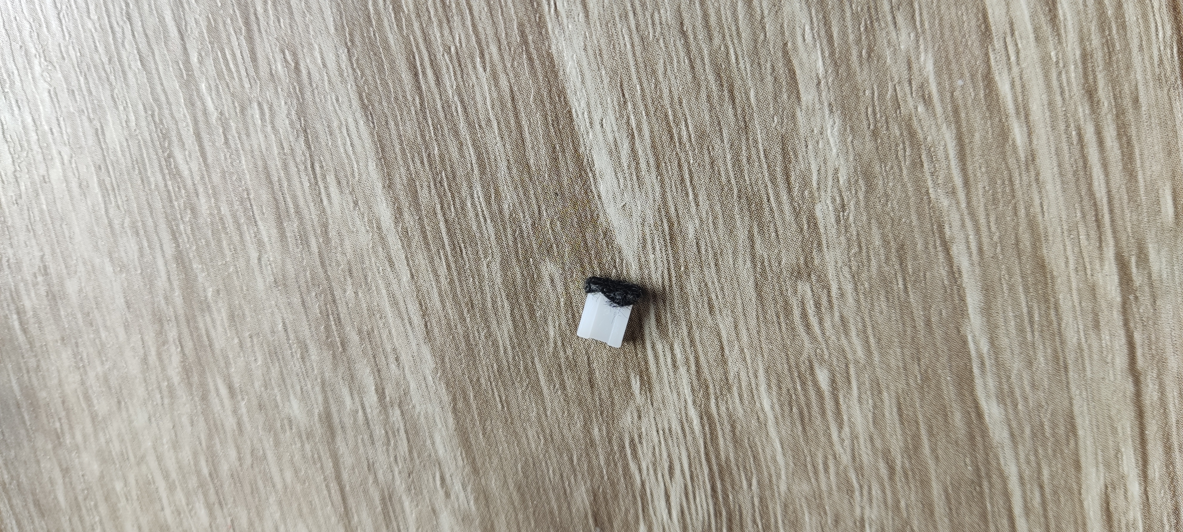

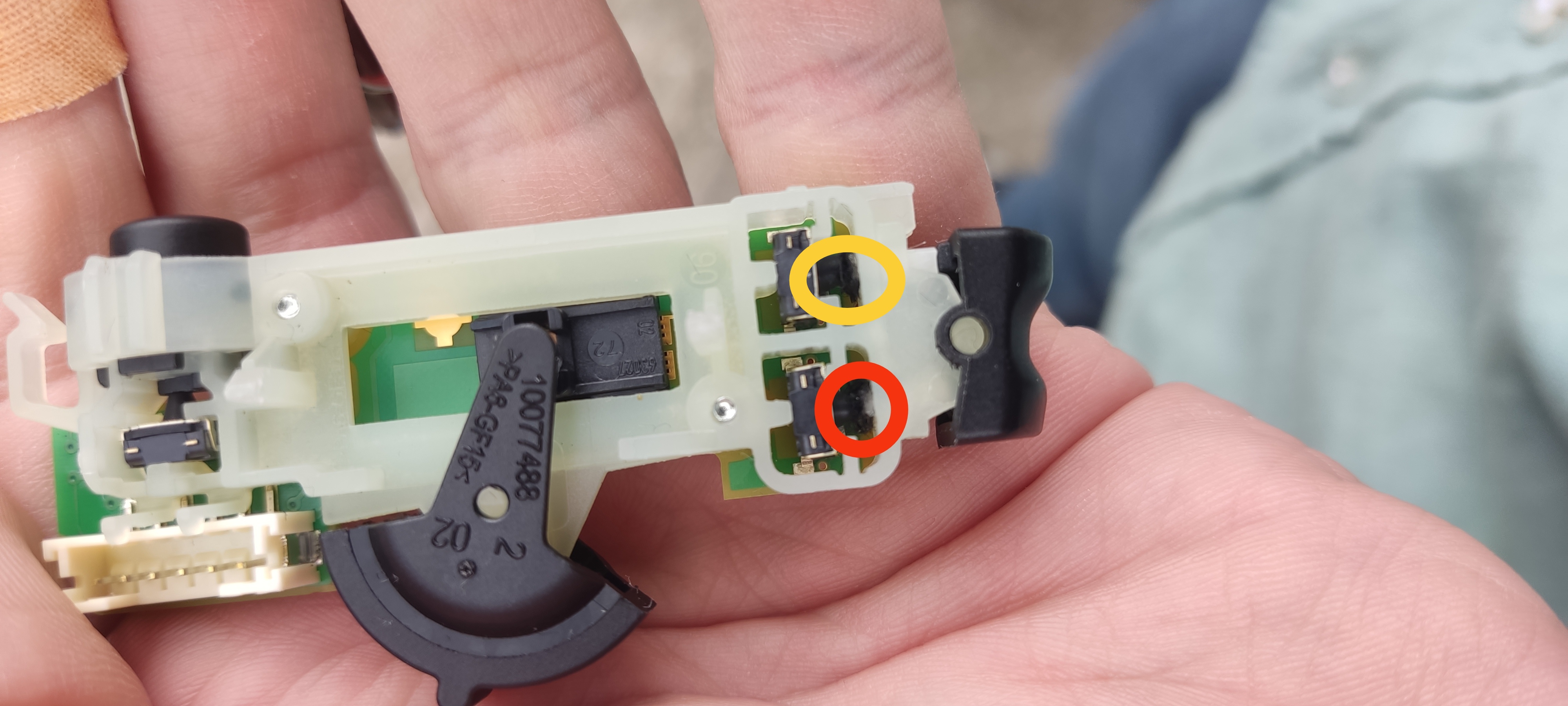

Stalks i had one issue, one silly push button on trip computer slipping. Lol buying used parts never know what you are going to get... lol.
Disassembled the lever ( easy) slip a card between trip button, and the plastic shell so you can pry under. Slowly go around.
The fix.
1. Put some cloth/ tessa tape on the litle levers that touch the button, so it doesn't slip.
I did it for both switches.
https://youtube.com/shorts/FGT-hVfF-9M? ... 7A-y3A2ETr
put everything back, this finger resting plastic peace can go only one way.
Now the lever doesnt slip on the button and is good.

It would be great if you could figure out the problem with the CAN line, I would focus on the repairs that were made previously. :)
Posts: 9037
Location: Earth β™₯, Spain.
Re: Stuck trunk
I'm referring to wiring repairs for the ABS, power steering, etc. that were made with the previous owner.
The engine has the same CAN powertrain line and is accessible by diagnostics.
As a suggestion:
If you can't find the fault in the wiring, and in test mode, you should run new CAN line wires to a point where it would be possible to diagnose the missing units.

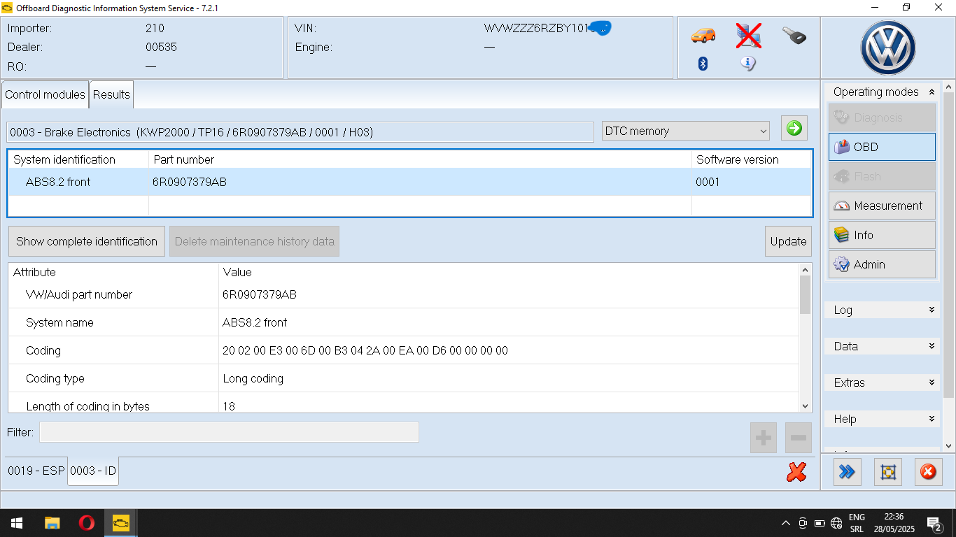

Re: Stuck trunk
Ok guys,
today the weather was nice and i had the time.
Unwrapped and unboxed the abs connector.
Using test light.
Grounds on abs connector confirmed βœ…
Power from the fuse box sb9 ( the one inside the car requires ignition on to test) to the abs pump connector βœ…
Power from Sa fuse box ( on top of the battery) to abs pump connector βœ…
Cabus hi-low resistance is ~60.2-63.8 ohm meaning the canbus wire-ing towards abs pump is βœ… (spec 60-70 ohm)
Its hard to take a vid, and hold the test leads. Because i had thin needles inserted into the connector. ( And we dont want lost needles in the engine bay).
I ran diagnostics while abs pump was unplugged, our steering assist 44 didnt come to life.
03-ABS Brakes -- Status: Sporadic communication error 1000
56-Radio -- Status: Malfunction 1010
Address 01: Engine (J623-CAYB)       Labels: None
   Part No SW: 03L 906 023 D    HW: 03L 906 023 D
   Component: 1,6l R4 CR td H13 9970
   Revision: --H13---    Serial number:                CVN: A5A3D4E5
   Coding: 00114014002400080000
   Shop #: WSC 00788 648 00255
   ASAM Dataset: EV_ECM16TDI02103L906023D 003009
   ROD: EV_ECM16TDI02103L906023AH_003.rod
   VCID: 270BFB81FF6EEAE26E1-8072
   VINID: 9E69EAAAA1A2A92A4100114814B9406116
Readiness: 1000 0000
Address 03: ABS Brakes
Cannot be reached
   Coding: 01
   VCID: 7EA5FEE540748B2A7D7-802A

Address 44: Steering Assist
Cannot be reached
Address 56: Radio
Cannot be reached
End----------(Elapsed Time: 01:45, VBatt start/end: 12.3V/12.3V)-----------
and ofc. abs module on vcds became red with no communication.
After plugging it back in, it came with sporadic communication fault.
After clearing all dtc... back to usually issue.
And when the pump is plugged back in its black, doesnt show faults and cannot be reached.
Conclusion:
- Abs pump s**t it self
- What is funny no warning lights on the dash. Only while the abs pump is unplugged.
- I have to check the power steering pump. Forgot to bring a t25 torx to remove the fog light...
But im pretty sure it will also return ~60-70ohm on can hi-low. and the power is good since the pump is running.
So yeah... ❀️ you trw and your pumps.

The intermittent fault detected in the G85 was the result of a malfunction in the communication or power supply lines at specific times, both before (the donor car) and after (your 6R). It's not a sign that the potential donor 9.0i pump is faulty.
I insist :lol: . In external way, run any two wires as a test (they don't need to be twisted together), from the IC's CAN lines to the pump's CAN lines, and verify communication with the pump using the VCDS. You can use alligator clips to do this.

Ran a scan with Odis ( had a vas5054a sitting for years collecting dust - I know last time i used it- few years ago i couldn't reach these modules) but now
no issues.
Definitely adding heat shrink at bcm did help, and i can sleep now since we have communication.
Live data works, meaning everything is OK.
So yea, for you all budget folks STM32f405vgt6 is trash, and hex-can Atmega was good an did read these module ( not promoting, but someone might find it useful). Go for real deal if you can ofc.
ELM327 did scan the module like it had no issues, but no identification.
For me this is good enough, I can reach the abs pump. Friend has launch, and i will borrow it and do a scan with it.
